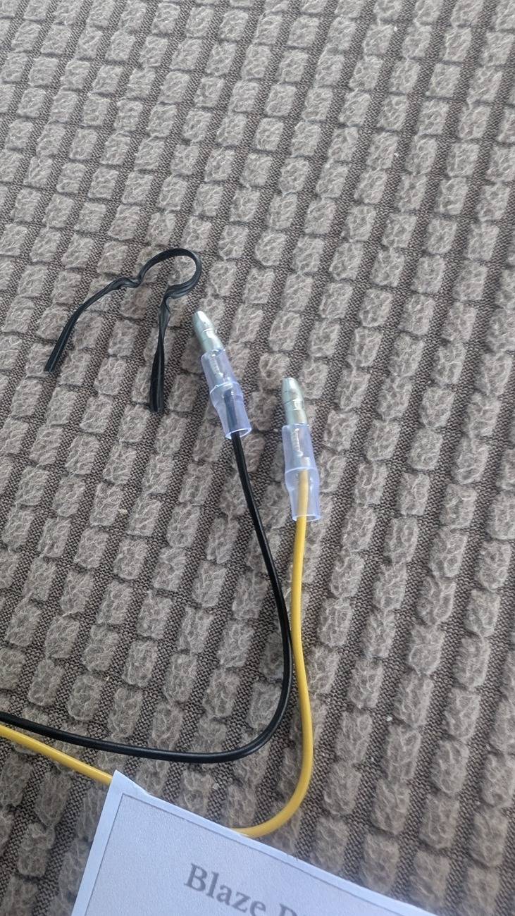

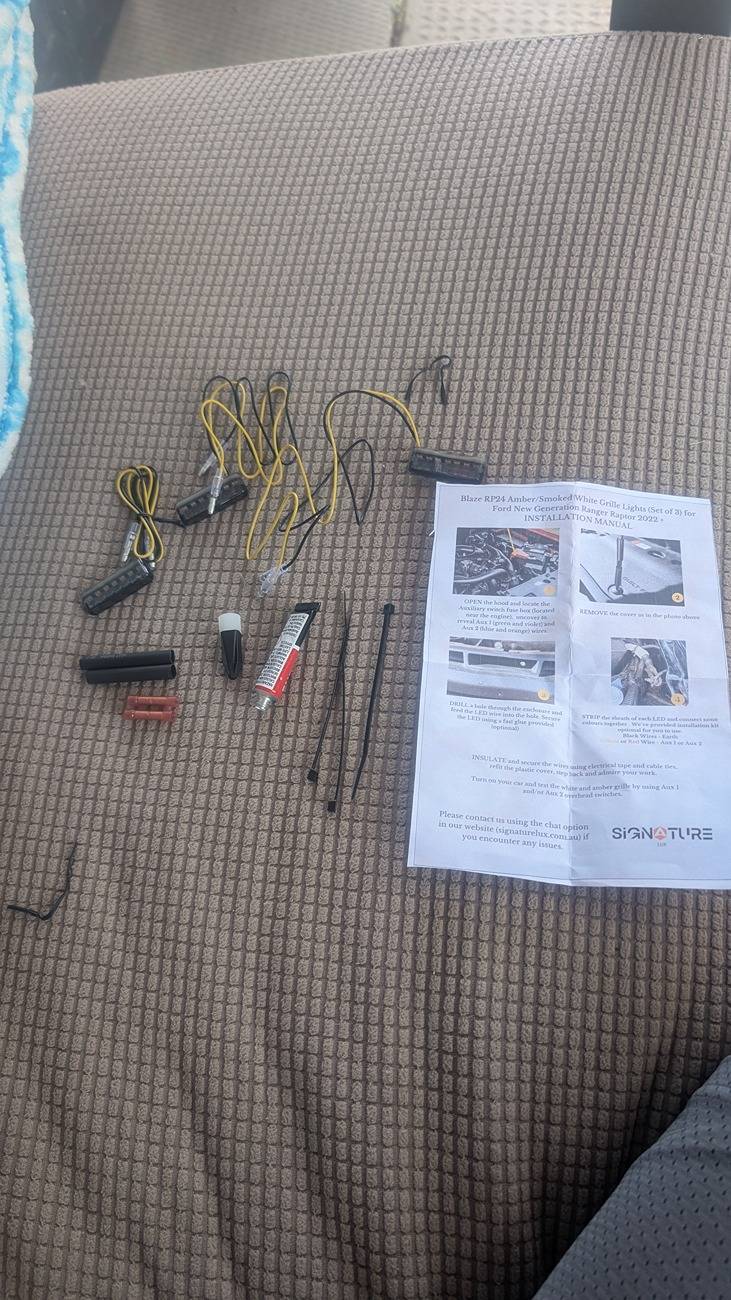

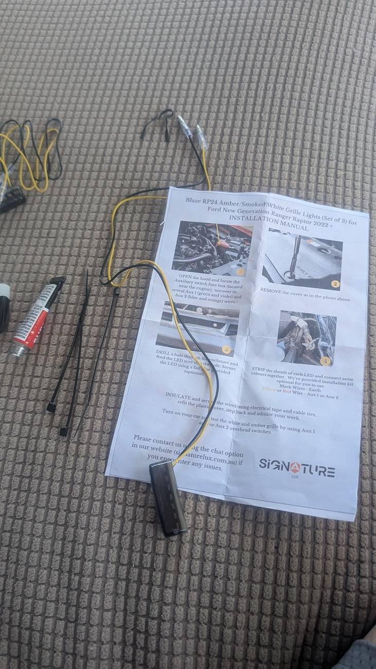

I ordered a set of Signature Lux Grill lights. I finally got time to install them last weekend. When I opened the package I was disappointed and confused. It's a pricey kit, I was expecting a near plug and play set up.
All that was included was the 3 LEDs each with a very short bit of wire with a connector end. There are no adapters, no harnesses, no extra wire to tie everything together, and only a small sheet of instructions saying basically install lights. There is no explanation as to where these connector ends are supposed to go. There is no wiring diagram.

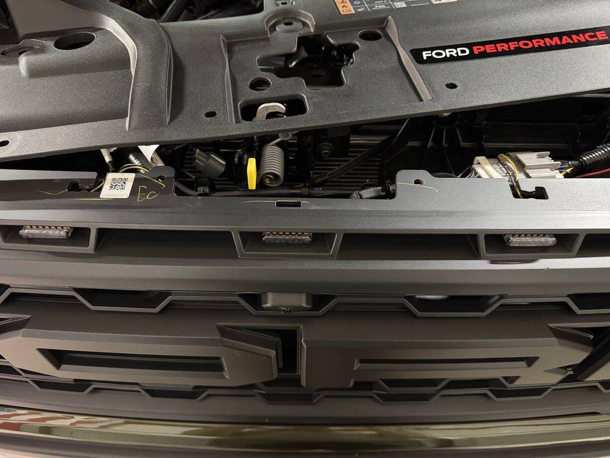

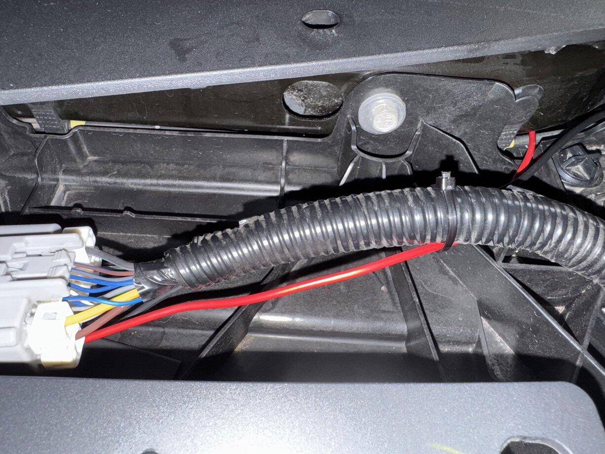

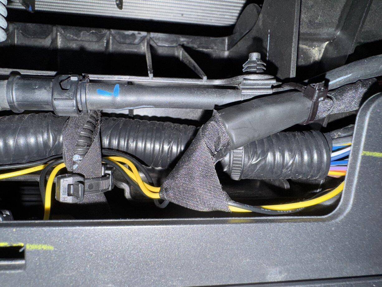

I just installed these and wired them like this:
Ford Ranger Signature Lux Grill Lights Troubles 1750341828523-rd
Used some thin double sided tape on the bottom of the lights to hold them in place.
Ford Ranger Signature Lux Grill Lights Troubles 1750341890059-j7
Drill holes in the right side of each of your three recesses in the grill and feed all the wires through there. You can cut off the included connectors before doing so because you don't really need them.
Tie the three yellows together and the three blacks together, and crimp them (separately) in the included splice connectors along with a single wire coming out of each. I used shrink tubes and Tessa tape to protect the connections.
Ford Ranger Signature Lux Grill Lights Troubles 1750342135774-f
I used red for positive and black for negative.
Ford Ranger Signature Lux Grill Lights Troubles 1750342222986-yx

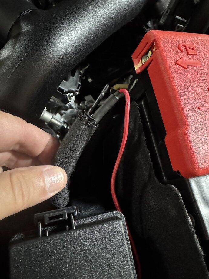

Crimp your positive wire to the AUX1 in the bundle next to your battery. I used heat shrink tubing again to protect the connection.
Ford Ranger Signature Lux Grill Lights Troubles 1750342324748-y8

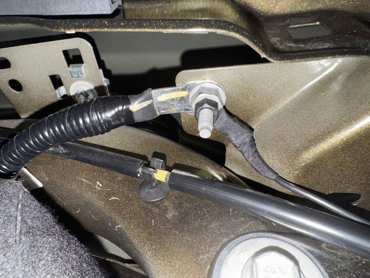

Use the spade connector included with the kit to crimp to the ground wire and a spare 6mm nut to connect it to the main ground connector on the body near the front of the battery.
As long as your AUX1 switch is on, the lights will be on when your truck is running.

Thanks for the helpful reply.
I didn't receive any extra wire to go from the two sets of three tied together wire or a spade connector in my kit.

Hello JDW — were you able to install your amber grille lights, or has one of our staff replied to your email yet? If not, feel free to send us a direct message with your order number so we can check our system and reach out to you.
We’ve recently been getting reports from some customers about the amber lights not quite reaching the AUX box — this seems to vary based on vehicle specs in different countries. We are now providing solutions for this. Rest assured, we are taking all feedback seriously and taking appropriate action to improve both the product and instructions.
