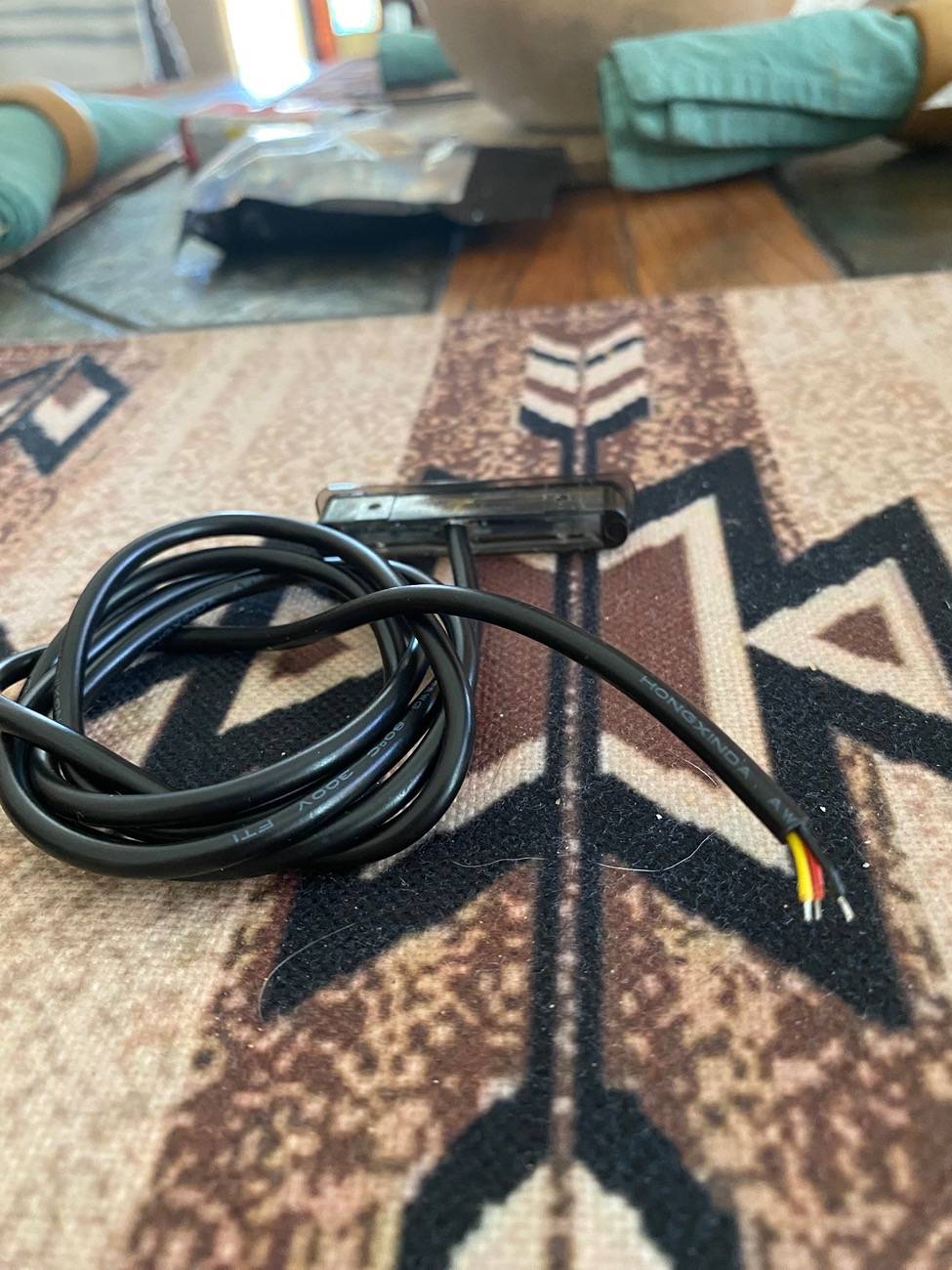

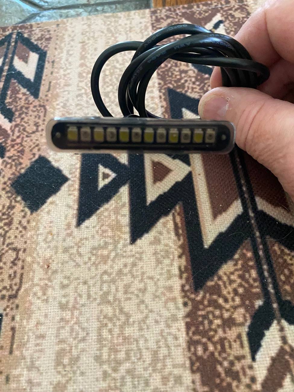

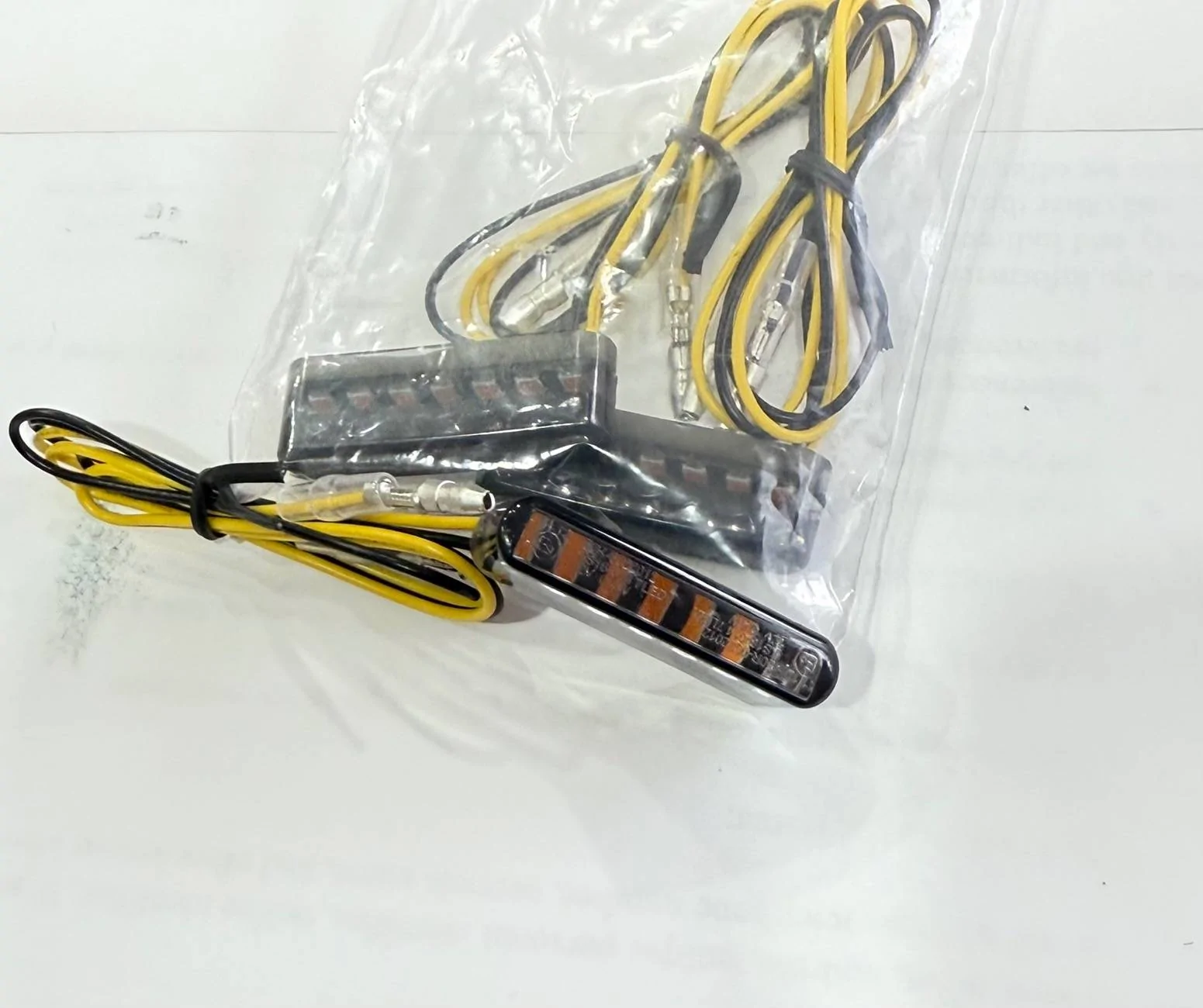

Thanks. They sent me both as I wasn't sure which I wanted. They also look different so I wan't sure which was which. So you said yours are white then larger ones are white? See my photos below.

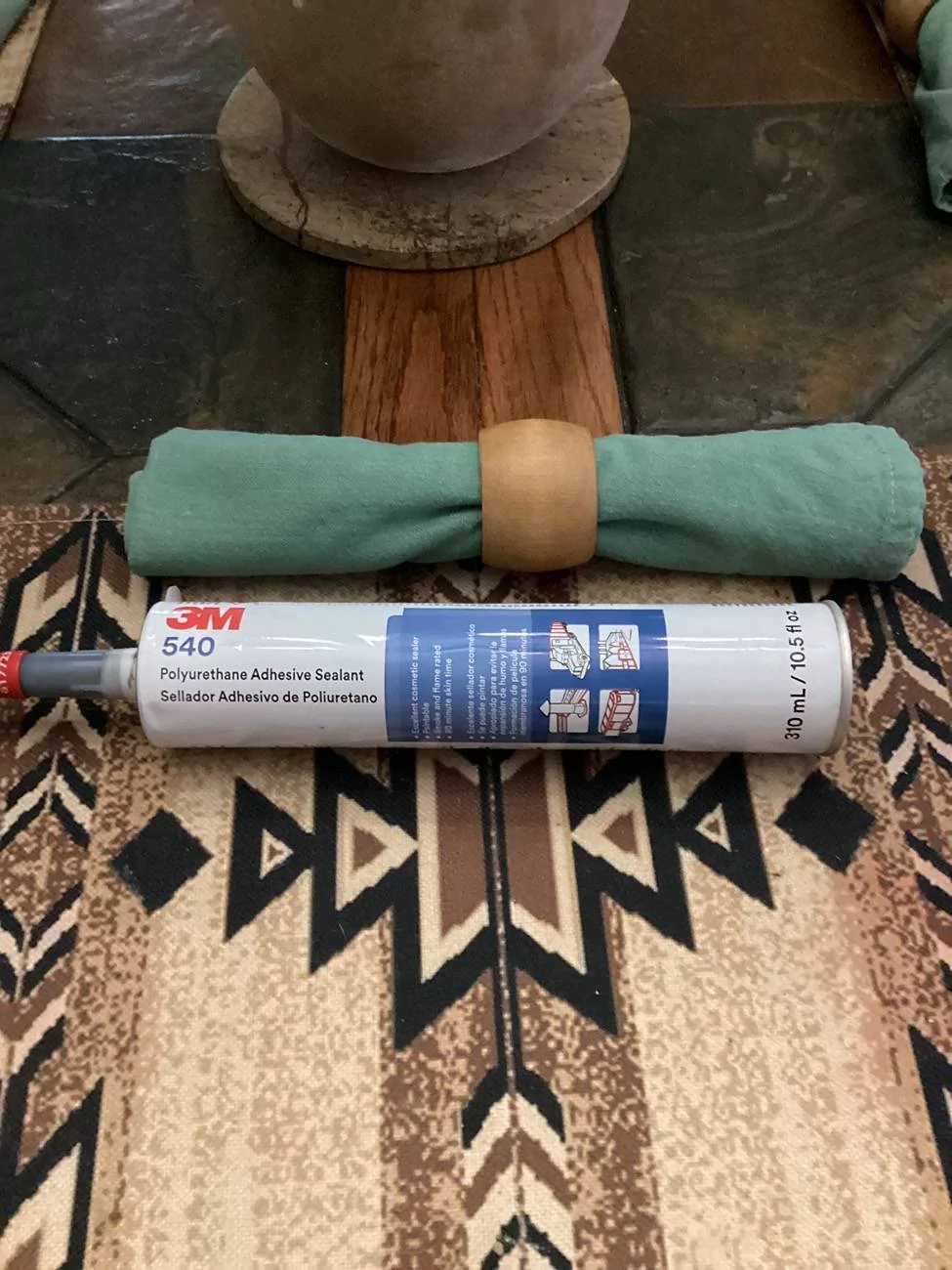

3M has an adhesive that is used on most of the Air Design spoilers. It’s black and sets very quickly. This same adhesive can be used on the rear of the lights when they’re set in place. It’s waterproof and holds far better than any silicone available.
It can be purchased on Amazon.???
Good stuff, but once it's on, you'll never get it off. bulb dies; it would be a biotch.

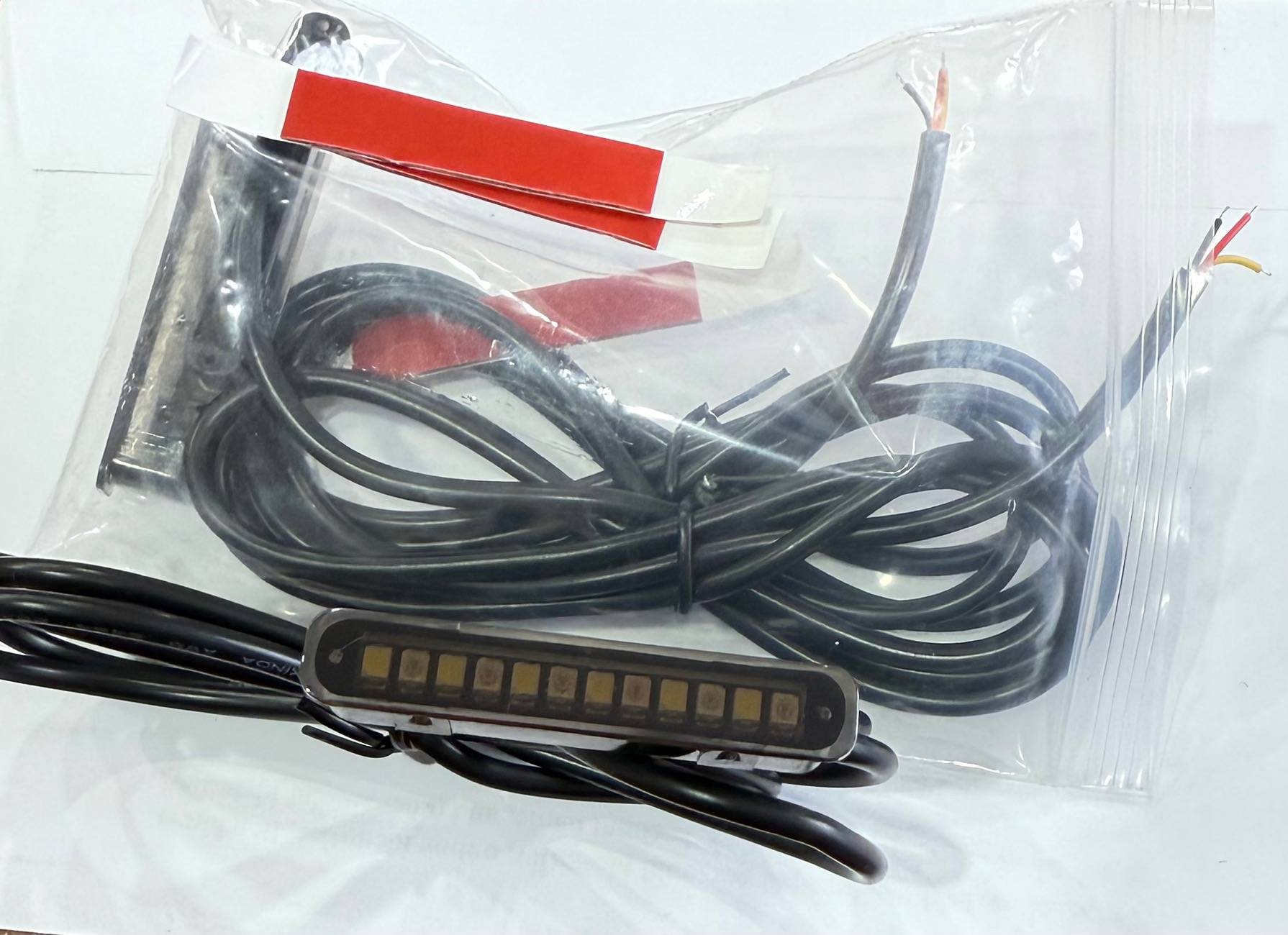

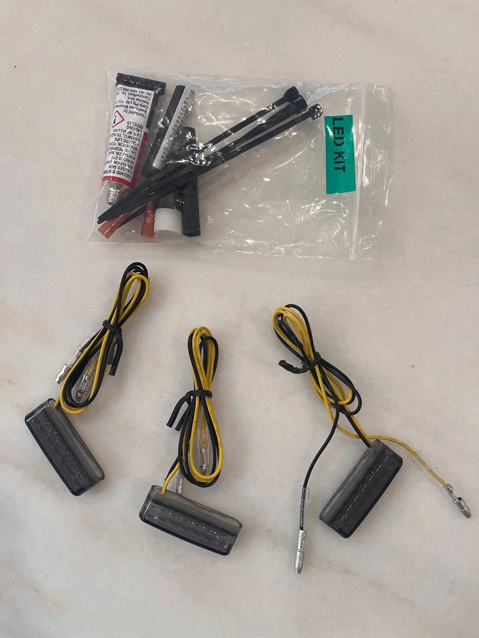

Can you share how you installed? I purchased the amber grille lights but they don’t seem long enough to reach the Aux box from the farthest point on the left. Did you connect all three wires to the aux box directly? Or do you connect them together before connecting one to the aux box? I am a newbie to this and the directions from Signature Lux are minimal at best. Any guidance would be appreciated.

I ordered the amber/clear from them but because I wasn't sure they were nice enough to send me both. I started to install the amber which are not as wide as the multicolor ones. I found that they wouldn't fit very well. The middle one went way into the back and the side one were crooked/cocked. I gave up trying to install them and used the multicolored ones instead. These were also a bit of a pain. I ended up using superglue so I could get them to stay straight. I don't think these are designed very well.
As for your question when trying the amber lights I connected the grounds together with an extension piece and then to a bolt on the frame. I also connected the yellows together and an extension so it would reach the Aux 1 wire by the battery.

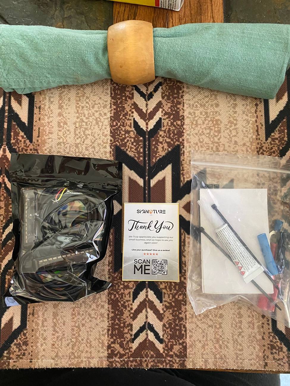

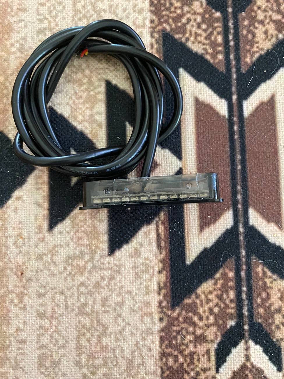

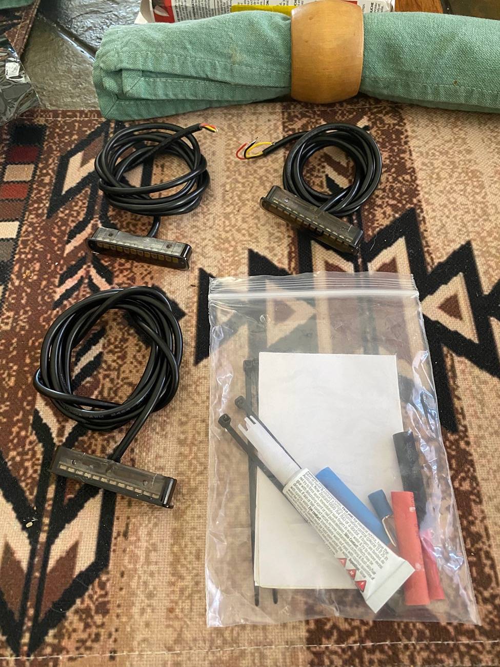

Just received mine and they look like the amber ones with the short black and yellow wires. Pretty disappointing actually. Leads aren’t long enough, wiring is cheap crap, connectors don’t match each other, no real instructions. Just some random parts thrown in a bag with a couple generic lights. I’m sure I can figure it out, but I’ll need to buy some longer wire, decent connectors, cable sheathing, some proper adhesive, etc. Maybe I missed the memo, but I didn’t get the impression I was buying a DIY hobby kit.
