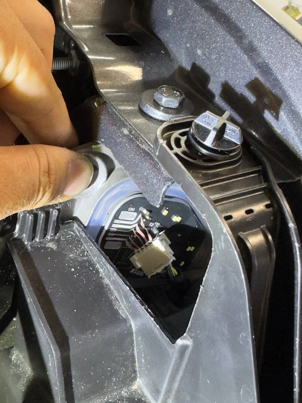

Got mine today and gave it a go, flexible extension is a must have, that is where everything turned tragic, dropped 2 of the 3 screws trying to put them back in (only found one of them) and pulled a bit too hard on the connector for the original board for the driver side... whoops. They do look amazing though cant wait to get the other side installed.
damn... thats a bummer about the clip but not the end of the world... the good thing is that it is on the module and not the truck wiring harness... it woulnd't be cheap but you could always replace it down the road if you needed to. they sure do look great. FYI, the pax side is WAY more of a pain to access the bolts from the fender but there is a lot more room to work on getting the wiring harness squared away. Nice work and great to hear that it is easier with the extension. maybe grab a magnet and fish it around in the fender to see if you can grab that screw... or just get another small one with course threads for plastic and throw that in there. Cheers

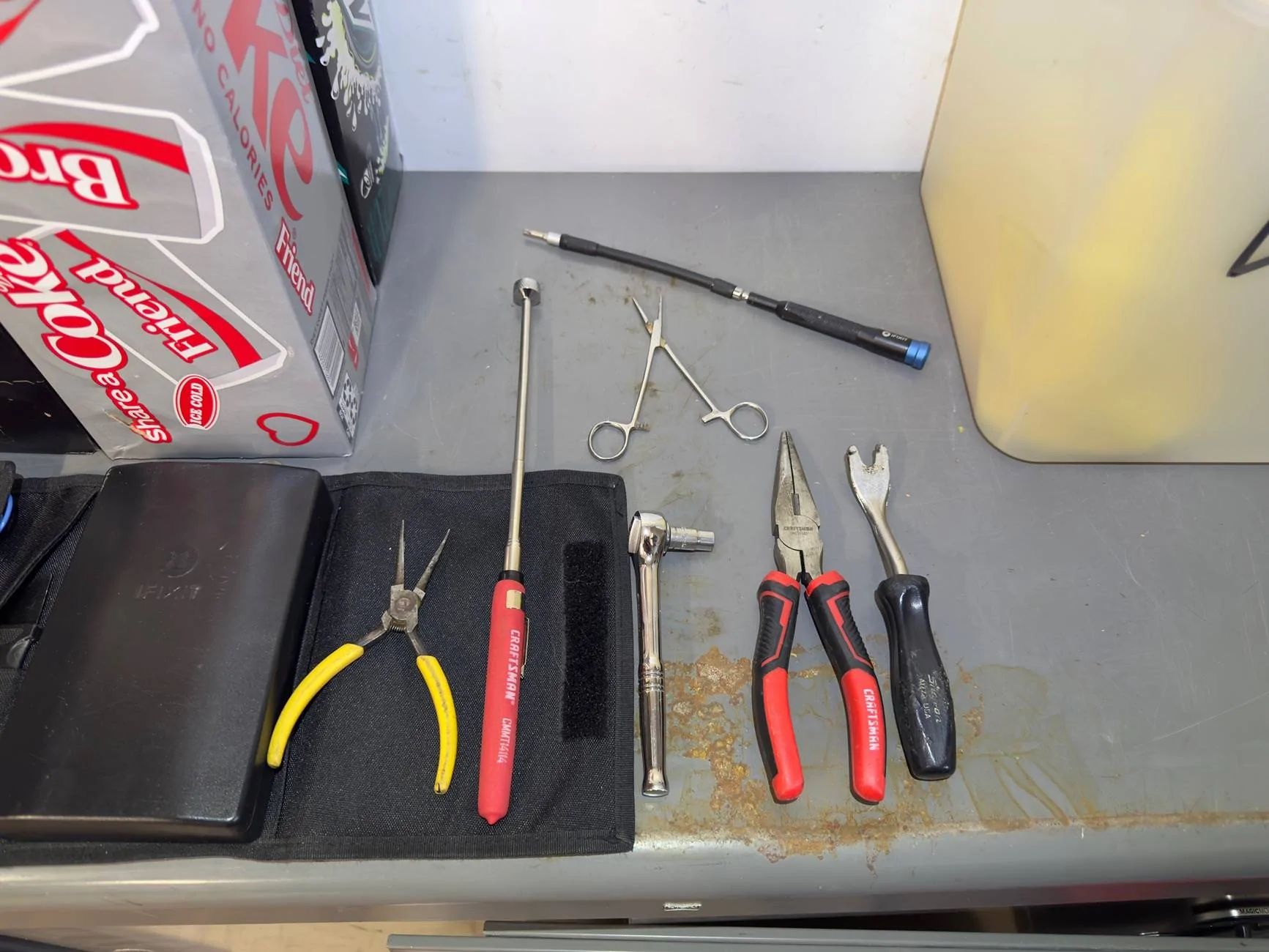

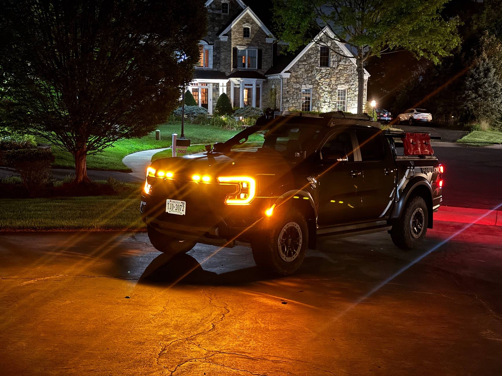

I ended up getting it out and getting everything back in place. She’s done! I took off the engine air filter box lid to get the angle that I needed for the bottom screw and was able to get in with my flexible extension. For anyone doing this in the future here are all the tools I used -
Ford Ranger Signature Lux amber (lava) daytime running lights uuid=563E774A-8AC1-45AC-9101-8F6F907506D6&code=001&library=1&type=1&mode=1&loc=true&cap=tru
The only thing I would change is having a magnetic extension for the screwdriver. The forceps are great for getting the screws in and out if you don't have a magnetic one. I wouldn't even bother trying to go through the fender liner for the passenger side. 2nd side went much better even though that bottom screw is a massive PITA.
uuid=563E774A-8AC1-45AC-9101-8F6F907506D6&code=001&library=1&type=1&mode=1&loc=true&cap=true.jpeg

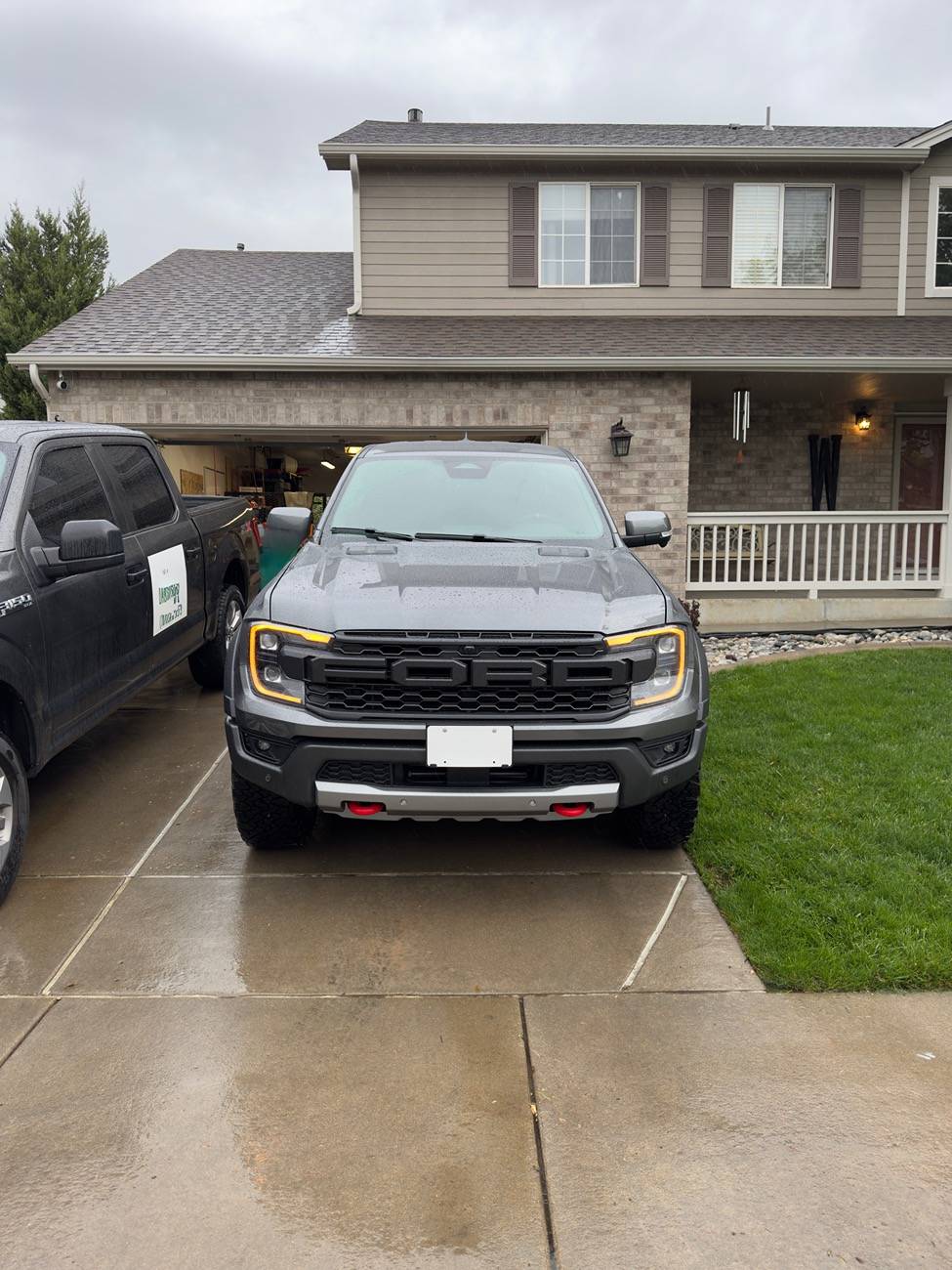

Looks great, would you share a daytime pic please ?
Dude... well done! I am going to buy a set of forceps to keep in my tool box! i didn't even think of that. Great note about taking the air box cover off! i didn't even think of that when i was doing it because it was getting dark and i wasn't thinking straight but i will keep that in my back pocket for when i help out other dudes and dudettes with this mod! Cheers and congrats on the sweet amber running lights!

I got them installed and it was a serious pain to get to some of the screws… wish I had the flexible 1/4” extension. Looks freaking rad! Gonna edit the install video and post tomorrow but here’s a preview!
