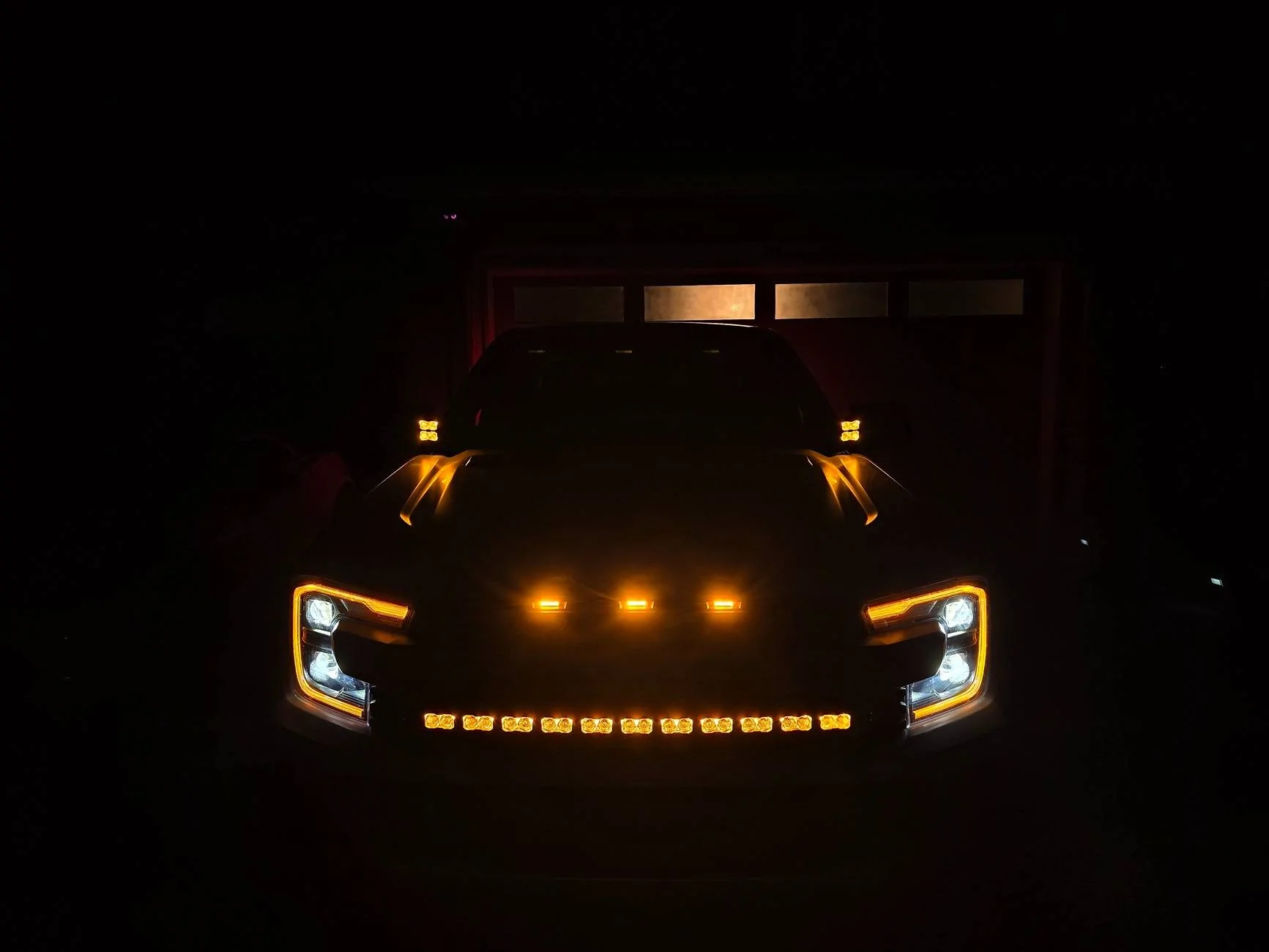

I like the look, wondering if anyone make the 3 amber marker lights that are the same hue as the drl & light bar?
Is your lightbar all amber or is it one thats switchable to white?
The amber markers I'm running are signature lux ones as well.
As for the light bar and ditch lights, they're M&R pro. The main lights on both are actually white. What you're seeing is both of them running the amber / DRL mode.
Clear on that thanks. My Rigid ditch lights had same feature.

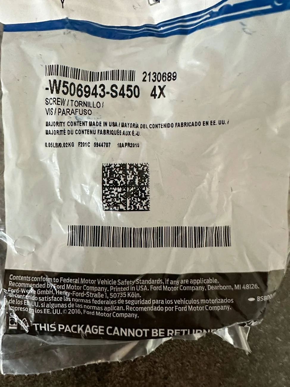

For anyone else who dropped and lost one of the three T15 screws holding the module in place, I can confirm these are the correct part to replace them lol..
