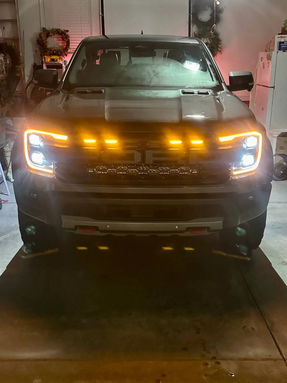

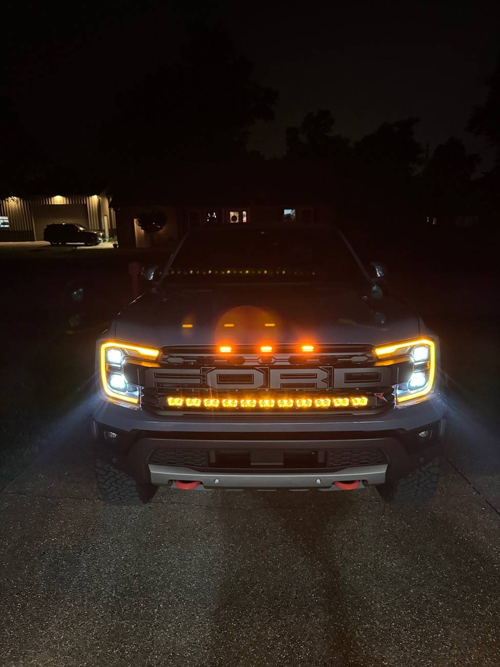

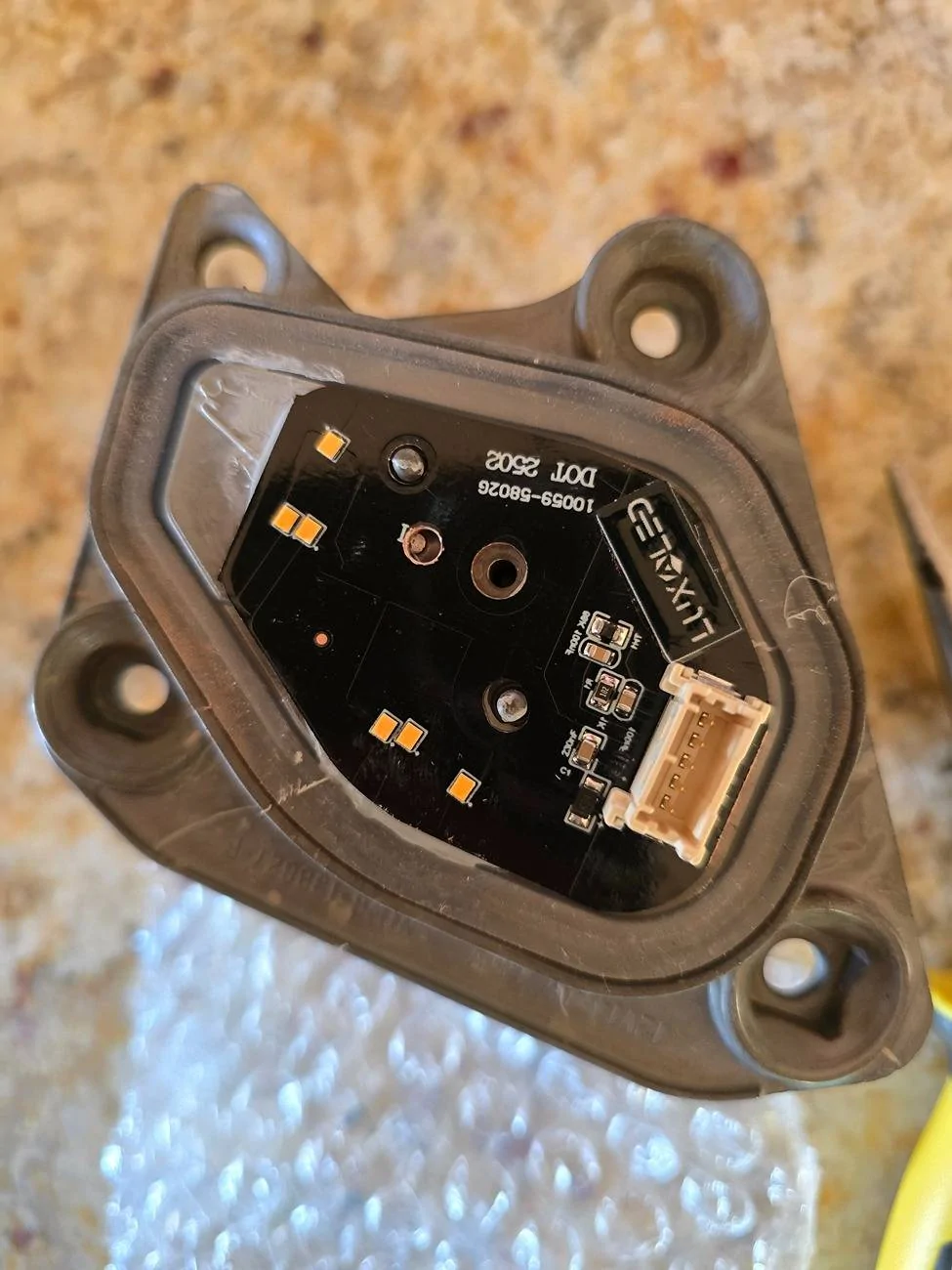

Painful but the fender move helped. Only one side done so far and my board is still copper but the extra hole was mis-drilled and just misaligned enough ....and I'm a little disappointed that I had to break the OEM alignment pin.
The other side didn't have that problem, the holes accommodated the guide pins, but were a little 'too' big. So, even with the screw turned all the way in, you could still slide the board around a bit.
Either way, it works, and I like the look. Pardon the dirty PPF on the headlights - haven't really cleaned since Moab lol.

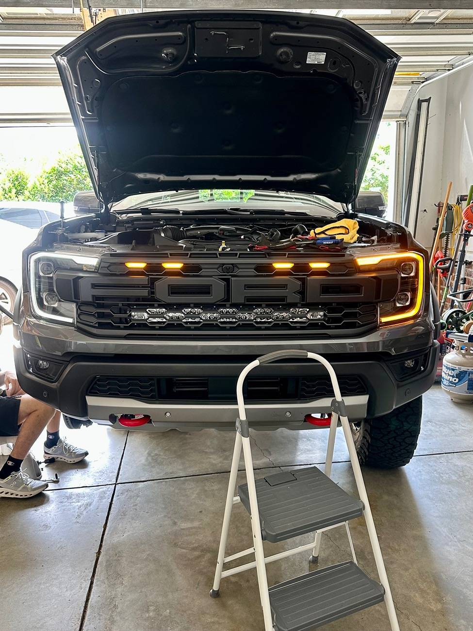

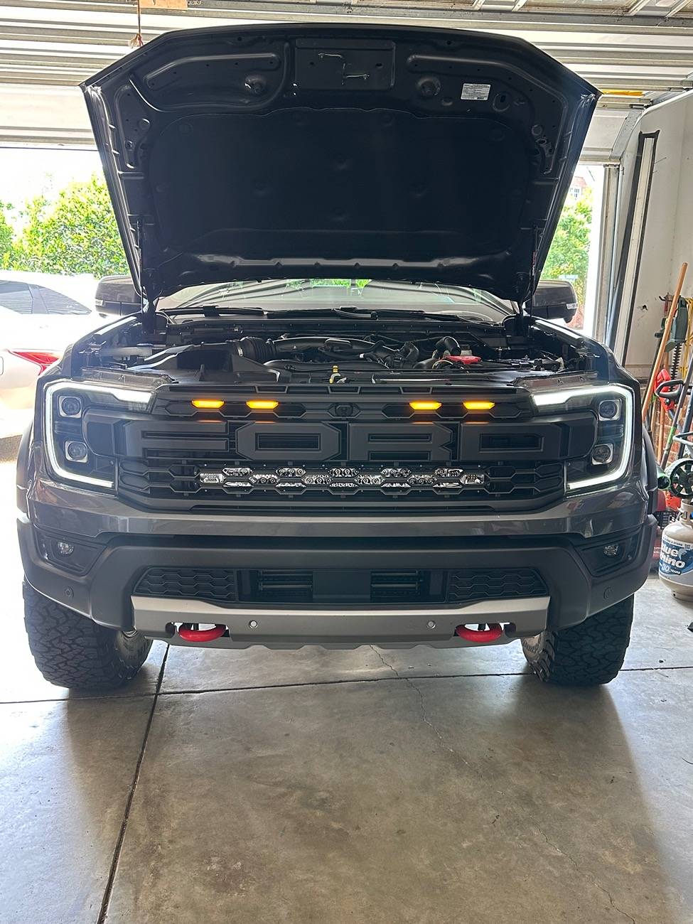

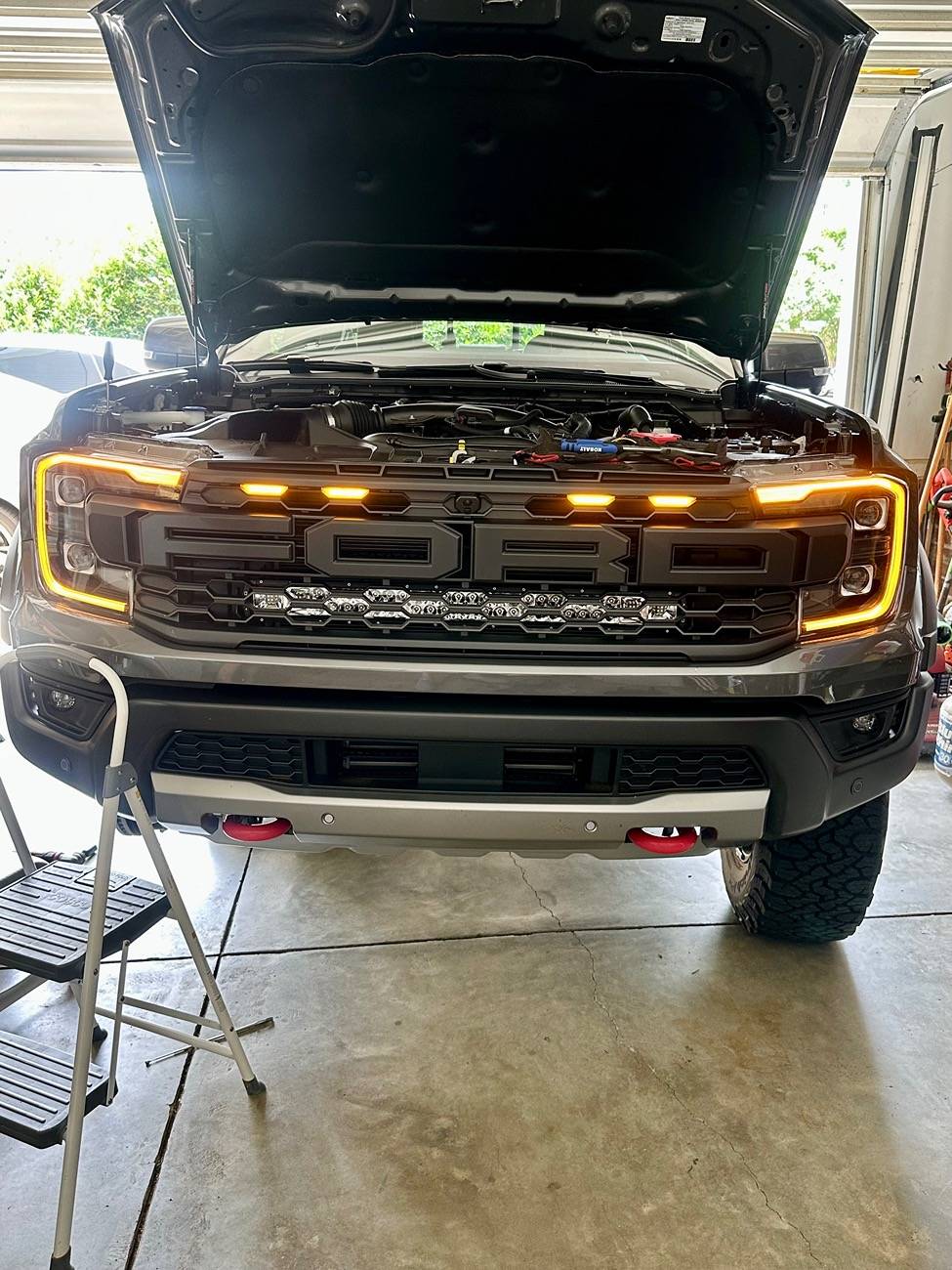

Figured I’d start working on installing the lights this evening. Took me about 5 hrs. I have the updated version, holes all lined up perfect. Only issue I had was the top screw, that was probably over 2 hrs itself combined for both sides. They look great, especially with the M&R light bar on.

Congrats @JrHDRanger...
What was your top screws challenge?
Remove tires?
The top screw on the module was slow to remove. On the drivers side I was able to just get the tip of my thumb in and finish unscrewing it when it was halfway out, so that was a big win after doing passenger side first. I pulled the tires and the horns, but there isn’t much space to work with. Glad it’s done. I saved the original modules, but I don’t plan on having to do that again.

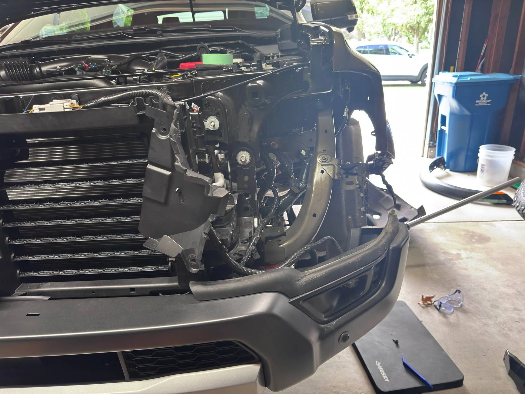

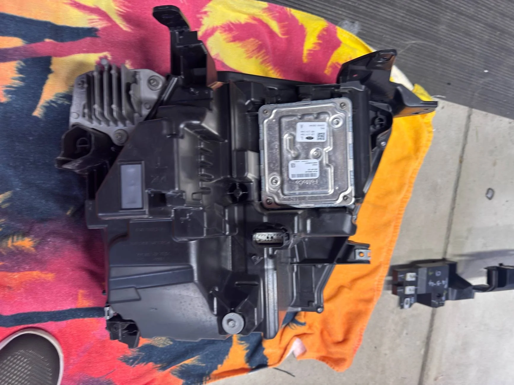

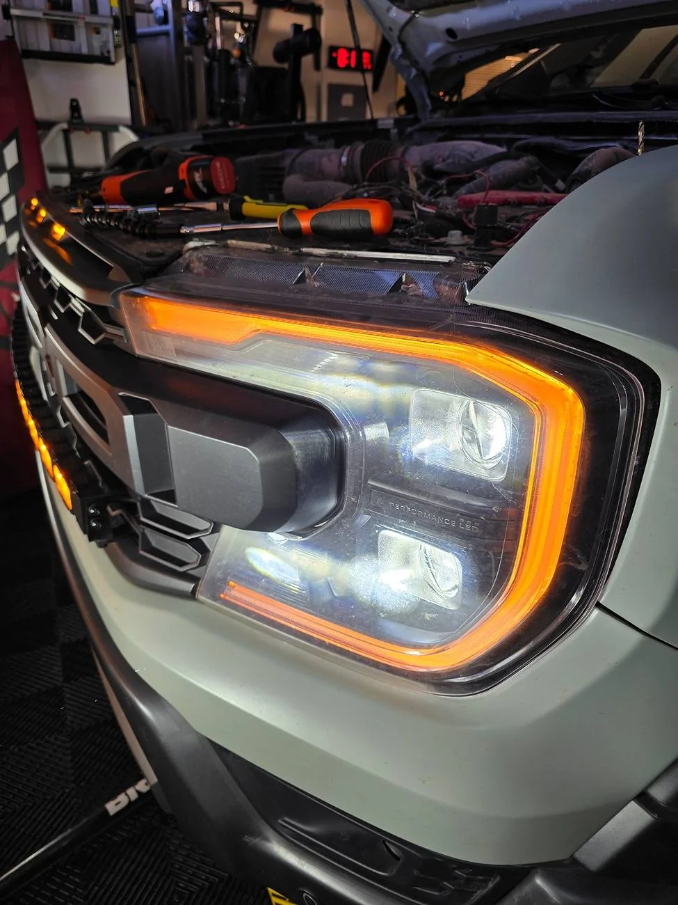

Reading everyone struggling with this, I just pulled the headlights out, was it quite a bit of work yea, but not to bad.
worst part is having to remove the fenders
How long did that take to remove per side from the start?
