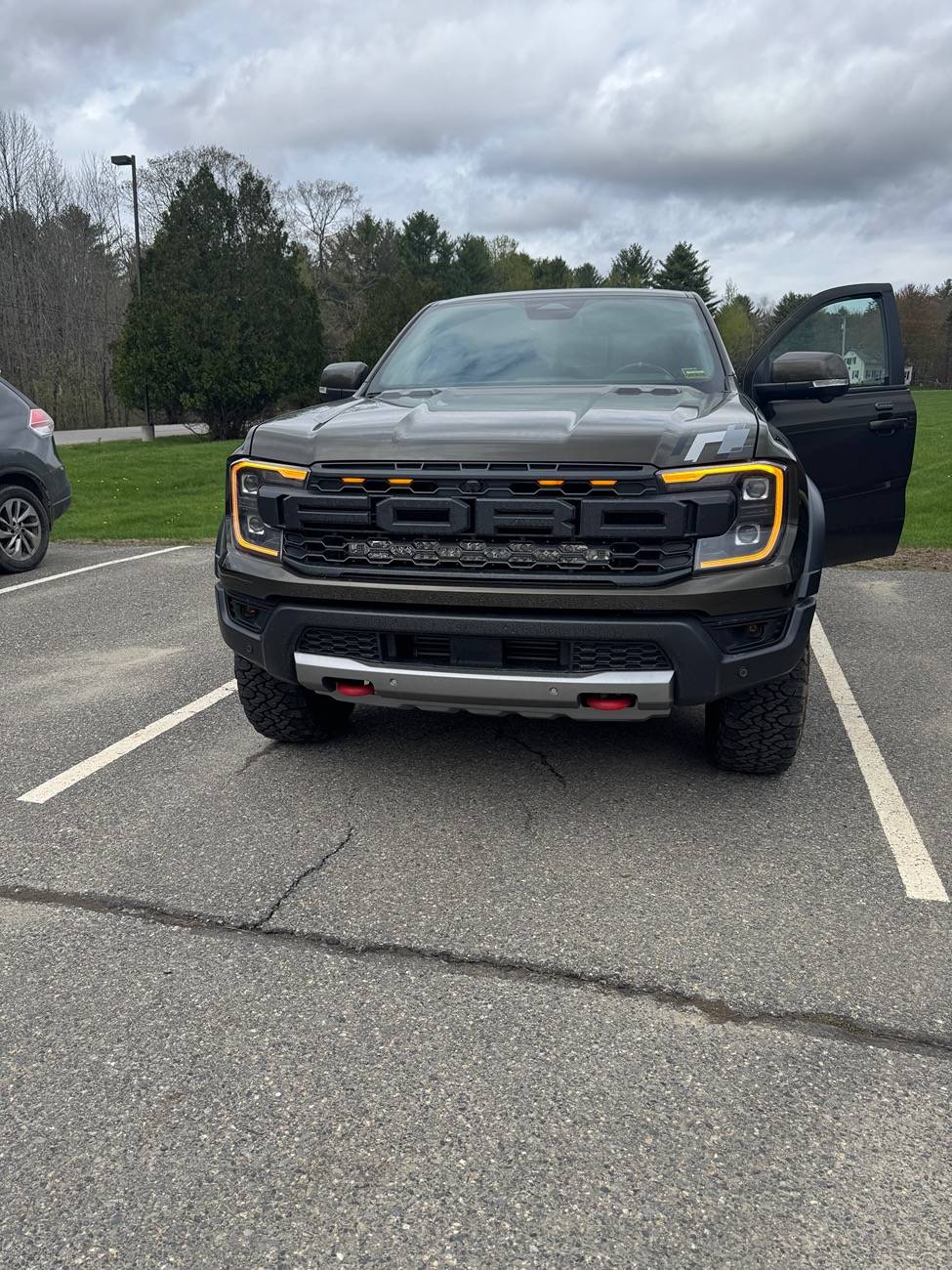

On a different note. Your reassembly video that just posted was helpful. My bumper and fenders are misaligned. Now that I see how that black flat piece with the 3 threaded bolt holes goes between the 2, I think I’ll make a go of trying to adjust everything. Looked like a frustrating process. I did get a laugh from a couple of your “oh sh@t” comments out of the blue though. Definitely won’t be going that route when my lights show up.
Awesome, getting that fender flair off was a bit of a bear for sure but I think you will be able to get it back together and looking mint if you give it a shot for sure! I was going to edit out the frustrating moments but I wanted to share my plight with the world hahaha. Cheers

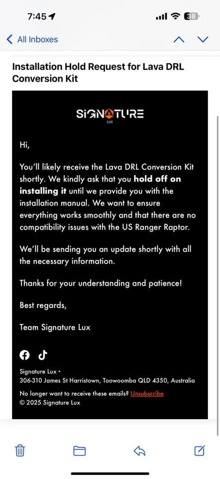

However, still concerned about the comment underneath the video about them not working the way they should when the truck is running (but not remote started)... And this other comment on the FB group that seems to hint at the same thing:
DO NOT BUY THE SIGNATURE LUX Lava DRL conversion!! It does not work on US trucks and requires permanent modification of your headlights.
I bought the kit and had to remove a locating pin from the heatsink to get the new boards mounted. When the truck is running, they do not work but they work when the truck is unlocked and remote started."
And this other comment on the same FB ranger raptor group thread saying they sent out an install hold request (see attached picture)
https://www.facebook.com/share/p/19UXqv9adX/
Not saying I agree with the do not buy comment, because I'm definitely thinking about it.
I think this has been addressed. I installed mine and no need to remove pin.

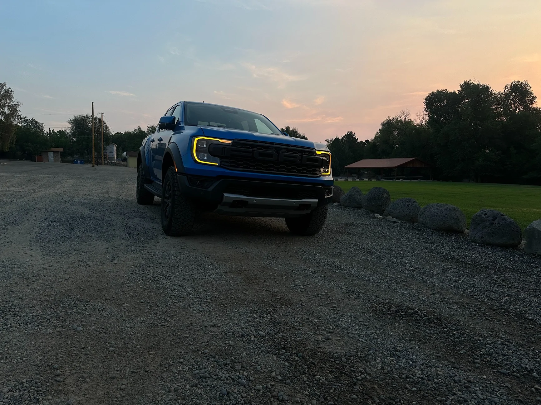

Just did mine last night, it turned out to be a bit easier than expected and I love the look just missing some marker lights now
They do look good! If you don’t already know this have someone get in your truck, start it up and put the truck in drive, reverse or neutral while you stand outside your truck and admire. They really light up then!!!
If you already knew this, never mind.😁
Btw, Sig Lux amber grill lights look great and super easy to install.

haha yeah I just been put in remote start and admiring it that way 🤣 I was going to pull the trigger on them but wanted to see how it would look without them and now I regret not just buying everything at once haha😭
