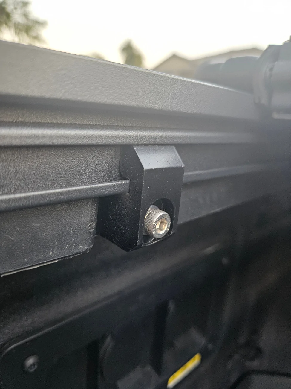

My idea is Lomax has nice bolt in clamps for their tonneau cover (not C-clamp design) and they also sell just the clamps. Now I’m wonder if the Lomax clamps would work with the Leer rails? What worries me is the change in bed cap height may affect the tonneau rails height and in turn the clamps.

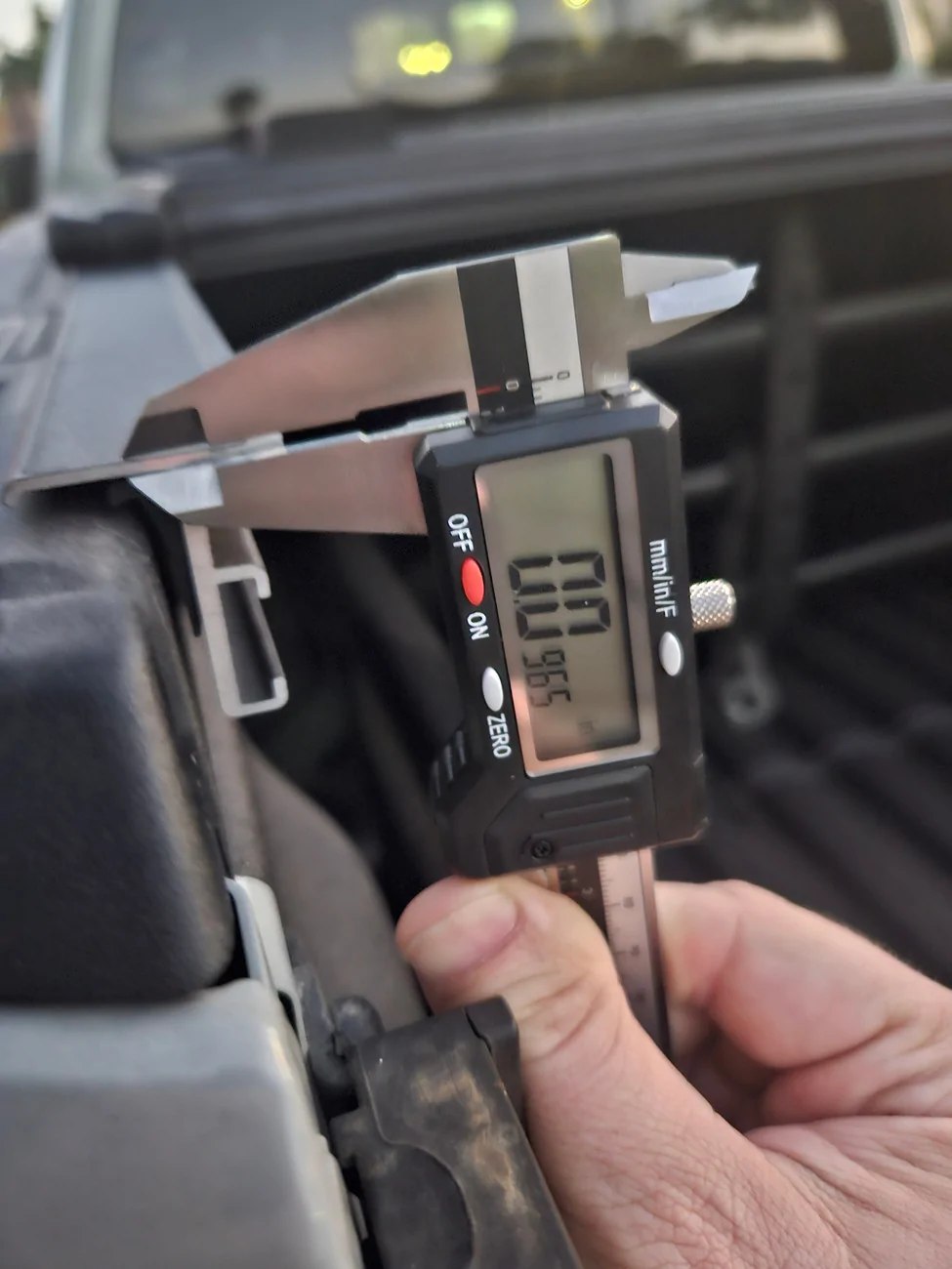

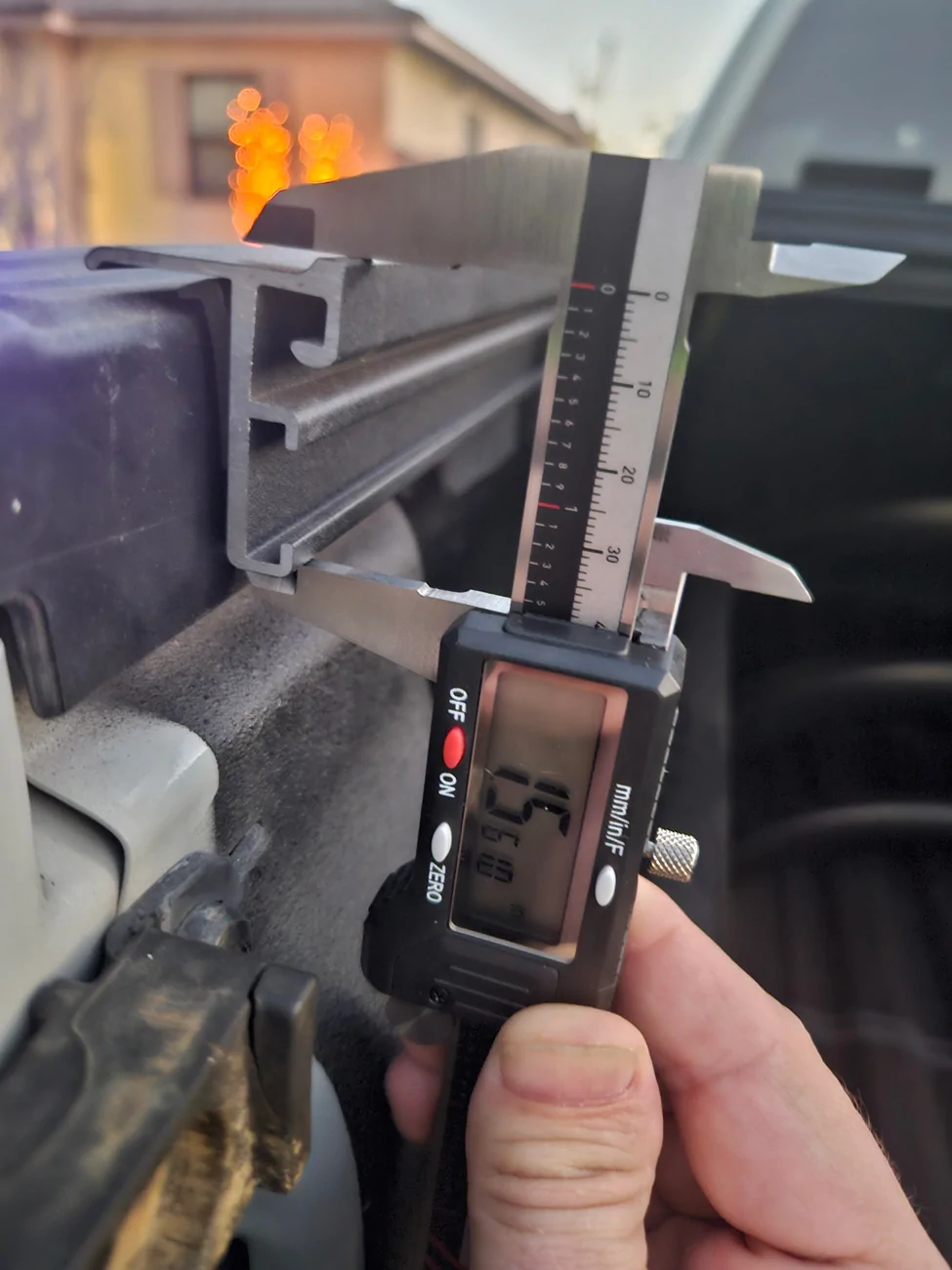

Here's a couple measurements off my HF650M rail.
Looks like about 1+9/16" total height. Inside pocket is about 1+7/16“

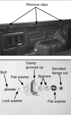

Thanks much for the measurements. Wondering about the clamp design you mentioned are they the L shape bolted in or C clamp design?
With those rails from the picture being C like I worry that the L designed brackets would not work.
I did try reaching out to RealTruck and got: For this particular tonneau cover, you'll want to reach out to the manufacturer directly.
Leer has been a joke to get an answer from, told fix in a week, a month, few moths, keep checking Since March!
Yet: RealTruck officially acquired LEER Group (along with brands SnugTop, Century, Pace Edwards, and StateWide Windows) from JB Poindexter & Co. in August 2026.
L brackets being like this

Err, you're correct, the HF650 are a different shape. They're not quite C's, but they definitely are different than the MX4... I must've misremembered.

It seems like the Lomax clamps rely on small groves to secure to the bed rails while the Leer relies on a one large channel.
