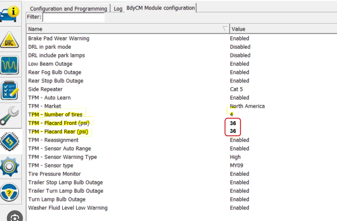

I was playing around with FORScan settings to lower the TPM Placard values for the TPMS. Essentially, 39 psi on the Raptor is too high so I wanted to set it closer to the "chalk test" 36 psi. I know the rear is really closer to 34 unloaded but for now am keeping it 36/36 for simplicity.
Anyway... I set both the front and rear as follows:
BdyCM 726 TPM - Placard Pressure Front, psi 36 726-10-01​
BdyCM 726 TPM - Placard Pressure Rear, psi 36 726-10-01​

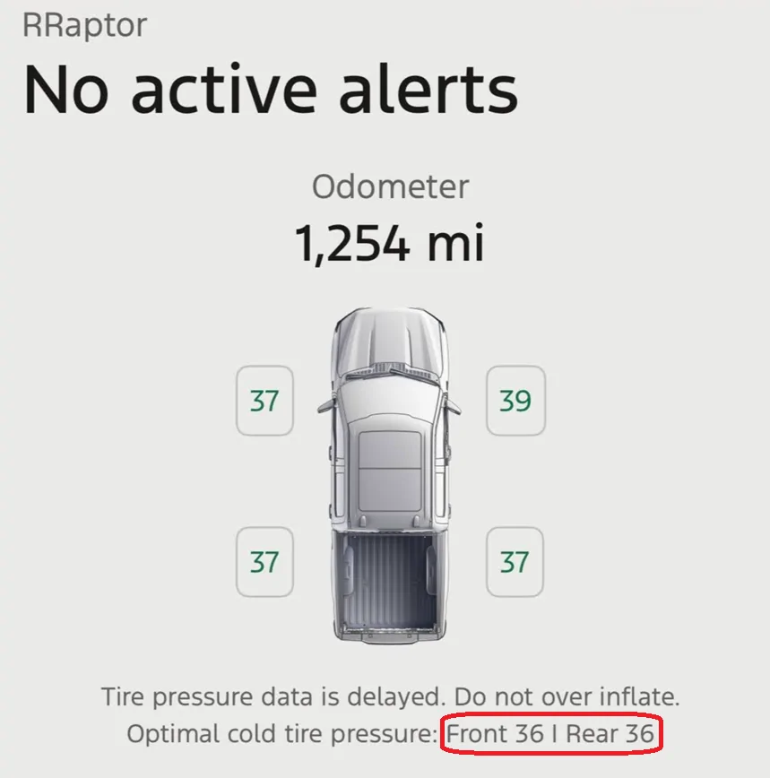

What I wasn't expecting is that the Ford App optimal pressures also followed that setting.

It was as simple as going into the BdyCM menu (non-as built) and setting the two Placard Pressure entries to what I wanted. Write the module and reset it. Simple as that.
