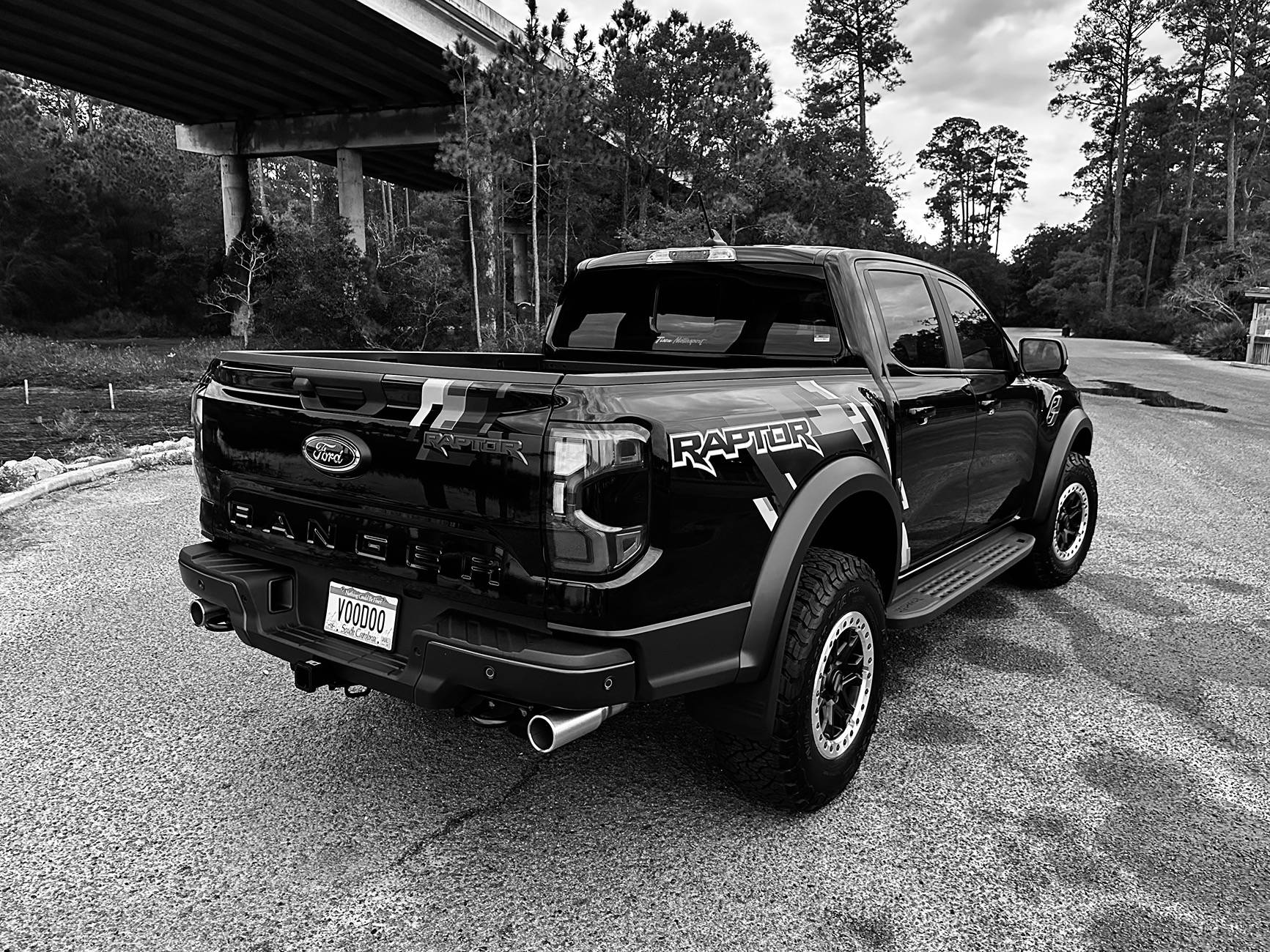

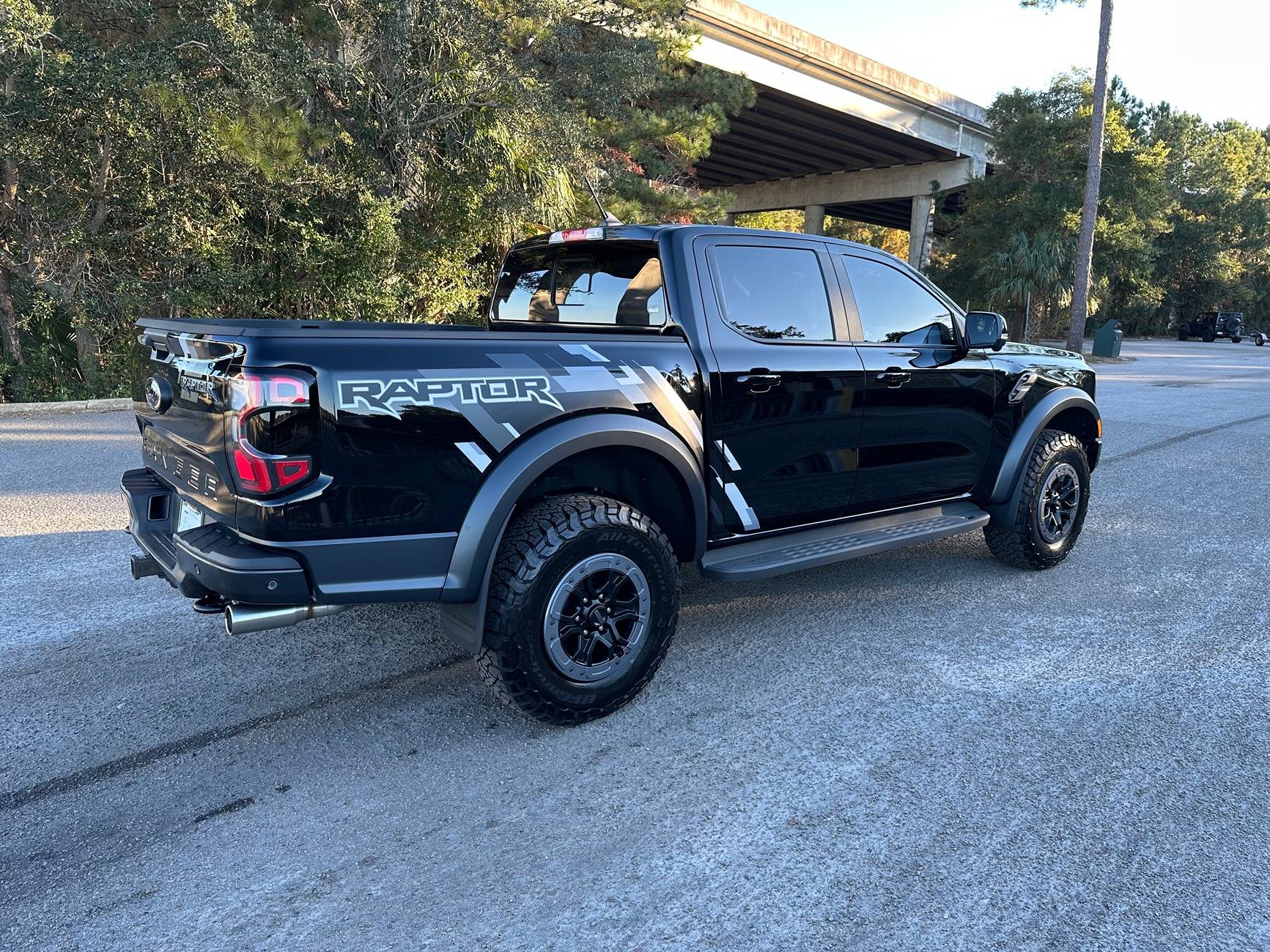

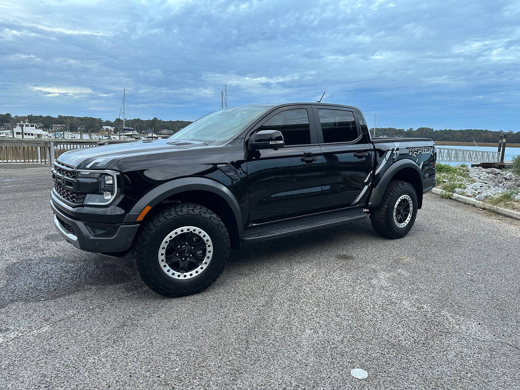

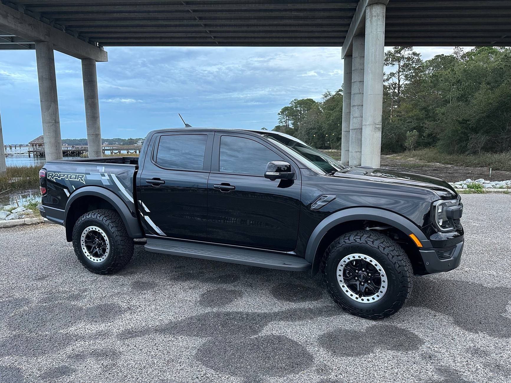

I finally had a chance to install the Ford Performance functional beadlock rings.
My wife bought them for me during the Black Friday sales on the Ford.com website.
Ford had 25% off on the website for Black Friday, M-1021-F15RB, normally $225 each, with the 25% off they were $168.75 each.
We used the Ford Pass points from her 2024 Bronco Wildtrak and bought 2 rings, and then used the points for my 2024 Ranger Raptor and bought the other 2 rings, we spent $300 bucks for all for rings!
I love the way the wheels look with functional rings!! Took a few before and after pics.
Ford Ranger Ford Performance functional beadlock rings finally installed! IMG_3977
Ford Ranger Ford Performance functional beadlock rings finally installed! IMG_3979
Ford Ranger Ford Performance functional beadlock rings finally installed! IMG_3993
Ford Ranger Ford Performance functional beadlock rings finally installed! IMG_3996
Ford Ranger Ford Performance functional beadlock rings finally installed! IMG_4028

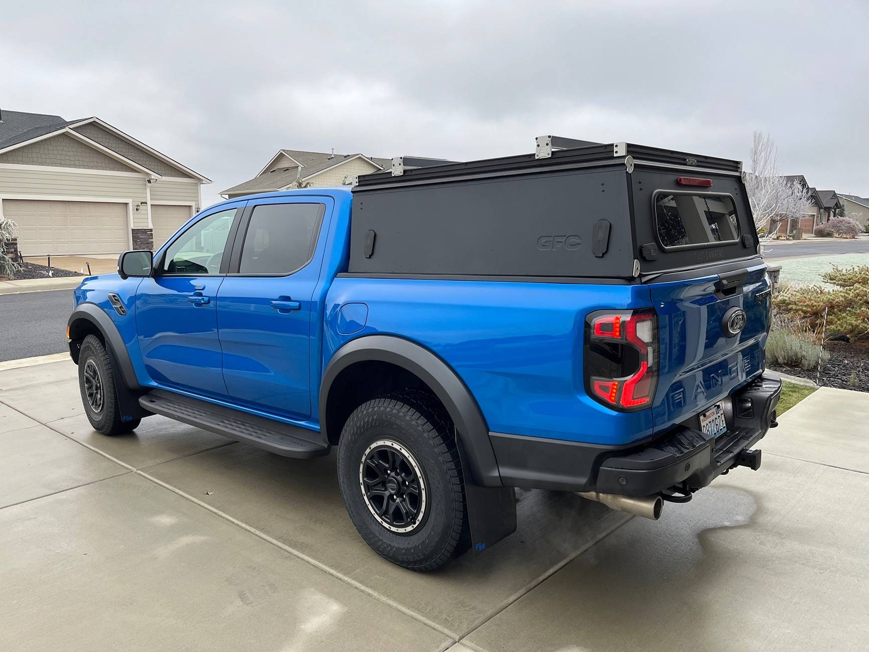

My local Discount Trie store really doesn’t like true beadlocks , I had them mount snow tires on my BLC wheels (with the decorative trim rings removed) and they actually asked about them. Here is mine with no rings at all, the look is very similar to yours. I did not bother to paint the circumference where the rings were, these wheels will get beat up if I install chains….
Ford Ranger Ford Performance functional beadlock rings finally installed! IMG_8199

How did they balance them without the beauty rings?
???? Removing the rings doesn’t affect balance, and the wheel weights go on the inside of the rims. Each ring and its hardware weigh almost five pounds, I chose to not deal with that much extra unsprung weight. I hate beadlocks, if you don’t need to air WAY down, they are just bling IMHO, and a long term maintenance nightmare..
