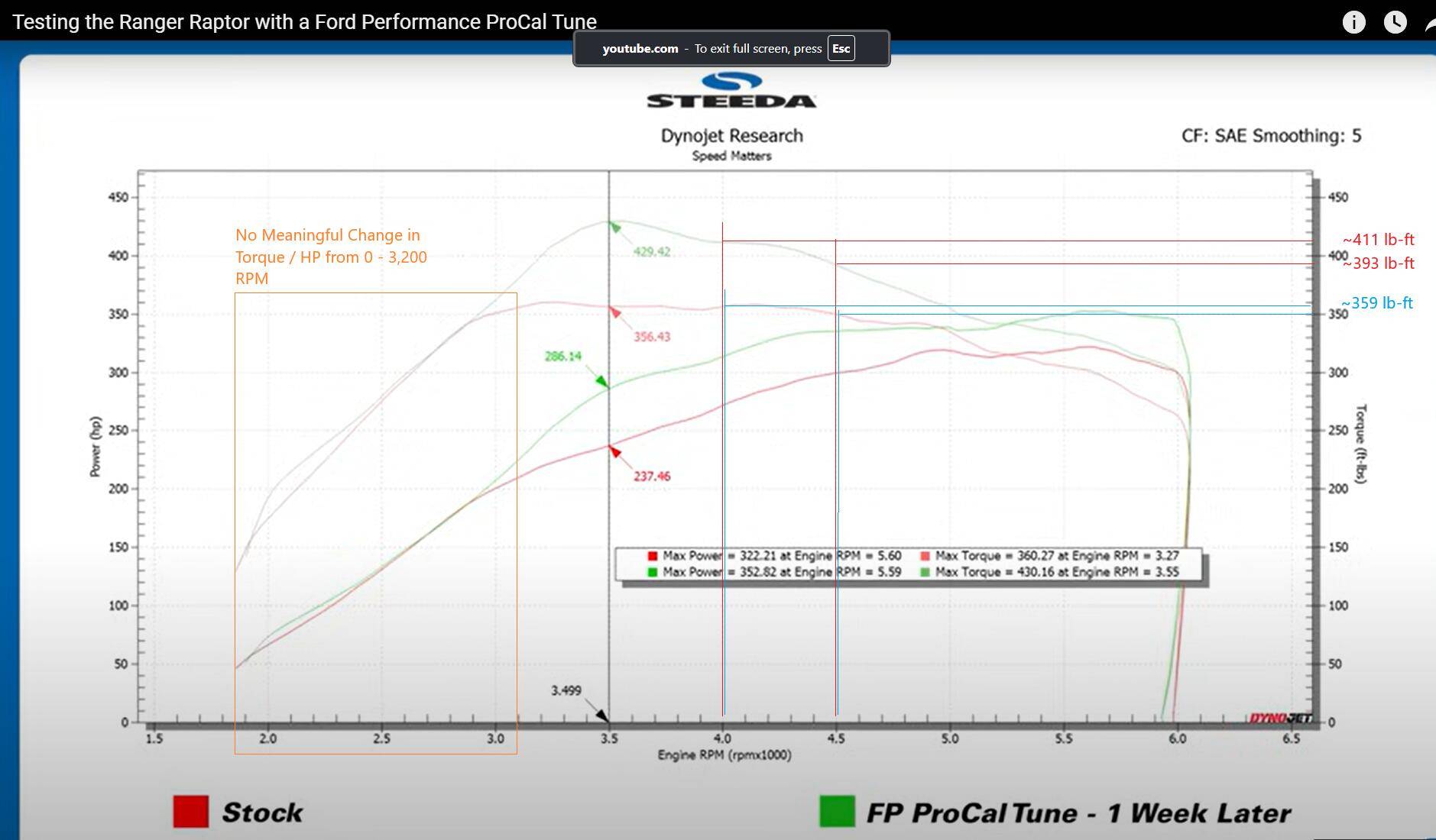

Looking at this real dyno graph from Steeda of their test rig 2024 RR, before the Pro Cal (stock) and after the Learn function on the Pro Cal had a week+ to "learn", you can see this reality:
And even up in the power band, as far as 3.0L output torque...it's about only 59 lb-ft difference from stock at the crank (using 14% drive train loss to back-calculate from WTQ to Crank TQ). 468 lb-ft vs. 409 lb-ft @ 4k RPM or 448 lb-ft vs. 409 lb-ft @ 4.5k RPM.
