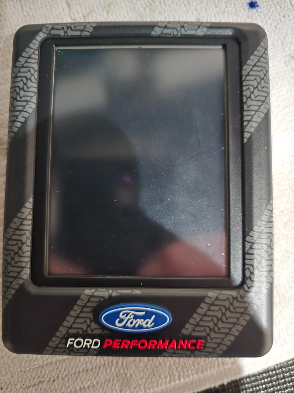

You should have a computer that comes with ProCal.
Ford Ranger Ford Procal Tune 20250815_065239
