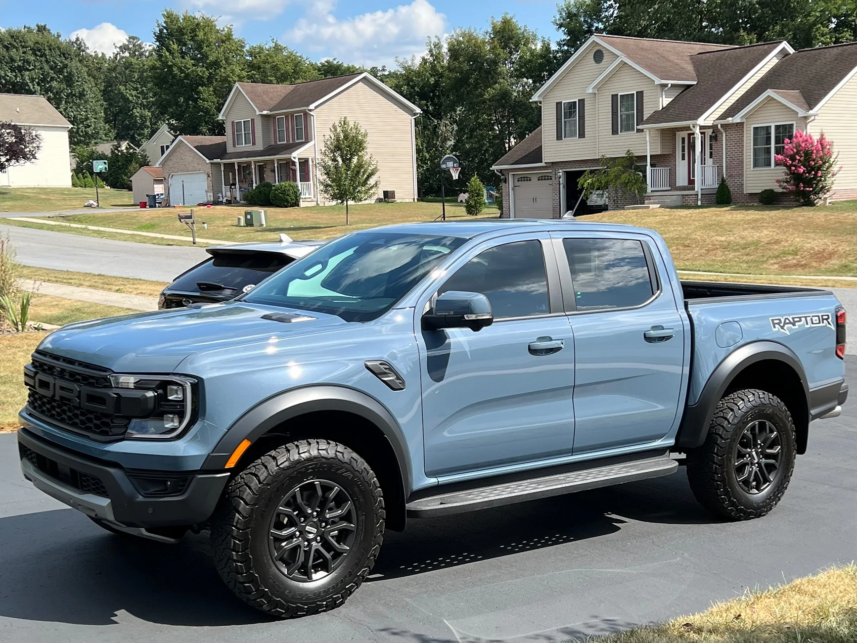

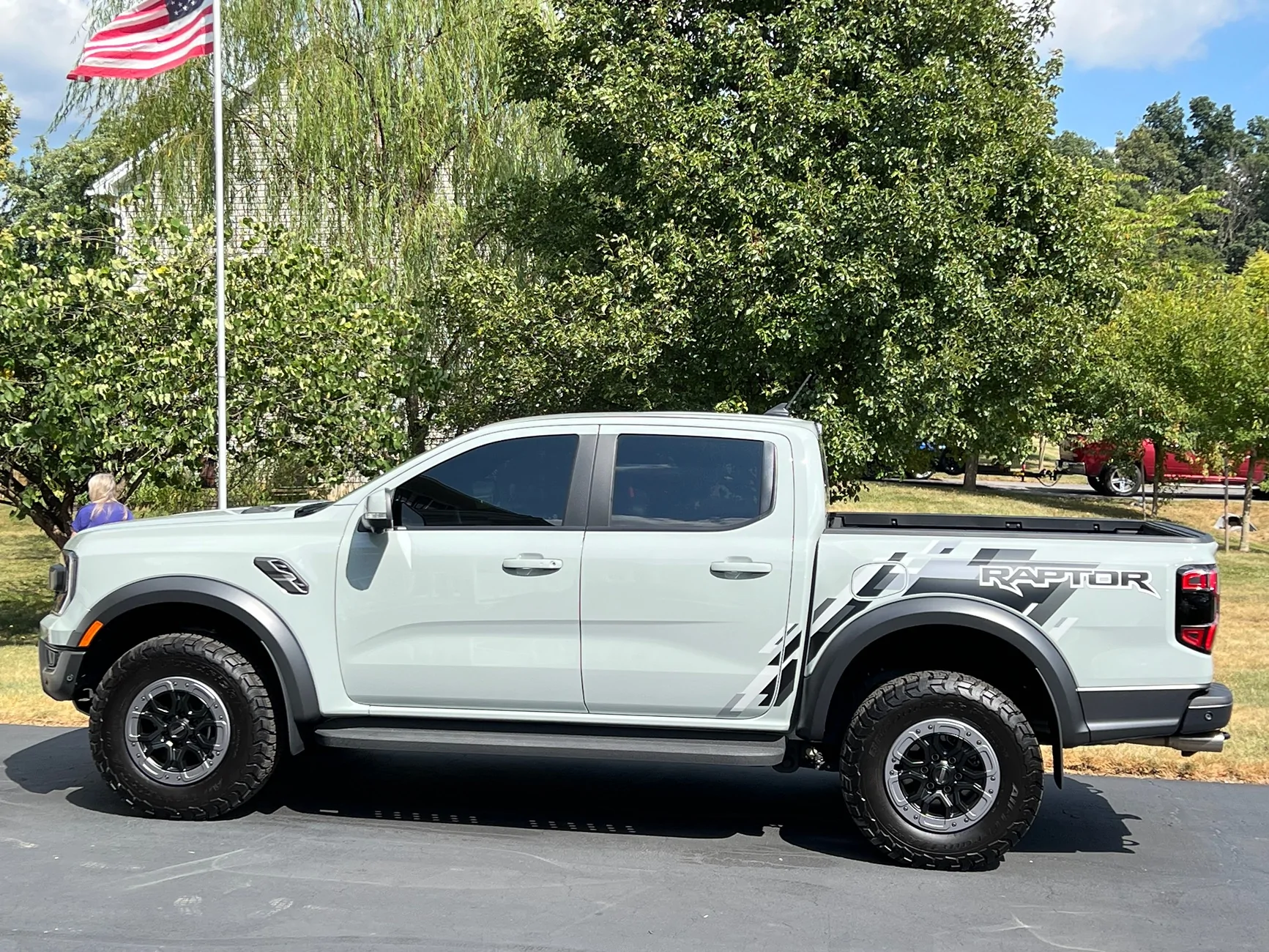

My 24 RR is stock and the wife’s has the procal tune. Full torque and horsepower is all modes and is very different than my stock RR. The difference is amazing and initially you need to take it easy as the power and torque gradually come in within a few miles. Her Azure gray has not lost any fuel mileage, albeit that’s not what you buy them for. 😎 it does help shifting as well. Mine is a daily driver to work locally and makes a weekly trip to DC for work. I do enjoy driving hers for the performance difference. Highly recommend the money spent for it and only drawback is premium fuel, which we use in our vehicles anyway.
