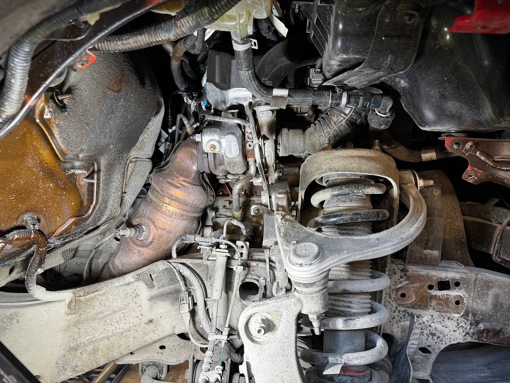

they are also extremely easy access so it should be a easy job.
Here’s a pic of how easy you reach them when removing the inner moldings in the front… pics from when I swapped springs.
Two bolts on top two in the bottom

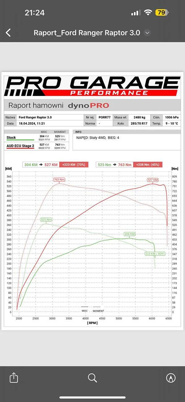

527 hp, 763 Nm 👍🏼
Last dyno results.

For now, 527 hp, 763 Nm, but it will be better soon🙂
We are already better than Herods Performance and Hennessey Performance, they have 500 hp and 750 Nm.

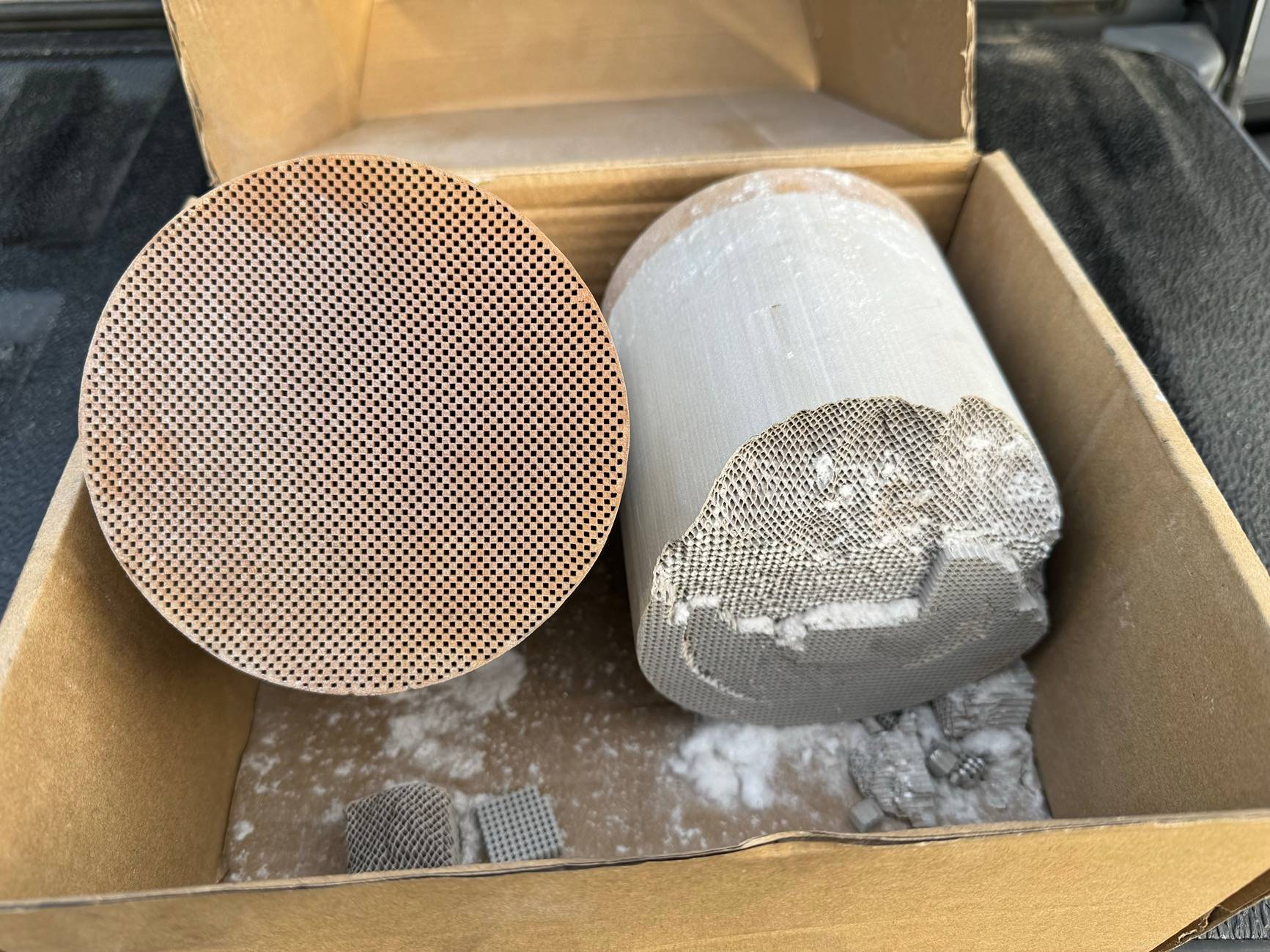

I forgot, I also removed the GPF filter, of course, and left the factory catalytic converter. The ECU programs are created by BPT, I also removed the factory speed lock to 188 km/h
