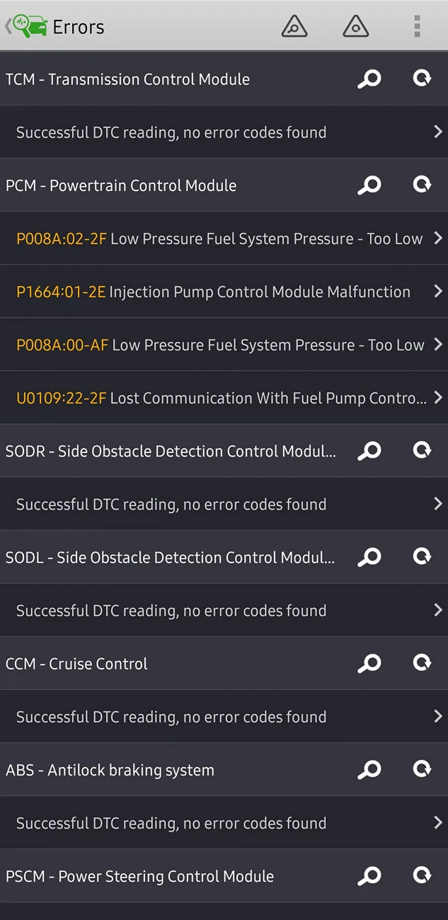

Has anyone had this issue with their Ranger 6G yet?
Or any of these codes before?
I was in the middle of the bush and my engine kept cutting out. I fiddled with the harness going to fuel pump on the tank and it somehow came back to life.
It again died on me this time on high speed main roads. Just managed to pull off the side and nothing I did would bring it back again. got it towed home.

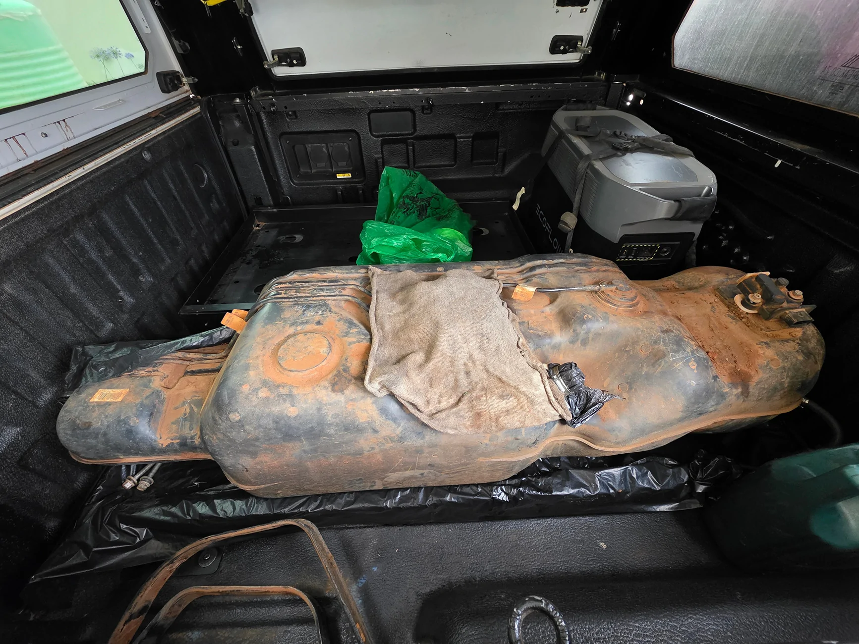

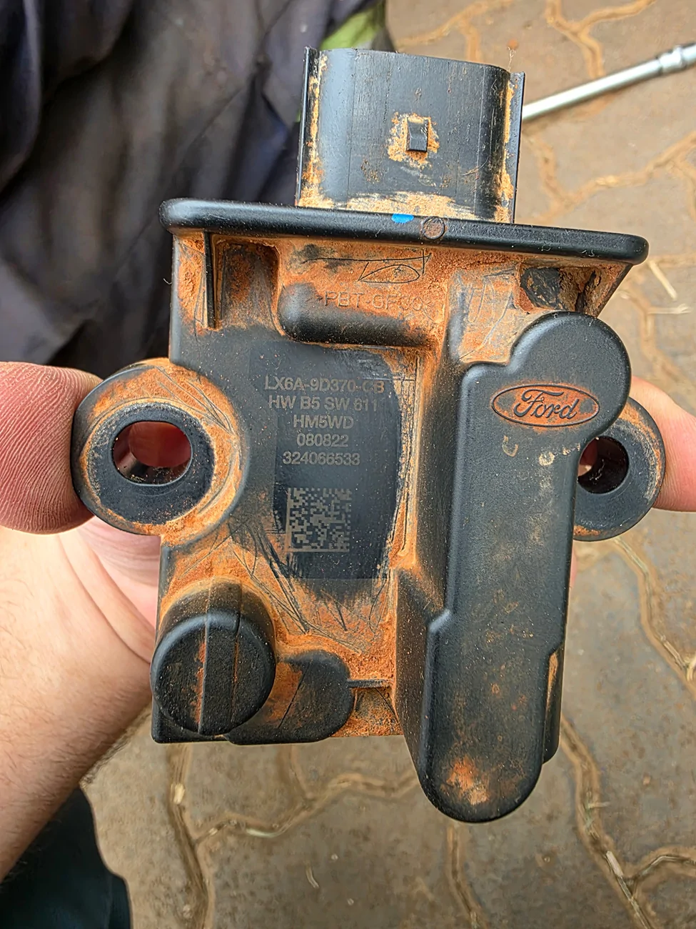

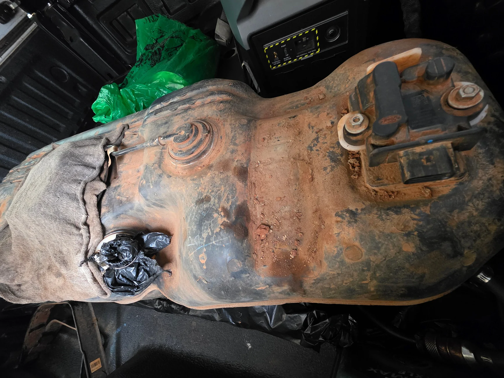

Dropped the tank and found an additional control module separate from the fuel pump. It seems this module had some corrosion on the pins and was making inconsistent contact with the harness plug. I believe this module is a power module for the fuel pump. Without it being proper connected what I experienced would make sense.
Cleaning the contacts, bending the pins slightly, made it connect properly now and the fuel pump is pumping fuel again normally.
Anyone else had fuel / fuel pump / fuel component related issues?
See picture of my tank and the module I talk of. Why would it be corroded or not making good contact? Those plugs seem robust.

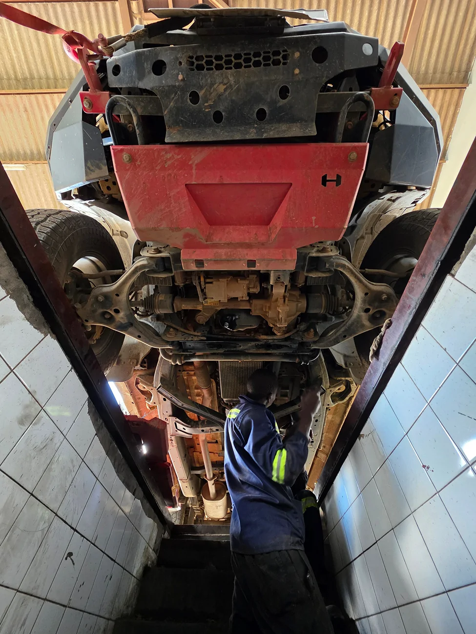

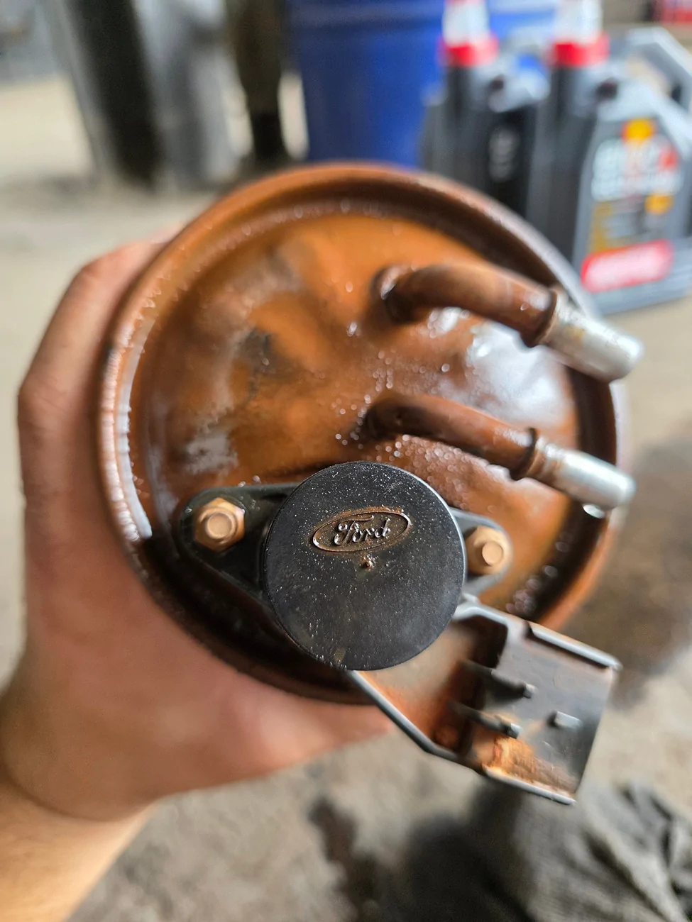

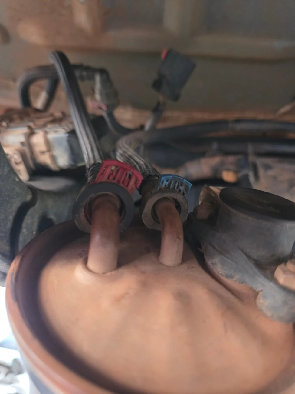

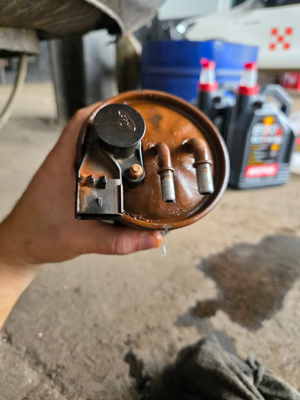

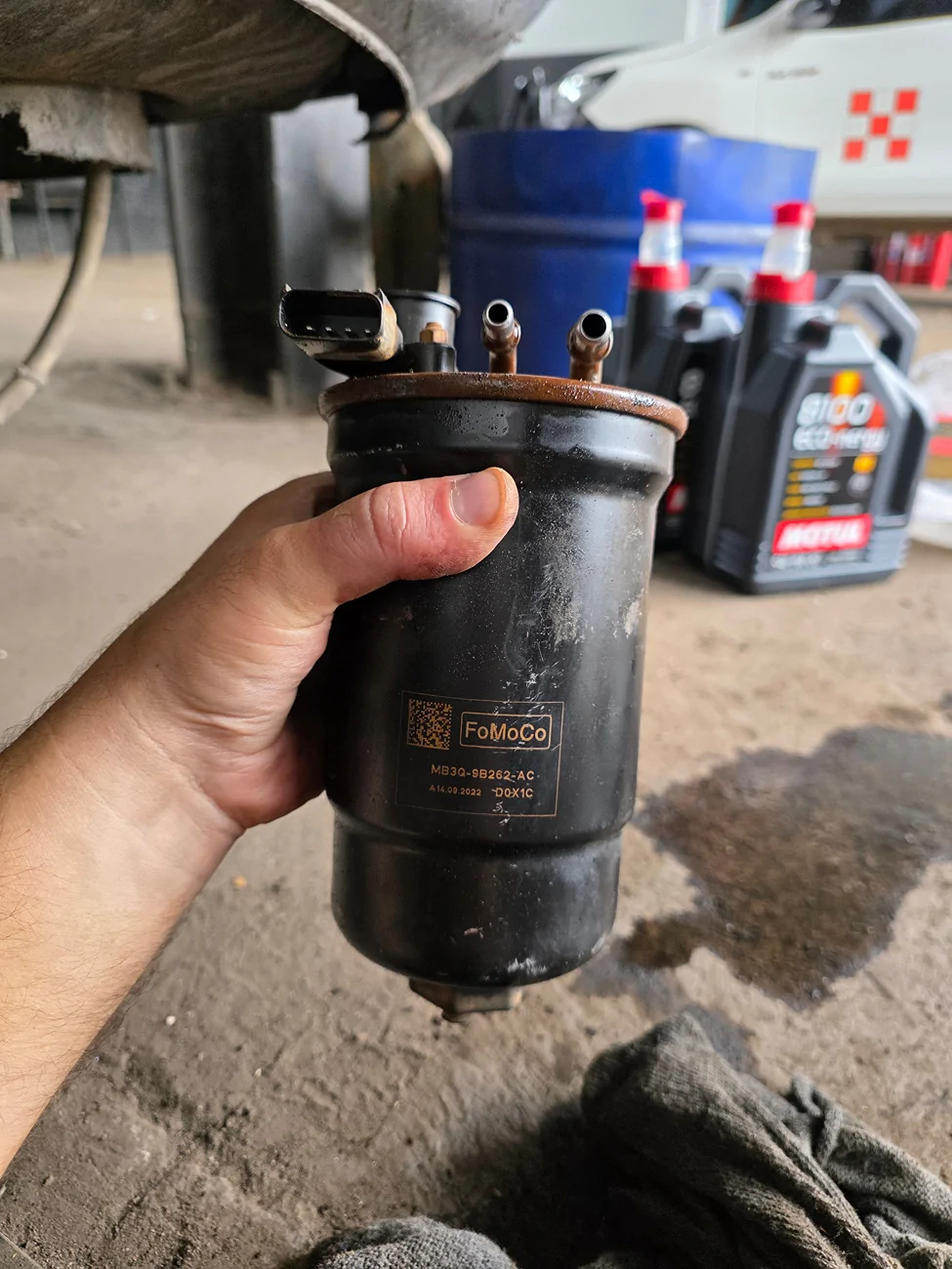

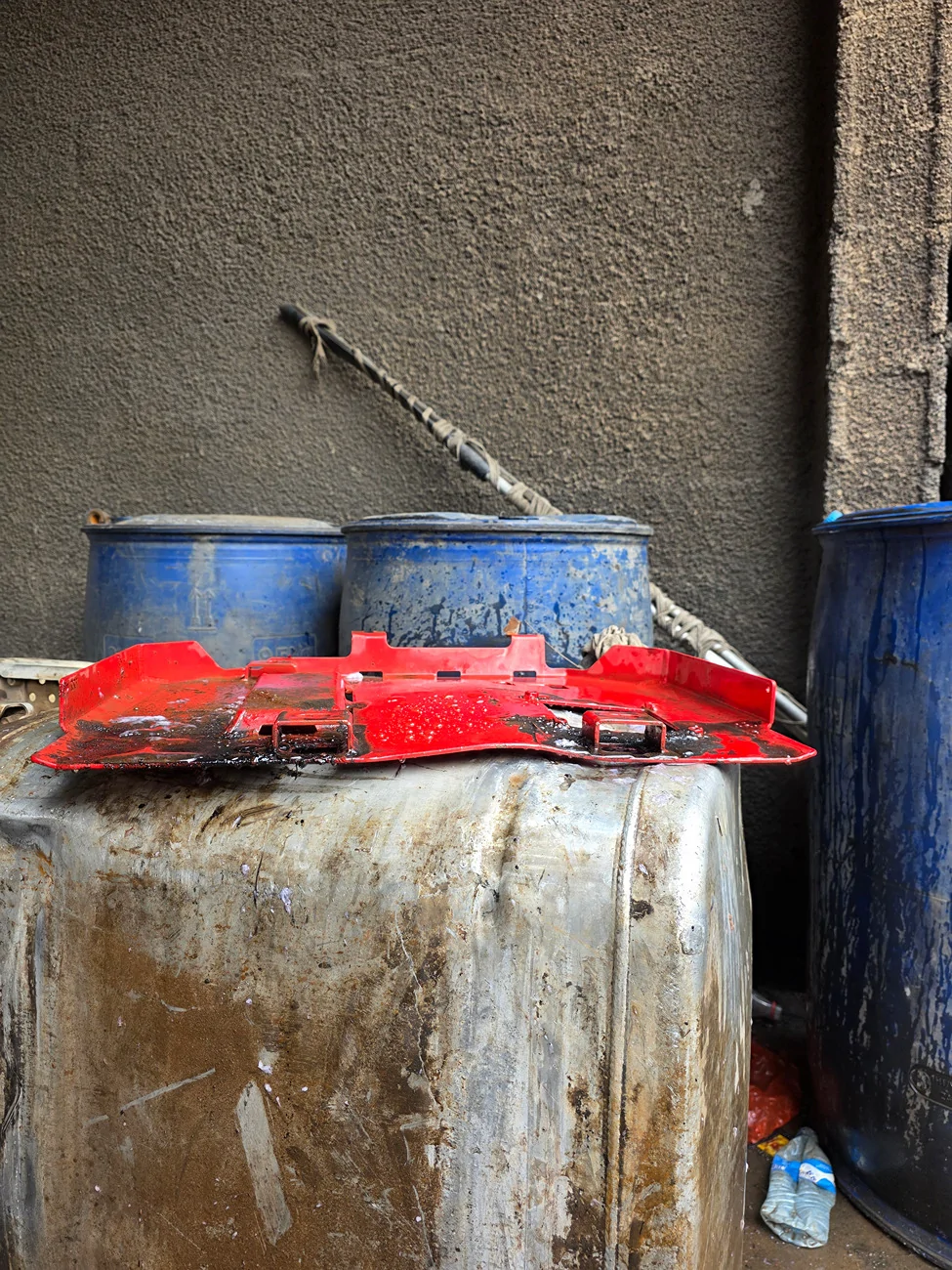

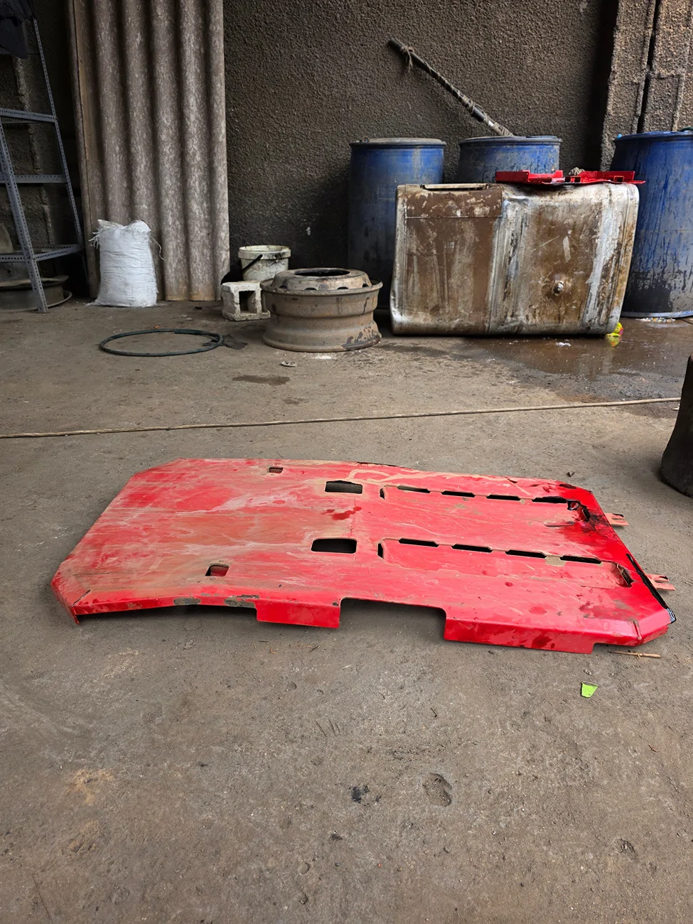

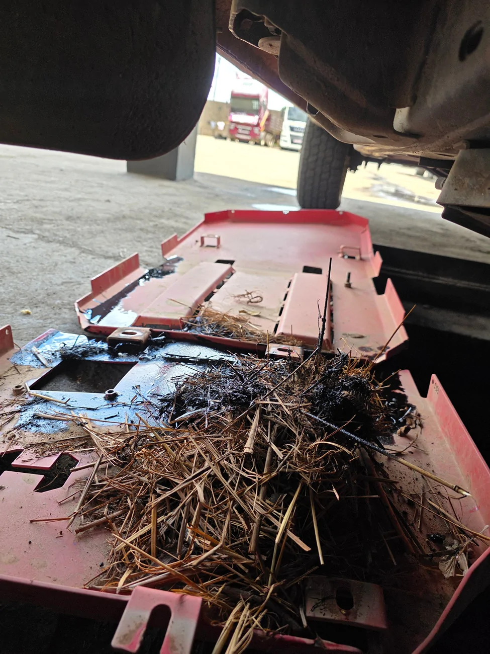

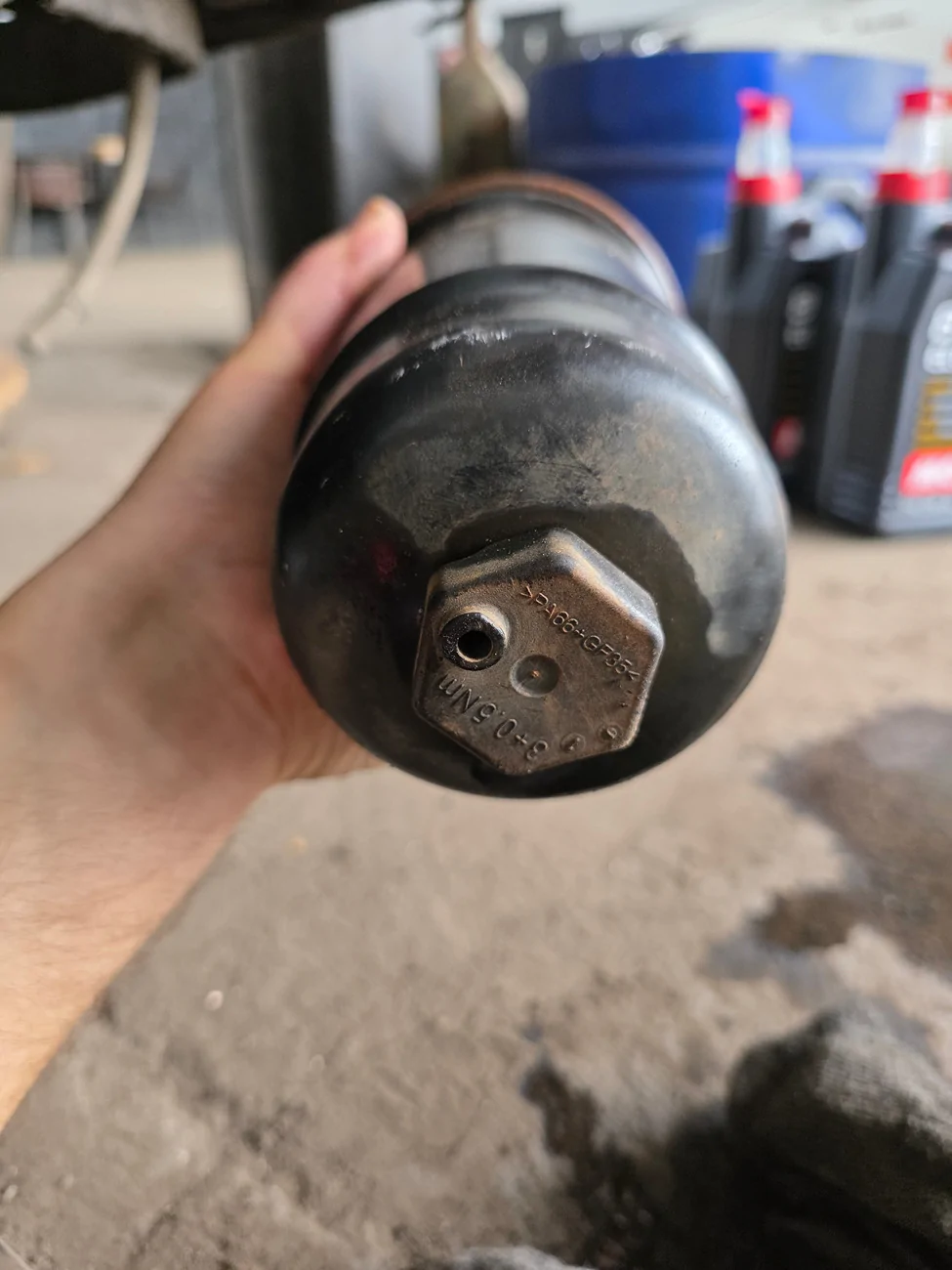

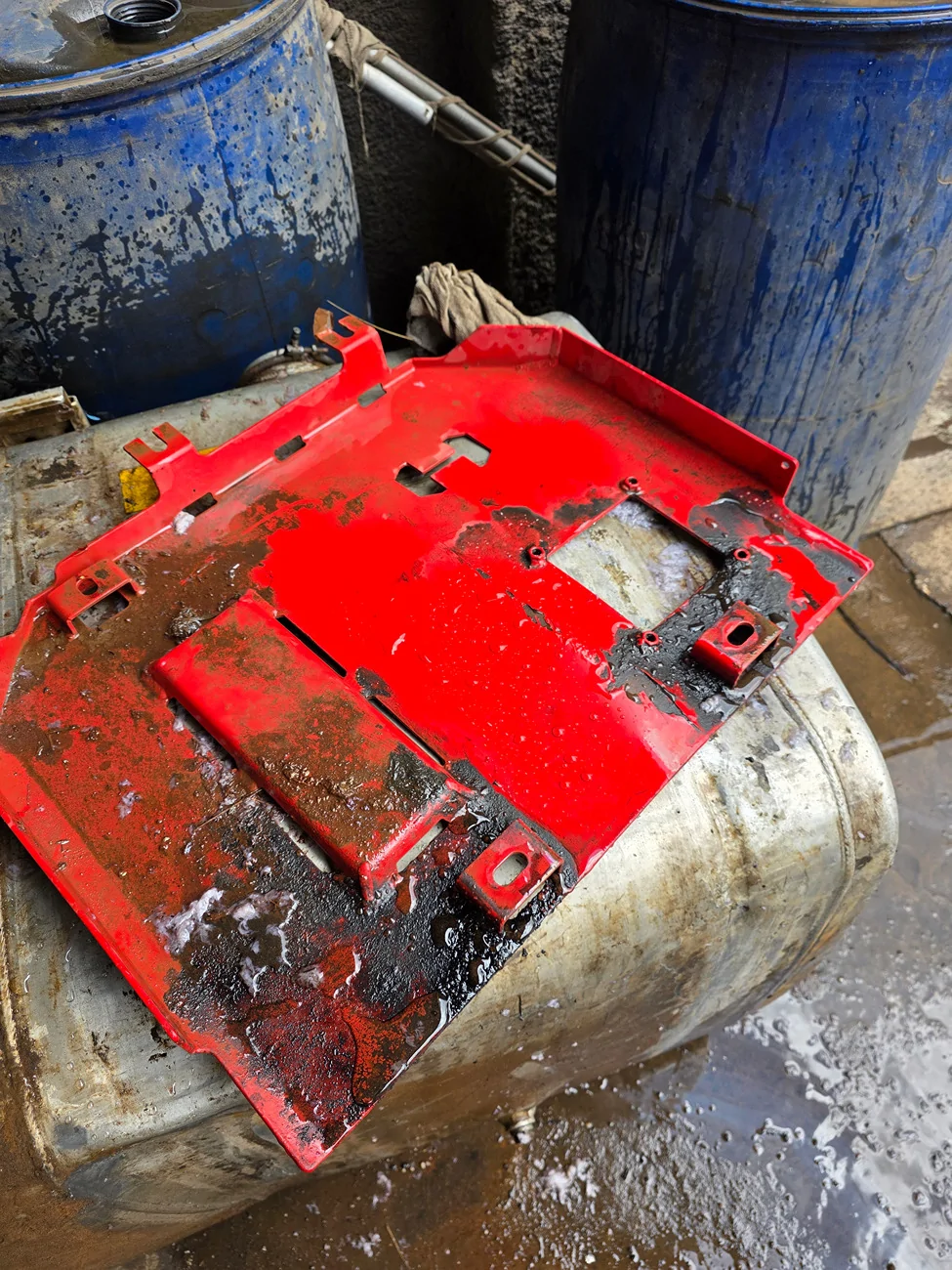

For anyone interested or experiencing the same thing...
It wasn't wiring. It wasn't a bad driver module. It wasn't a bad pump...
First failure was a loos connection on harnes to driver module. Continued intermittent failure and pressure drop outs were all caused by the diesel fuel water seperator/ filter.
It was a failed diesel fuel water seperator/ filter.
See picture. + Some additional photos of the carnage that is my underside.
Will be replacing it every 30k KM now.
