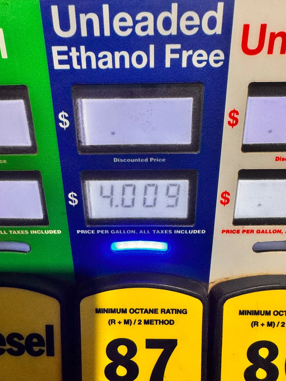

I'm petty about fuel and oil. I like to min/max everything for no reason.
Gas prices are very high right now. I'm seeing $4.89 for 91 octane. Pretty horrendous. So I decided to swap over to ethanol-free 87 octane.
With that ethanol-free 87 octane, I think it would be dumb for me to mix it with AMSOIL Dominator Octane Booster. I received 10 cases for free. What do you all think of this fueling mixture for OEM 2.7L Ecoboost? Sanity check requested.
