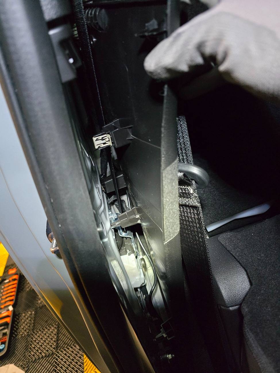

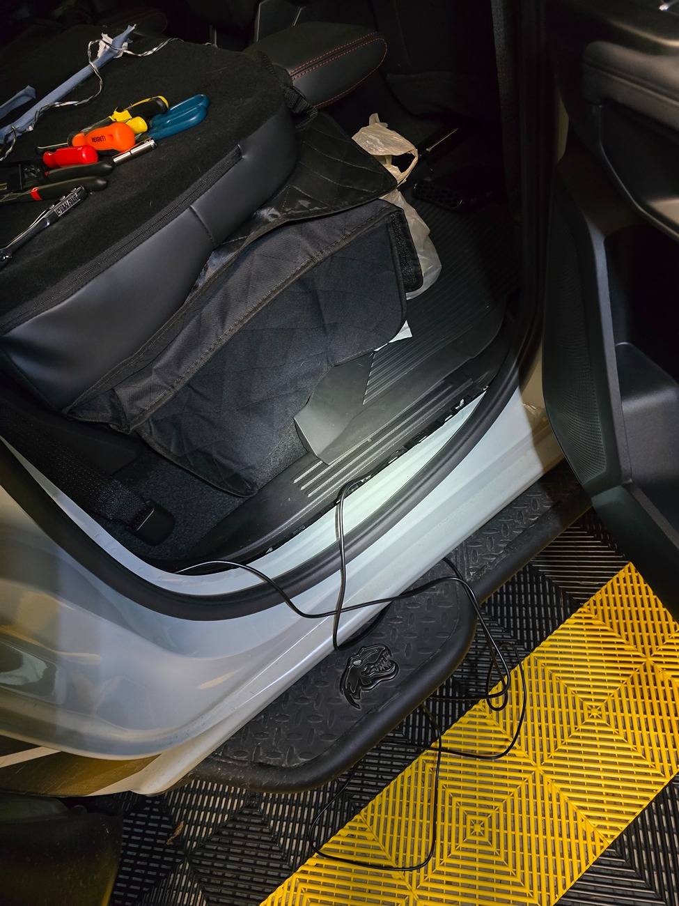

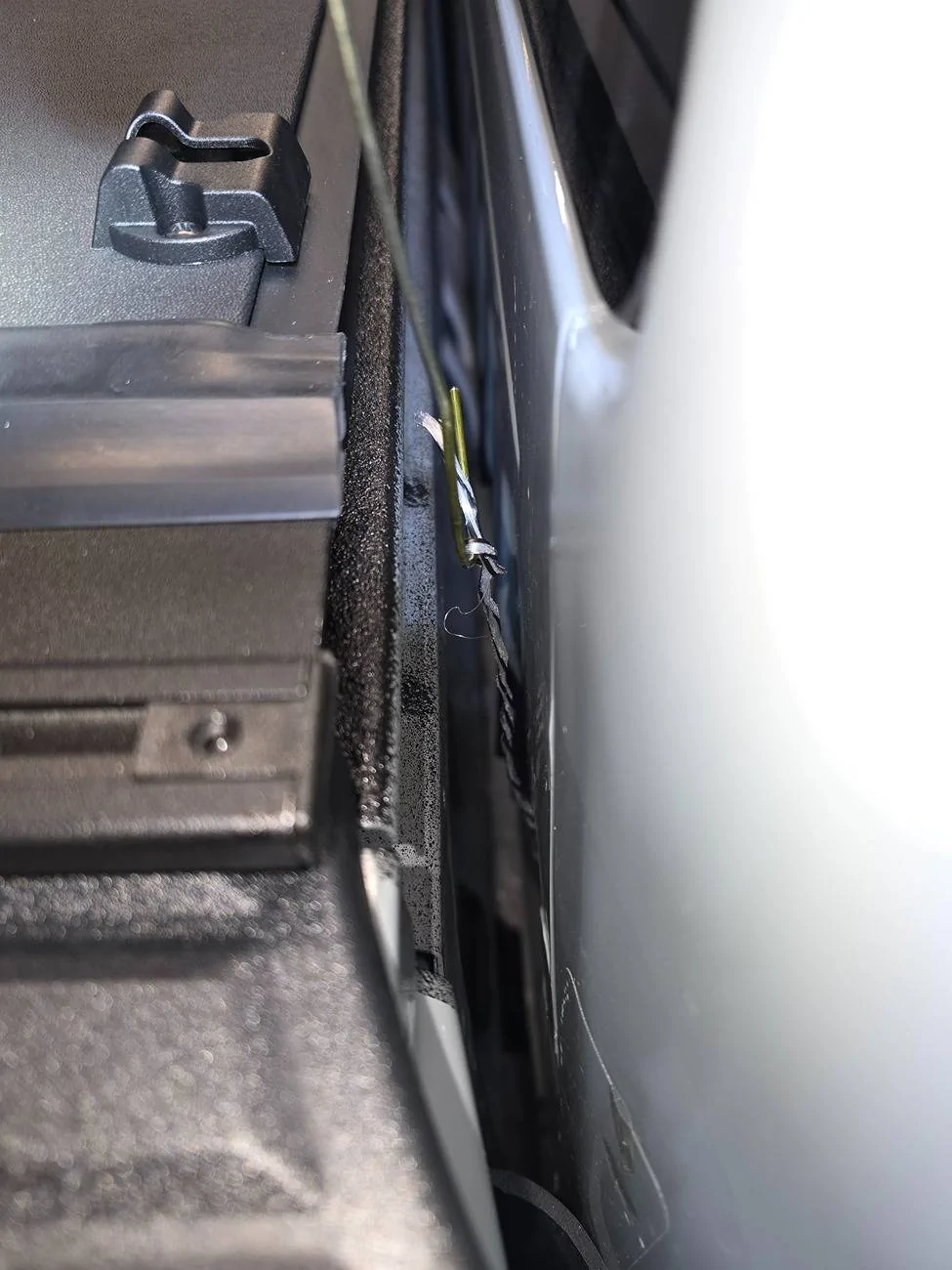

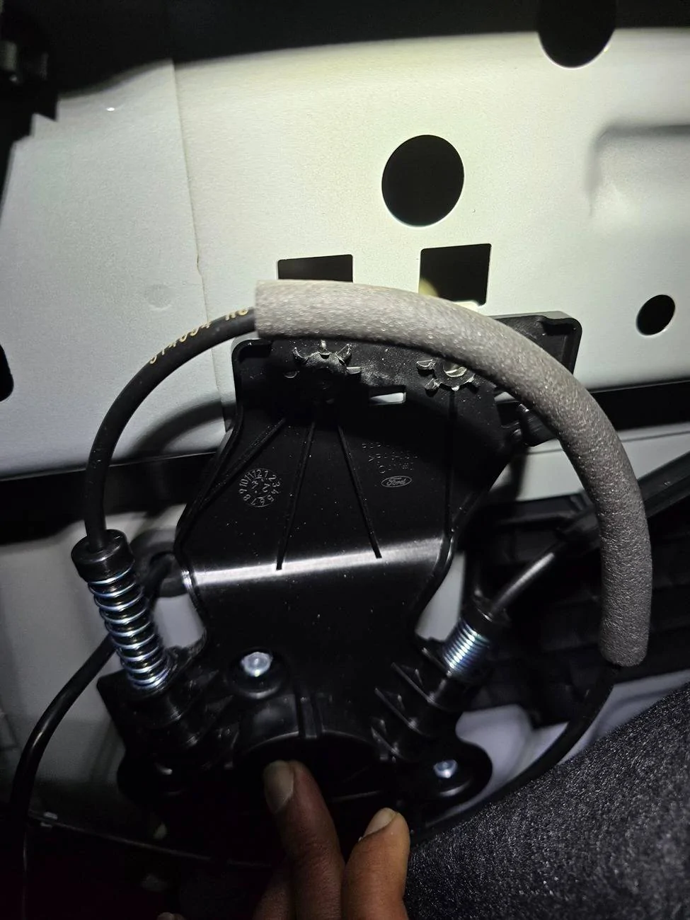

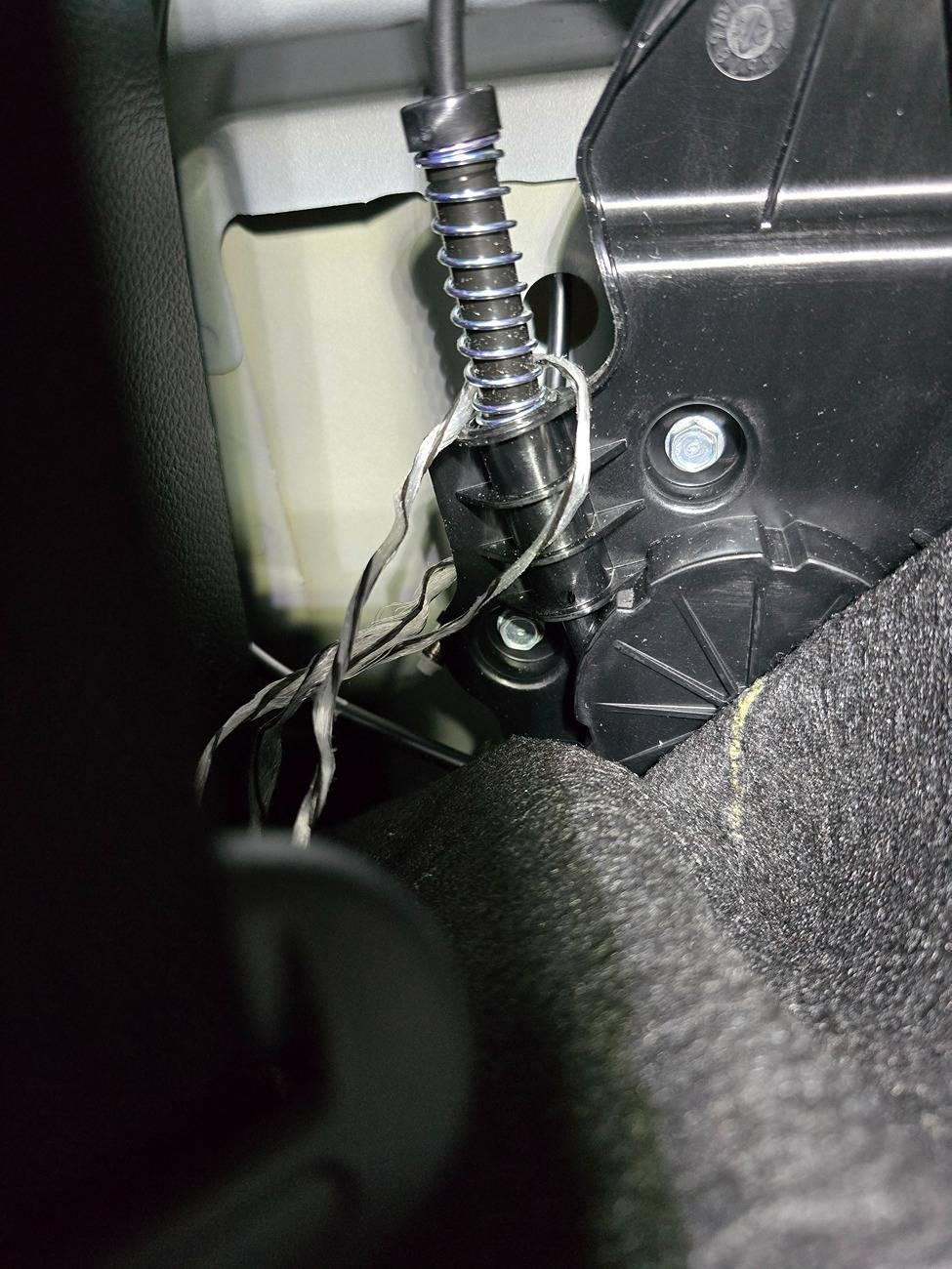

If you're wondering how to get wiring through the grommet between the cab and the bed, this is one route. Drop the rear seat back down and remove the liner to reveal a grommet (well one on each side). Poking from inside towards the outside through it is not insanely tough, but I had to go from the outside to the inside because of the size of the connector on my Midland antenna cable. It was a HUGE pain and I ended up popping the entire grommet out eventually to cut it and push things in and pray that it went back in (which was also a pain). The narrow space between the cab and bed back makes it harder.
Pictures here. I then ran it down the C pillar trim, through the channels behind the floor/door edge trim and then under the carpet to the center console where I had the radio stashed in the (very generous) space under where the parking-brake lever is.
