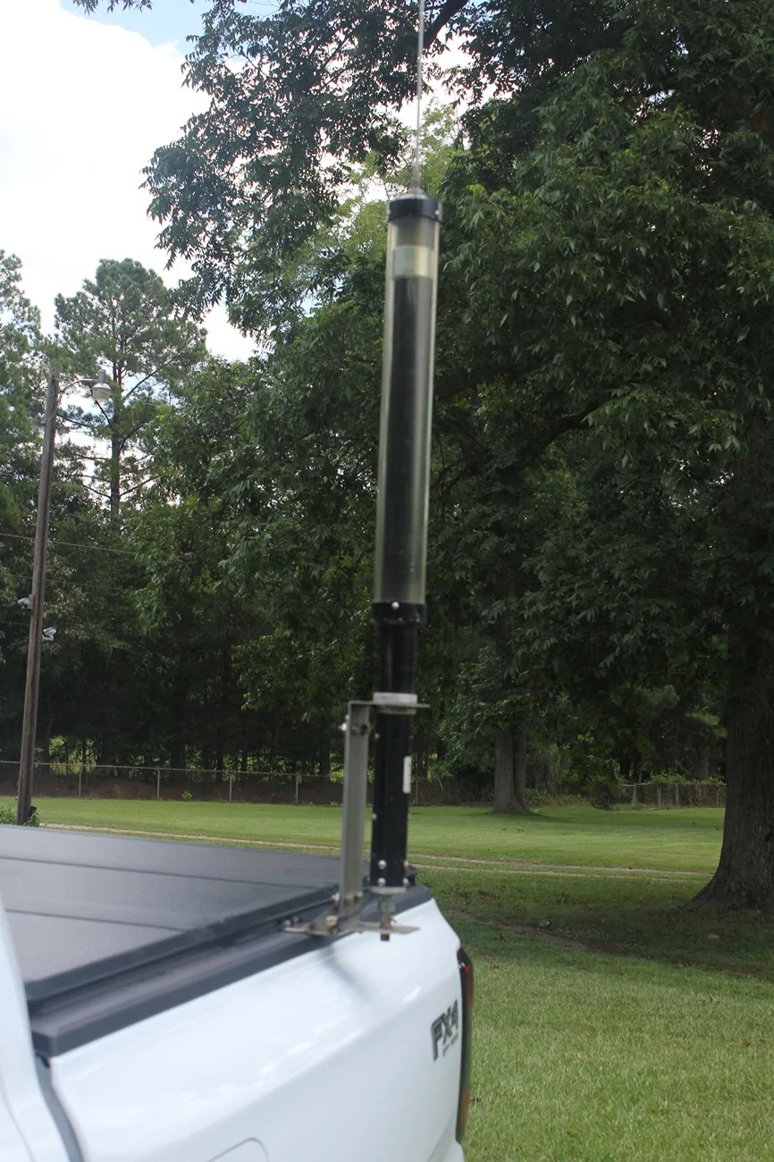

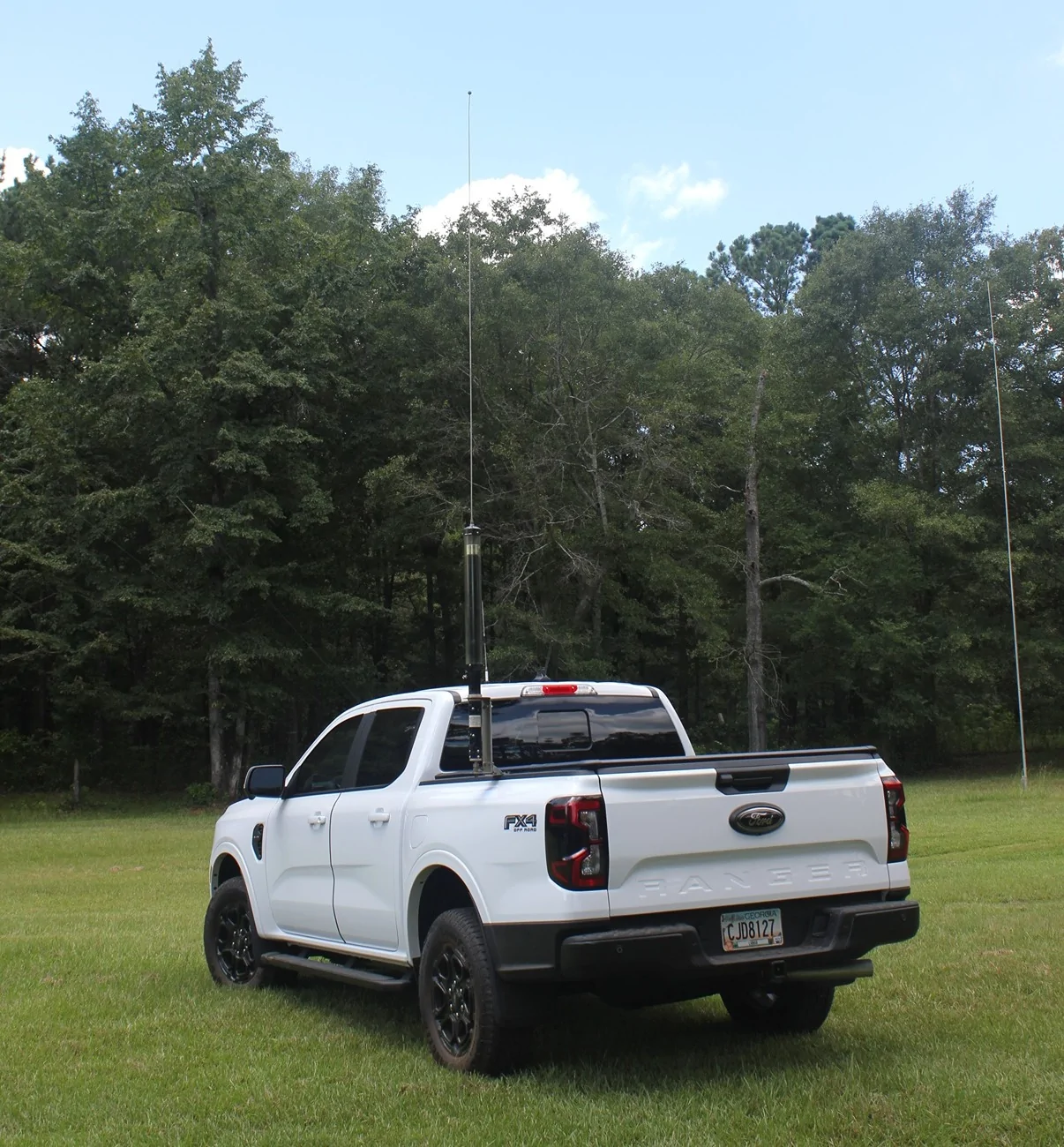

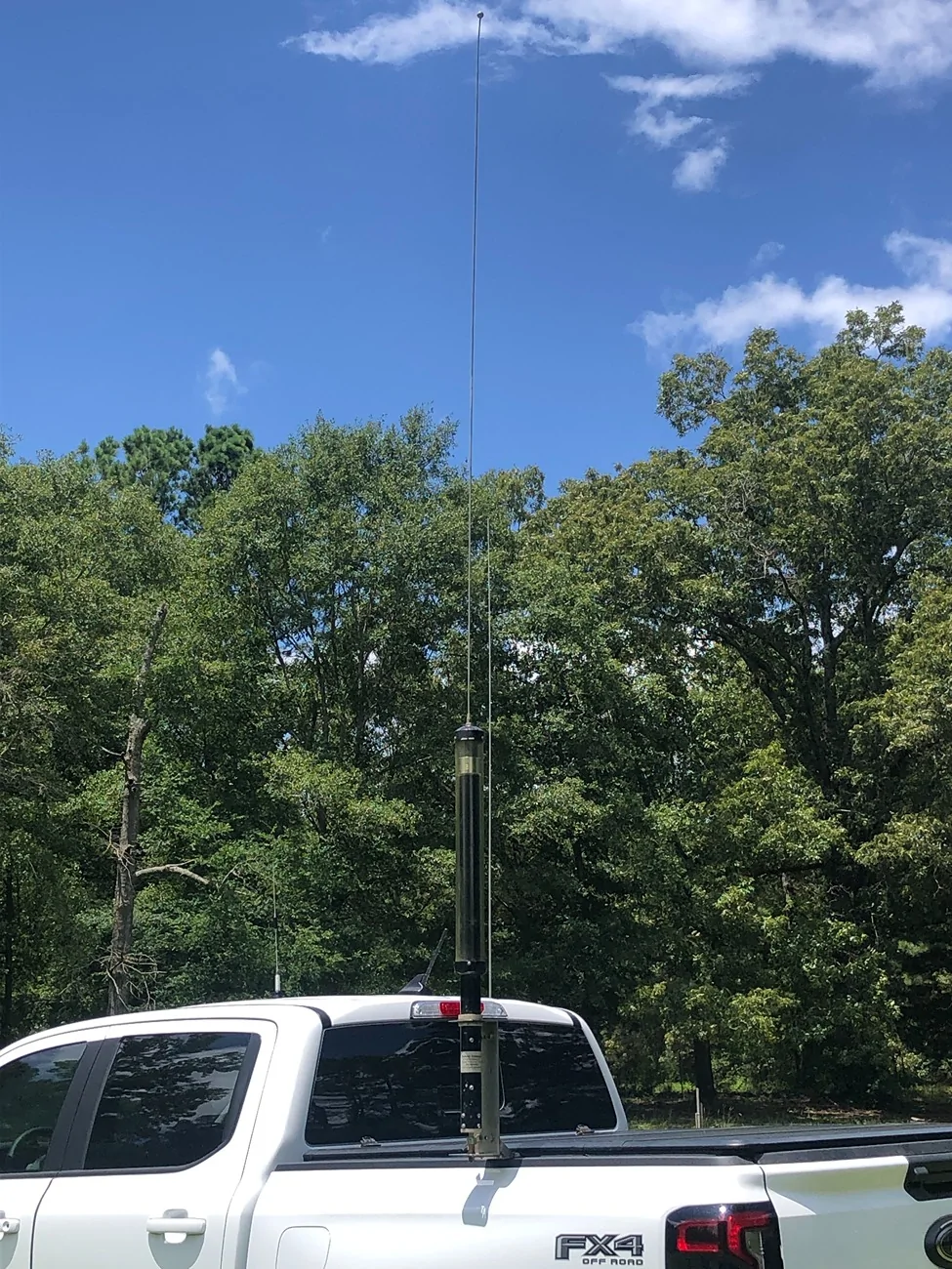

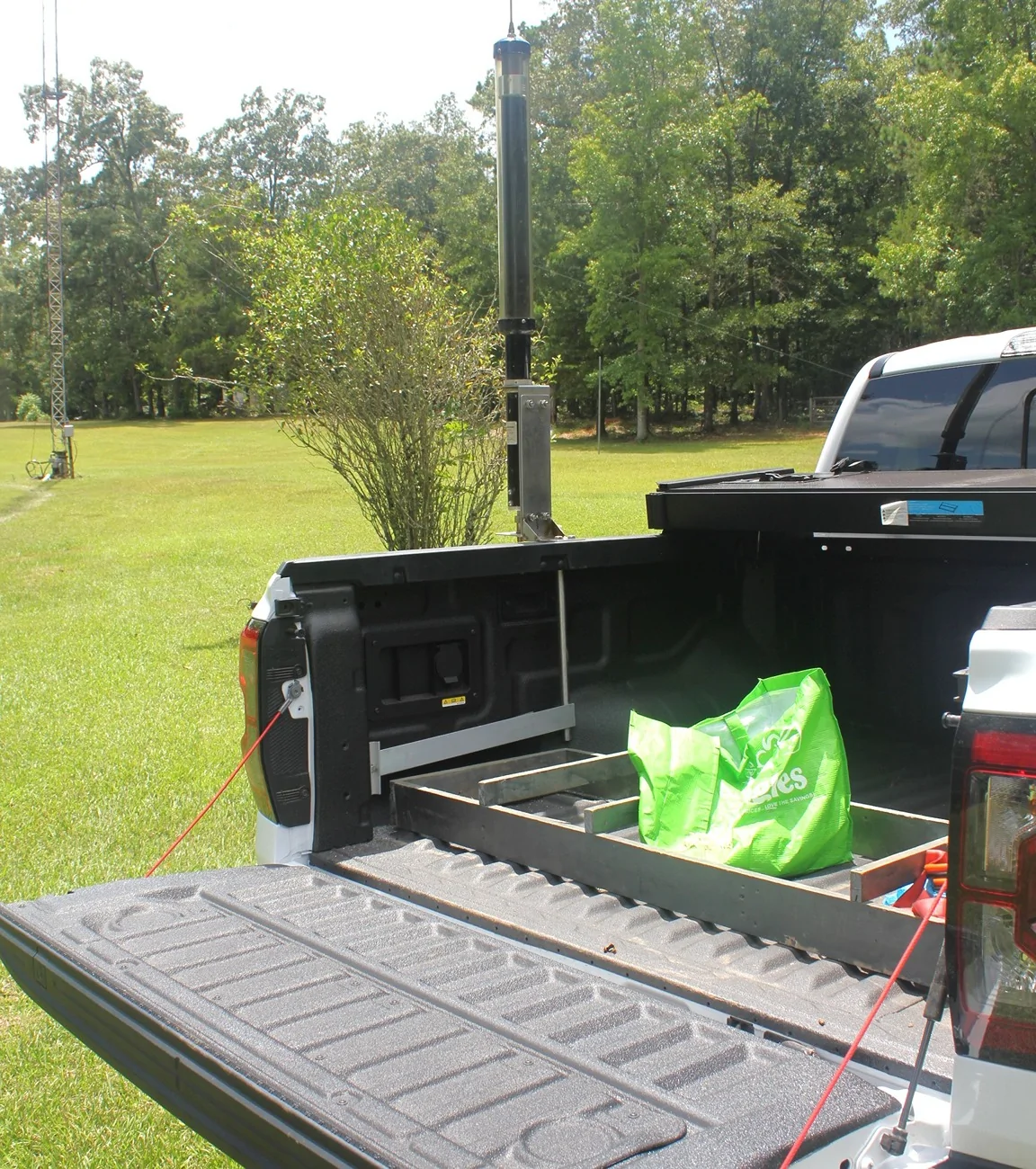

I made an HF antenna system mount for my 2025 ranger. It is all stainless steel hardware that uses existing bed holes (with some resizing). I have different top mount brackets and adapters so I can use any antenna style in any bed tie down hole. I'm working on a 48V battery system that is "trickle charged" with a 10 amp charger so I can run an 800W LDMOS modified ALS606 amplifier. That is one of the HF amplifiers I ran in my F250 PowerStroke trucks. In the PSD trucks with dual batteries I just mounted a dual 50V switching supply right near the batteries and ran 50V into the truck. Can't do that with the small Ranger system, but the PSD system let me run an ALS-1306 1200W amplifier. I'm limiting it to ~800W in the Ranger and using a Lithium-Ion 48V battery system to spread the amplifier load power out.
Mounting the radio head in the smaller interior is a bit more of a challenge than anything else.
