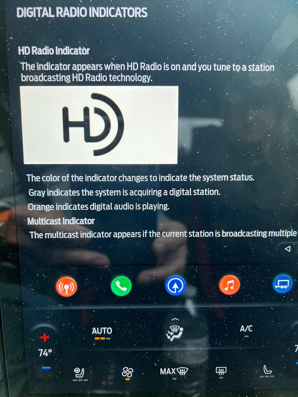

Hey, I went to the grocery store and did some searching for you in the owner’s manual. Hopefully the attached photo helps out.
Ford Ranger HD Radio IMG_5277

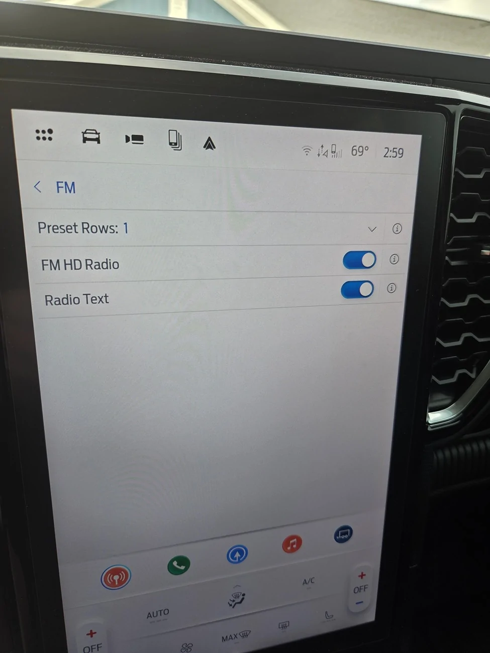

Thanks. I hooked up Forscan this morning and it was off. I enabled it then went into my setting in the sync menu and turned it on. It is now working perfectly. I don't know why or how it was off.

Actually it was in the APIM and I used the non asbuilt to toggle it on.

Perhaps this was simply disabled? Glad it's working though.
Ford Ranger HD Radio 20260428_145944
