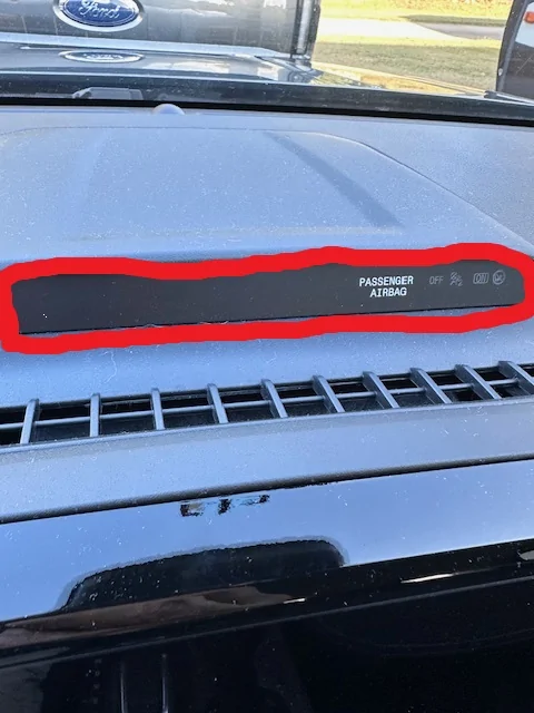

has anyone removed this?

Ok. I have a Tackform mount (which is awesome) for my radar detector and my Auxbeam control panel. I need to run the wires up to the Tackform. I'm OCD about wires showing so I'm looking for s clean route. I found a path to the center speaker enclosure but I need to get to the tacform from there. My thoughts are there may be a route under the piece I want to remove. I don't know but it's worth a shot. I did make a fish out of wire ties and passed it down through the vent behind the info screen. where it came out is undetermined but I'm going to try that again. Conventional wisdom says to open up the radio enclosure to fish the wires but after watching videos on that it's a no go for me. So that's what I'm trying to do without destroying something which I'm good at.

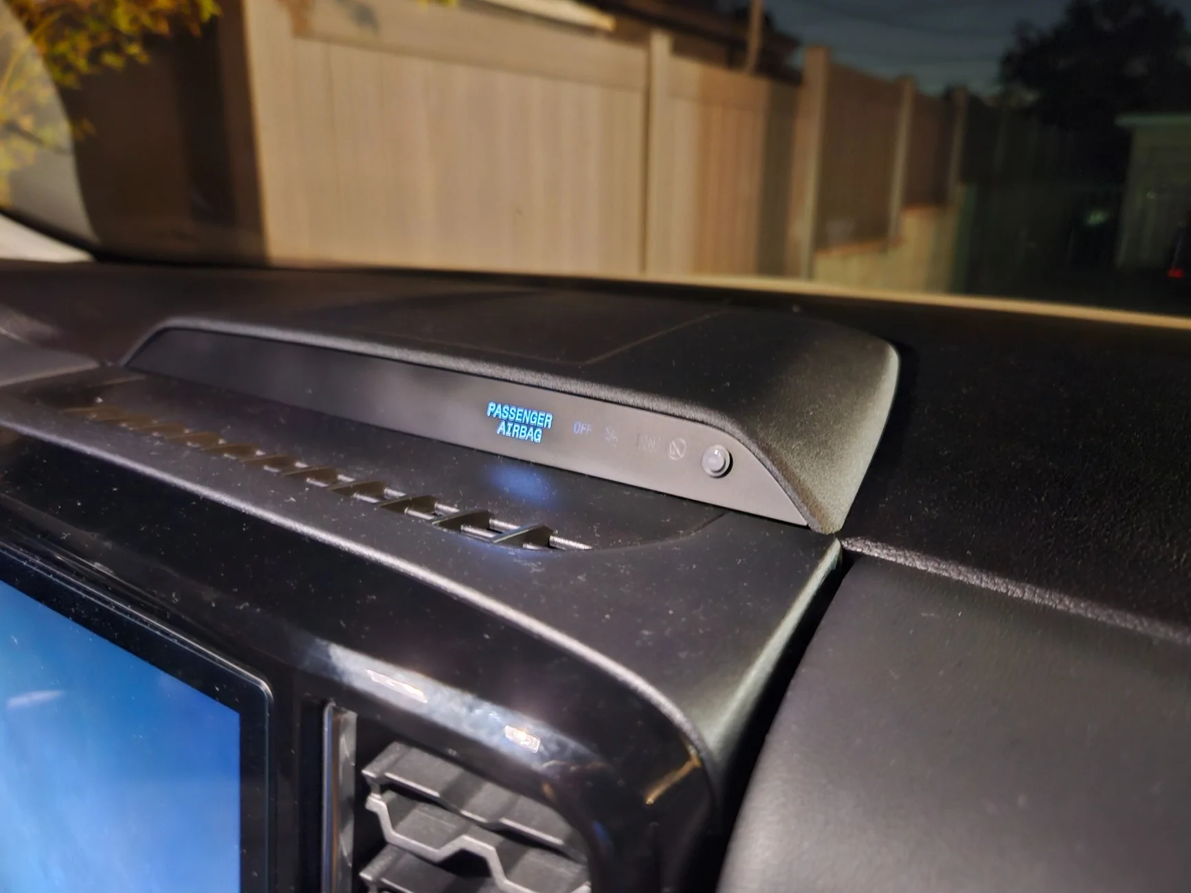

I completely unplugged/removed mine when I put the blinky LED for my perimeter+ alarm in. I drilled a little hole next to the airbag lights and put the LED in there, so I had to take it out entirely to get it to my drill press. (I followed the airbag light harness to get the wire for the LED down to the alarm module behind the glove box.)
Mind you I didn't start the truck with it unplugged, but I had no problems after I put it back in and hooked it back up. I didn't even unhook the battery. The screws didn't hold anything else that I could tell either. I think there's actually a third screw in the middle too if I remember correctly. And a 4th hole in the plate that doesn't have a matching hole in the dash (so it looks like a 4th screw hole, but you could never put one in).
