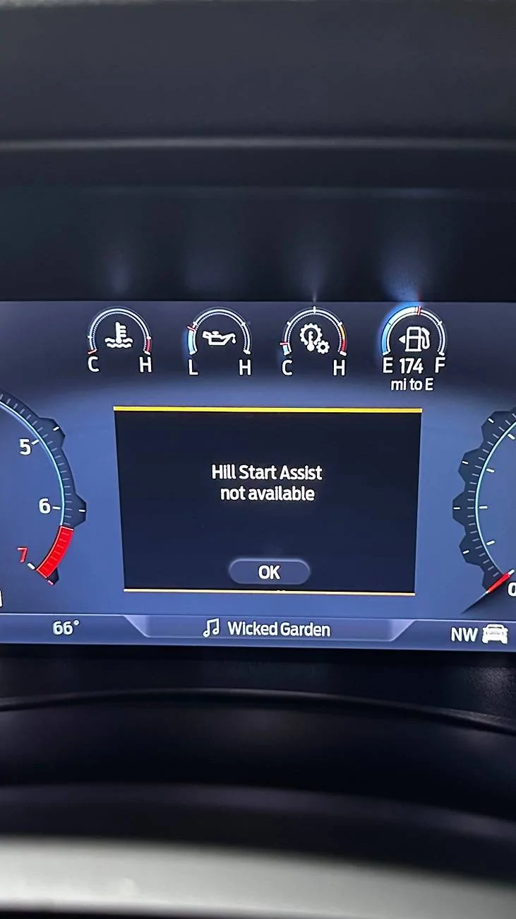

Hi everyone,
I just picked up my new raptor on Monday, and joined the forum today. Unfortunately I'm making my first post on this section of the forum. I have been getting a warning on the display and also on the ford pass app that says " The Hill Start Assist System has detected a failure". It shows up every time i start the truck. the warning goes away after i press OK. I haven't had any issues while driving it.
Has anyone else seen this message? I plan on taking it to the dealer but I don't have time to do that until the end of next week.
