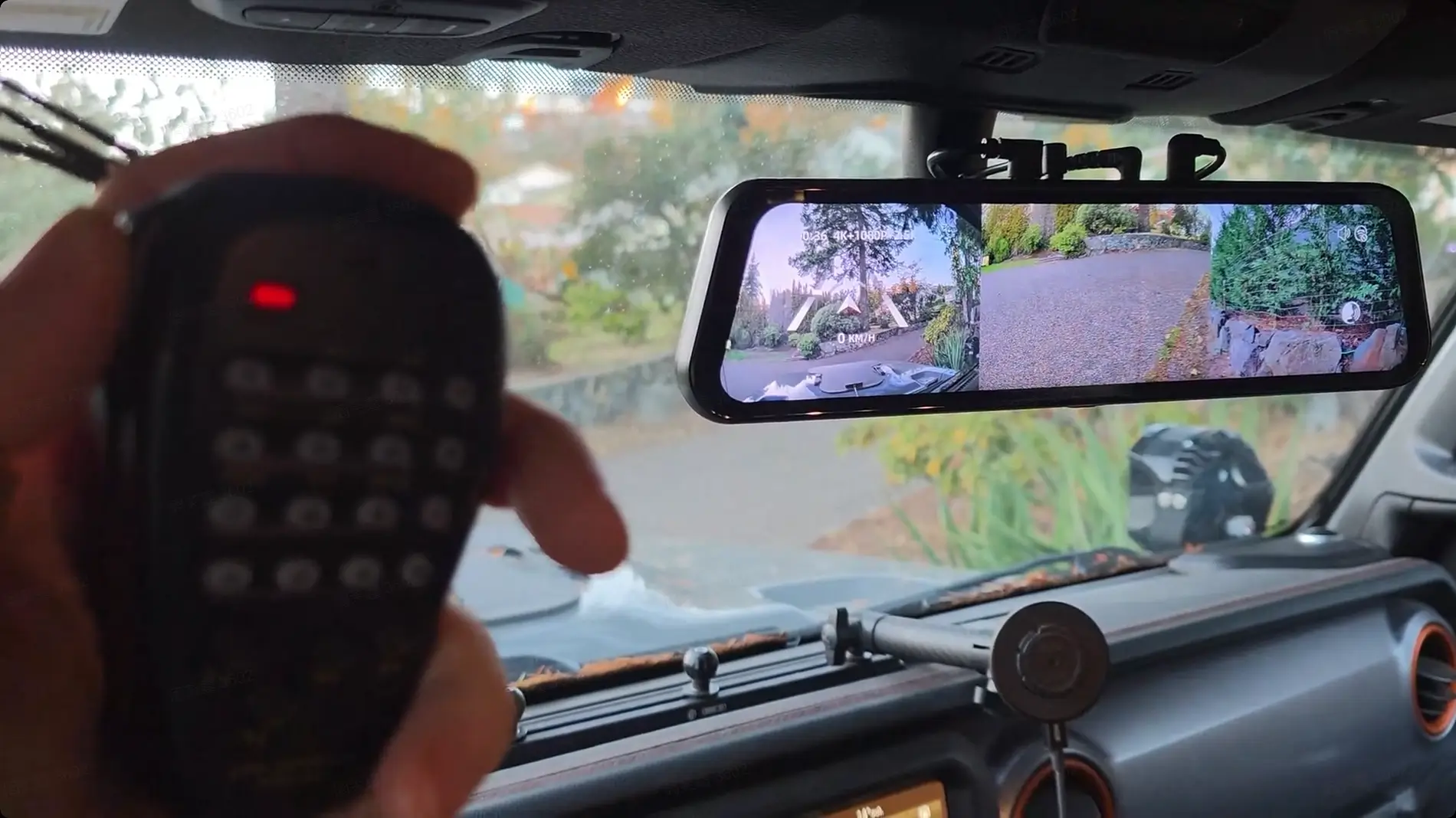

Do you have any practical ways of protecting electronic devices from being intervened by high frequency radio? It would be much appreciated. Thanks.

Standard method is to use a Faraday cage- all that means is a fully enclosed conductive surface. like, say - a metal case! Helps if it's grounded to the vehicle, and since the +wire will act as an antenna, use a shielded power wire, with the shield grounded common with the device. Sur ethere are other methods but that's basic Radio engineering.
