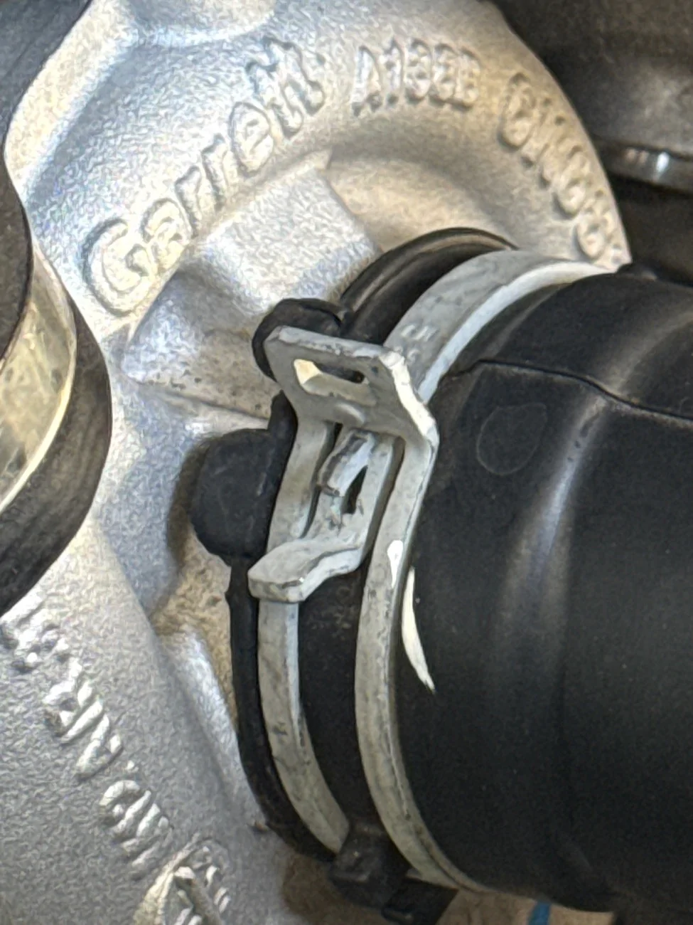

Hey Everyone! Got a dumb question here. How do I remove this hose on the passenger side turbo? I’ve tried sticking a flathead under the ear and pulling up.
I’m replacing the OEM air box with Process West. Just finished up the piping and I’m just stuck on this part.
Ford Ranger How do I remove the Passenger Turbo inlet hose? IMG_8BAC4672-4BAC-4BFC-BA9E-29392D486CCB

Yup, pliers. Recently installed my S&B intake and went through the same thing.
