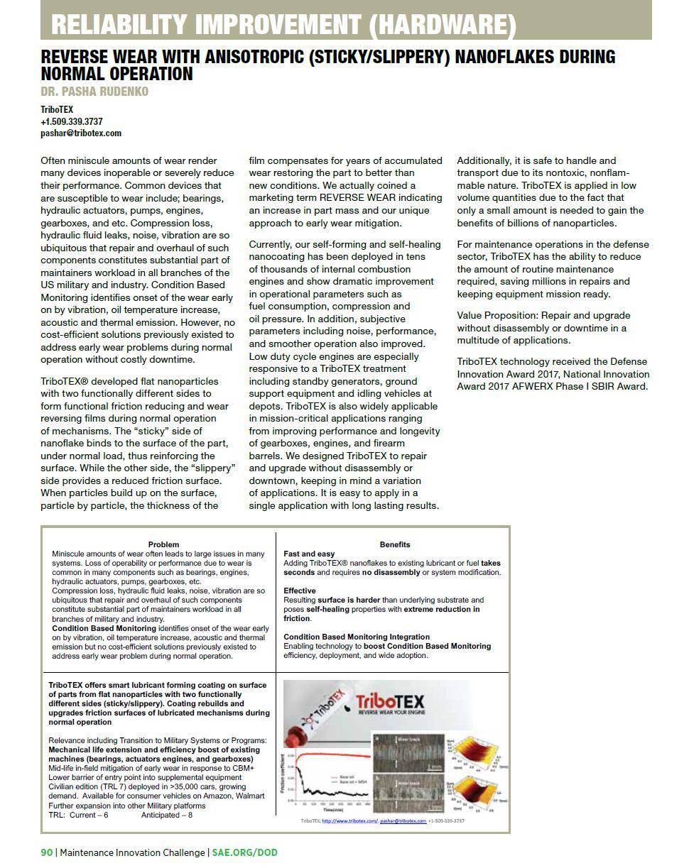

Another fun one from the DoD maintenance symposium:
Ford Ranger Informational - Science / History Behind In Situ DLC Coatings for ICE and Transmission / Gearbox Applications 1744319978929-j7
By the end of this thread, you should have MORE confidence in DLC coatings than you do in your "black box" motor oil formulation!
Notice the footnote? SAE.ORG/DOD...how much information does a person want? I think that just about covers all of the source information I have at this time.
If anyone is questioning the legitimacy and reality of this technology...I'm questioning their sanity...the big question on an individual basis is, does it benefit you?
That's up to you to decide, but I will continue to use it given what I know and my experiences using it since 2019. I just passed the 500-mile wear-in mark on my Raptors 3.0L and did the entire powertrain yesterday so now wearing in that.

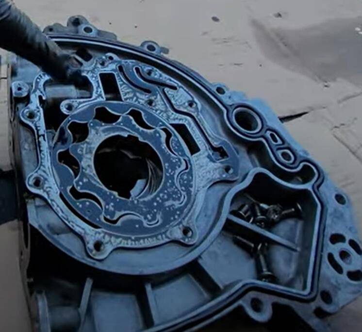

Above is an image of a Ford 3.0L positive displacement oil pump as an example (not 3.0L Ecoboost). It's of a g-rotor design. Consider how over time the pump gears wear and lose their ability to "squish" oil out as they lose volume (due to wear), hence the namesake as positive displacement, since fluids are incompressible, the gears force fluid to flow by displacing them.
As DLC coatings form on the gear faces and sides of the rotors, they build up a film to restore worn away metal by "resurfacing" kind of like building up polish on a metal surface or plating a surface (bonding).
Because of the lattice structure, the DLC film helps with fluid retention and adhesion to the surface of the film during operation where there is sufficient velocity differential between rubbing pairs to support a hydrodynamic fluid wedge. As the DLC film forms, and the capping process of the film at its final stages of formation creates a super lubricious and wear resistance surface that is carbon rich, yielding multiple benefits simultaneously.
Since the In Situ DLC film forms on BOTH faces of the rubbing pairs (bearing surfaces), the steel or iron substrate sees little additional wear as the film becomes the primary wear surface.
1. Promotes oil adhesion for better film strength on the contact surfaces.
2. Builds up a film over areas of high wear (areas most subject to heat and pressure) that can replace some of the lost steel substrate, up to 40 microns or 0.0016 in.
3. Most of the continuing wear is now on the film which will over time wear down like any other DLC film, but since it is In Situ, it is replicable without disassembly, which is incredibly advantageous!
4. The synthetic magnesium silicon hydroxide (MSH) film achieves a friction coefficient of about 0.01 or less, achieving super lubricity which is where you gain in hp / tq comes from, by reducing friction losses which are parasitic to ICE and gearbox function.
In the case of the oil pump, especially in older vehicles with high pump wear, it can help restore oil pressure and extend service life of the pump which is absolutely critical for engine function. It also reduces friction losses in the pump assembly itself, so the oiling system operates more efficiently.
It was designed specifically to work with existing oil additive packages now common in motor oils like ZDDP and MoDTC (an organic moly compound that was developed by Infineon in 2009 to help address wear issues with motor oils on factory applied DLC coatings as earlier oil specs were developed prior to the common use of DLC coatings on parts).
That is just one example. On a newer vehicle, you don't have any wear or enough wear to matter. However, there is still friction losses, so there are benefits in efficiency, durability (by reducing wear rates and preserving like-new function) and robustness of operation as the enhancement of film strength is still gained.

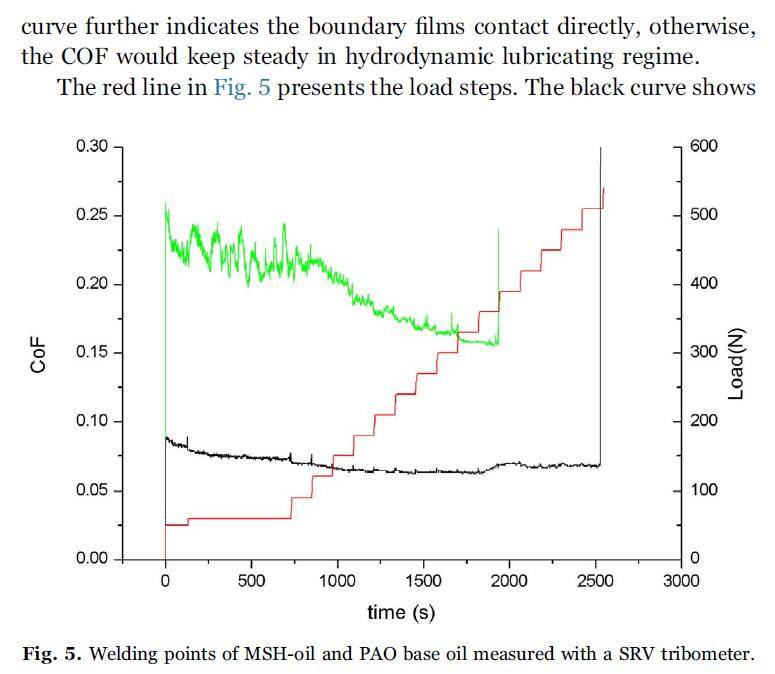

The difference in COF (coefficient of friction) and two, the difference in load before welding. 350n vs. 500n of force or 42.8% increase in load bearing capacity. Taken from Tribology International 110 (2017) 35-40. This is exactly what was also observed in the US Army's Weveden hypoid gear mesh efficiency test and WHY it's very useful not just in engine applications, but gearboxes particularly. Pretty cool technology.
