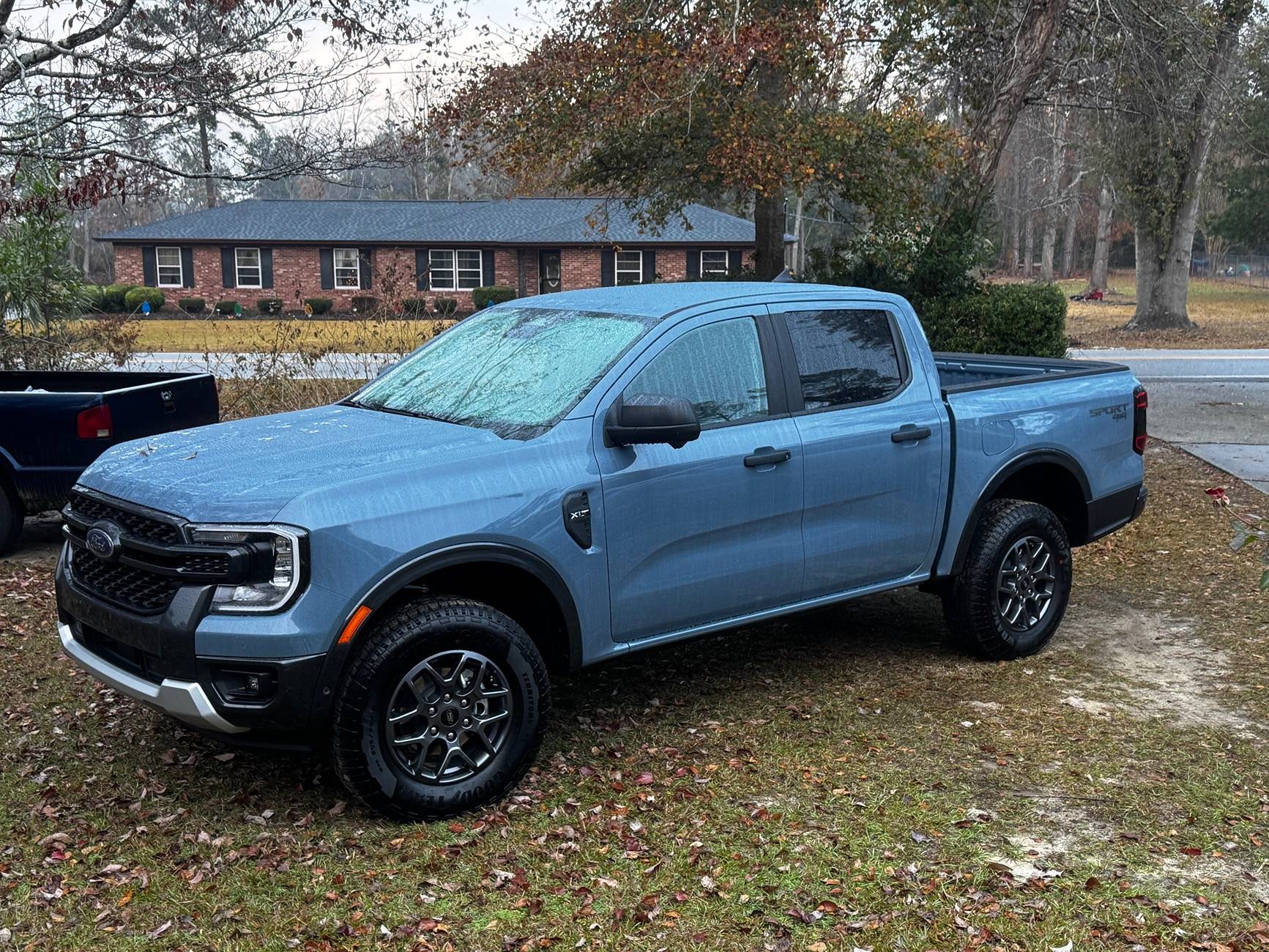

My tow hitch is the rear mounted bumper kind and the plug that goes where the ball is supposed to sit has a hard plastic piece that hangs down under the bumper. My question is does that piece need to be removed before installing the ball itself?
I’ve added a pic of my truck. It’s the Azure Gray Tri-Coat Metallic color.

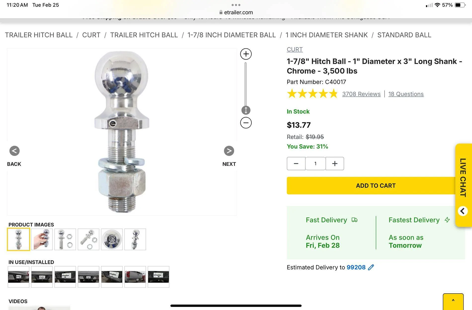

Thanks! I’m on my lunch break right now and I checked and the tube the plastic plug fits into is all metal and about 2 inches or so long, so I’m gonna have to try and find a ball that has a longer thread to fit into there.
What size is the shank? It is most likely 1”, this long one might work. eTrailer is a great source for odd sizes. Your owner’s manual should specify the size needed. What do you plan to tow?
Ford Ranger Installing tow ball on bumper mounted tow hitch IMG_7697
https://www.etrailer.com/Trailer-Hitch-Ball/CURT/C40017.html

Thank you! Right now, I really just want to be prepared to tow a standard flatbed trailer like you would use to tow like a riding lawn mower, etc. Thanks for that reference!

FYI most of the rental trailers require a 2" ball.
