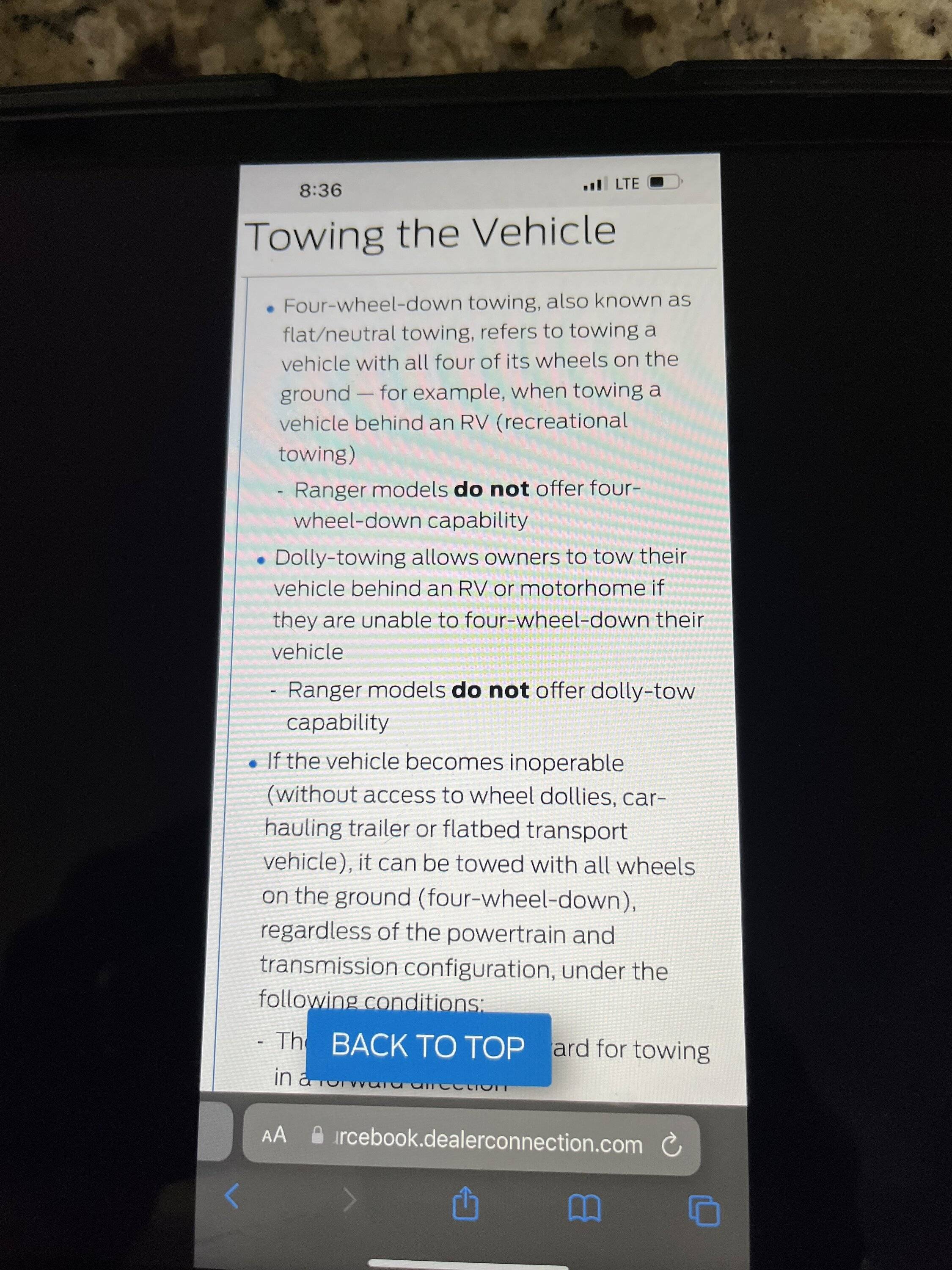

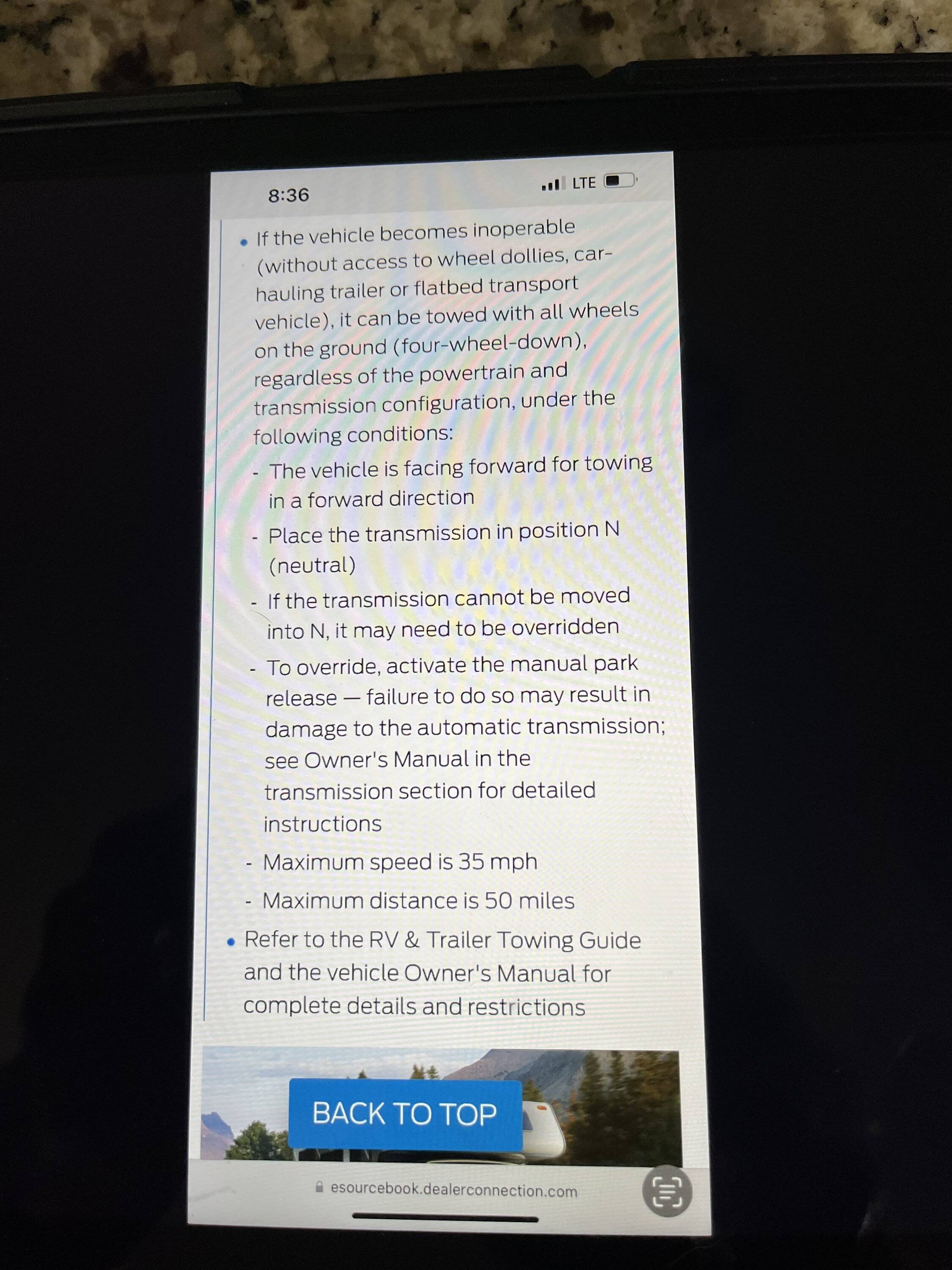

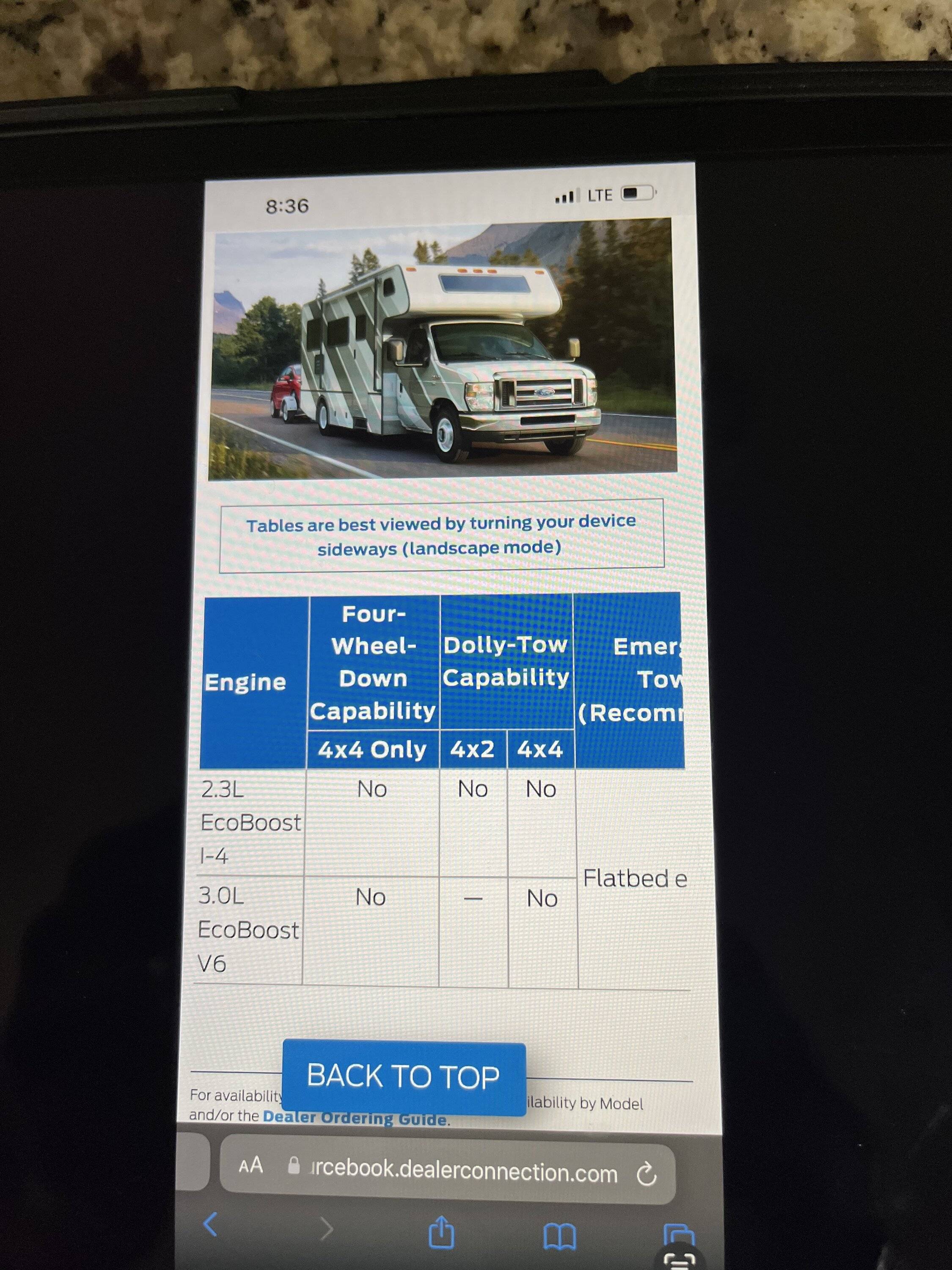

Flat Tow 6G Ranger? Update 6/23 ***NOT FLAT TOWABLE***
Deleted member 6753
I believe I’ll do the same, I may take delivery of my RR and sell it stright away. I should be able to make 5 or 6 Gs
ThickGatorade
Jul 7, 2023
90
100
Bronco Raptor
This is unfortunate. Looks like they opted to ditch the offering entirely. The issue is the EBB system not remaining active during flat tow. It shuts down and certain supplemental braking systems becomes ineffective. However it will still work if you use a braking system designed for unboosted braking afaik. This has been a long ongoing thing regarding Ford EBB systems and flat towing.
What is disappointing however is this only applies to the Nano engines for NA and all available engines I believe in ROW. Those power plants all use an EBB module. The 2.3L EcoBoost afaik still uses a traditional vacuum booster. Since it’s only one out of six engine offerings they must’ve decided to scrap the mention of recreational flat towing entirely. Hopefully this can be an OTA update but because it’s a Battery Management System issue (afaik) it might not be that simple. Also there are quite a few module updates needed to provide the sequence to allow flat towing.

I can’t think of any unique issue to the Ranger that would require them to omit the offering of flat tow. However because it’s a brand new model launch in an existing dilemma regarding flat tow on similar products then it would make sense why they would strip it until it is resolved.
It hasn’t been in the owners manual of any 6th generation Ranger so far so it’s been a long standing decision
Deleted member 6753
The new Rangers and raptors have full time 4 wheel drive I beleive it has to do with the inability to disconnect possibly a software issue.
ThickGatorade
Jul 7, 2023
90
100
Bronco Raptor
No that’s not the issue I reference. There has been a long standing complaint about issues with flat towing due to EBB. However if the issue is with the TCCM that would make minimal sense because it’s the same unit offered in the Bronco and has been in customers hands for way too long at this point to not be addressed for the Ranger launch.
The TSB for flat tow issues on the Bronco involve removing a fuse for the EBB but it remains only a TSB. I believe a software fix is due soon to address that which, should, open back up flat-tow on the Ranger.
