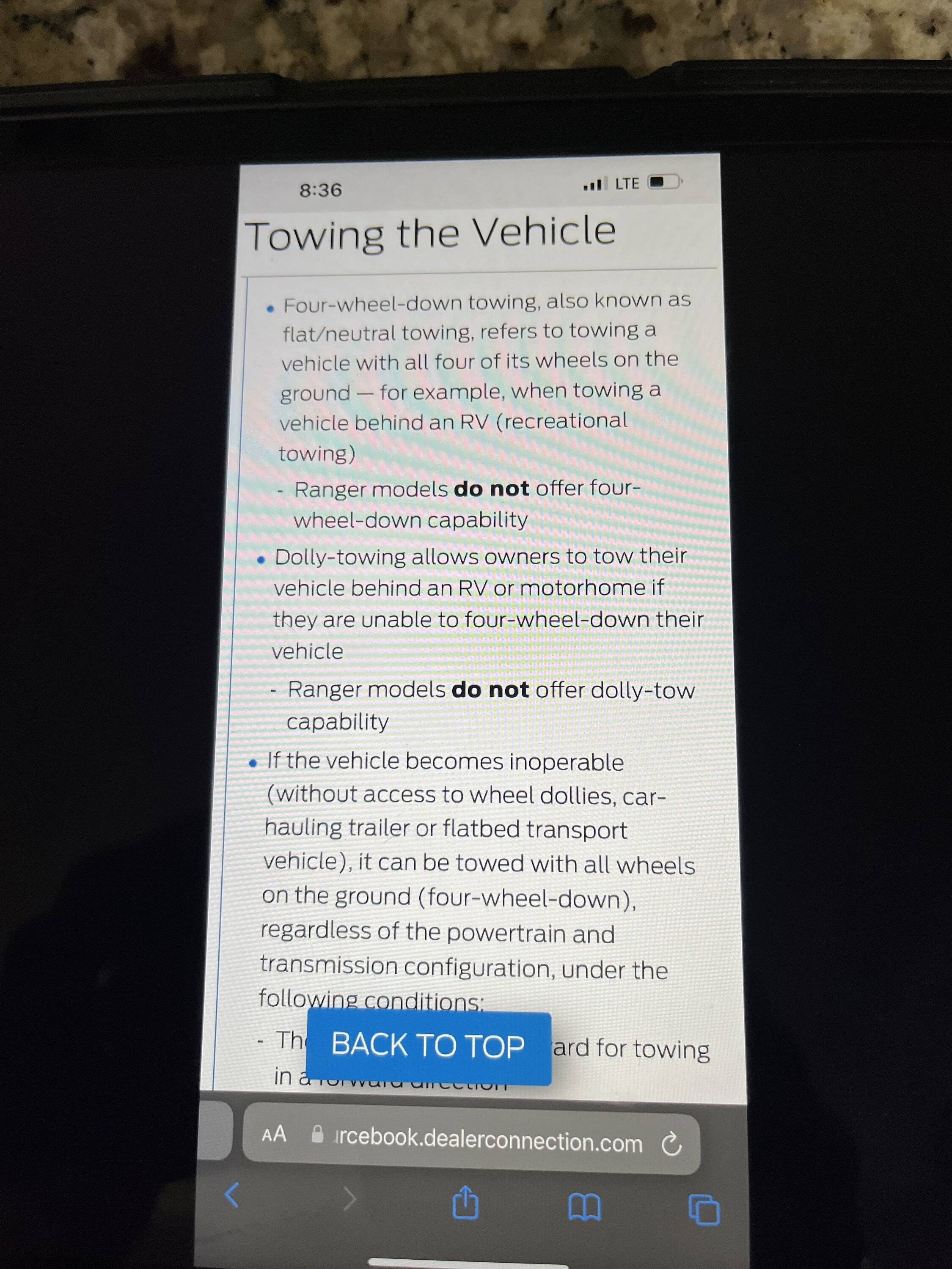

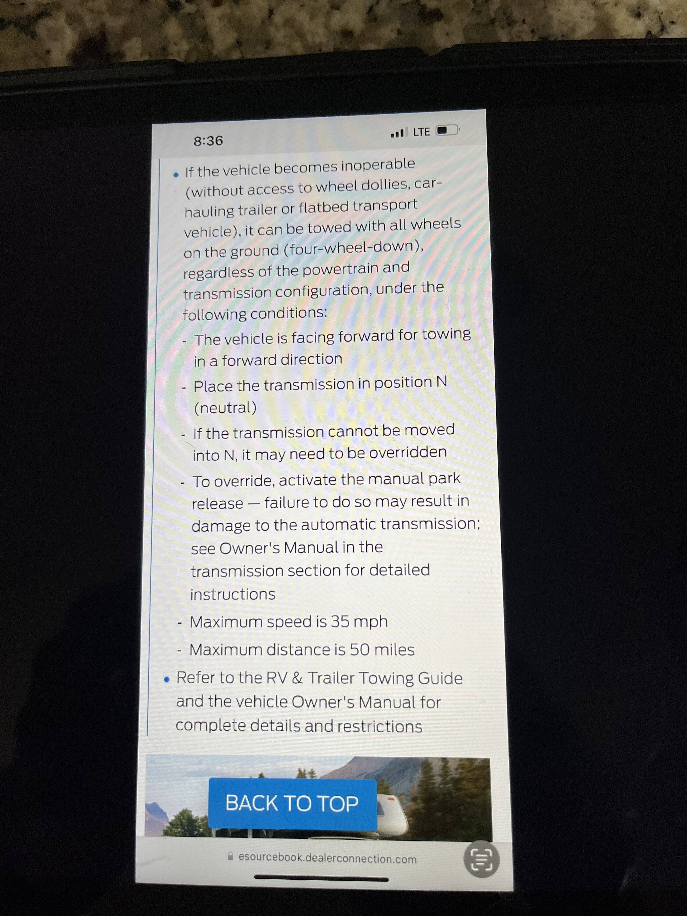

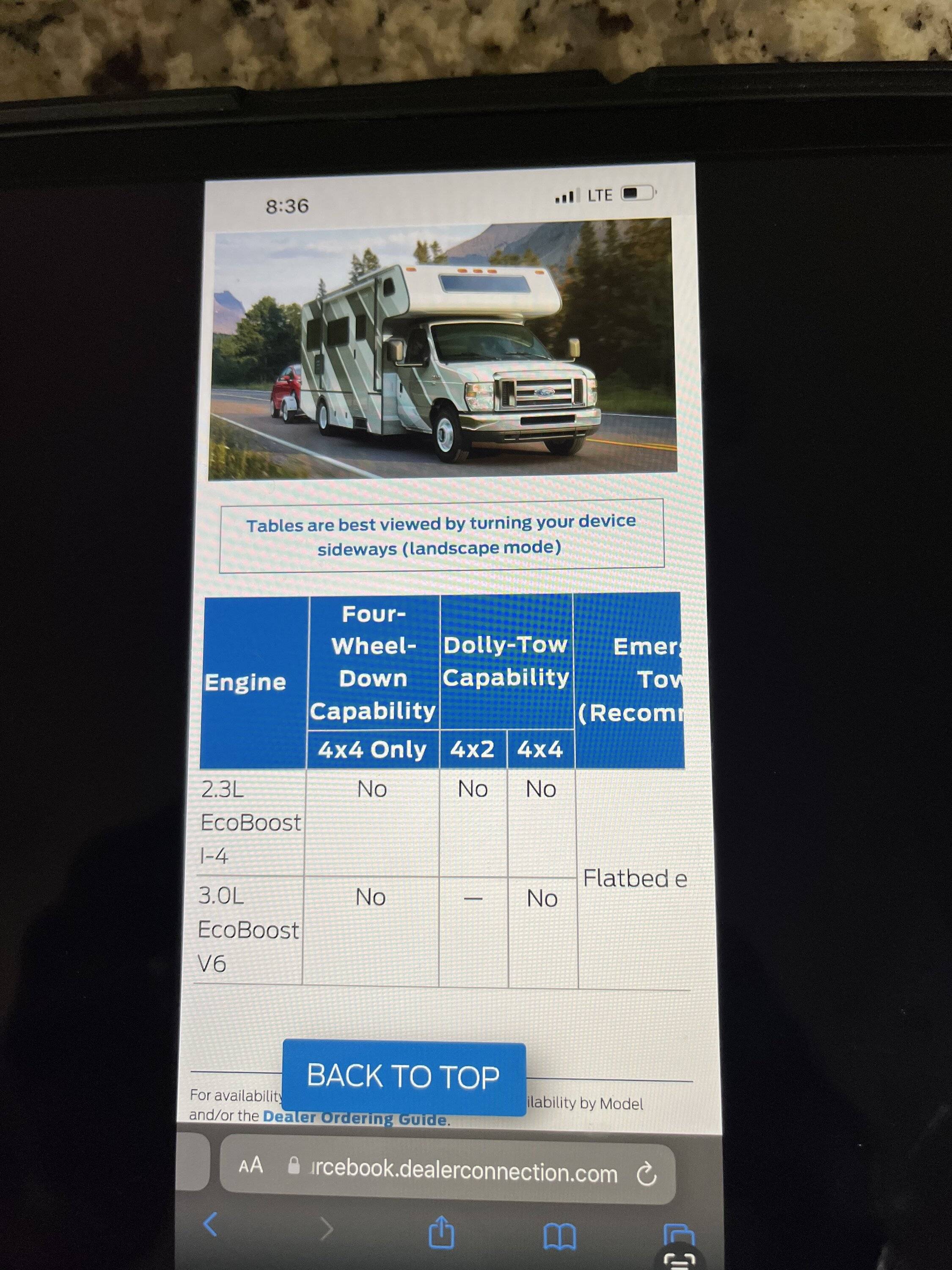

When I questioned my dealer (we flat tow behind our MH also) he sent me this from the not released 2024 manual. As per my dealer the Ranger and RR can not be flat towed.

This has been confirmed and suppose to be addressed with the 2025 model year. The 2024 will not be capable of 4-wheel tow.
Ford understands and will make this function available so future models are supposed to be capable, and the issues corrected.
It is not expected to be corrected on the 2024 model year as it is now a deleted function so unlikely the program will be available at all.
