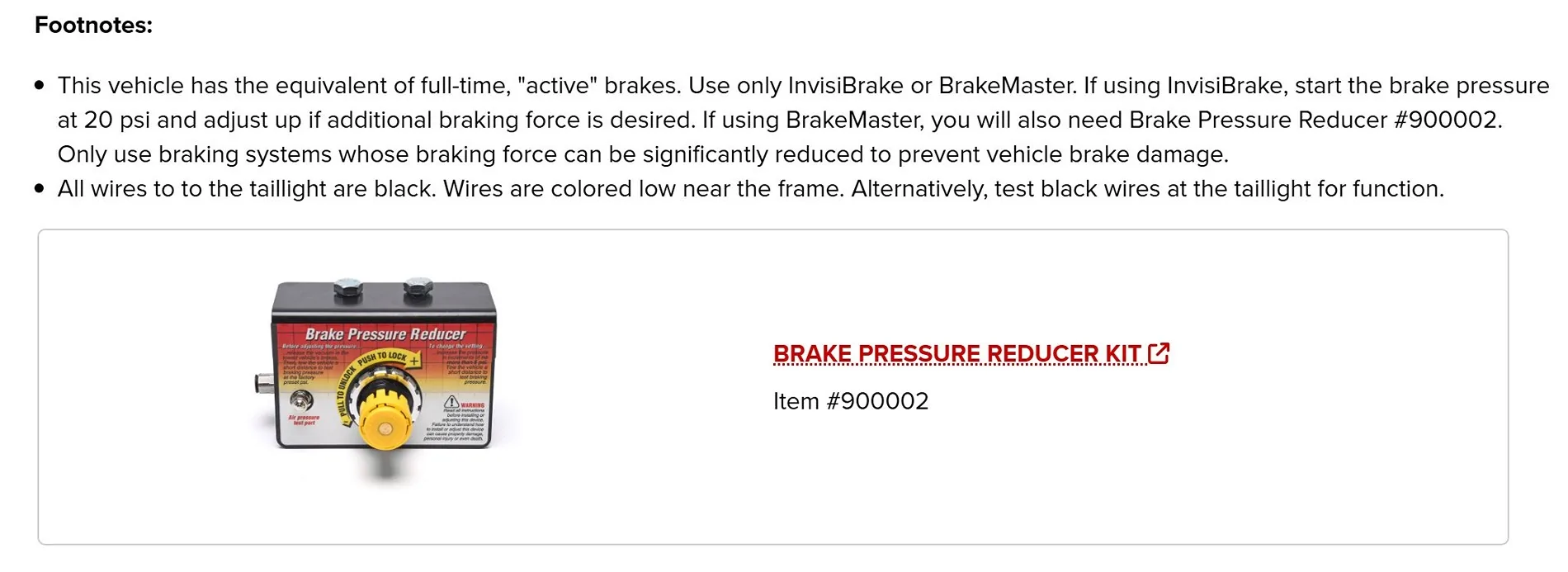

Hello all - first post here. I currently tow a 2017 Jeep Cherokee behind my motorhome. Will be trading it in the next couple weeks for a Ford Ranger - likely XLT trim unless I find a deal on a Lariat. The motorhome has air brakes and I've always used a Roadmaster Brakemaster for towed vehicle braking. It basically uses line pressure from the air brakes to proportionately push on the pedal with a slave air cylinder.
The Roadmaster web site includes the following footnote for the '25 Ranger. I haven't seen any other web sites mention brake sensitivity for the Ranger. Has anyone here experienced a problem with this flat towing?

We use a Patriot system and found the brakes are sensitive. We started out about 7 of 10. Way over braking and would stop the 30,000lbs Pusher on it's own, easy.
We have now dropped that down to 3 of 10 and you can still feel a strong drag and will hold you stopped if you release the RV brakes, leaving the trucks on.
