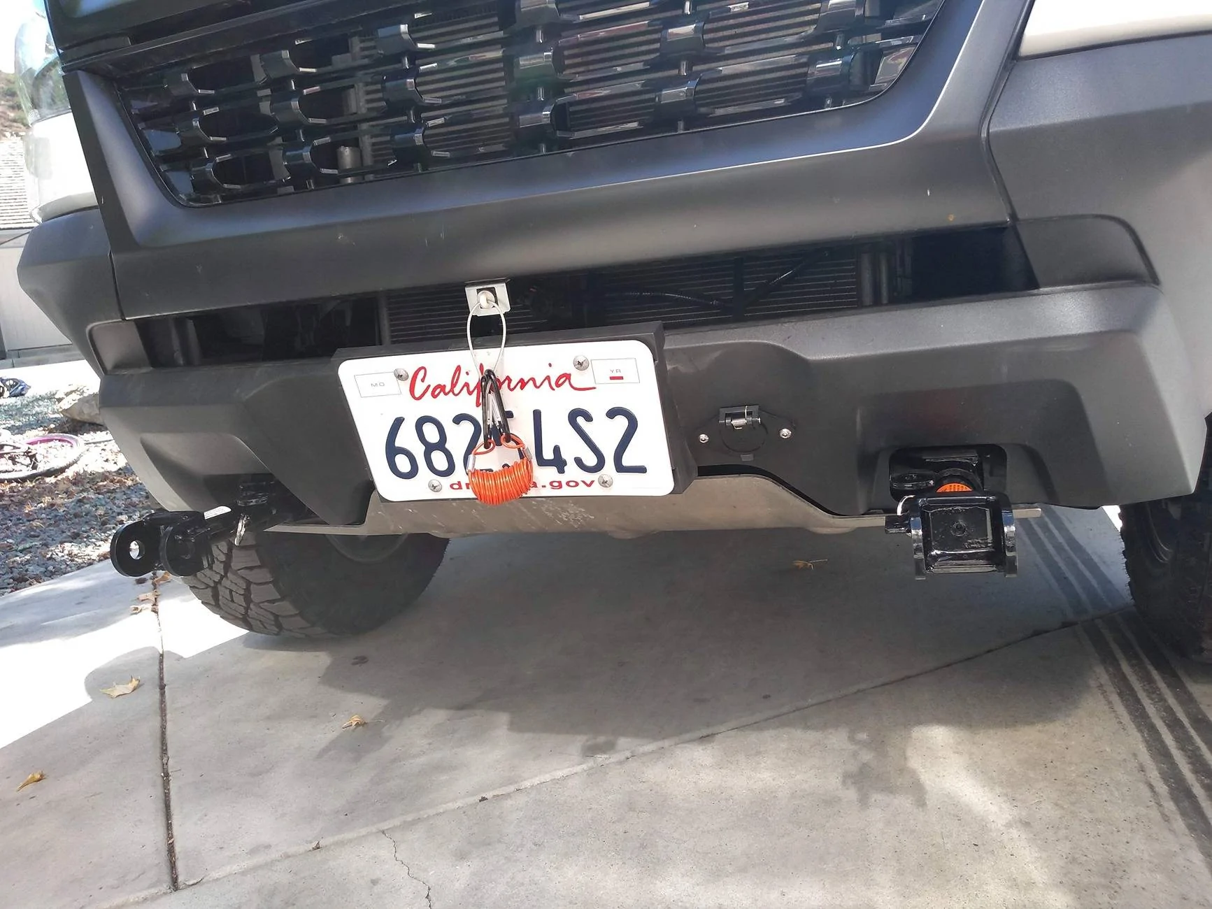

Double dutying my front tow hook for a whip flag mount
Of course the whip didn't arrive today, but the mount seems pretty good. I had to use some rubber tires for shims
Pin itself is 3/4

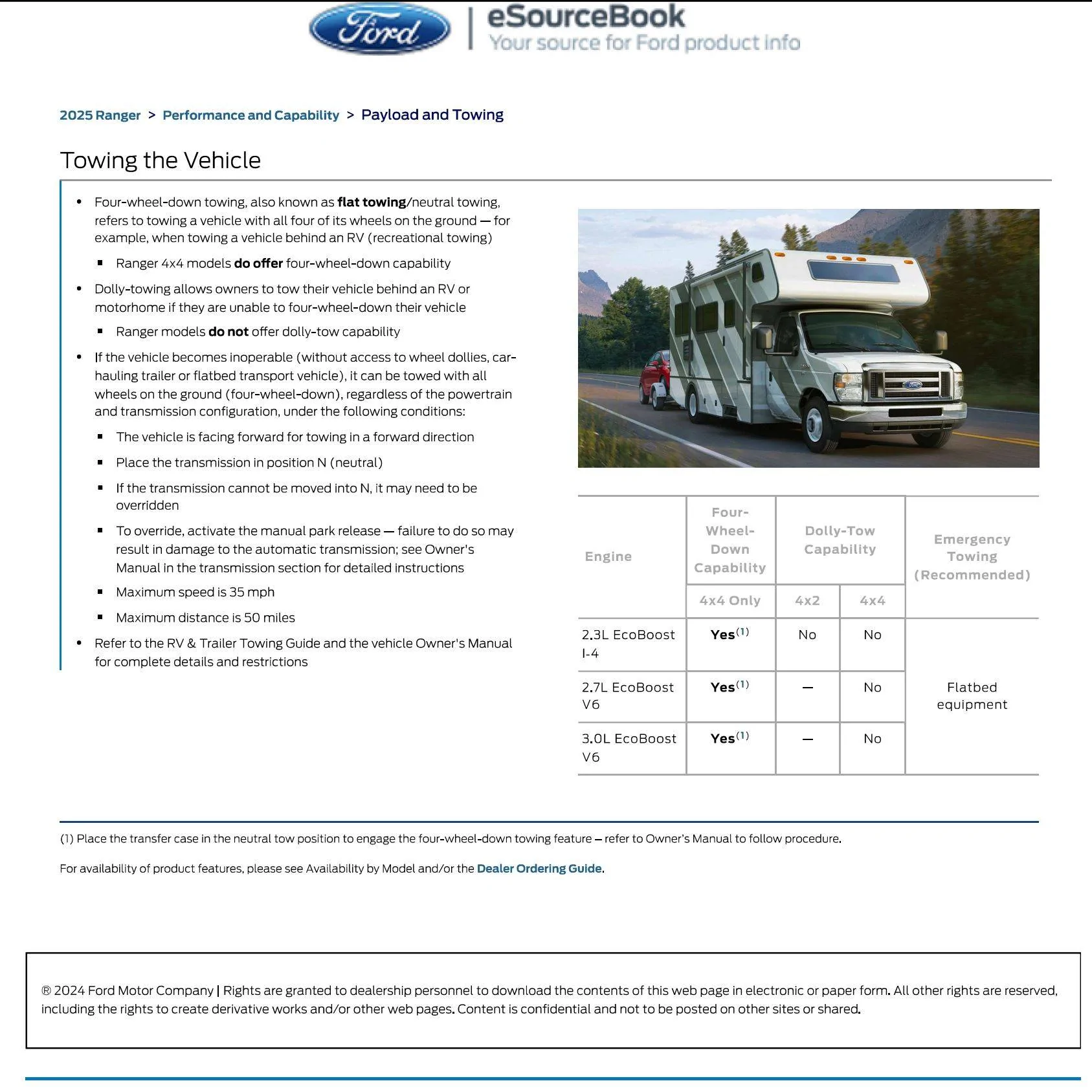

I flat tow my 2025 RR behind my Jayco Class C motorhome. Admittedly, the instructions to engage recreational tow are lengthy. (I have to sit with the instructions and read them each time I set the truck up for flat tow.) I don't tow more than 200 miles in one day, because I don't want to be behind the wheel longer than that anyway. But the truck tows well behind my Demco tow bar.
I posted last week about a guy from Canada I met whose 2025 model RR was built in October 2024 and does not have the electronic set-up for flat tow. I can't explain that. He tows his 2025 RR on a tow dolly with the drive shaft disconnected. 😕
