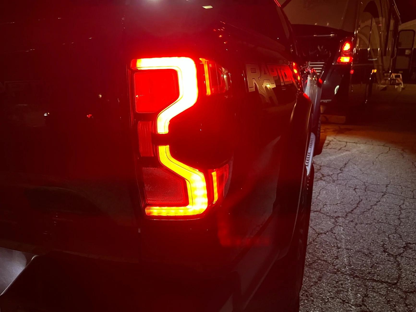

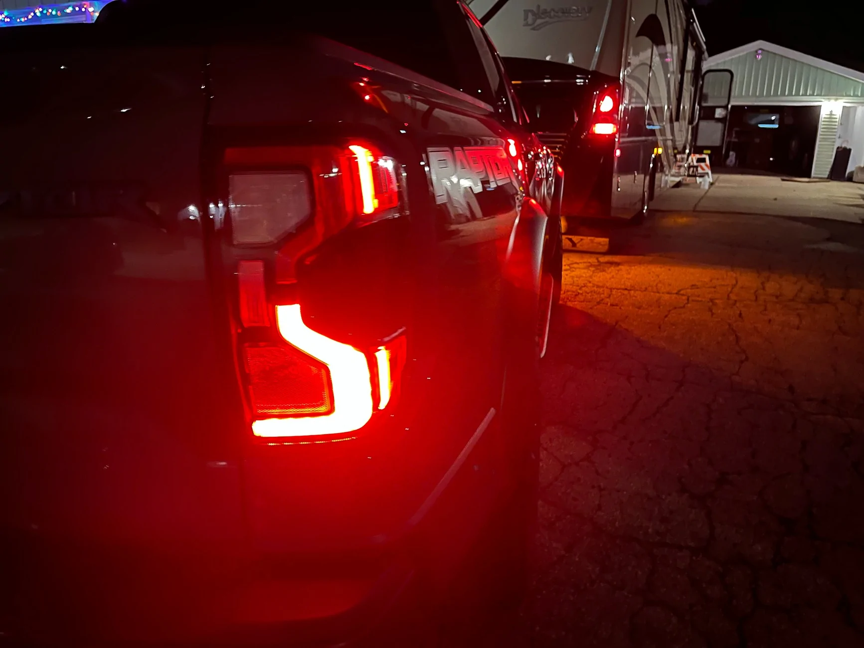

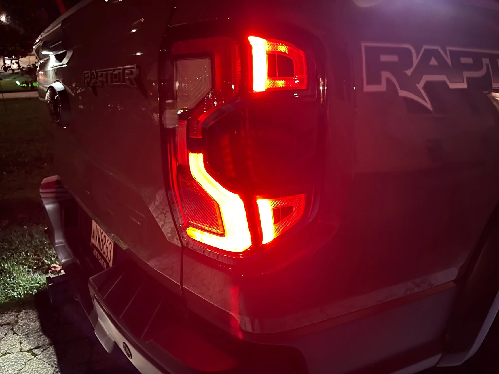

Songkaji-
I installed the Curt wiring harness to my Ranger Lariat. While the brake lights and turn signals worked as they should, the driving lights do not. The driving lights facing the rear do not illuminate, however the driving lights on the side do illuminate. Any suggestions?
songkajai
Sep 18, 2023
117
99
2025 Raptor Marsh Gray
If you did not see this already as it is posted in another thread. I went out and confirmed what actual lights work. The side and bottom C come on with the tail lights. The top is brake and turn signal. It is hard to see in the daytime but easy to see at night! The last picture is with brake light on.
Ford Ranger Setting up 2025 Ranger for flat towing IMG_0532
Ford Ranger Setting up 2025 Ranger for flat towing IMG_0528
