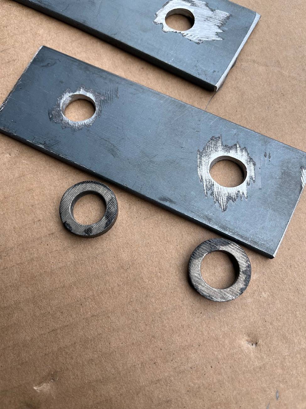

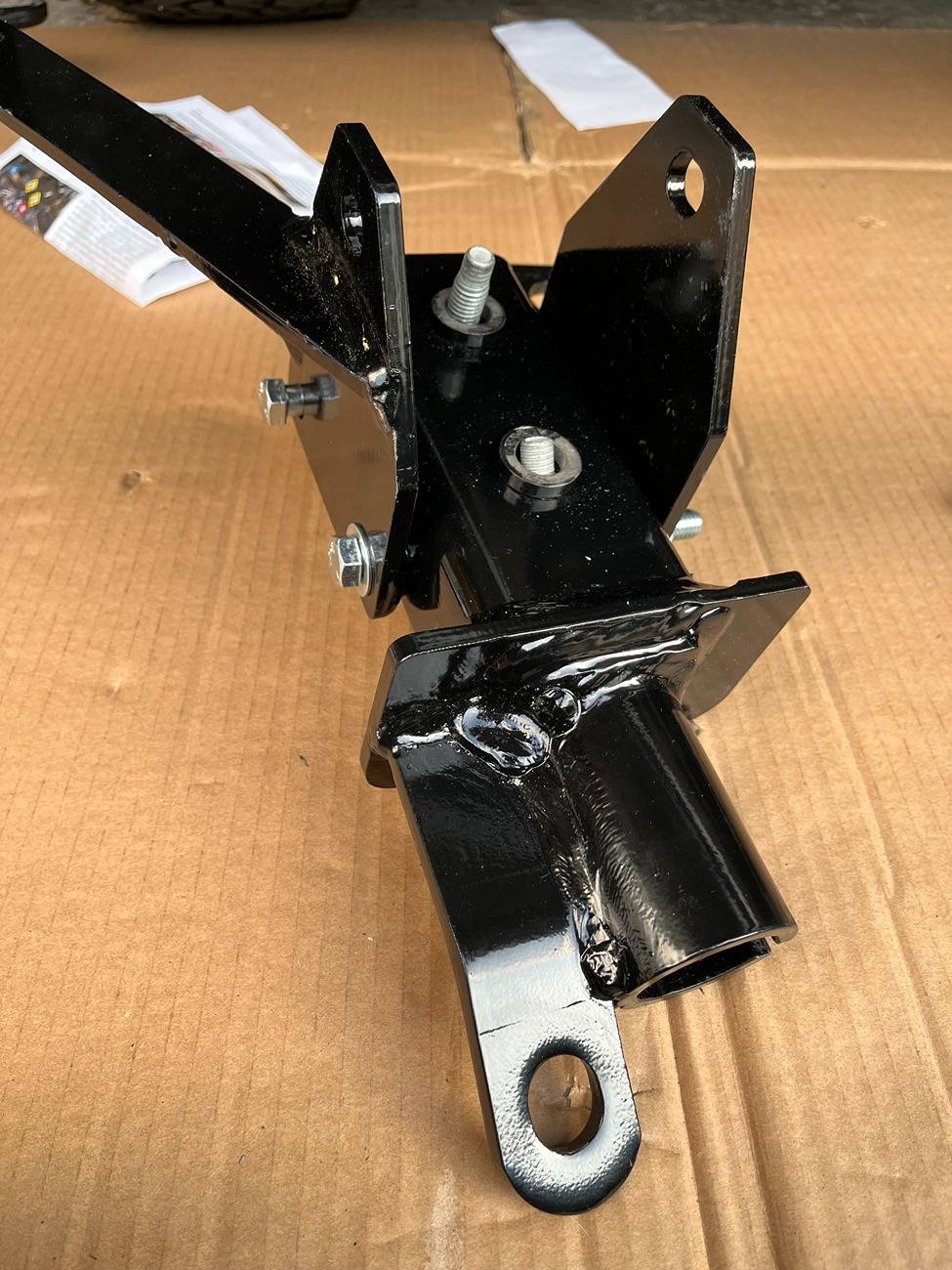

ON the base plate: They cut these stupid rigged pipe spacers to lower the bracket. This is really stupid and they did it because of the extra reinforcement on the frame. They should have just cut them back a little to fit and mount them higher, oh well.
The spacers are 3/16" so you need to make a 3/16" spacer plate as shown. The pipe spacers severally reduce strength, allow them to rock and were into the frame rail. This is also the main resigns for the side plates that go around the frame to support the rocking action. They don't do much for shear support. MOst of the stuff they tell you to take apart is to slightly inlarge the bolt that goes through the frame half way up. A bad spot and area that has no real support, the bolt would just rip through the unsupported frame. the bolts can be down sized to a 8 grade 3/8" bolt vs the 7/16" they provide. If not enlarging that hole, no need to take anything apart other than the skid plate.

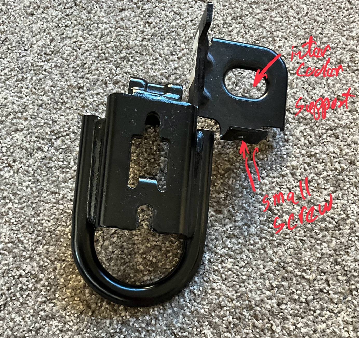

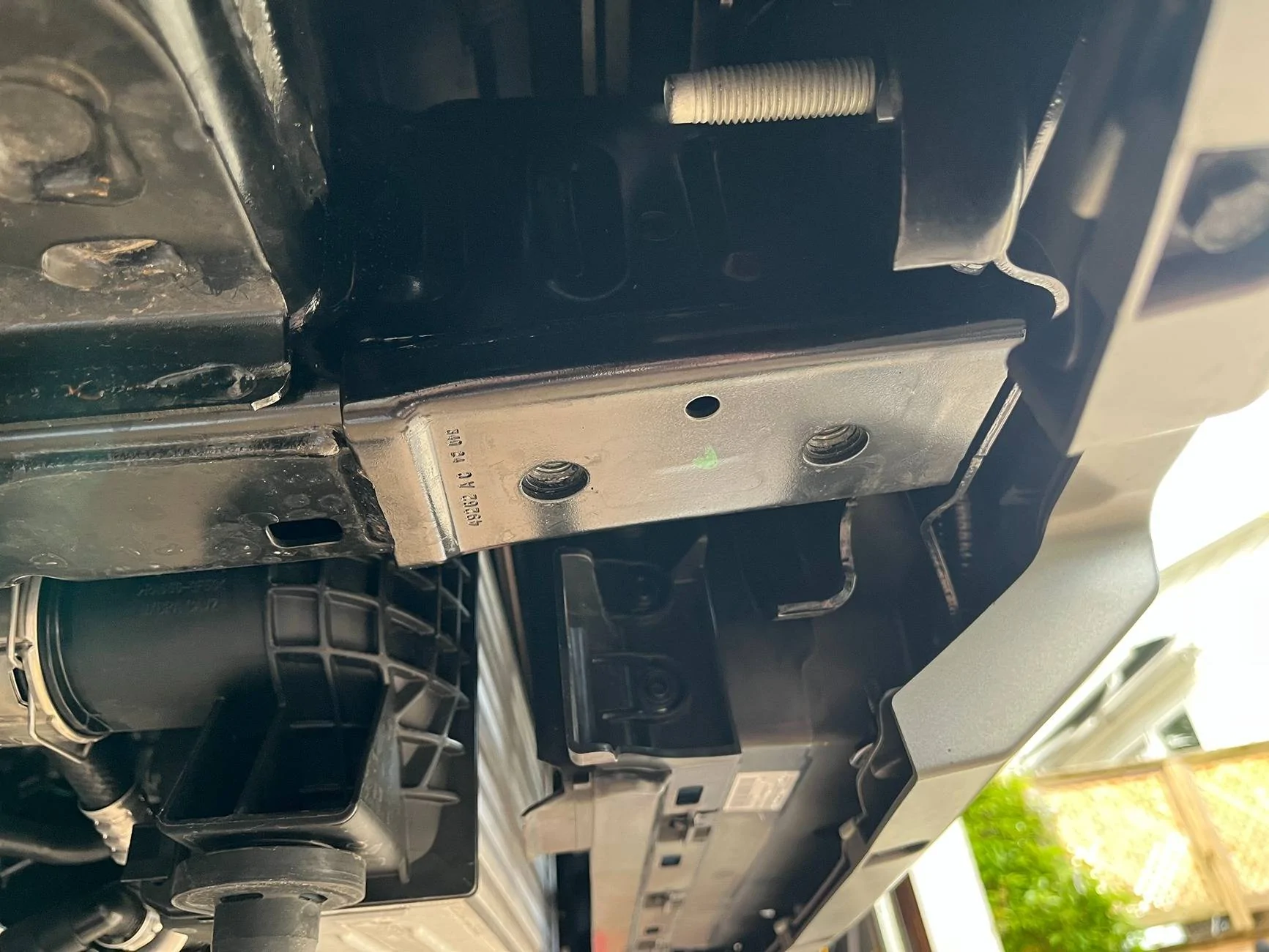

The new bracket has the support for the intercooler round rubber support. Then a small hole that was for the shutters. The new one just has a clearance hole and bolt included in the hardware of the base plate.
Found this picture that shows the bracket holes from the original tow hook and is same with the new base plate:

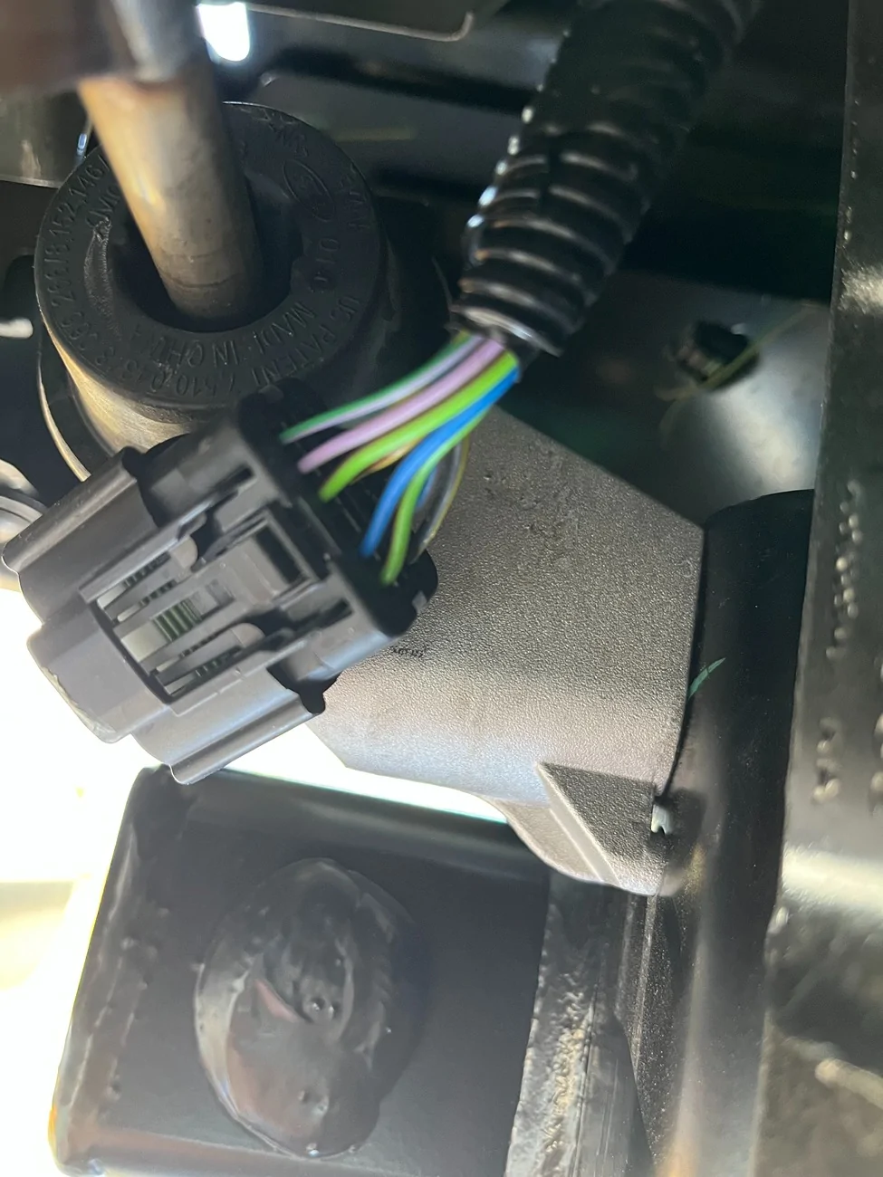

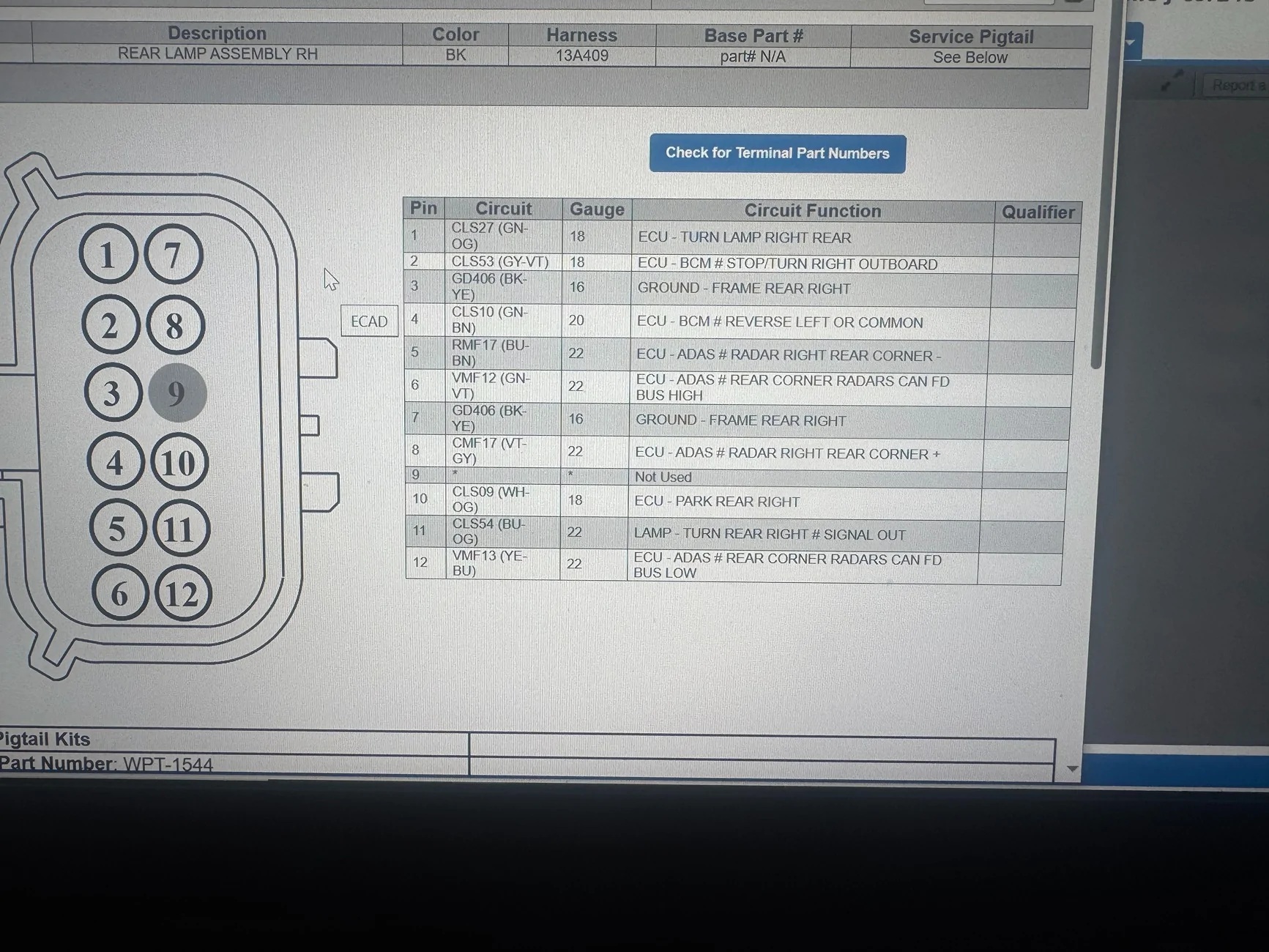

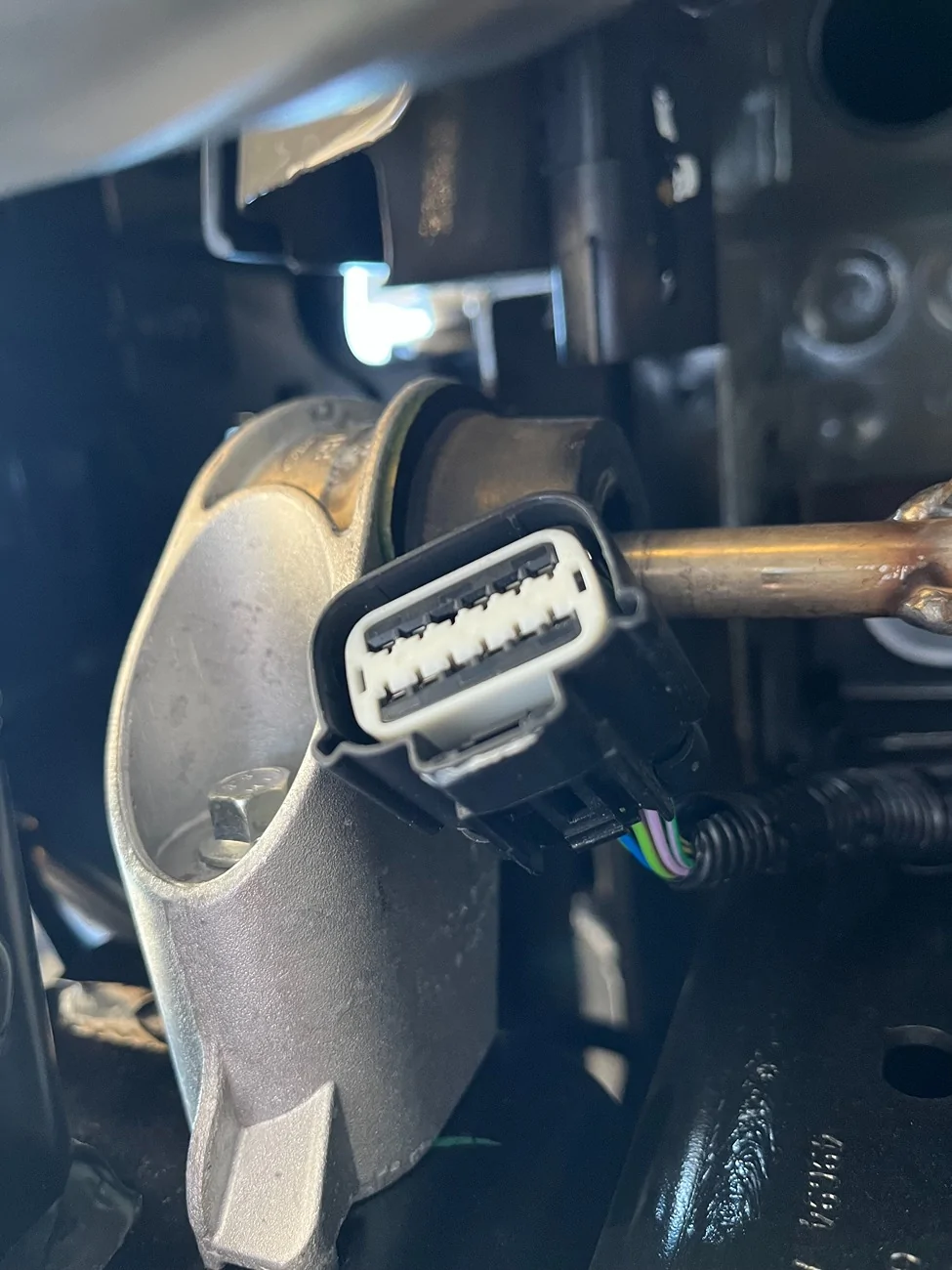

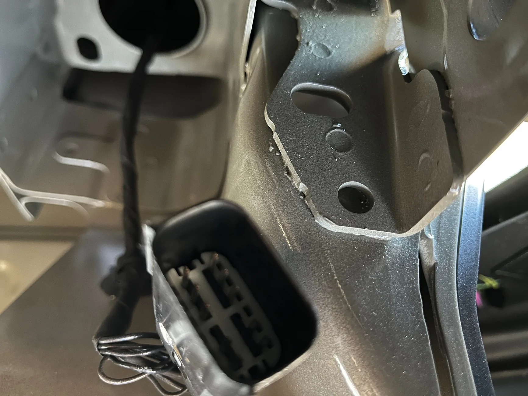

Also it plugs in on each side under the bed just above the tailpipe, below the taillight. Don't bother taking out a taillight as it is all molded together, nothing to see.
The wiring to down under the bed is around 10 tiny black wires. Good luck if you do like they say and use a universal kit!
The drawing below is the F150. The ranger does not use the ground on pin 3.
When you run the Curt harness run on the driver side following the factory wire. Their is a good ground point on the frame just in front of the spare tires. Inside the frame rail as I recall!

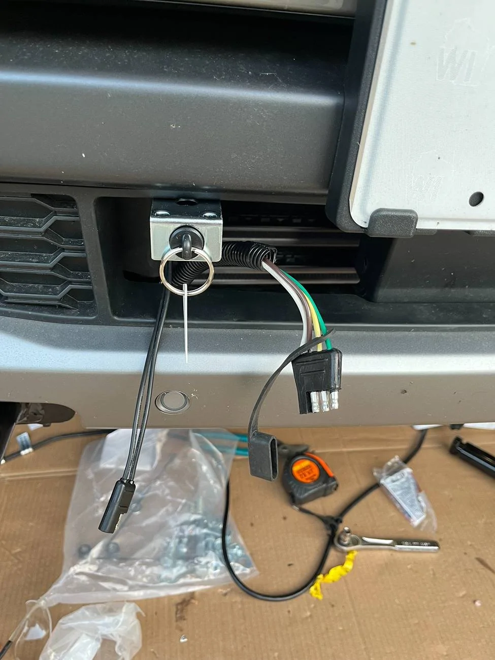

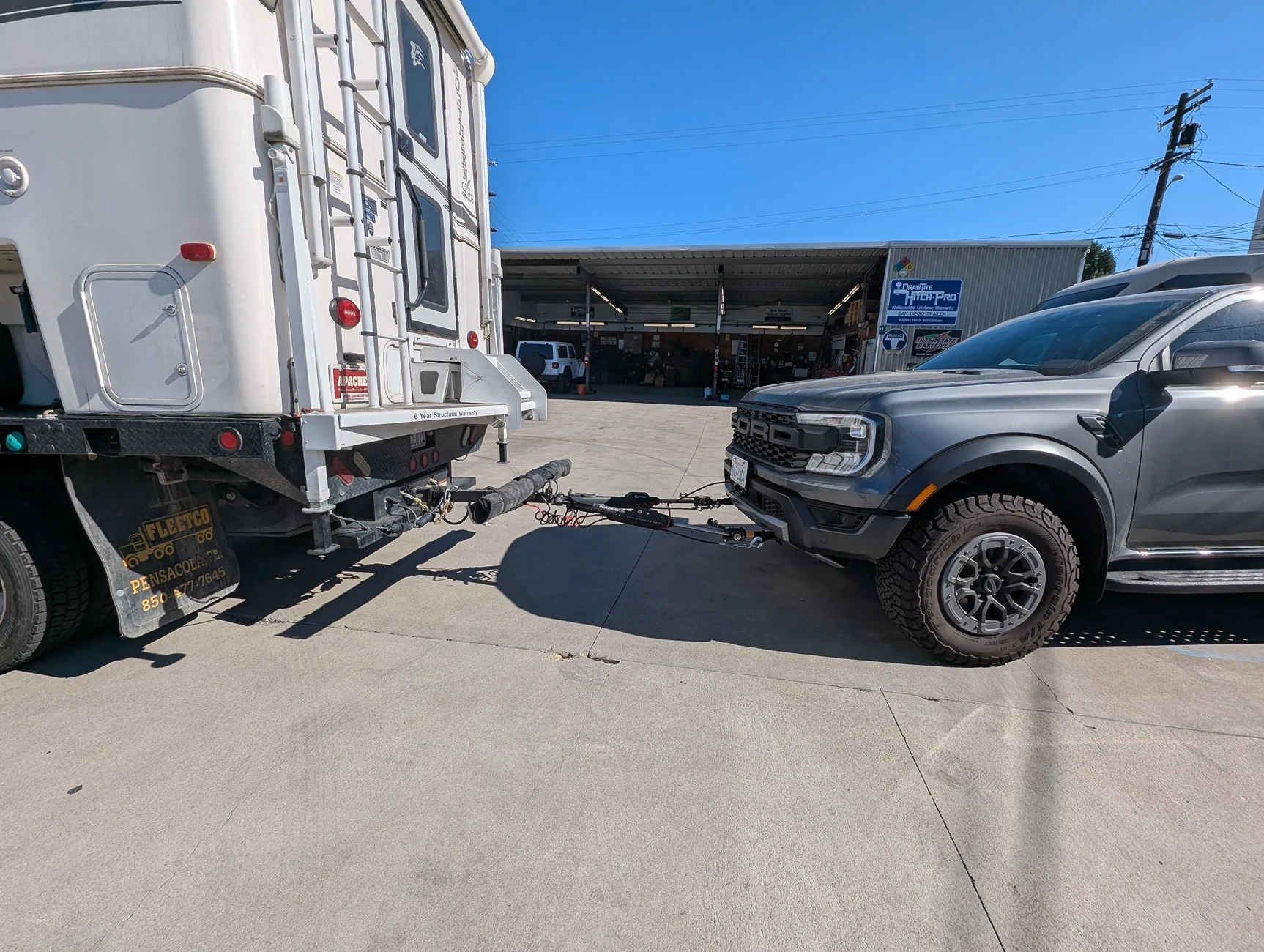

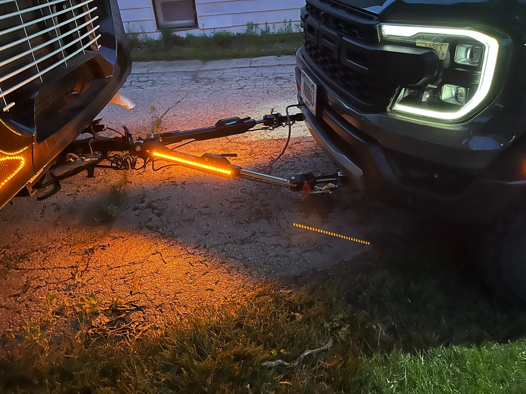

I had my setup installed and drove from San Diego to Telluride, CO where I am now. I used the curt plug n play (no disassemble tail light splicing diodes) brake wire adapter as reccd by another member
There are no one way diodes, so when the ranger brake (or head or parking lights) are power the truck campers lights illuminate too. Not really an issue as long as it doesn't damage the tow vehicles electrical
I also have a curt hitch 34" extension trimmed to 19" and mildly fabbed to clear the truck camper steps
Roadmaster nighthawk tow bar and Roadmaster quick release baseplates
Using Blue ox Patriot and Blue ox charge line adapter
I also have a roadmaster rock screen mesh product that attaches to the tow bar. Can see it rolled up in last pic, it unrolls, attaches to baseplate about 6x3' opened up

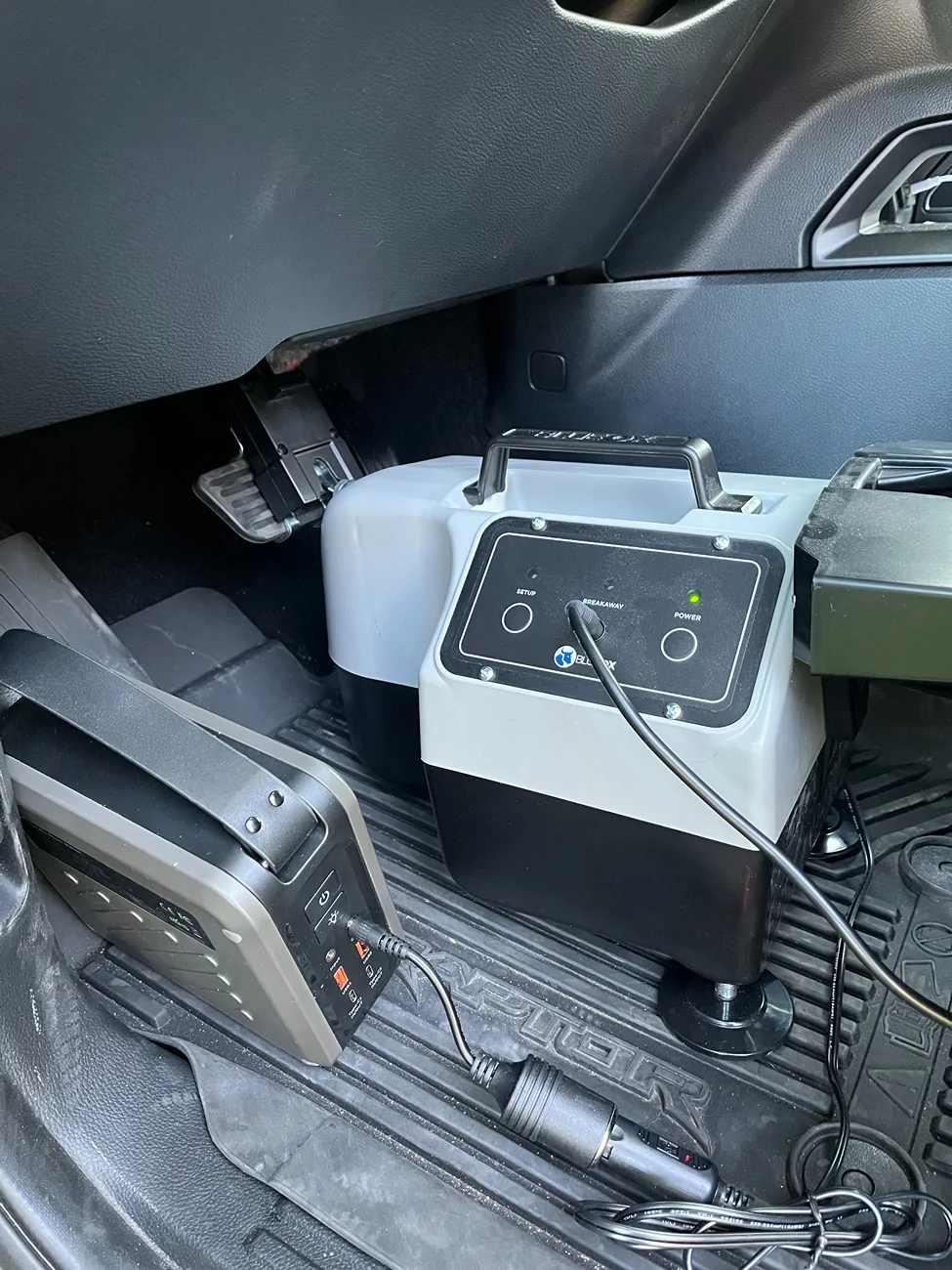

WE are using the 2025 Ford Ranger Blue Ox Patriot Portable Flat Tow Brake System - Proportional
Also Had a hell of a time with Blue Ox and the base plate. EEtrailer was also not helpful. Landed up calling Roadmaster and they had 30+ in stock and sent out the same day.
The Nighthawk is by far the best tow bar to go with as it is so tightly and neat.
We have every thing up and working for 500miles now.
The outlet in the truck does time out. Could have added an outlet but the brake controller only used 8watts so just use a little 292watt battery pack. With coupons about $65 ( Amazon.com: Newsmy Portable Solar Power Station 270Wh/72000mAh, 268W Max Output, 2×100W USB-C PD, LiMnFePO4 Battery with Spotlight for Hiking, Traveling & Emergency, Drone Charging, Compact Power Stations : Patio, Lawn & Garden )

I installed the Curt wiring harness to my Ranger Lariat. While the brake lights and turn signals worked as they should, the driving lights do not. The driving lights facing the rear do not illuminate, however the driving lights on the side do illuminate. Any suggestions?
songkajai
Sep 18, 2023
109
98
2025 Raptor Marsh Gray
Interesting, I use on a Raptor.
Above has another guy with a Lariat, his seem to work. He might have a comment.
Might want to look closely as we did notice a difference that is noted in these threads.
When the trucks driving lights are on, both the top and bottom C work on the taillights. With the wiring harness it seems only the top C works. Checked it at night and seems plenty of light so have not worried about it.
Not a lot of night driving anyway.
But do have a couple of ways to deal with it in a situation you want both top and bottom C are on on.
Just turn on the driving lights in the truck. They are all LED and will take little power, If you have charge, should not be a big deal at all. Or the app will send you a warning if the battery gets low.
Since the harness now makes a point that you could cut wires without damage to the truck wires you can find the correct wire for the bottom C and power that with the wire that is for driving lights ( brown wire)

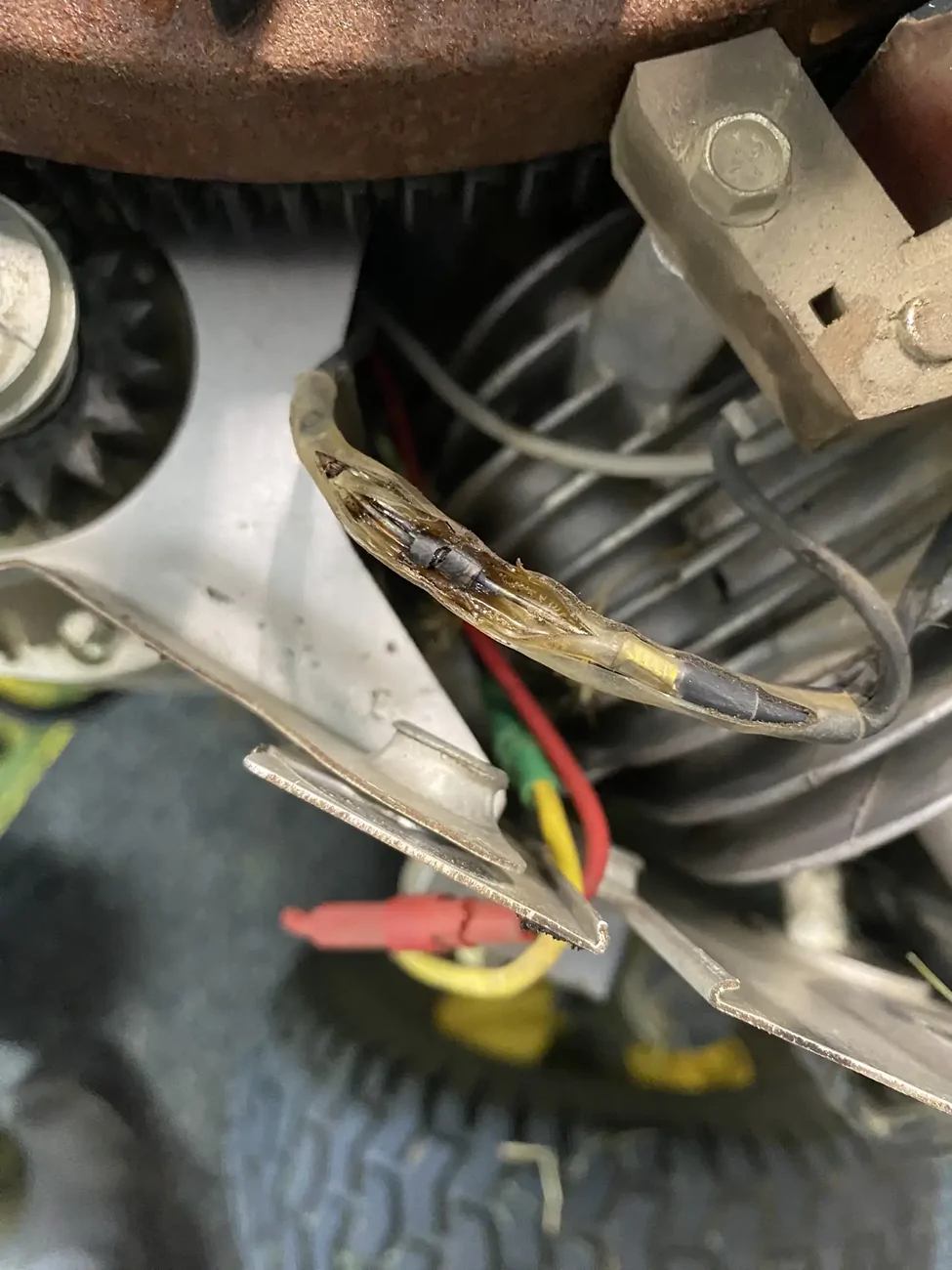

Reading your post again. It seems as if the diodes are wrong in the Curt Harness. The taillights should be on but not the marker lights.
This means the output is blocking the taillight and sending power back in to the truck.
That sucks but the diodes are wrapped up in the wire loon just towards the taillight connections. I would expect it is on the driver side for the brown wire. Have to find they diode on the brown wire, the diode should be going to the truck connector. Not the connector going to the taillight . Check it with a multi meter before cutting it out. The other option would be cut the corresponding wires to the in/out side of the connectors and reverse them at that point!
Sure taking it out for a replacement is also a B###h so up up to you how to deal with it!
The diode looks kind of like this, the ring/marked side is the output.
If you take it apart and find the issue, take some pictures and post here for others that might run into the same issue
