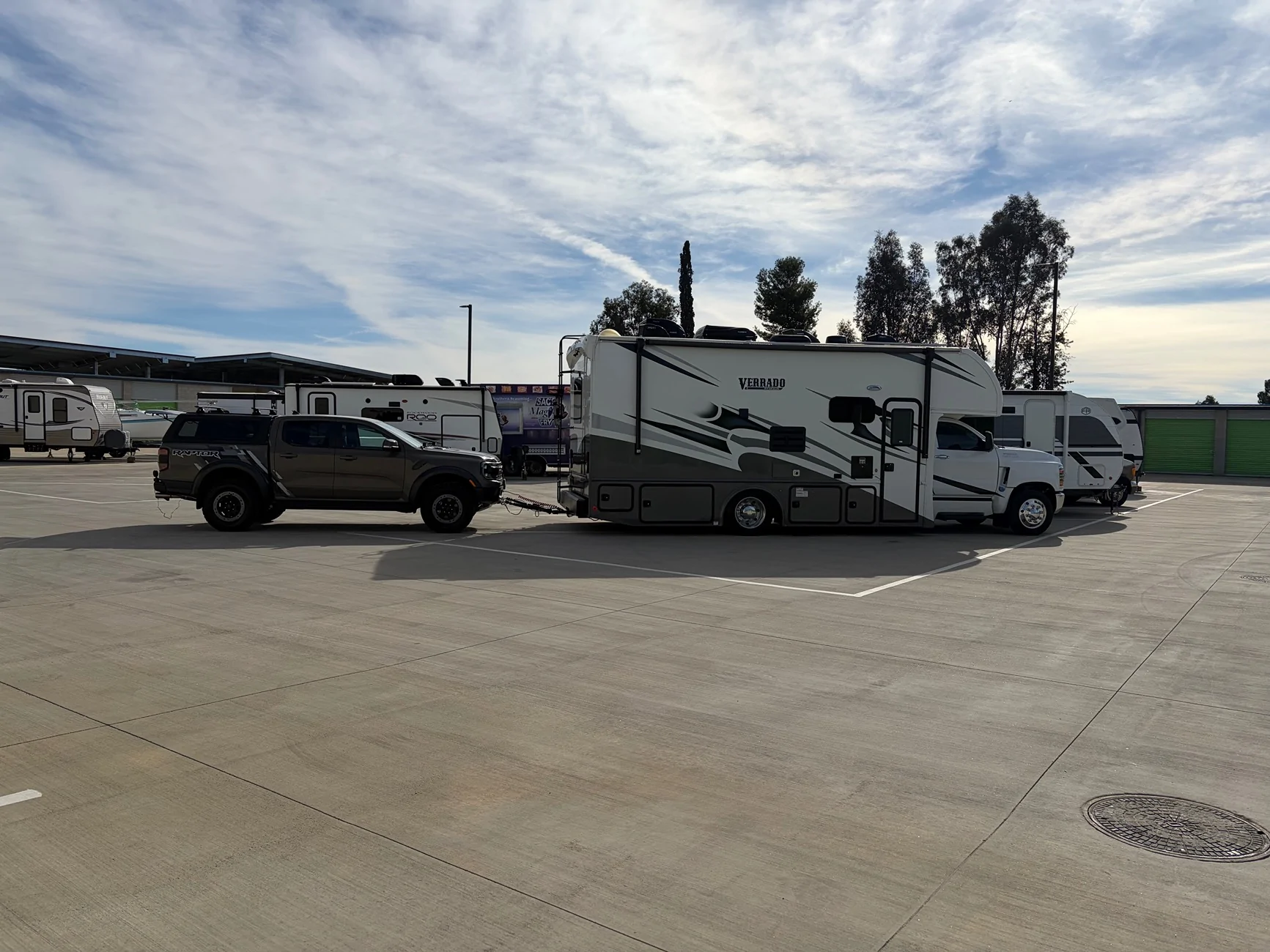

My flat tow set up
ckraptor
Cameron
Sep 23, 2025
MURRIETA CA
2025 Ranger Raptor Marsh Gray
2023 Nexus Verrado/ 2025 Ranger Raptor - Air ride is dumped thus the low riding motorhome lol
Ford Ranger My flat tow set up IMG_0002
Ford Ranger My flat tow set up IMG_0003
DJRR5325
Anonyme
Oct 5, 2025
58
60
Here and there in the west

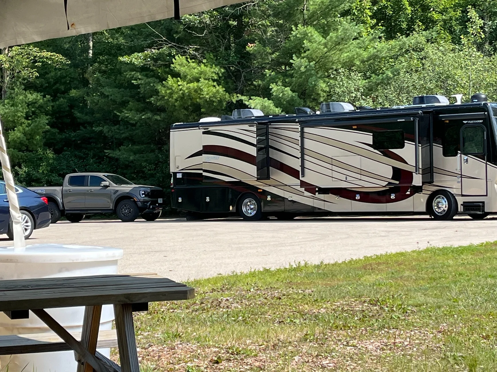

In an RV park at Coachella last week, I had an interesting conversation with a Canadian who is wintering in the USA and has a 2025 Ranger Raptor. He didn't see me come in, and came over later to ask how I tow my RR. (He has a Class A motorhome with a tow dolly.) When I told him I flat tow my RR, he said, "No, you can't." He tows his 2025 RR on the tow dolly with the drive shaft disconnected.
Long story short- his RR was built in October 2024 and has no controls in the panel for flat tow. It only has the 30-minute neutral tow. His owner manual has no narrative about flat towing. My RR was built in June 2025. I have lots of info in the owner manual about flat tow (pp. 184-186). I, of course, have the electronic controls for flat tow. Although I was at first nervous about flat towing because of the complexity of the set-up, I've now done it enough that I am very comfortable with it.
So.... it would seem that, at some point in the 2025 build, the RR electronics did not have the ability to flat tow but by the time my truck was built, flat tow was "built in."
Would that be an appropriate assumption?
So... if I were someone seeking to get a used '25 RR to flat tow, it might be wise to take extreme caution to make sure that the electronics for it are "built in" and the owner manual has the instructions. Right?
I sought out the '25 RR because I knew at the start I was going to flat tow, and none of the other Ranger equipment packages would allow that. During the purchase, my dealer assured me repeatedly that I could flat tow. I asked for it in writing, but never got that written confirmation. If I had been like my Canadian friend and discovered (after purchase) that flat tow was not possible because my truck was an early build... I don't know what I'd have done. But I'd be upset.
(There's no way I'd mess with a tow dolly and disconnecting the drive shaft every time. No way.)

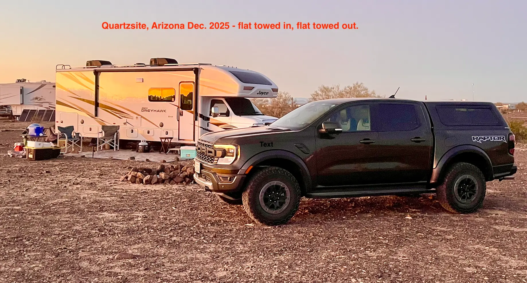

Ford Ranger My flat tow set up 2025 RR

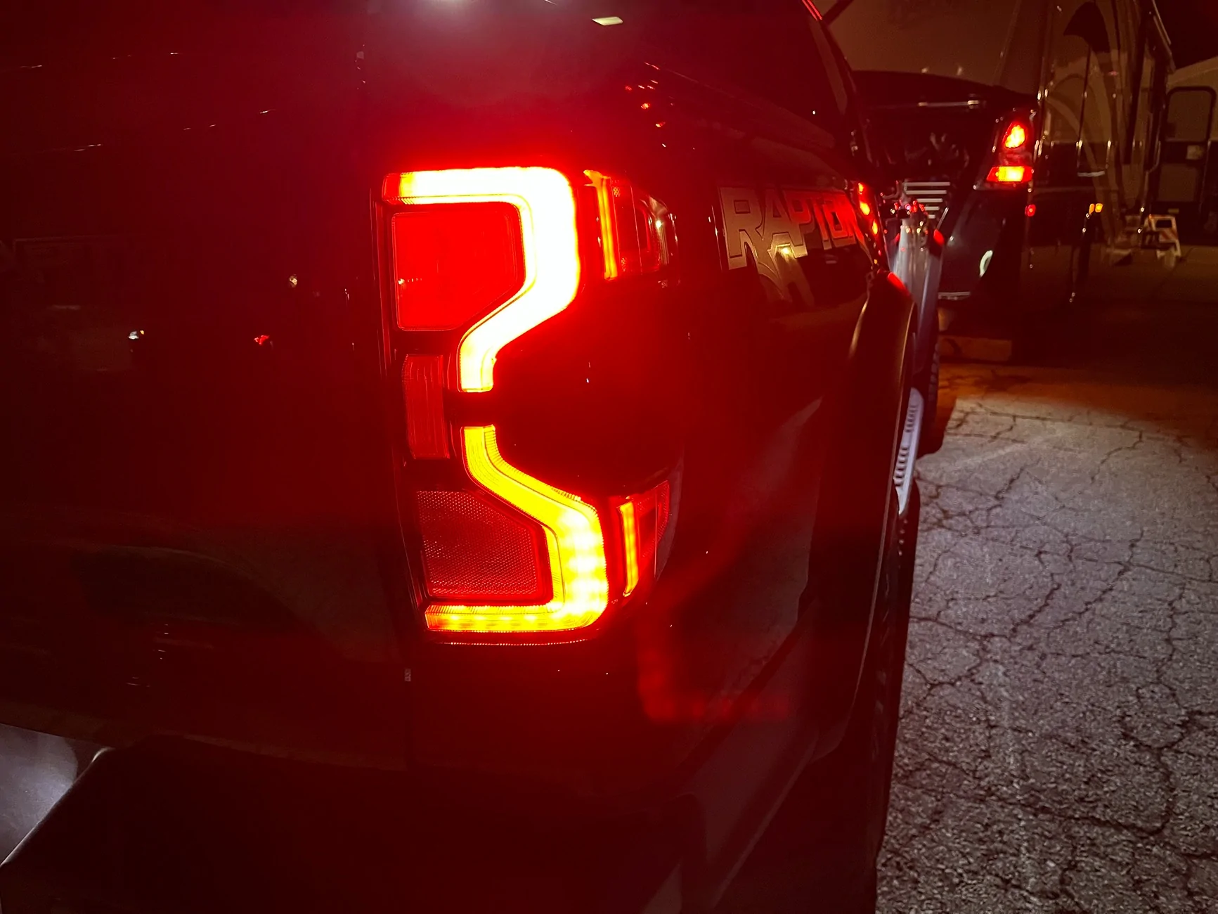

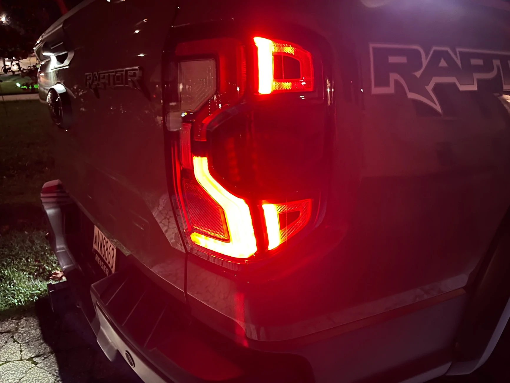

This is well covered in other post. And yes you can use the taillights without a single wire damaged: plug and play!
Here are the taillights, the next is the brake tight with the top C active.
