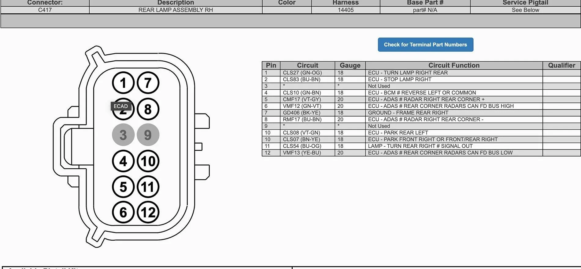

Thank you for everyone's replies. I verified the pin location for the parking lights against the chart below and by using a test light. Double checked my wiring and tested the diodes to ensure everything functions correctly. Interestingly, with the truck parking lights on, pin 10 lights up my test light clear and bright as expected, but pin 2 has a faint glow almost as though there is a stray voltage. Pin 2 lights up when the brake is applied. Does this stray voltage somehow play a role in lighting the rear facing parking lights? I'm not sure where to go from here.
