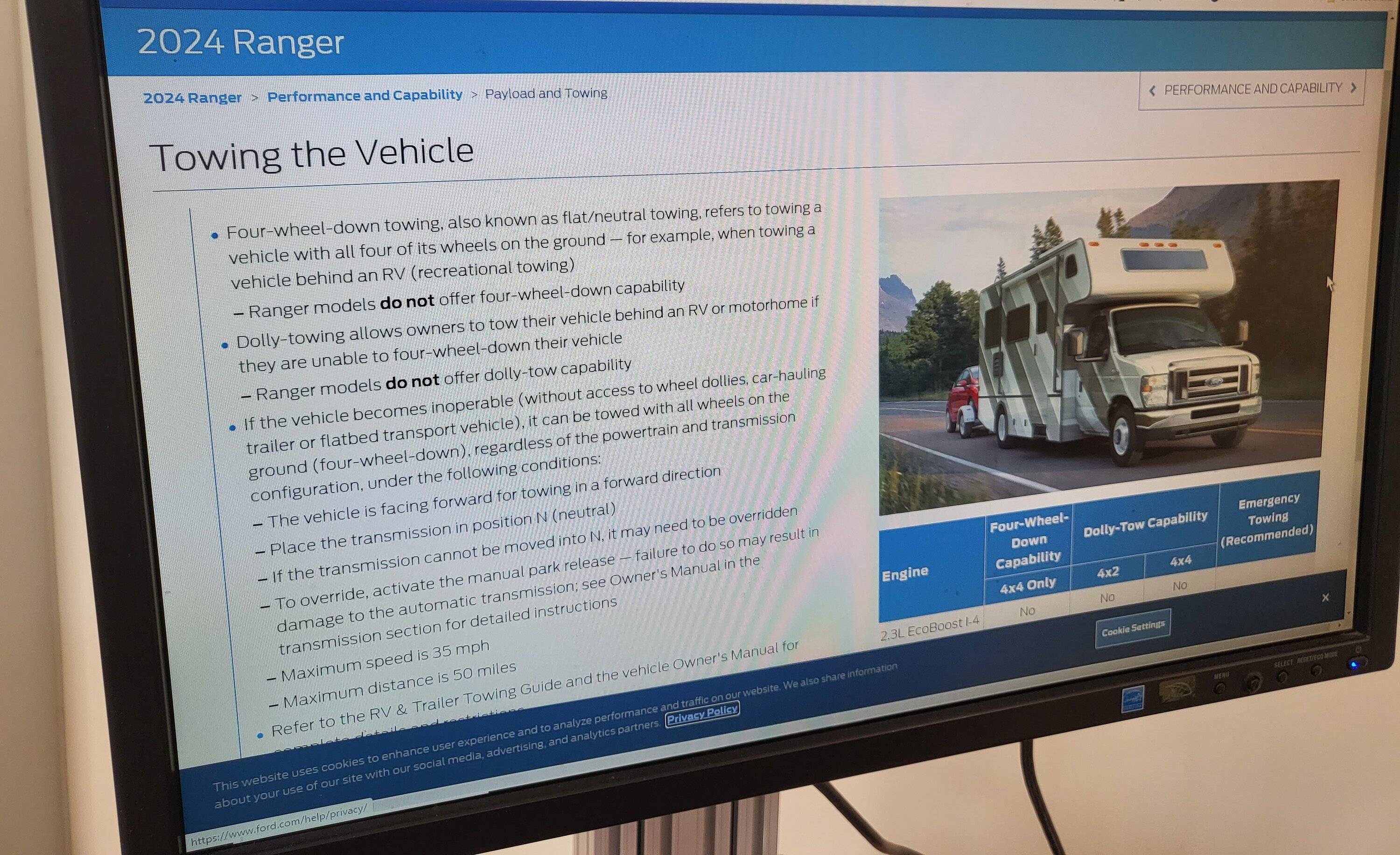

Went to my dealer today and after a bit of searching, we were able to find this page. No ifs, ands, or buts. 24 will not be a toad.

That's the page I was shown. Thanks for posting, saving me a trip.

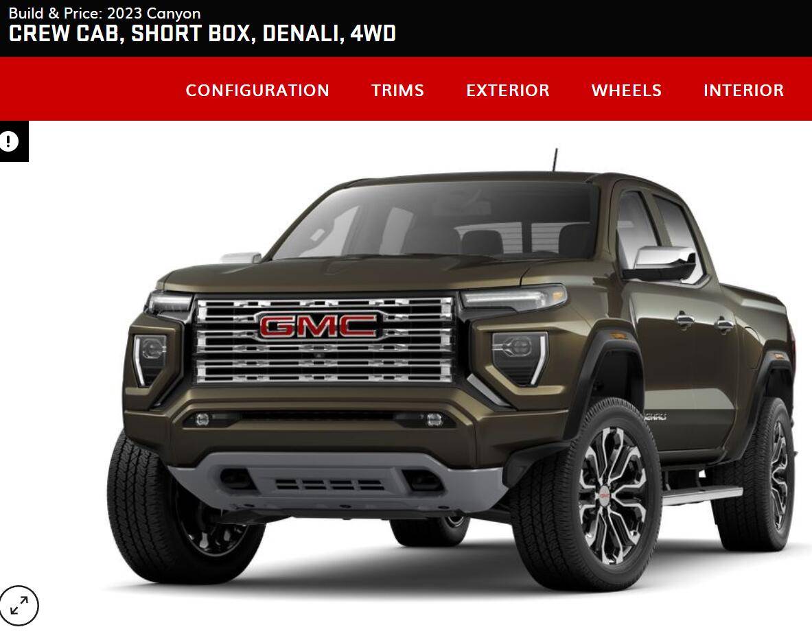

I looked it up - for my self also, yes... this truck is flat tow in specific configurations (4x4).
From the Build and Price on the GMC site.

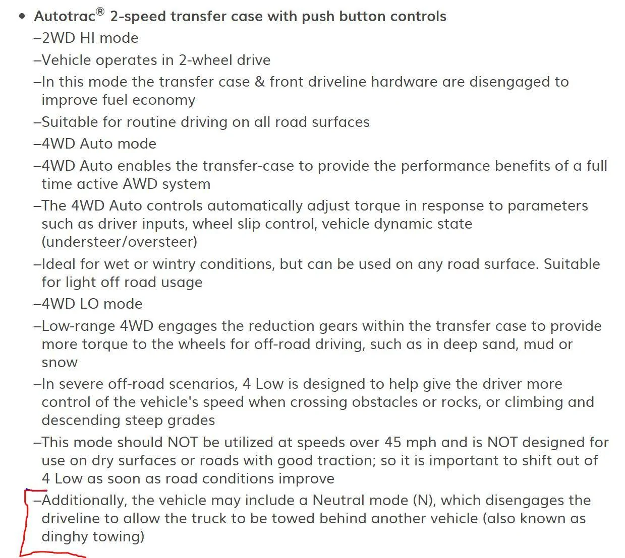

Summary of the build I'm looking at...

The GMC owners manual is also available online. I’ve searched it and can confirm that it has instructions for flat-towing.
