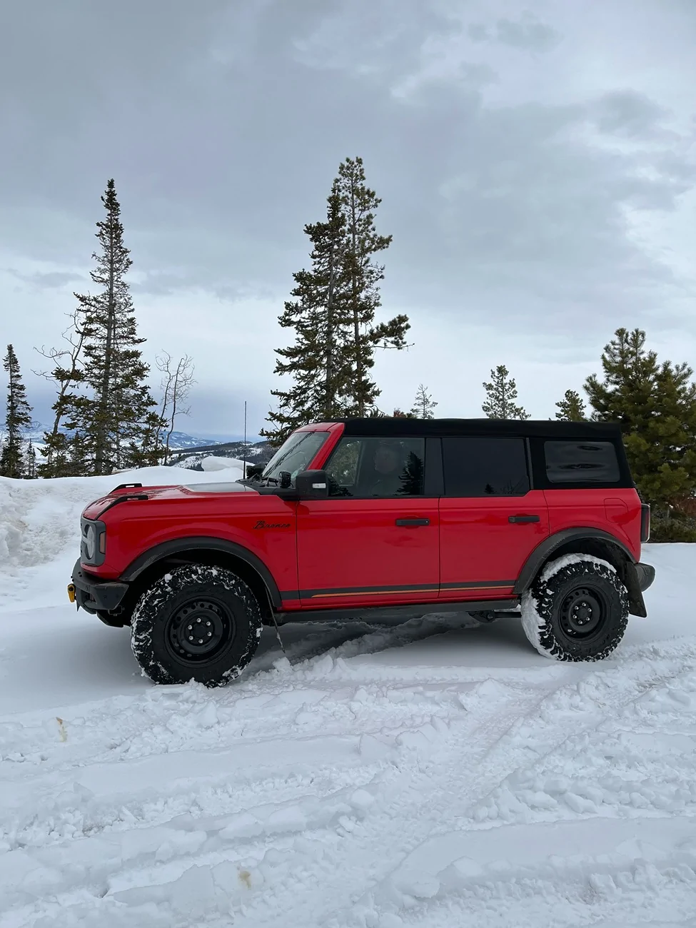

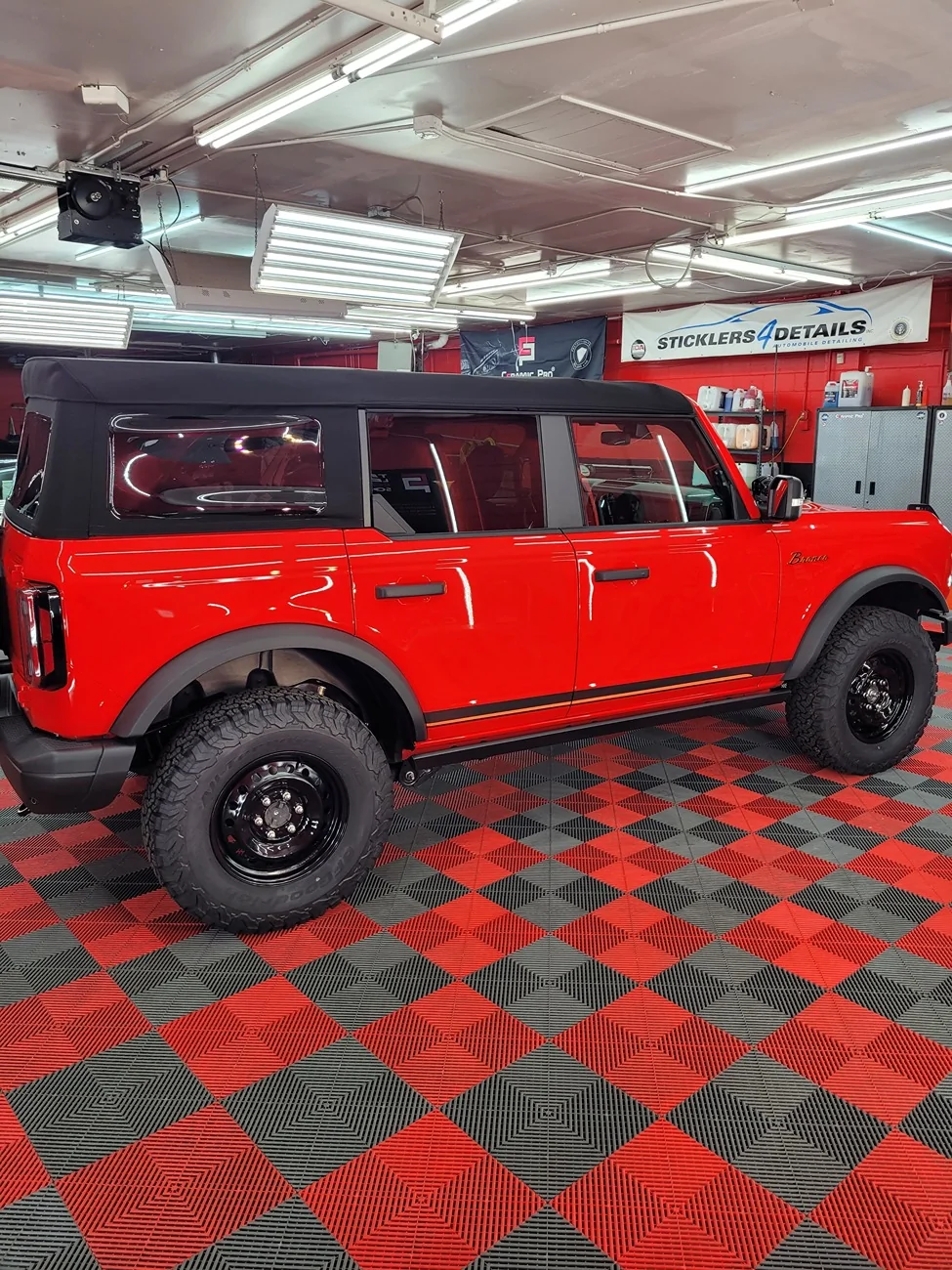

My Bronco currently has the 7.5x17 steelies on it (with 285/70R17 KO2s) and I love the look. BUT to go to any larger tire I must consider the wider 8.5x17 steelie. Anyone have the RR spare wheel that you would part with? Thank you.

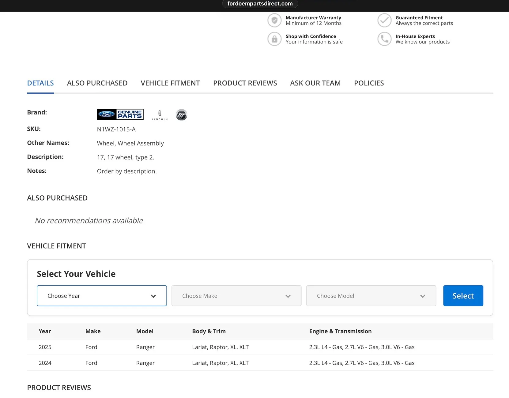

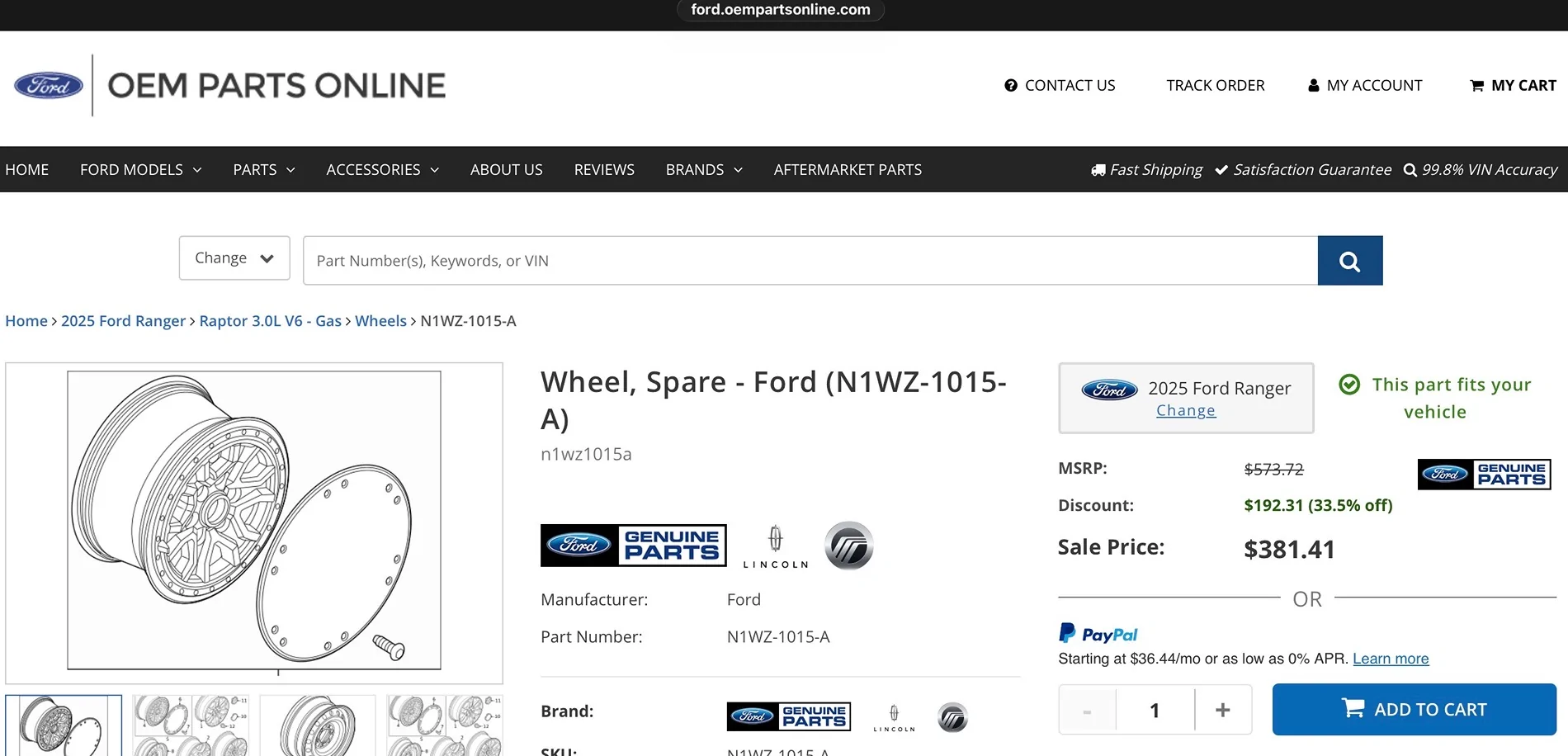

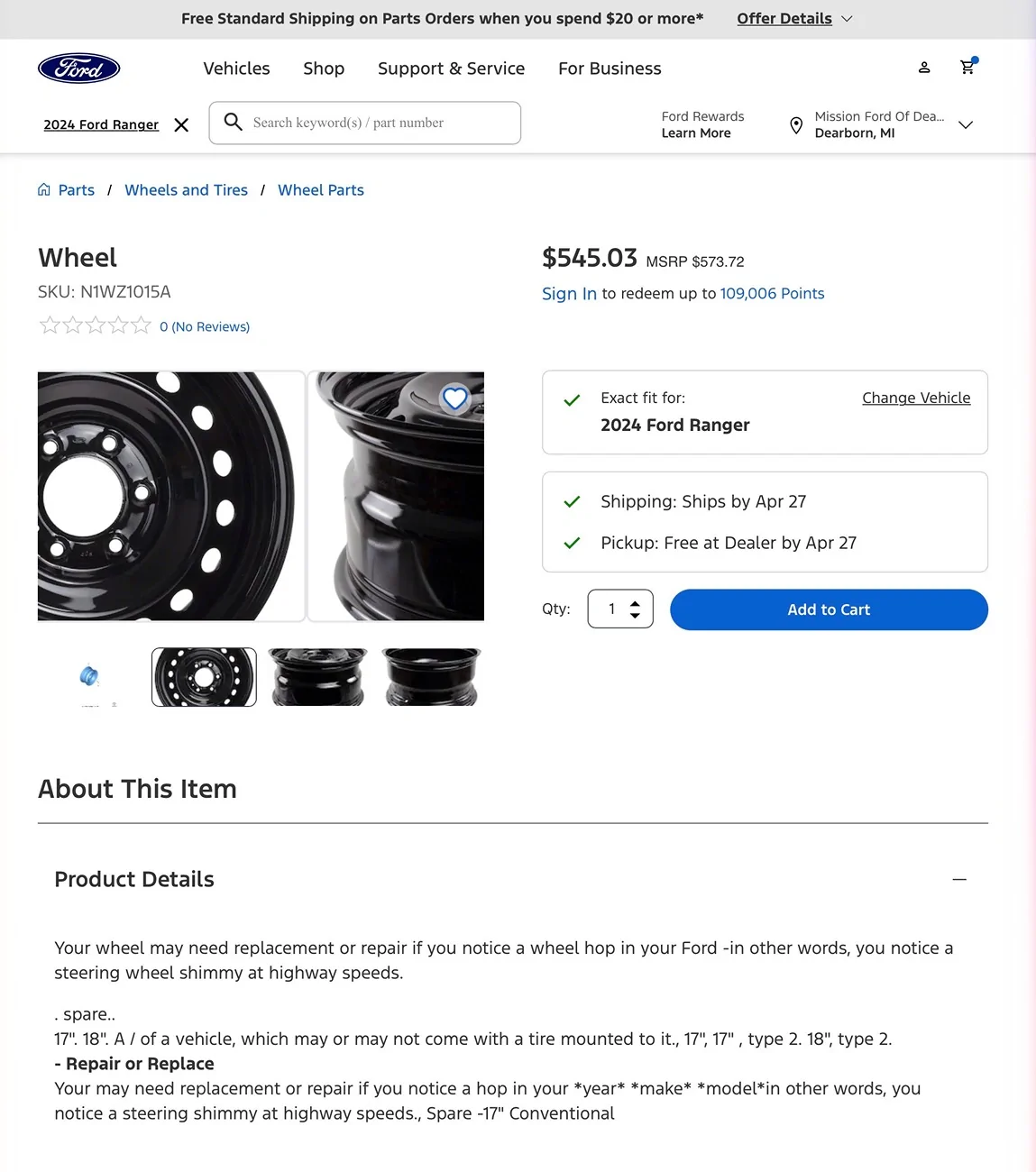

This is the part number I got using one of my RR vin numbers off the ford website.
SKU: N1WZ1015A

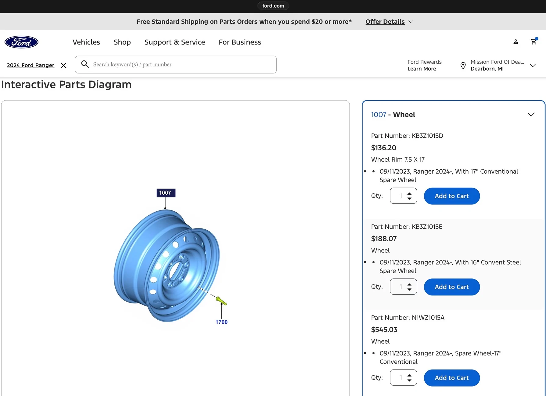

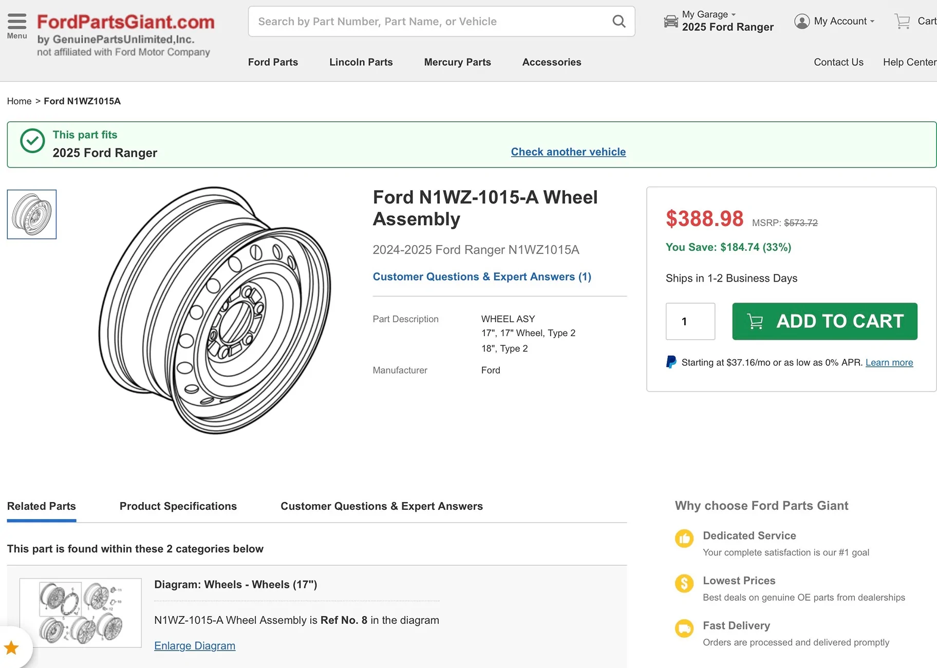

Only thing I found odd is or rather why I speculated it was a 7.5 was because it shows to be the same spare wheel part number for all the rangers. Most or all non Raptors use use a 7.5 aluminum wheel.

Thank you for your effort... Yes, that is the stock 7.5"x17 Ranger/Bronco (non-Raptor) steel wheel. I currently have them on my Bronco (look at the pics). They are available for $30-$40 around here all day every day. I also have a 2024 Ford Ranger RAPTOR steel wheel that is 8.5"x17, off of my neighbor's stock Ranger Raptor. He gave it to me because he wanted an alloy spare. That pricing that is showing is crazy out of line!!
