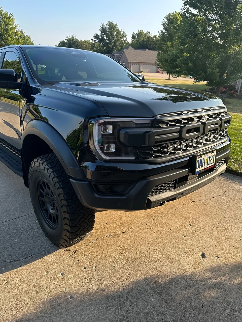

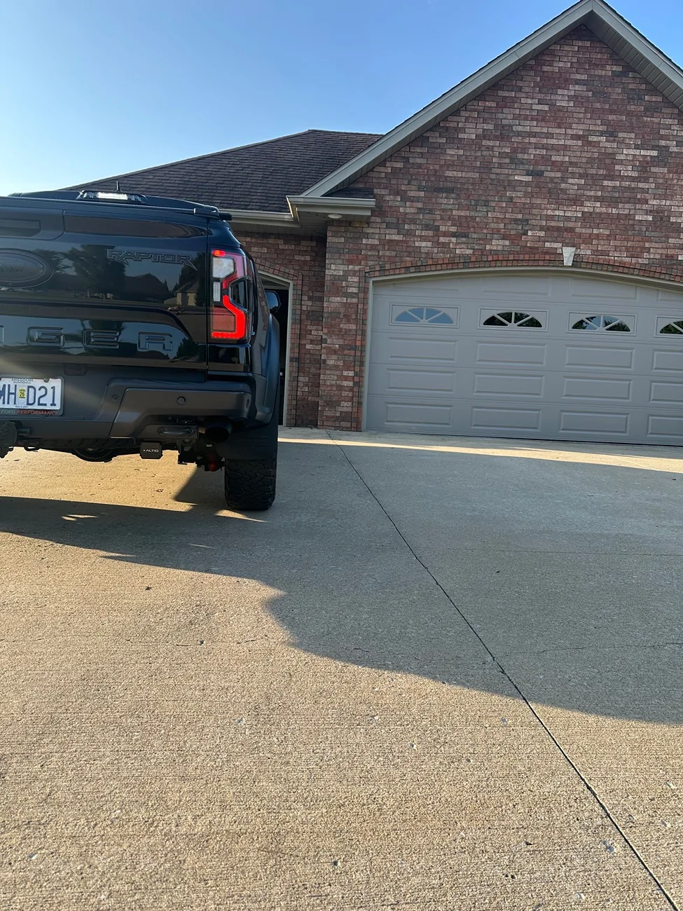

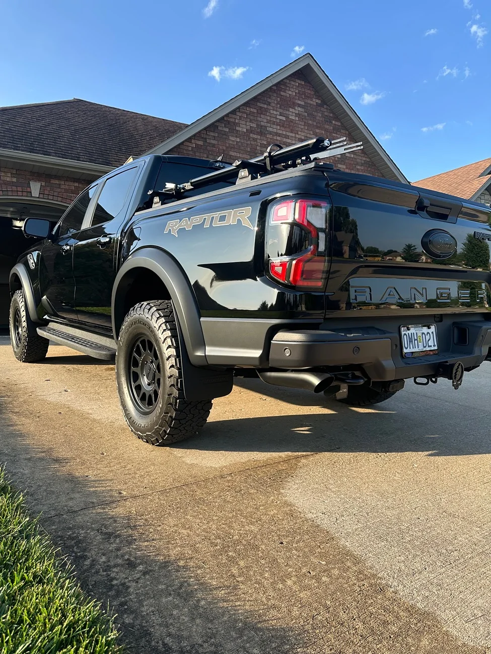

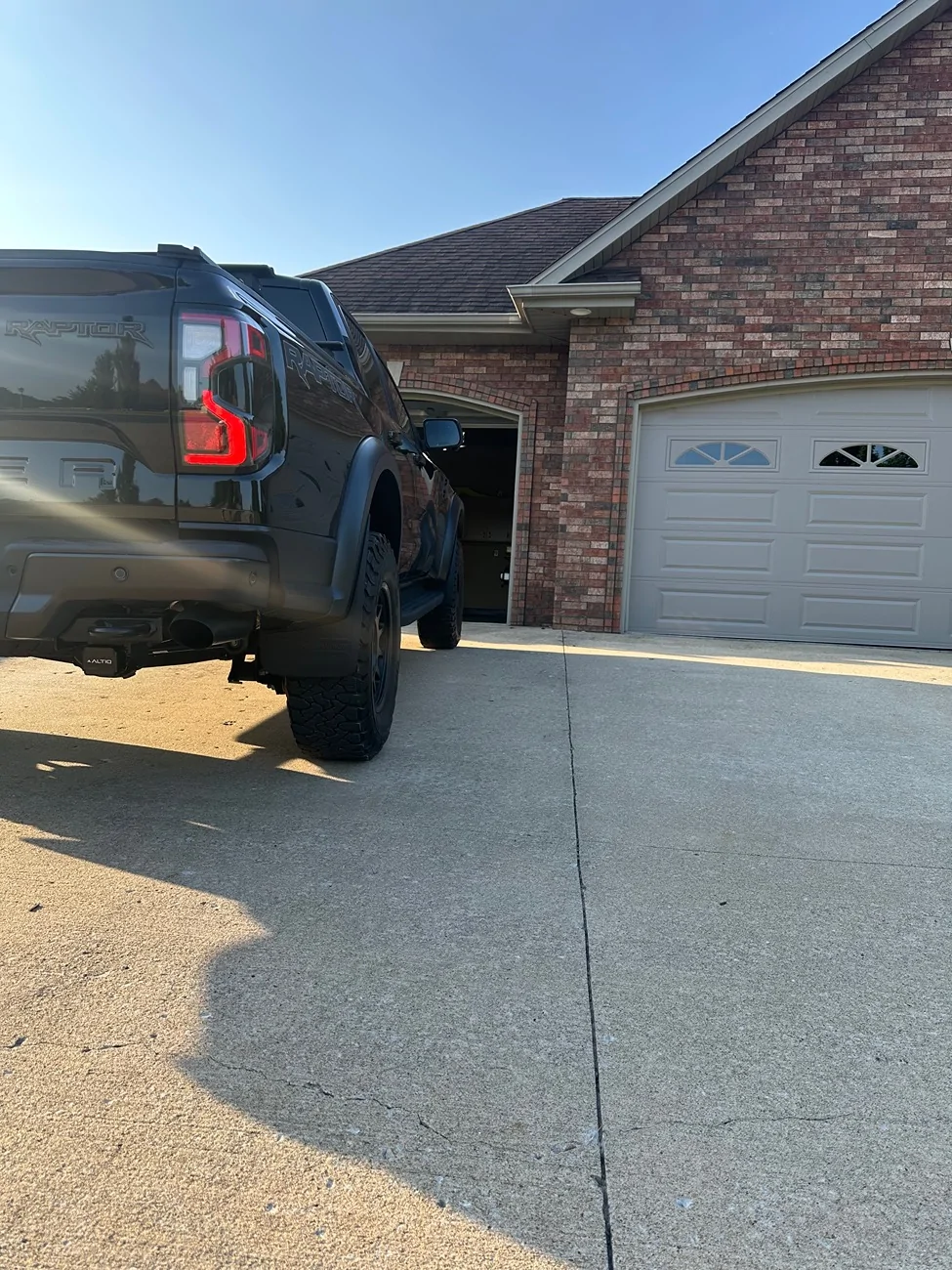

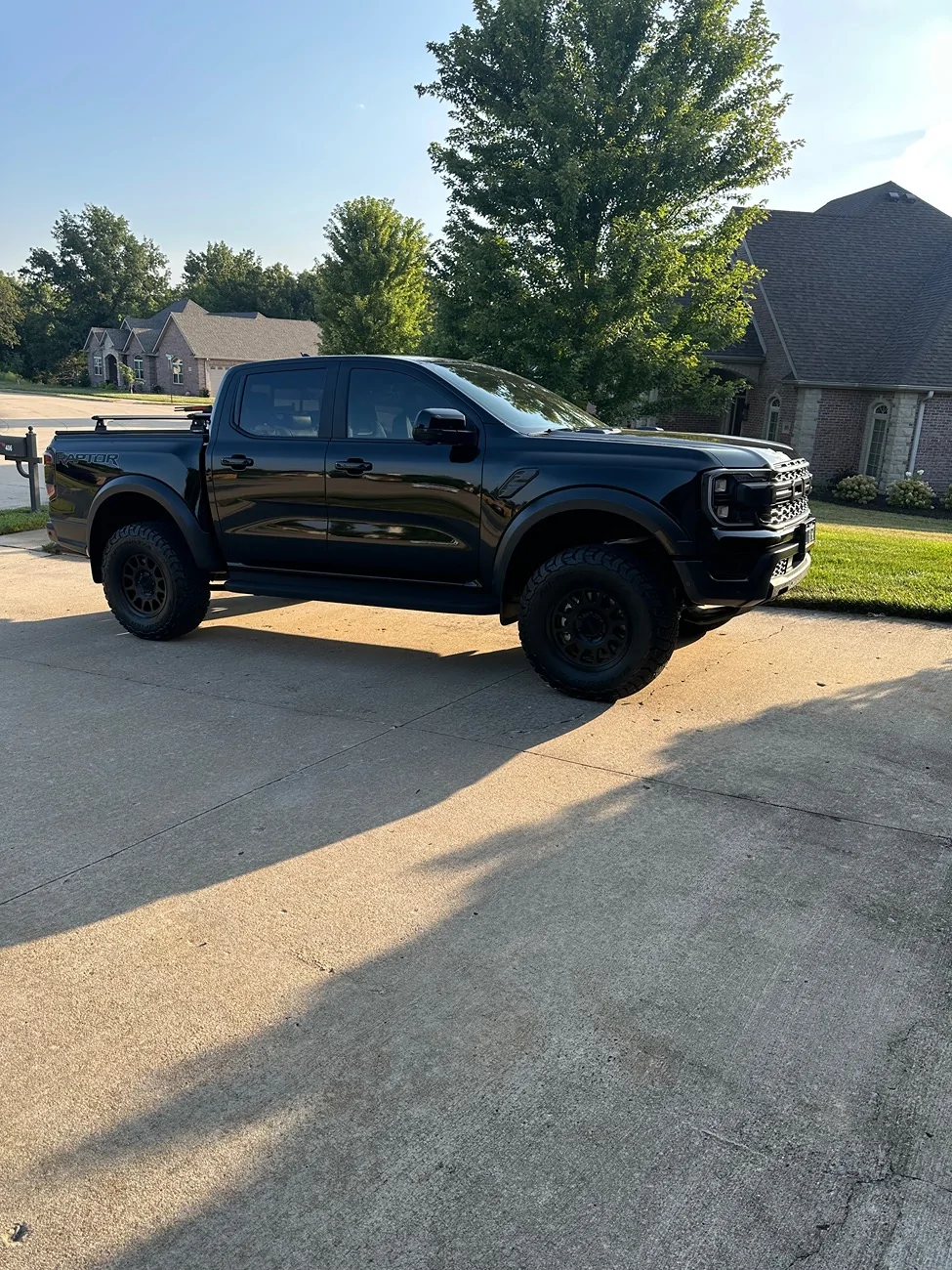

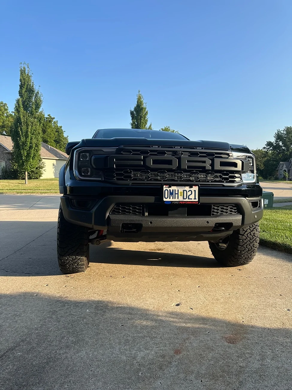

Pictures requested for the 703 with 35 offset please @GLW ! Would love to check it out as I’m thinking of getting some of those, bronze colour. 😜
Reactions: GLW
joprato
Jonathan
Sep 21, 2024
124
119
bahrain
ranger raptor next gen
pilot
Ooooohhh 😍 that’s a good looking truck ! Thanks for the pics !
