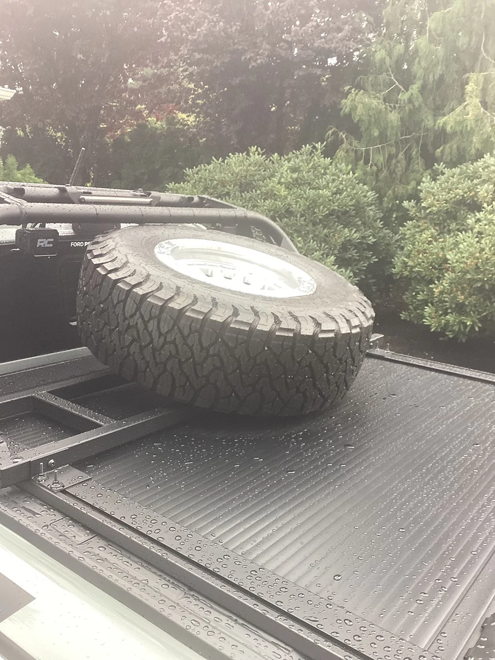

same wheel and offset, off-road an pop a bead, much easier to get to it this way.
Ford Ranger Aftermarket wheel/spare question IMG_0247
May 27, 2025
Searched but couldn't find an answer - those of you with aftermarket wheels, are you buying a 5th wheel for the spare as well if you are keeping the OEM tire size but have a different offset? I assume even in a pinch it wouldn't be ideal to drive on mismatched offset wheels. If so, any issues fitting a more negative offset (+25) wheel up in there?
I bought 5 KMC Canyon wheels (an extra to replace the OEM steelie spare)for my 24 RR which are +25 offset. With the 285 stock KO3's it fits just fine beneath the bed.
