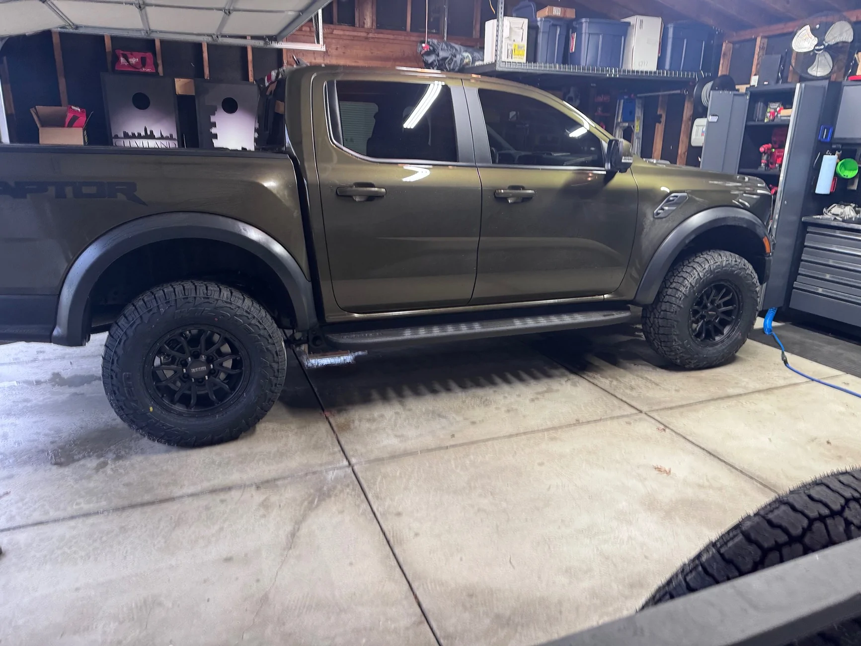

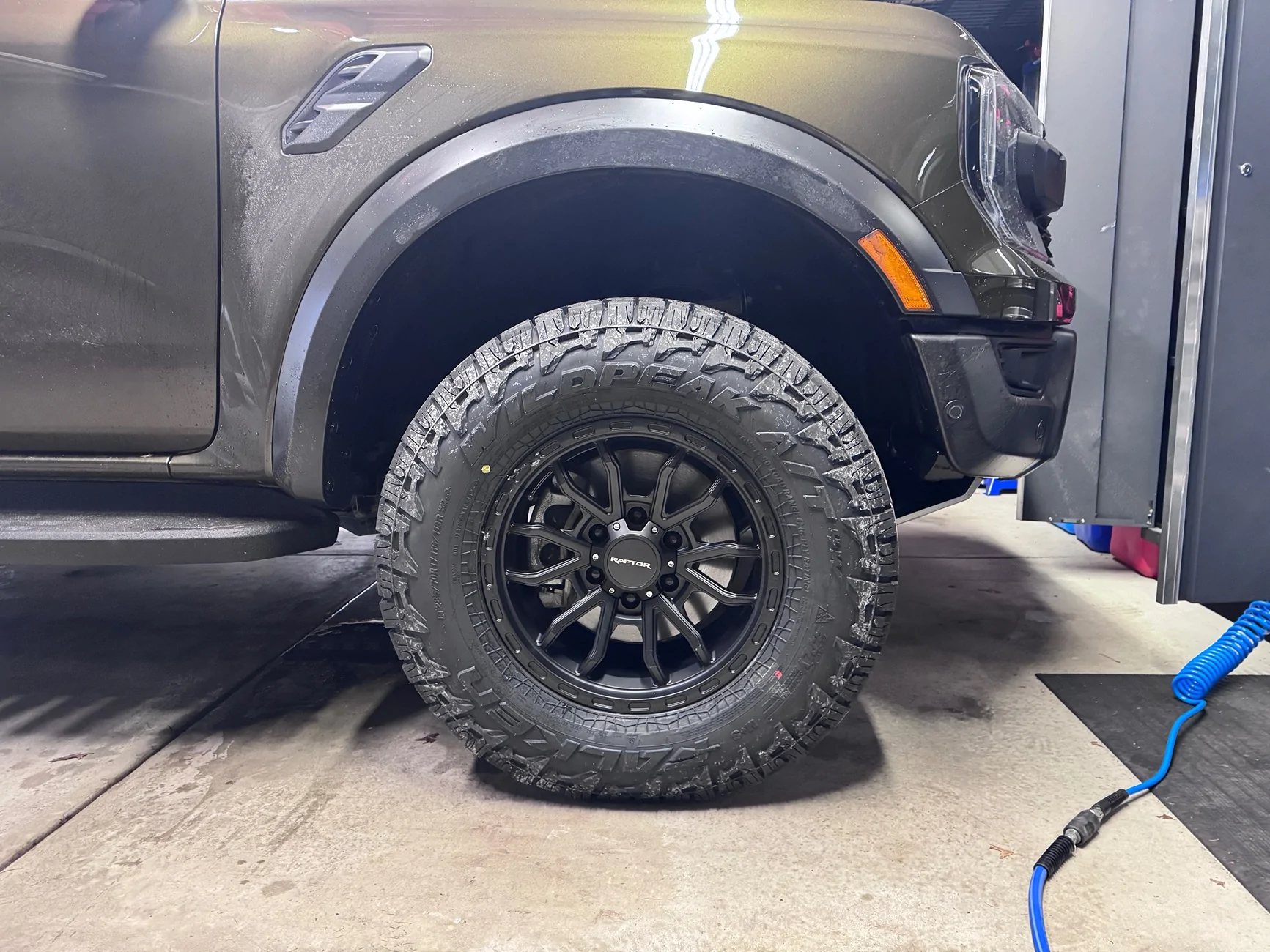

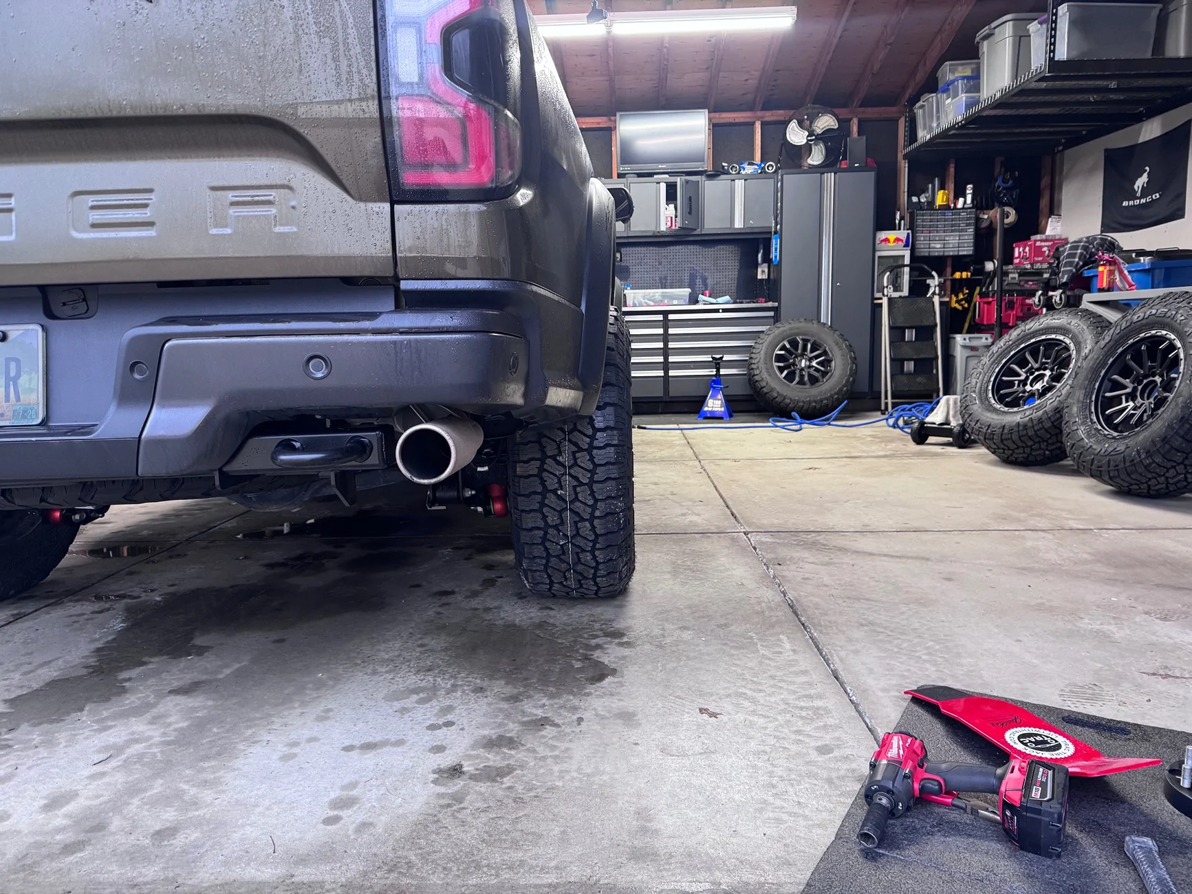

I run hub rings to help with the slop of the wheel bore being larger than the hub bore. I know some run without hub rings on aftermarket wheels with no issues and I would if they matched. I personally am not comfortable running without the hub rings on my setup as I think it puts too much pressure on the lugs as they technically could move a little since there is a little play between the lugs and the wheel.
For my instance, my hub rings are 106mm-93.1mm. I'm running 17x9 Ultra Warmonger 6 wheels with a 12mm offset.
Just my non-professional $.02

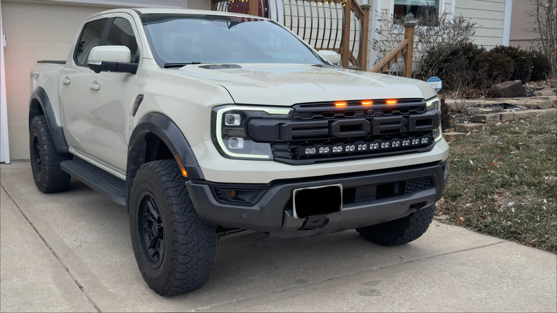

I couldn’t find anything that was hub centric that I really liked. Nothing wrong with running rings, I just wanted an oem replacement. So I had forged wheels made that are the hub centric to my liking
93.1 cb
20mm offset
17x9
23lb
Factory size tires 285/70/17

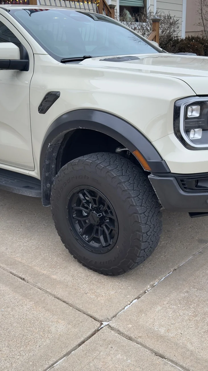

Black Rhino non hub centric, most rings are plastic and don’t supply support but centering.
