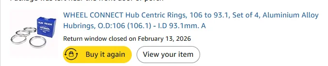

Hub centric wheels only help with wheel to lug alignment. You would need a 20-ton hydraulic press to put them on in such a way that they actually hold the wheel onto the hub.
Hub Centering Rings for 106.1mm Wheels (4pcs) – Rocktrix Offroad
Those are aluminum centering rings. They have the same bore size as hub centric wheels, but your wheel won't even stay on the hub without lugs just sitting there in the garage.
The failure with your mustang was either due to over torquing (was your wrench within its cal. period?) or a metallurgical defect in the lugs (only need 1 to fail, then the others can fail after).
I've had grade 8 bolts that weren't corroded at all snap at their rated torque spec. Only one or two occasions in my lifetime, but defects do happen.
There's no difference between hub rings and hub centric wheels other than the rings are there to help with proper stud alignment while torqing.
