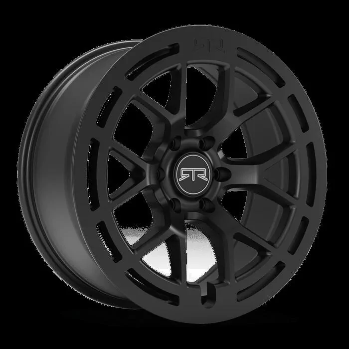

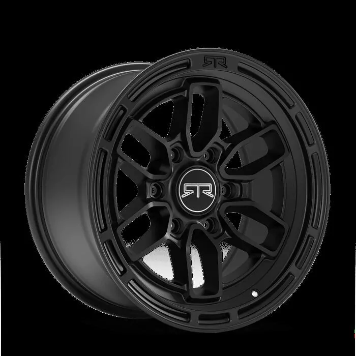

I’m really happy I went with RTR… even with a wider E rated tire and 18s I saved 7lbs a corner from OE beadlock capable.
Looking good, I got the 17x9 30mm EVO6 in black waiting, truck should arrive in 2 weeks.

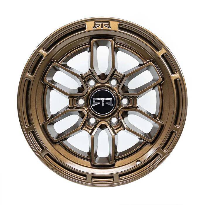

I wanted to go with the Bronze RTR wheels, but they were always out of stock.
I started asking around and RRW got back to me when I asked about their Bronze they use.
I ended up doing their pre-order for the RR5-H in Bronze with black machined aluminum trim ring and I also ordered their Extended Thread splined lug nuts. The center bore is slightly larger than what the Ranger uses, since it's designed for the new gen Tacoma, so I figured the E.T lug nuts would be a bit of extra insurance.
I've put roughly 1k miles on them and have zero issues as far as vibration, steering wheel wobble and so on.
