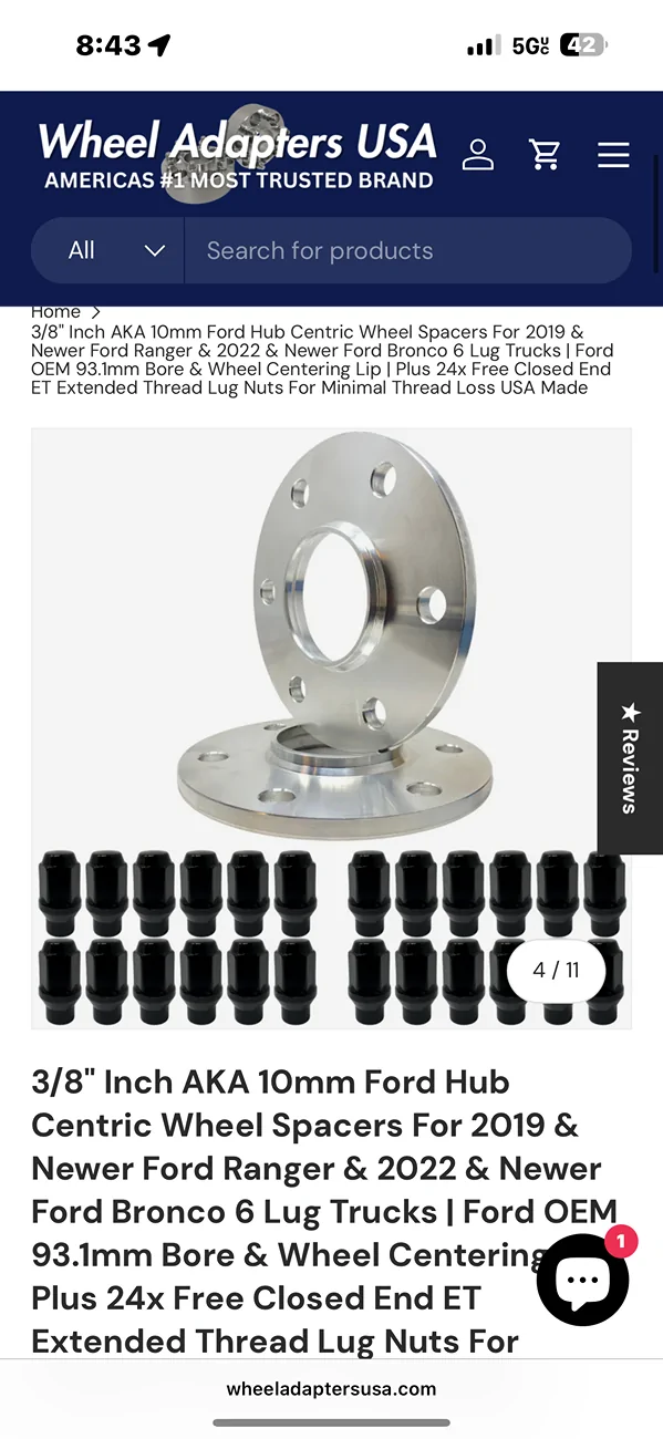

Wheel adapters USA has some 3/8 and 1/2” slip on hubcentric ones with different lugs to bite more thread that you’ll loose.

I have tried those they do not work. The lugs don't fit through the wheels. They would not take them back either. Aholes to deal with.

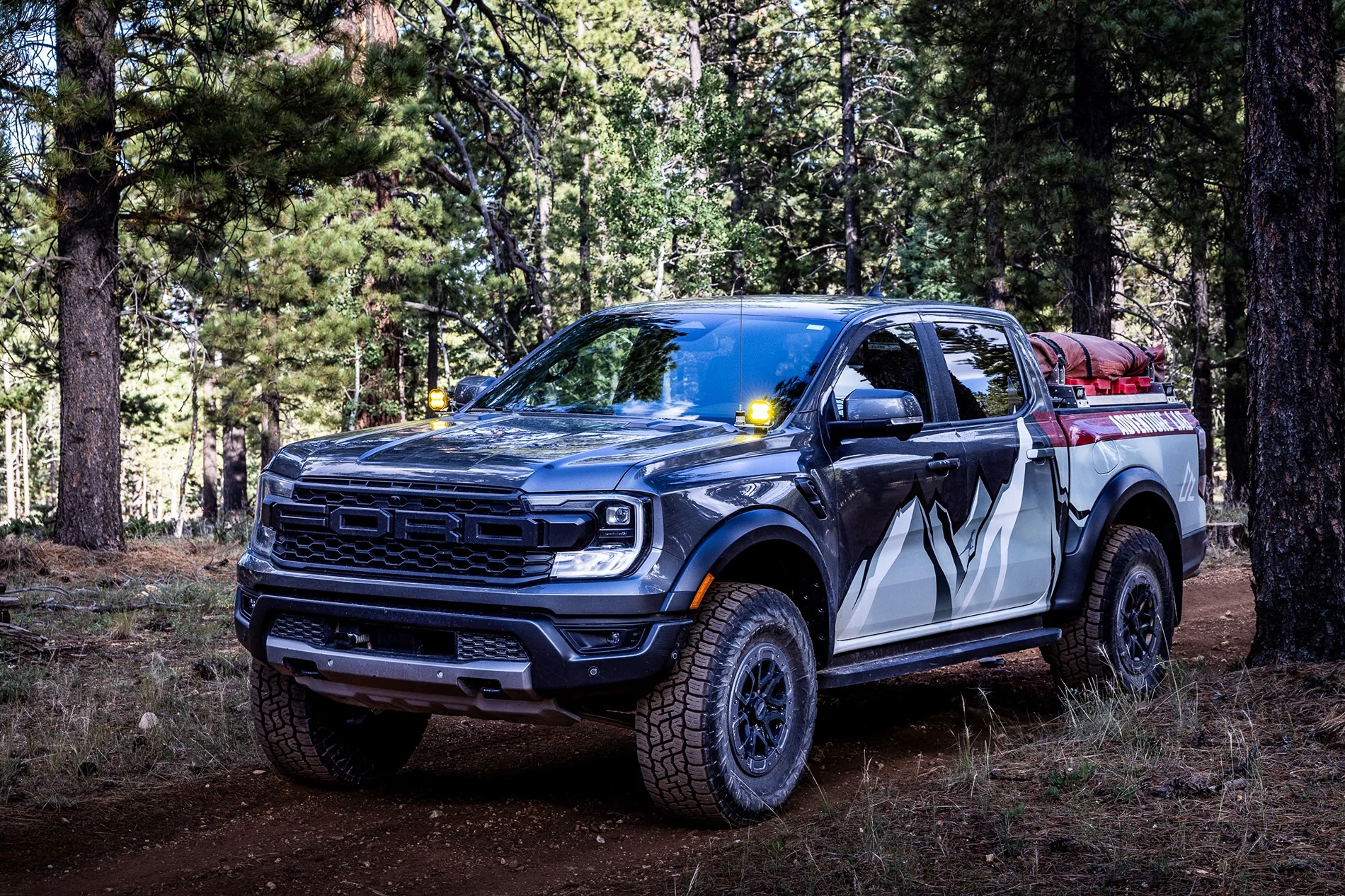

How close were they to fitting through the holes in the wheels? I would love to keep the stock wheels on ours, but the 4mm spacer I cut is obviously not hub centric, so I'm getting some vibration issues at speed. I don't mind drilling the wheels if the lug nuts are close.

I'm running the 1.25" spidertrax on the factory wheels with 35's. Which gives me like a +25mm offset. No issues.

We have 35" Nitto Terra Grappler G3's on this one. That offset wouldn't work with our tire. A 10mm spacer would probably be perfect.
