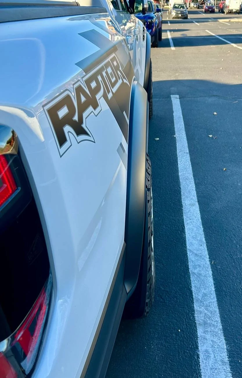

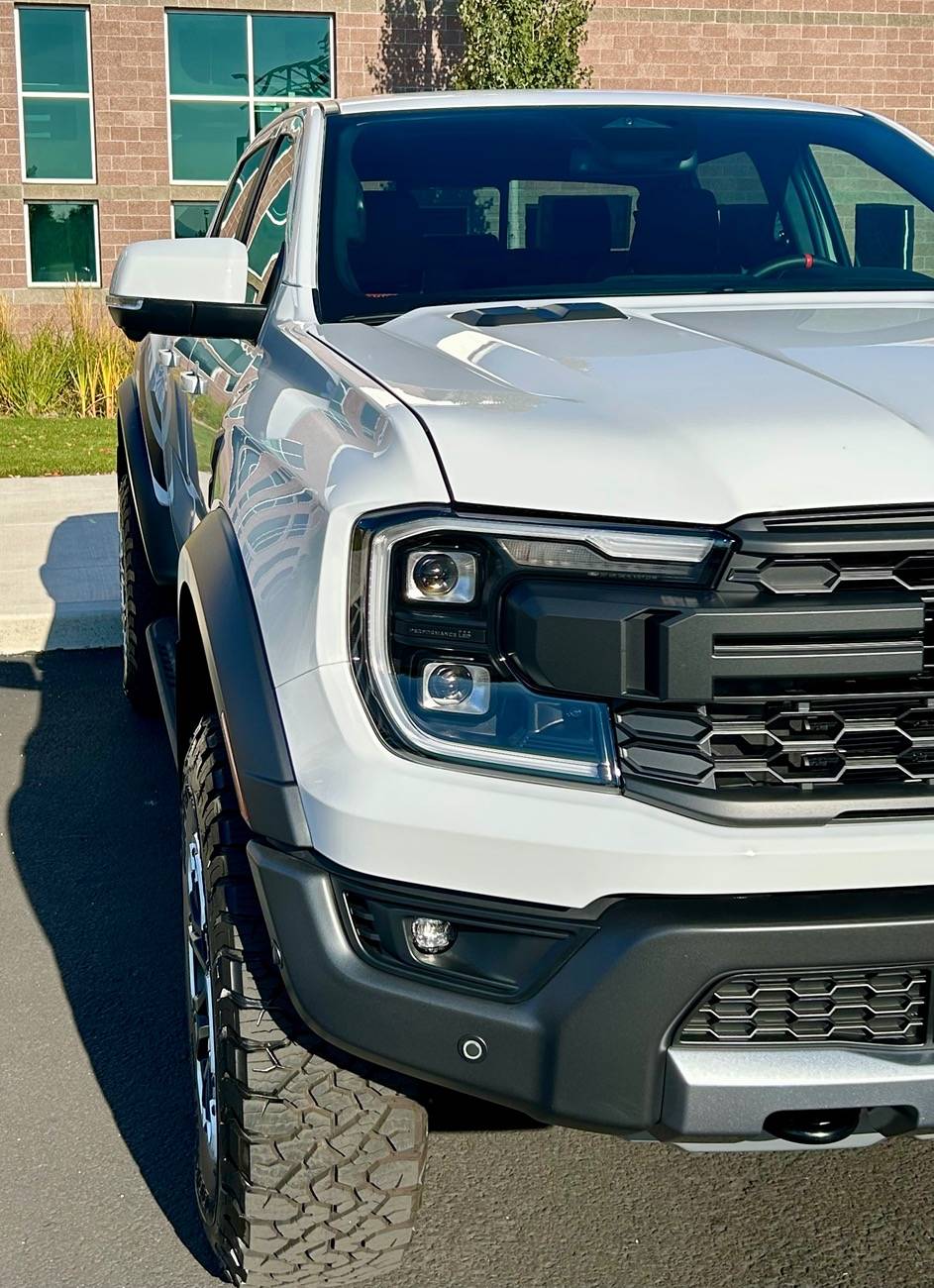

Hello all,
I have been heavily debating how I should go about fixing the stance on the ranger raptor. The wheel just sits to far into the wheel well. I would like to stick with 33s want to go with some kenda kleevers for a more trophy kind of look but I don’t know If I should go different wheels with less offset or spacers. I know the bronco sasquatch wheels work but I just like the look of the rr wheels better. Let me know what you guys think.

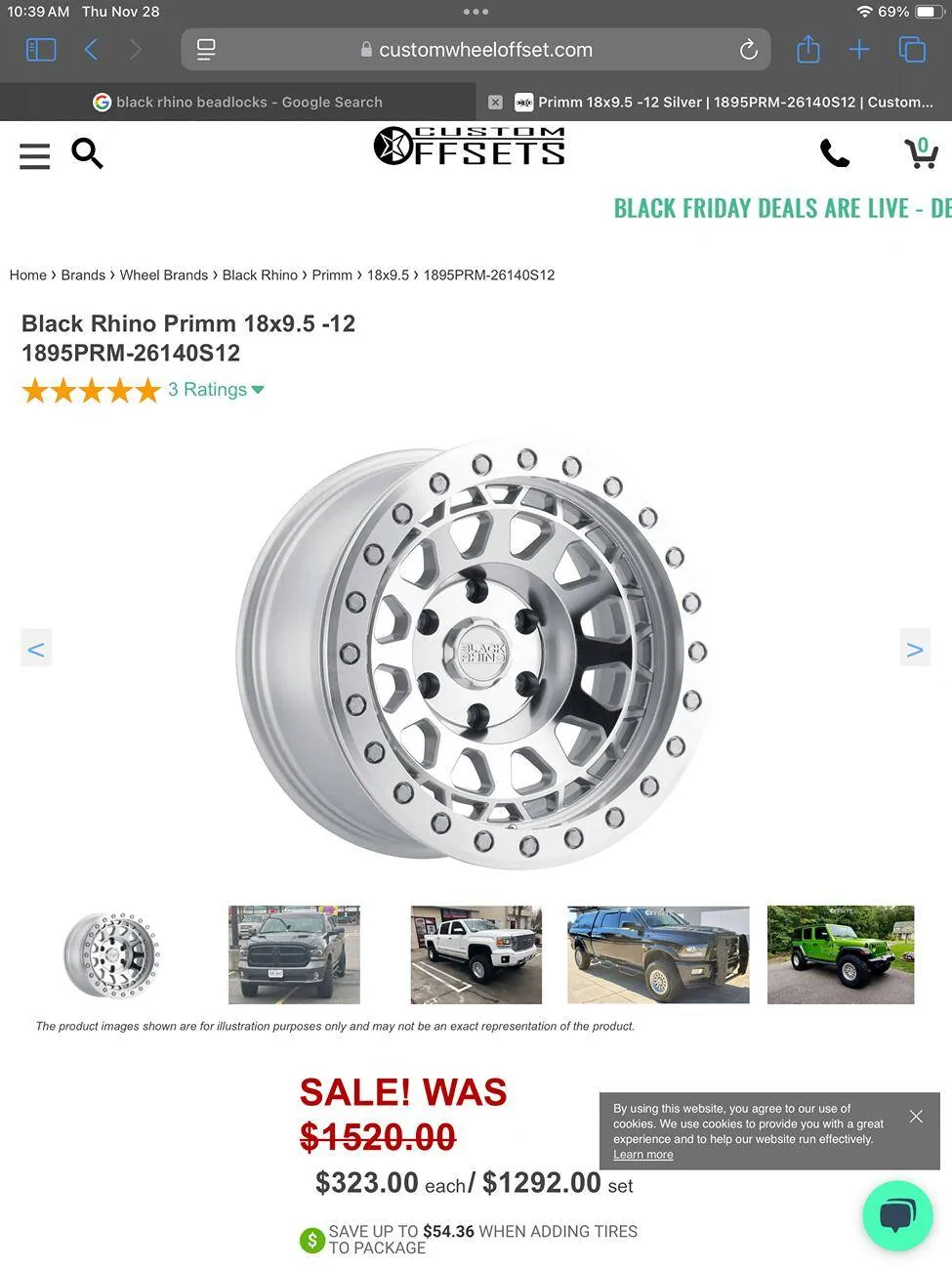

I have had the same issue as far as finding aftermarket’s I like. First time ever I have not had a set of Black rhinos ready to go when the truck arrives. So I painted the trim rings to match an added 1.25 wheel spacers.
