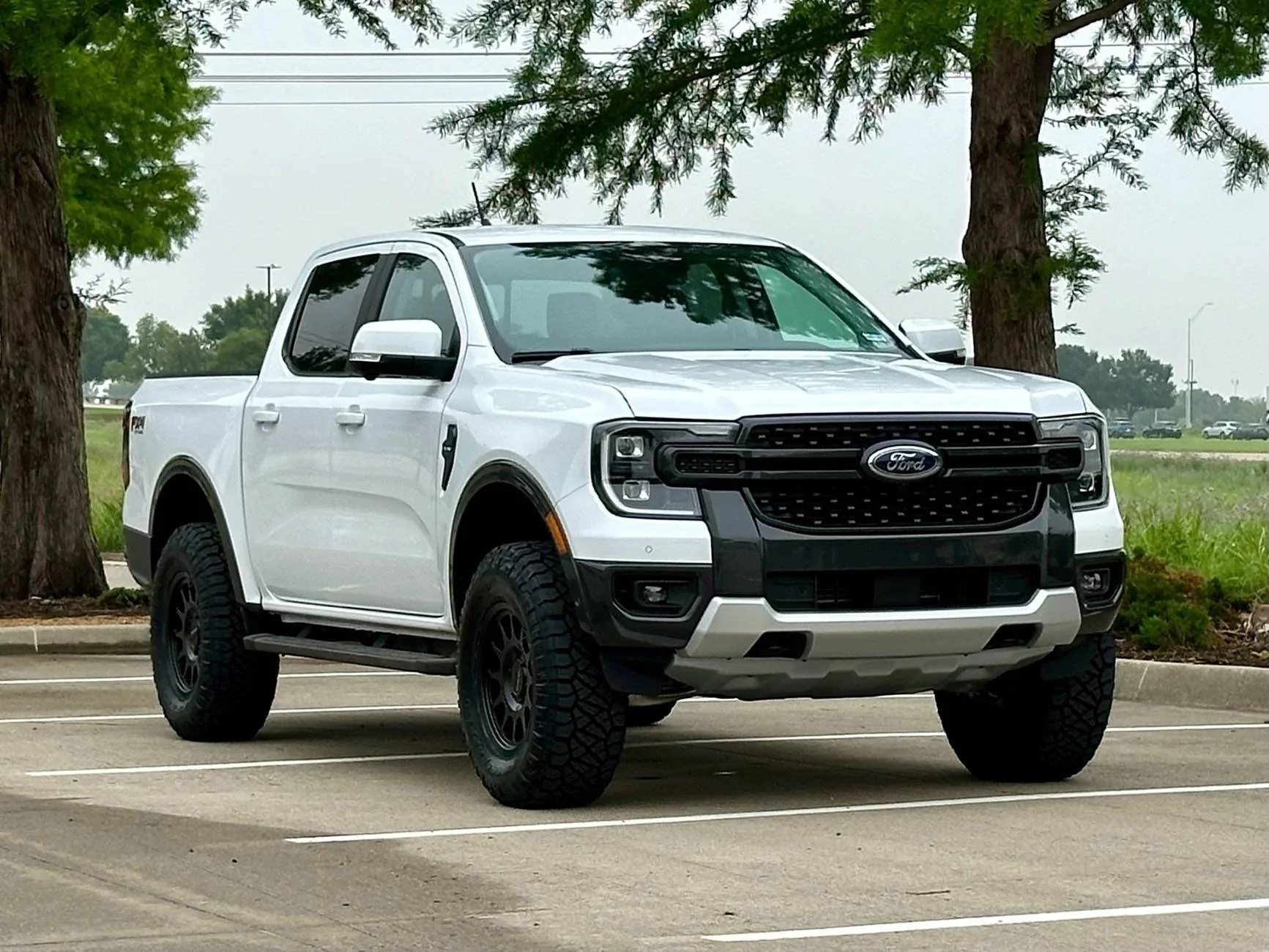

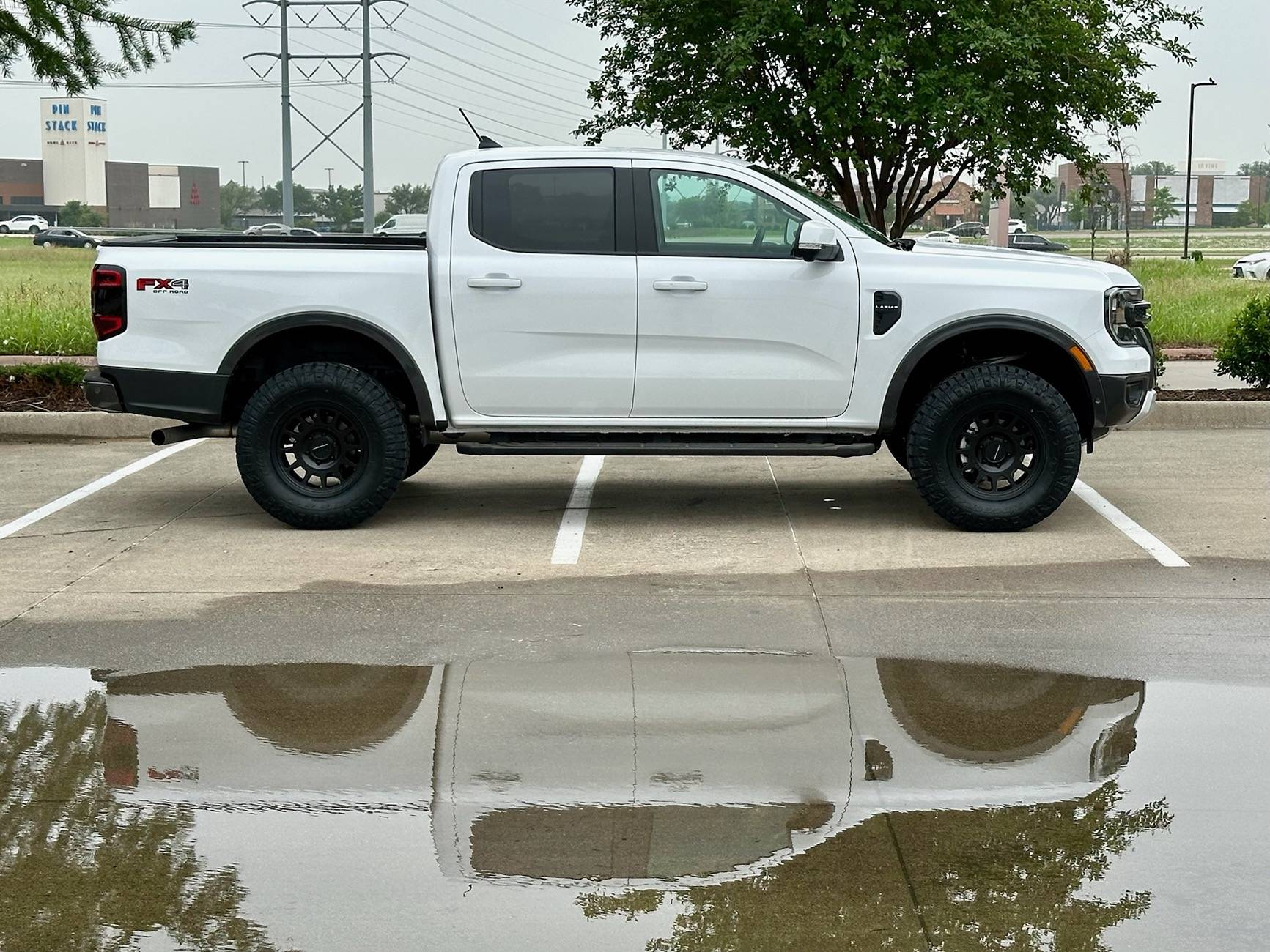

Just put 703s on my 24 Ranger FX4. They did come with hub rings from American Trucks, but luckily I was unaware of this since the included hub rings don’t fit the Ranger. I bought some from West Coast Wheel Accessories on Amazon. The wheels mounted perfectly by Discount Tire, no vibration whatsoever, and the 703 looks amazing on the Ranger.
https://www.americantrucks.com/meth...ck-wheel-17x85-35mm-offset-mr70378560535.html
West Coast Wheel Accessories Hub Ring 106.25 to 93.10 https://a.co/d/7X2FMDS
