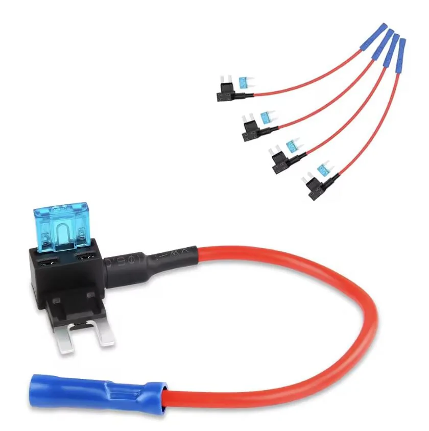

1. LED bar at front bumper: It's connected directly to the battery and I have a switch next to the steering wheel to turn it ON/OFF but I need it to be ON only when the ignition is turned on, so even if I forget my switch ON it looses power when I remove my key from ignition. I know Raptors have the AUX from factory, any ideas on how to do it with non-raptor models?
2. Courtesy lights on the inside: This one I would like to turn on only when my headlights are on because during daylight it's barely visible. Any suggestions on how to do this without cutting any wires and losing my warranty?
I guess the easiest way for both cases are these fuse jumpers. Am I right?

So I thought through the original issue further and determined the jumper wire definitely wouldn’t work. Since the jumpers would connect to the “all on” fuse terminal, they would be connecting all of the individual fuses and so I wouldn’t have any individual control over the lights. The Auxbeam doesn’t really permit the configuration I was looking for. Hard to explain but it wouldn’t work without another switch.
The system that I’m now going to use (and would also work for the prior poster) is a Garmin Power Switch which allows you to run multiple switch configurations through the app and allows control through CarPlay.
For the prior poster - the Garmin Power Switch allows for two trigger wires and you can assign different lights to the individual triggers. I believe you could use two different fuse taps and accomplish what you want with the Power Switch. There’s probably a more complicated way to do it without the power switch but I think this device will greatly simplify and streamline things.
