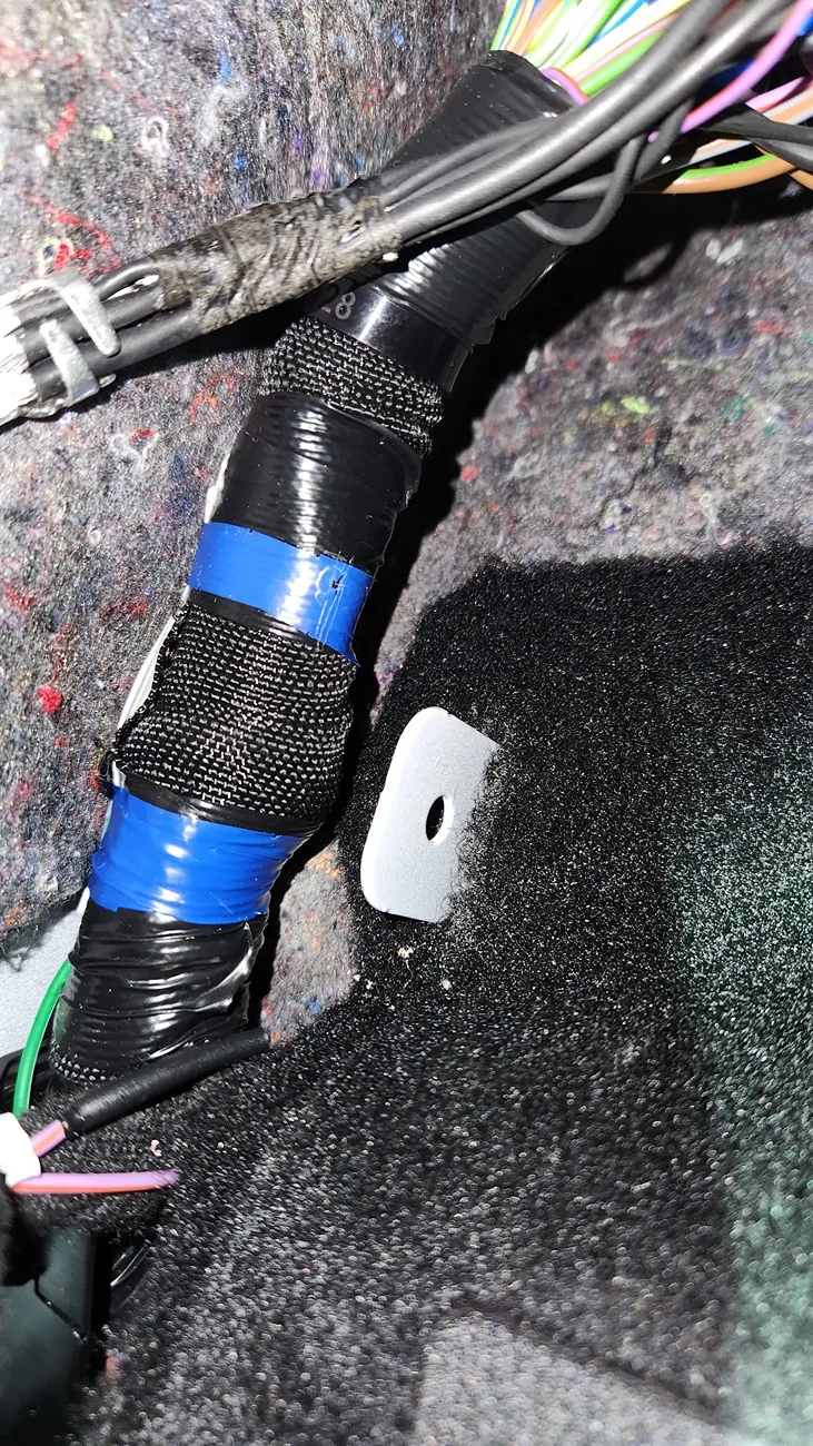

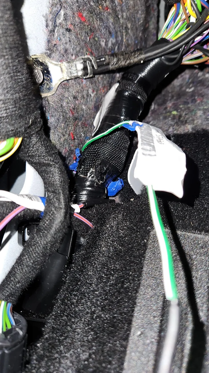

For future reference there is a green wire with a white stripe taped behind a harness behind the left kick panel. It is 10 amps, ignition switched and is connected to fuse #92 under the hood. It is capped off and intended for use by the consumer for light auxiliary loads like relays etc. I just tapped mine today for the relay to my compressor.
In the first pic you can see the wire and the white label just barely peeking out from behind the wire bundle, in the second pic I have slit the blue tape and pulled it out.
