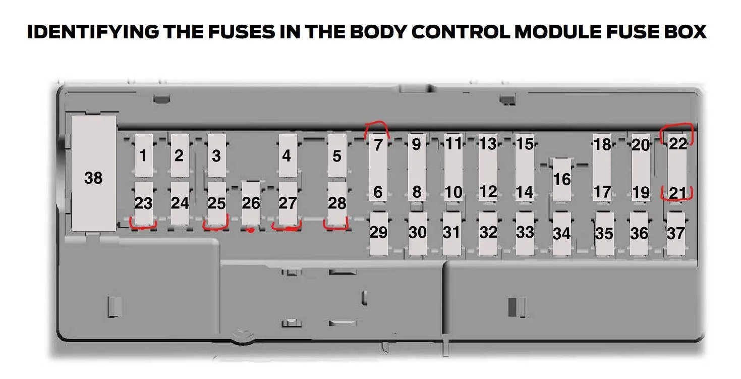

reviving this thread as I've got my viofo cam in the mail and need to install it.
I know consensus was that we need to order that Micro3 fuse tap for #21/22, but does this also mean I need to pick up a micro 2 fuse tap for the one at #28? if the answer is yes, would a kit like this be sufficient? https://www.amazon.com/Gebildet-Circuit-Micro2-Holder-Harness/dp/B07ZV4LY54
sorry if this a dumb question, this is all new to me.
For the micro2, yes. I think that's the exact one I got. The micro3 is a little more challenging to find.

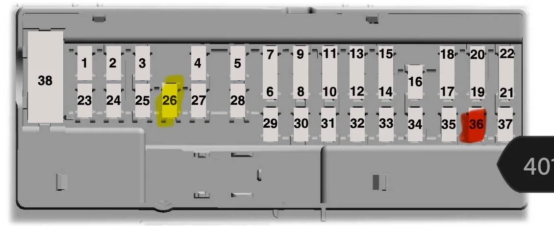

I purchased a Pelsee Mirror dash cam for my Ranger Raptor. I hooked it up to fuse #35 for ACC and fuse #28 for constant (Batt). Could you guys let me know if this is an OK setup?
jrRaptor
Josh
May 19, 2023
811
1,102
Maize, KS
#28 and #35 aren't used so those are perfect. Make sure you have your tap oriented correctly and all should be good.

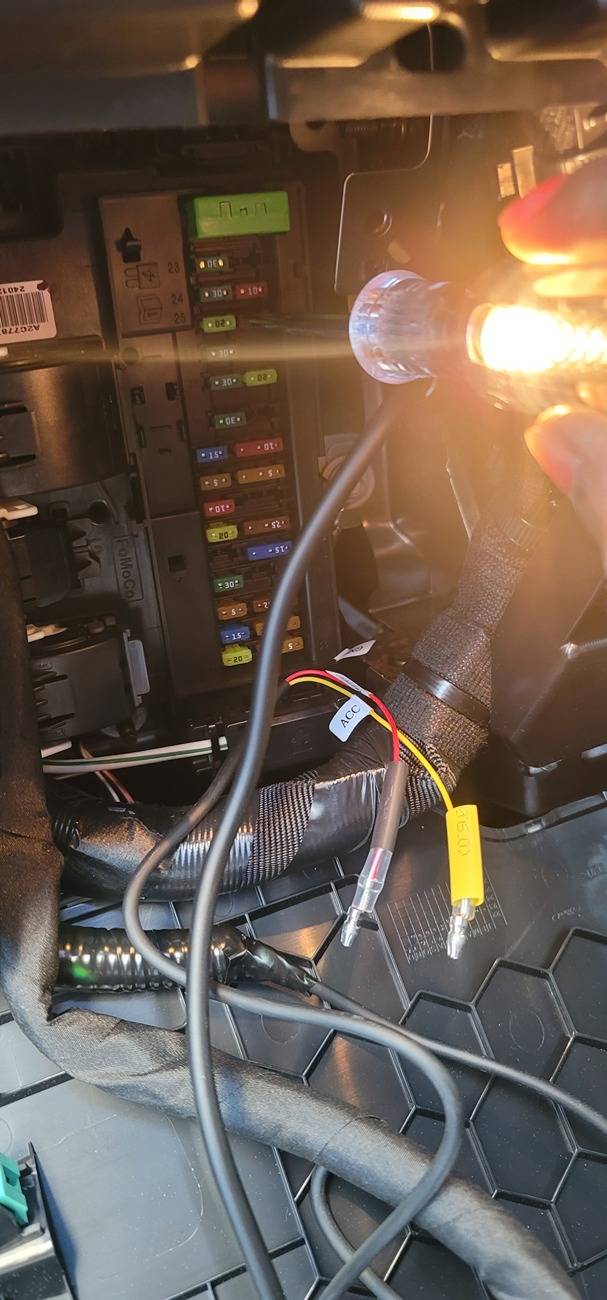

I used the stock fuses in the factory locations (30A in #28 and 5A at #21 and 22), and I believe 5A for the tap positions. The dash cam only pulls around 2A if I remember correctly.
See pic for reference
Important to note orientation of the fuse taps matters. See the installation pics above, for the '24 Ranger, the fuse taps point up.

Yes, same, no molded handle to pull. Just pull at the top. Here are some photos I just took to help:
Ford Ranger Dash Cam Fuse Taps 20241112_120737_resized
Ford Ranger Dash Cam Fuse Taps 20241112_120806_resized
Ford Ranger Dash Cam Fuse Taps 20241112_120823_resized
Ford Ranger Dash Cam Fuse Taps 20241112_120827_resized
Ford Ranger Dash Cam Fuse Taps 20241112_120840_resized
Ford Ranger Dash Cam Fuse Taps 20241112_120852_resized

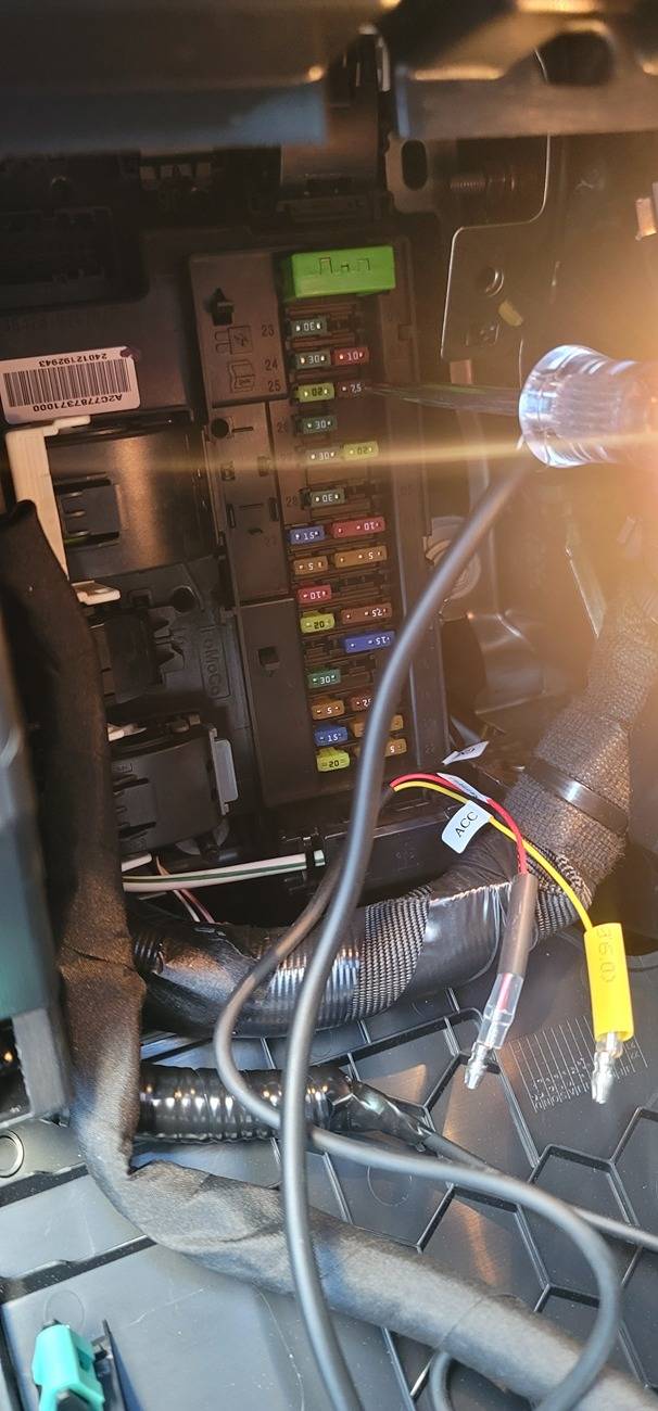

Could someone help me and see if I’m doing this right or if I’m gonna screw myself over.
I have the micro 2 acc on 28 and the micro 2 Bat+ on 35
I also attached the ground to this bolt, would that be a problem?
Ford Ranger Dash Cam Fuse Taps imag
I did get power to my dash cam but just wanna make sure I’m not gonna screw myself in the long run.
jrRaptor
Josh
May 19, 2023
811
1,102
Maize, KS
Your fuse selection looks good, verify with a multimeter or test light to make sure you get power as expected (ACC on/off). As for the ground, personally I would pick a ground that has full metal contact. It looks like the one you selected has plastic on one side and grounding is only through the bolt threads. I used the bolt that is visible in your second photo.
