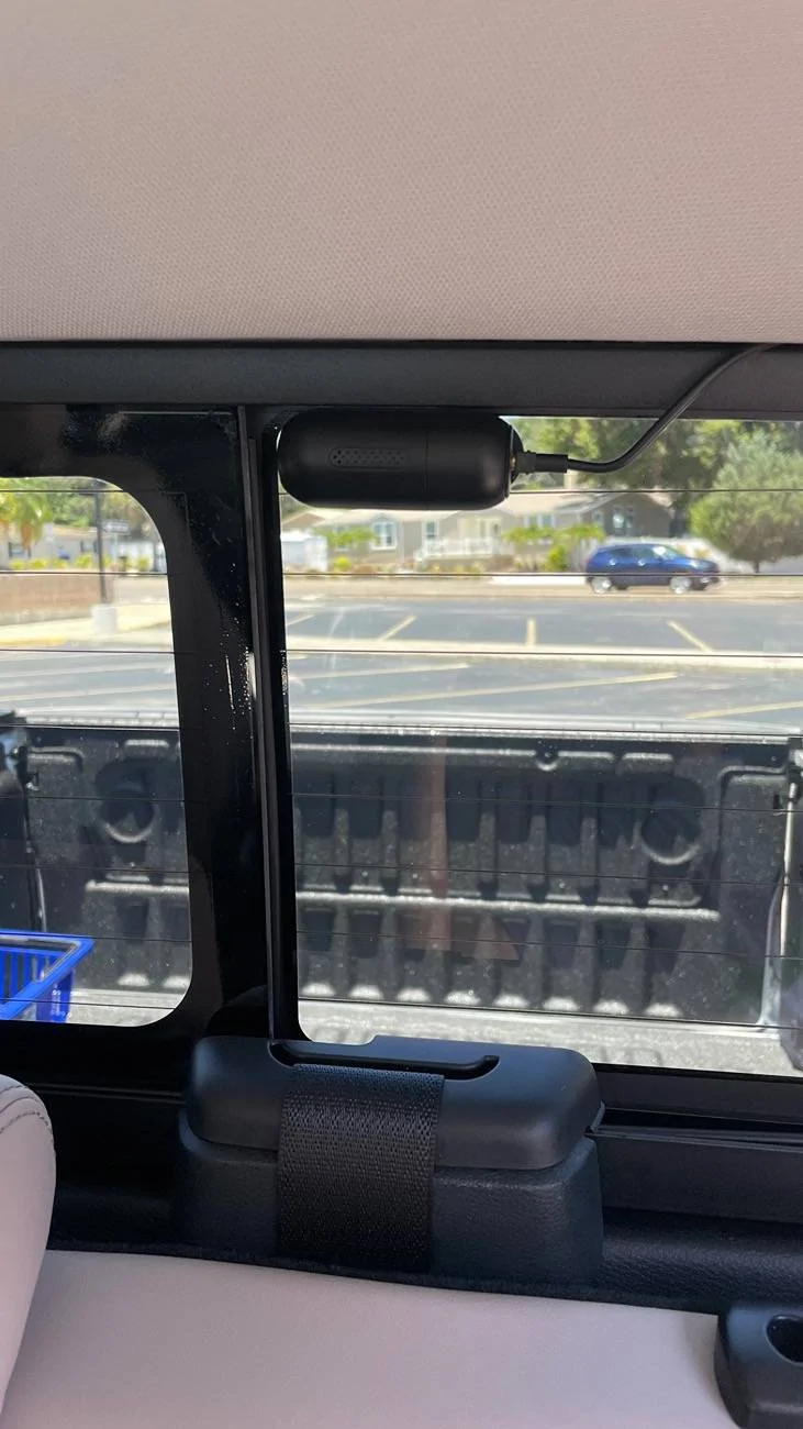

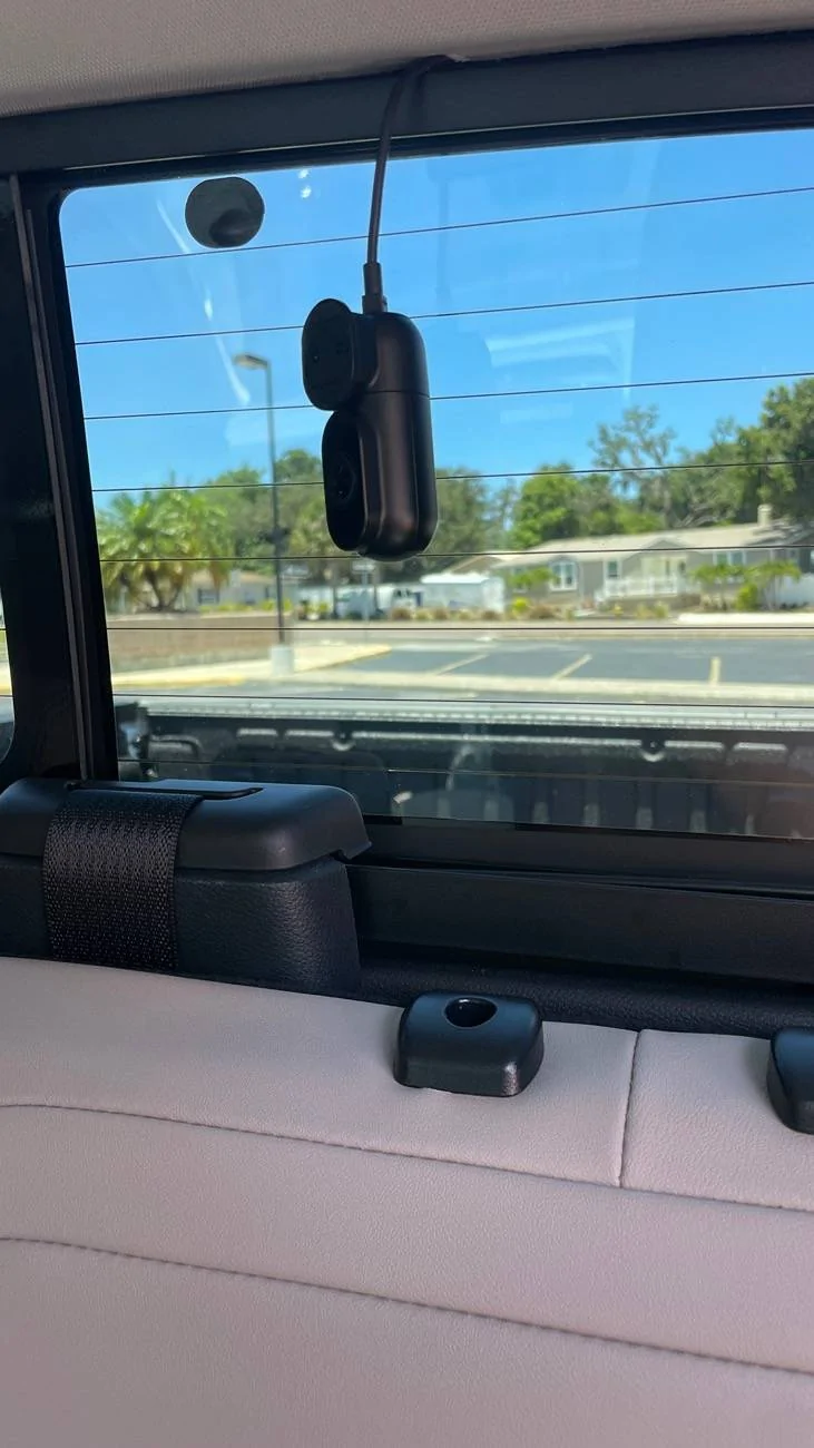

So I was backing out today and looked into the rear view mirror and as always my eye goes right to the unleveled camera. I was surprised to see it hanging from the wire. Apparently the Florida sun heat warmed it up enough to drop from the 3m adhesive. I got back there and with all the technology I could muster up within myself I re-fastened it level unlike my electrical installer. Hopefully it will hold

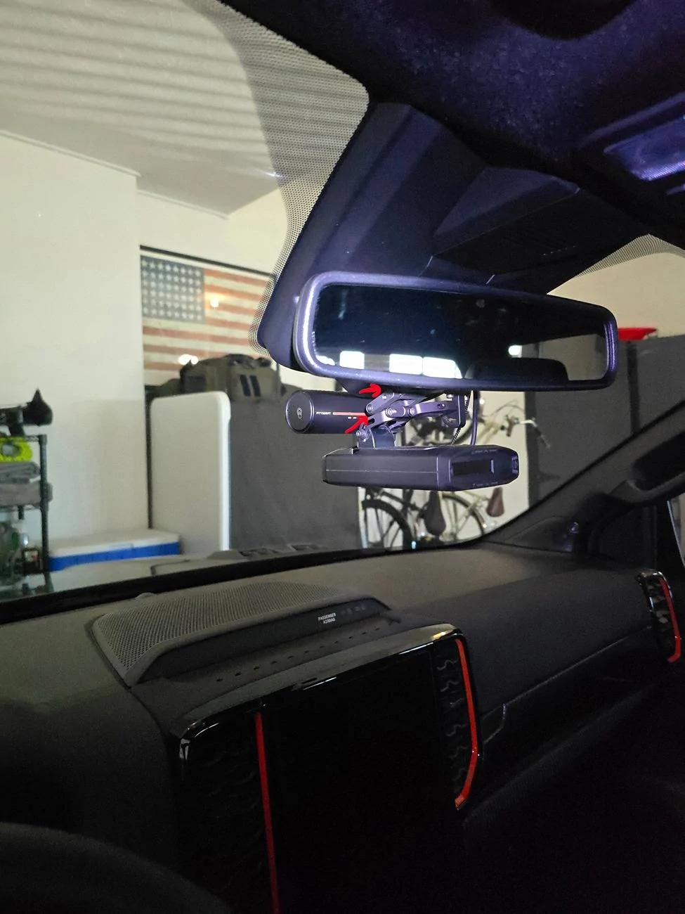

Hey @jrRaptor picking your brain again. Did you end up using the foam vibration pads that come with the Blendmount kit? I positioned the Blendmount pretty aggressively against the rearview mirror cover and each other. I was thinking of adding those foam pieces between the dashcam mount and the cover and between each mount. Spots in pic
I did not, I left space between them and they don't touch. If I were trying to compact everything like you did then I would use the pads or something to eliminate or reduce vibrations and noise. Good idea if you go that route. Only reason I didn't was because I didn't feel it bought me much more visibility and just made it more difficult to mess with or work on.
