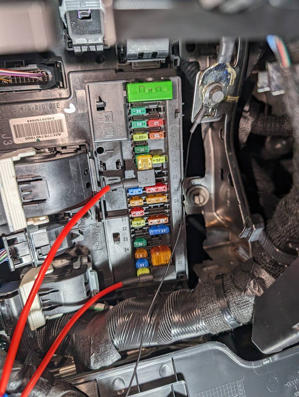

I don't know what I'm doing wrong but I can't get any power going to my dashcam, with truck started or turned off. I have power on 28 and accessory on 22. I even swapped the wires around and still didn't work.
You missing a fuse on 21+22 tap?
I mean, I dont have a spare 3 prong fuse to throw in there. I have the OEM fuse in there as the only one. Would that really keep it from getting any power?
Not sure to be honest but since 21+22 is already only 5 amp I don't think it would hurt anything. Just going off what I noticed.
Does your dashcam come with a 12v cigarette lighter power cord? Can you confirm the unit is good to go with a known working power source first?
Your new 5 amp on 28 looks fine. The 30 amp on 28 and the 5 amp on 21+22 good and not blown?
The other thing would be to check your crimp connections.
There's another part of this thread that breaks down which prong is the "hot side"
If you don't have both fuses in the tap and if the fuse tap is in the incorrect orientation it would not work.
Figured it out. I had to move the single fuse on 22 to the other open spot. Now its all good and working. Time to route the cable. Thanks again for your quick responses!

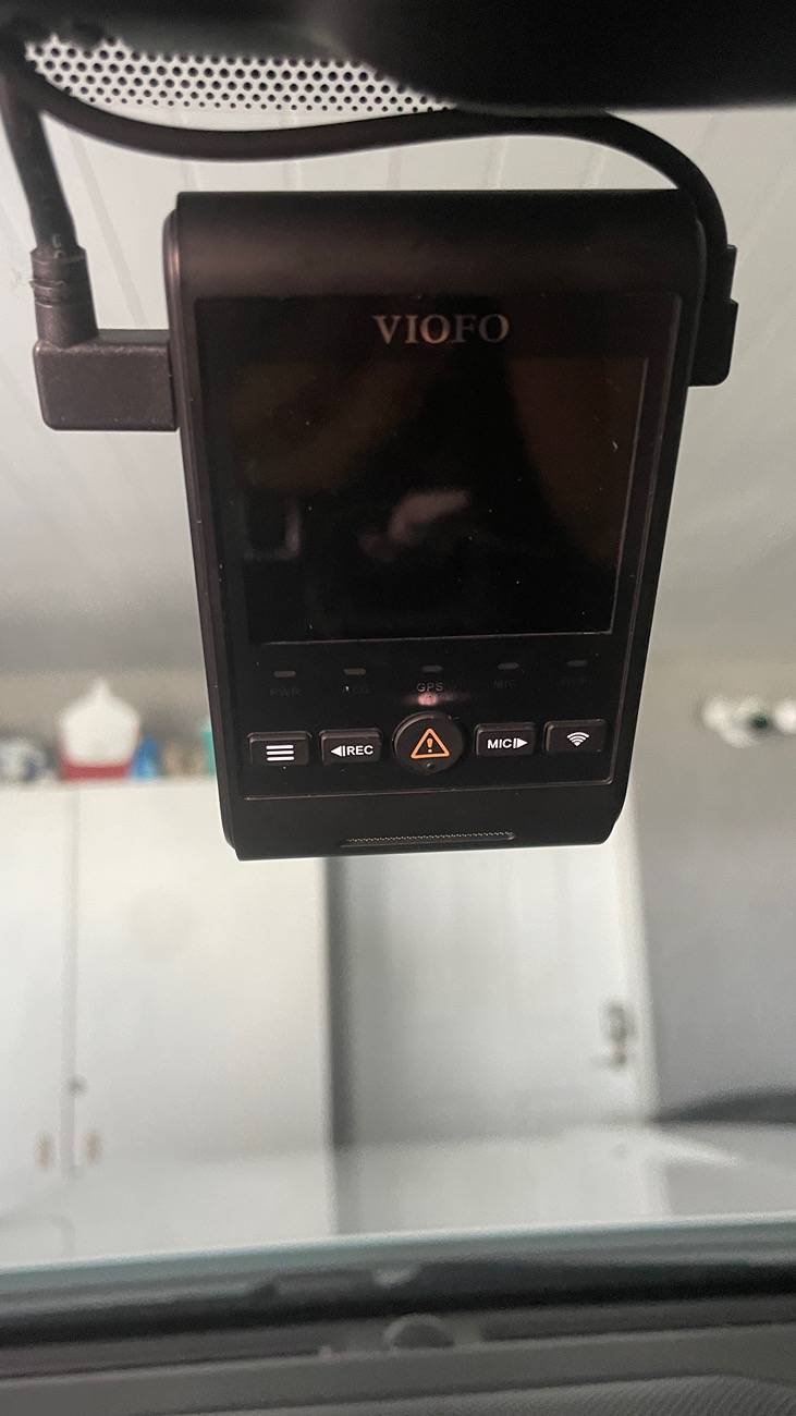

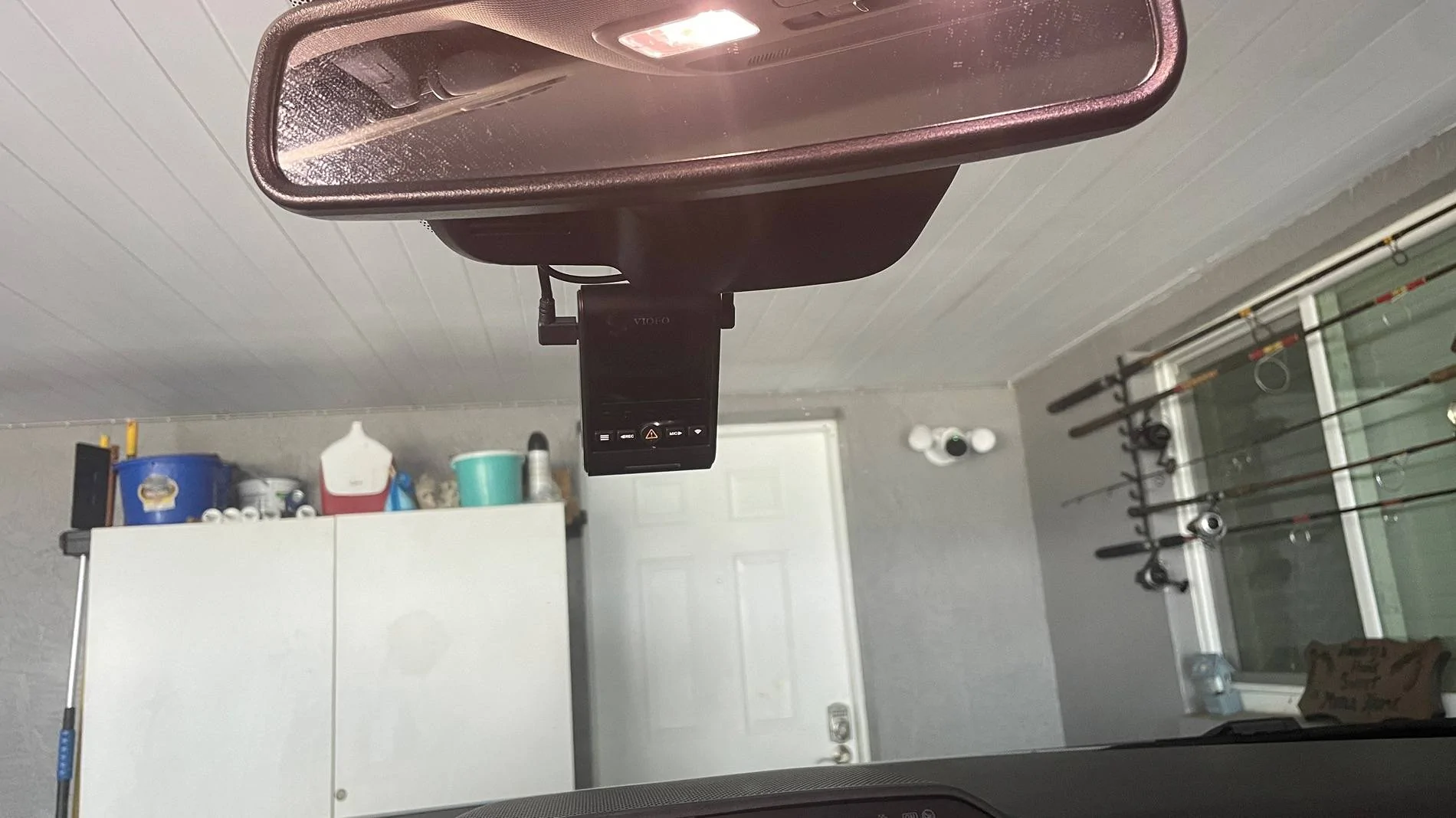

I just installed my Viofo A229 Pro front and back with their optional hardwire kit and it all works perfectly.

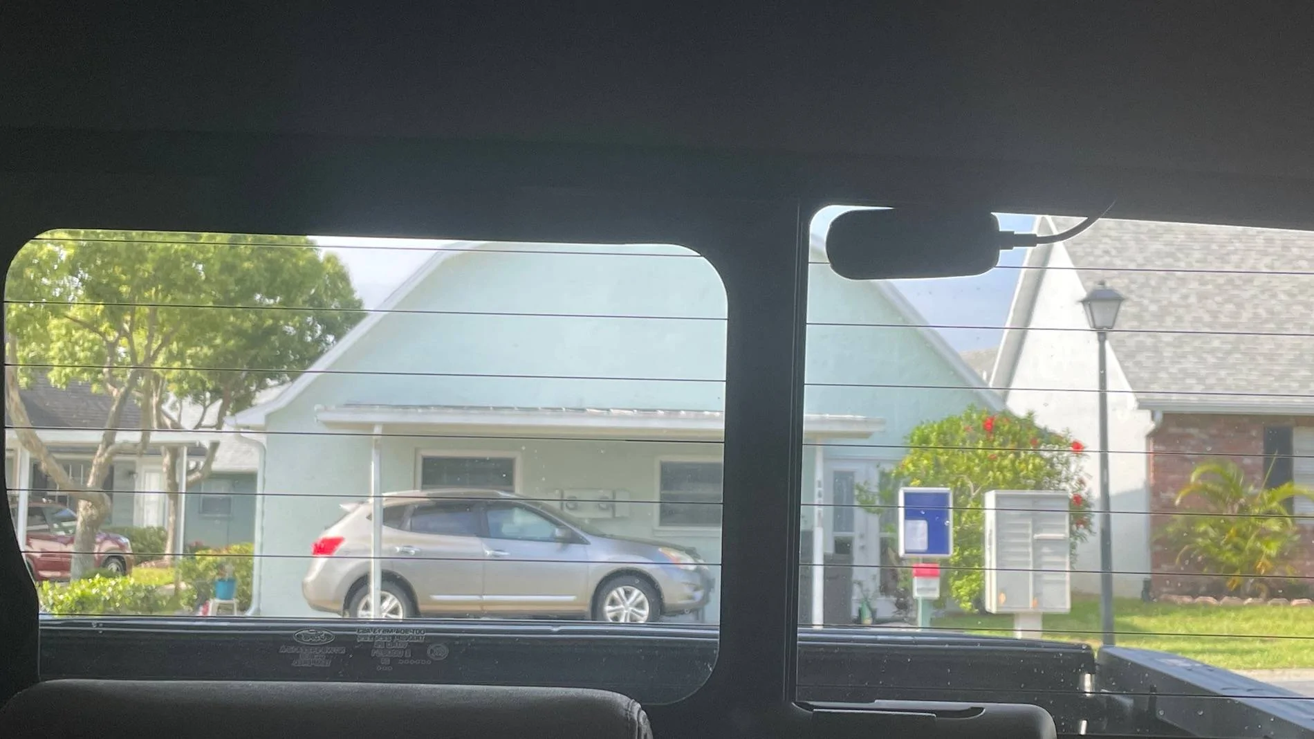

Yes - my wiring installer put the back camera on the tinted window crooked. It is not level and my OCD cannot stop looking at it ?

My OCD wouldn't like that it's not on the center window lol. Hey crooked cam is better than no cam. ?

Yeah - I guess so but dollars to donuts that within 2 weeks from now I will pull it off, re-tint and put it on level myself.

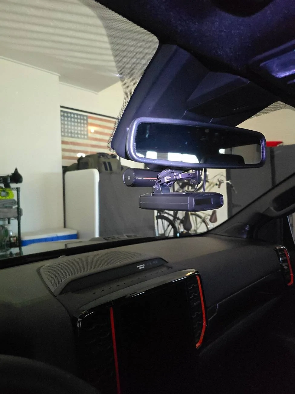

Still waiting on my darn micro 3 fuse tap. I have everything ran and buttoned up. Just need to complete the power harness and plug it in.
Thanks again @jrRaptor for the inspiration to combine the two Blendmounts. Very pleased with the front and rear mount solutions.
When I popped off my drivers side A pillar for some reason the tweeter snapped out of its mount that's a part of the A pillar. Not sure why it was so difficult to get that seated again but that was my most frustrating part of the install.
Did my best to ran all wiring behind airbags for safety purposes. Should have the fuse tap tomorrow and be able to finish this up.
Blackvue 970x Plus 2 Channel
Escort Redline 360c
Ford Ranger Dash Cam Fuse Taps 20240519_174456
