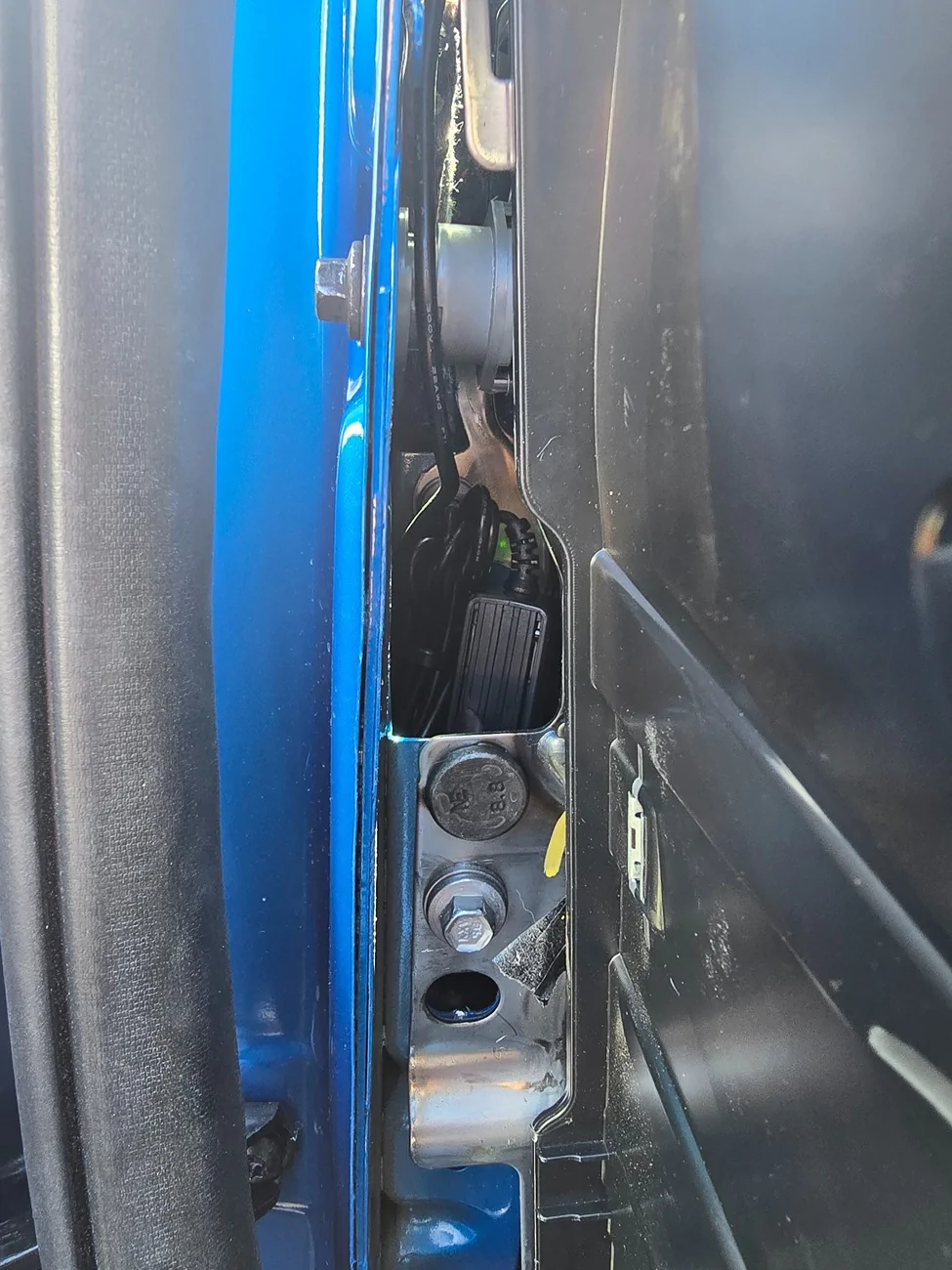

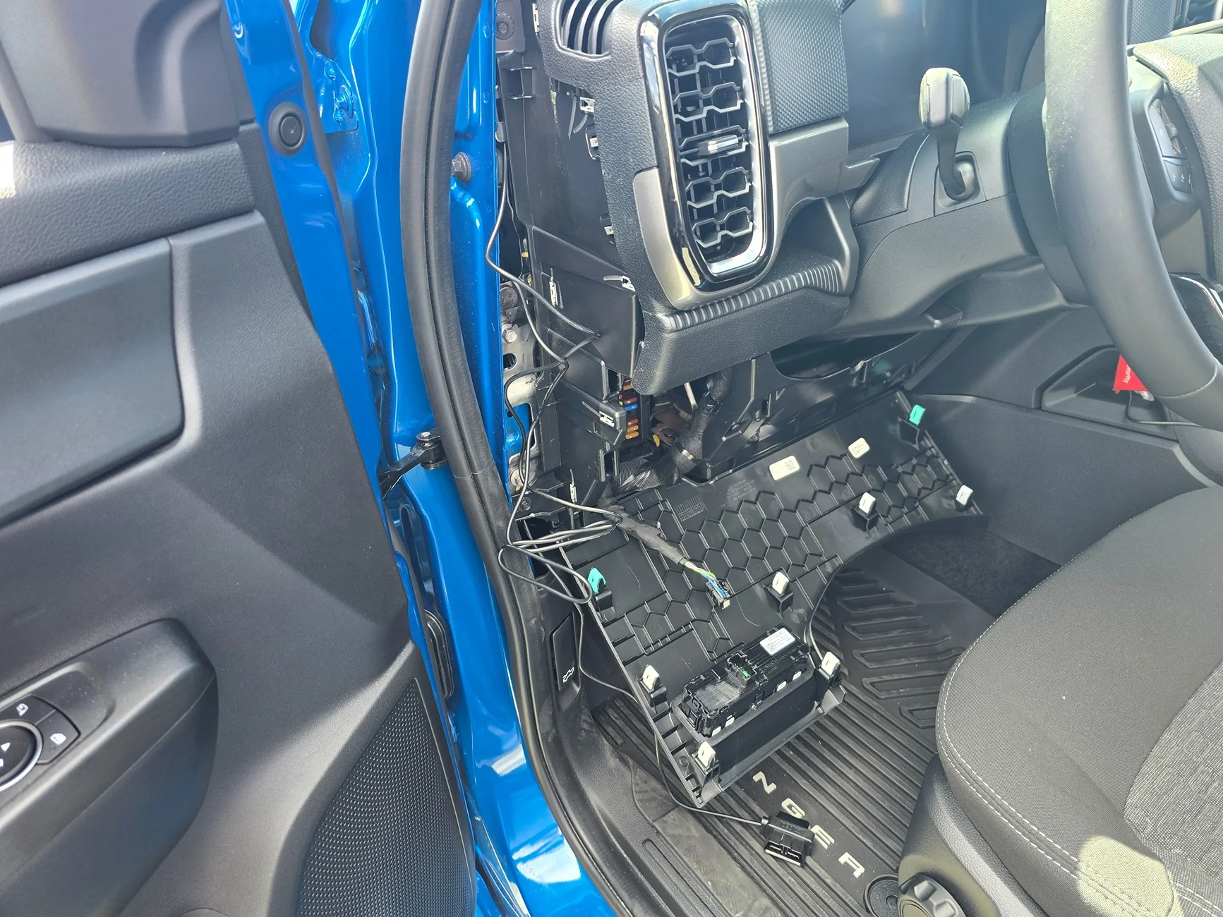

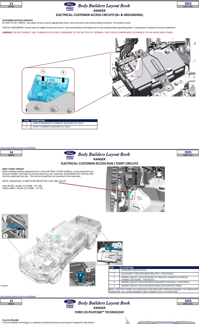

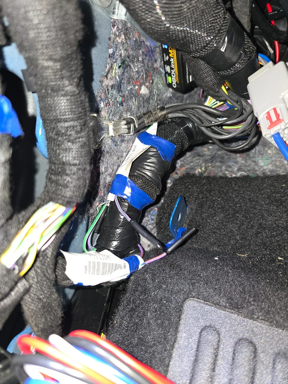

Under the BCM(fuse box) behind the kick panel are 3 blunt cut wires, a ignition wire, highbeam, and marker. my highbeam and marker wires, had the labels swapped, but the green/white wire is the ignition wire.
Ford Ranger So, best option for dashcam fuse tap location in “25 “Lariat Screenshot_20250922_091636_Adobe Acrobat

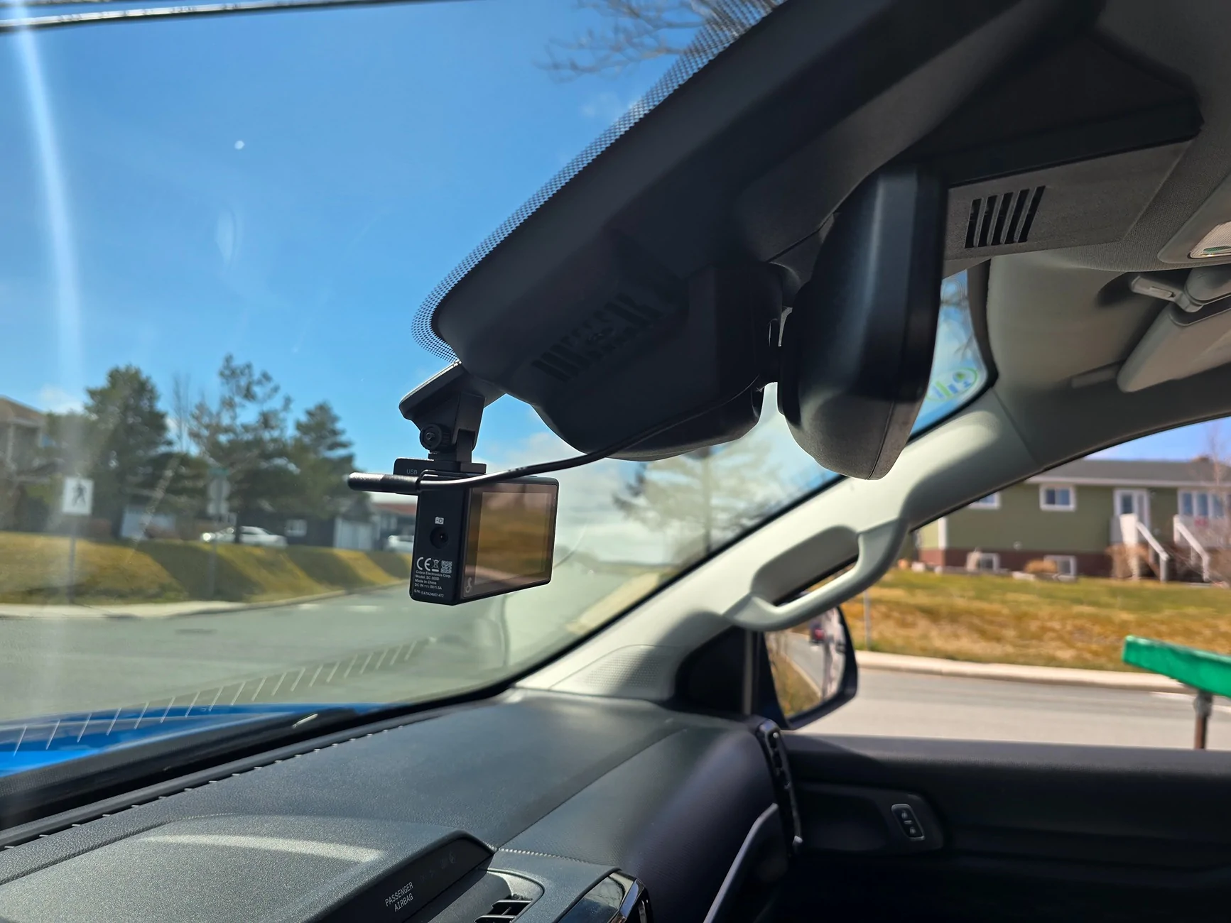

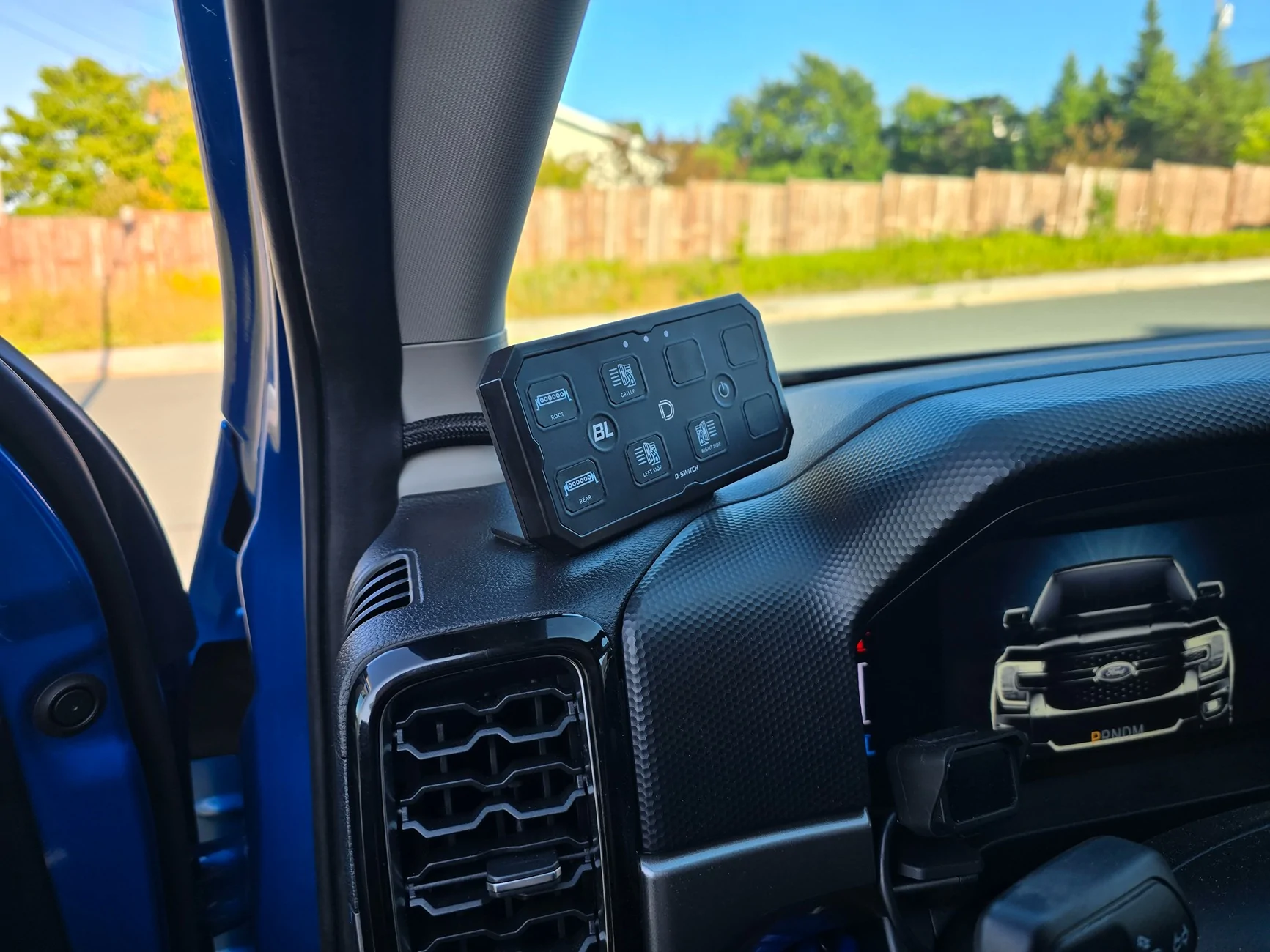

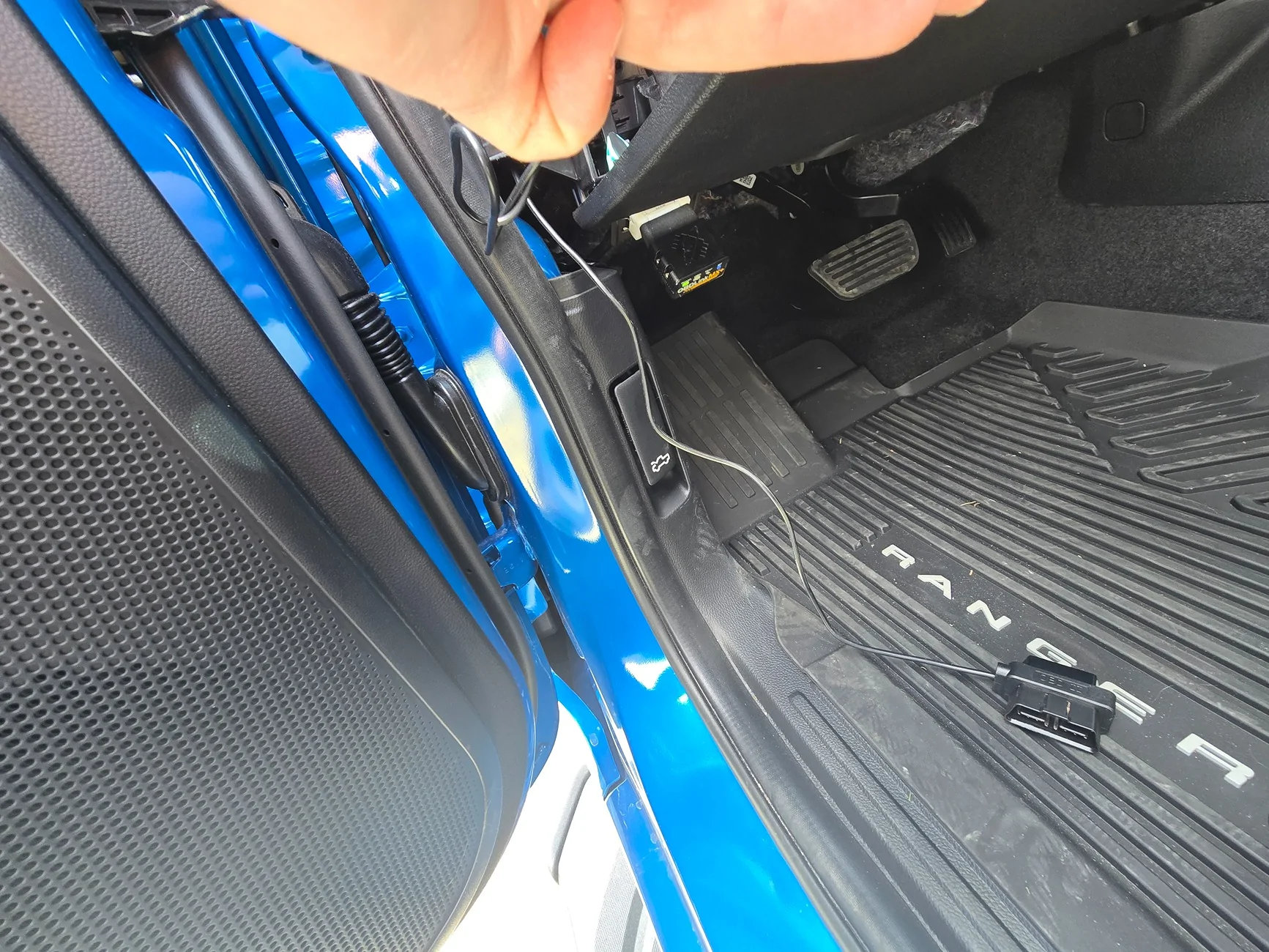

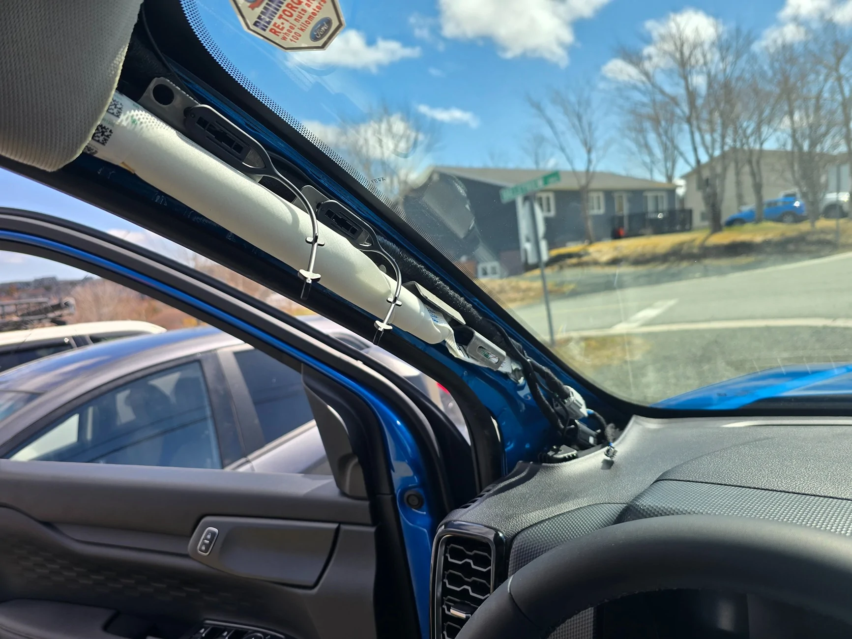

Me personally I have a OBD passthrough adapter for my dashcam. I am using the ignition wire, marker wire, and highbeam wires for my diode dynamics dswitch. to turn it on and off automatically, outside of the manual controls anytime. the marker wire to turn on my grill lights, and night mode on my dswitch, and the highbeam on the dswitch to automatically turn on my lightbar.
dashcam wire is ran across the headliner, ziptied to the wiring harness behind the airbags, down the Dash, plugged into the obd 2 port, and the excess is tied up and tucked up in the dash on side the bcm.
