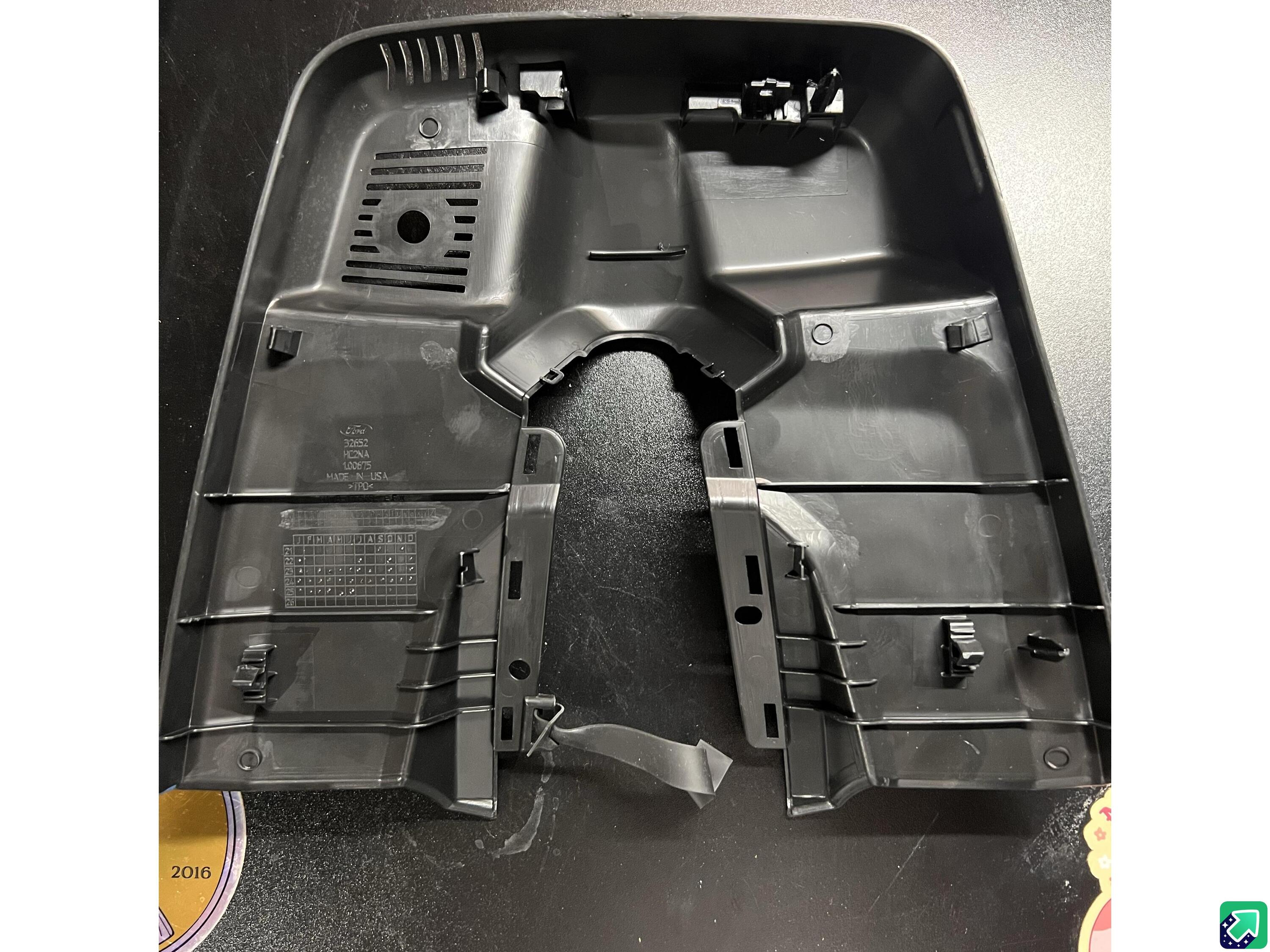

This is the larger "main" piece of trim, showing where the clips that hold it in are. Two in the front, two in the back.
Closeup of the passenger side tabs. I pulled primarily from the driver side first, then down (towards the ground) and away on the passenger side. It took a little convincing, but with a decent pull it popped off.

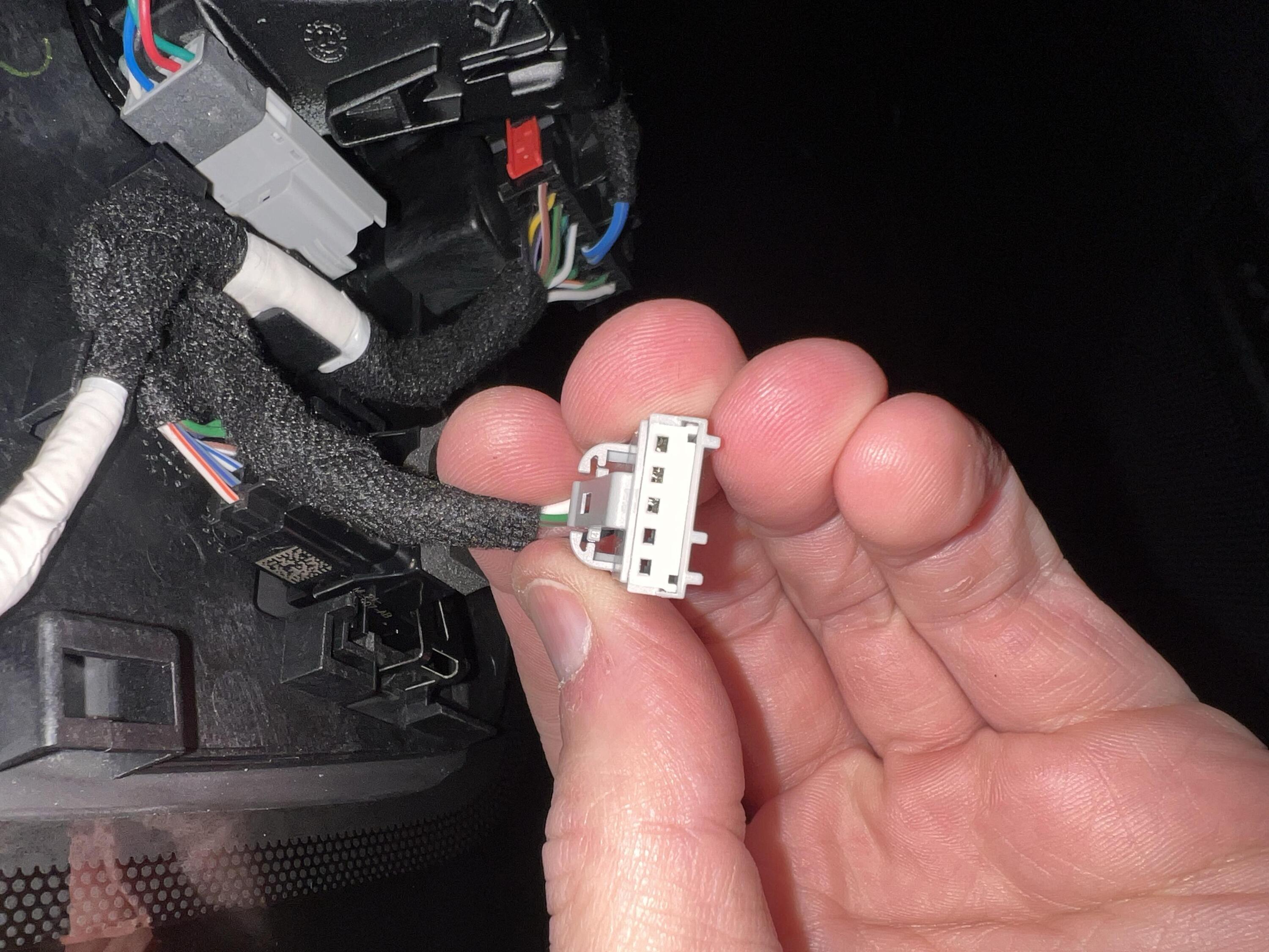

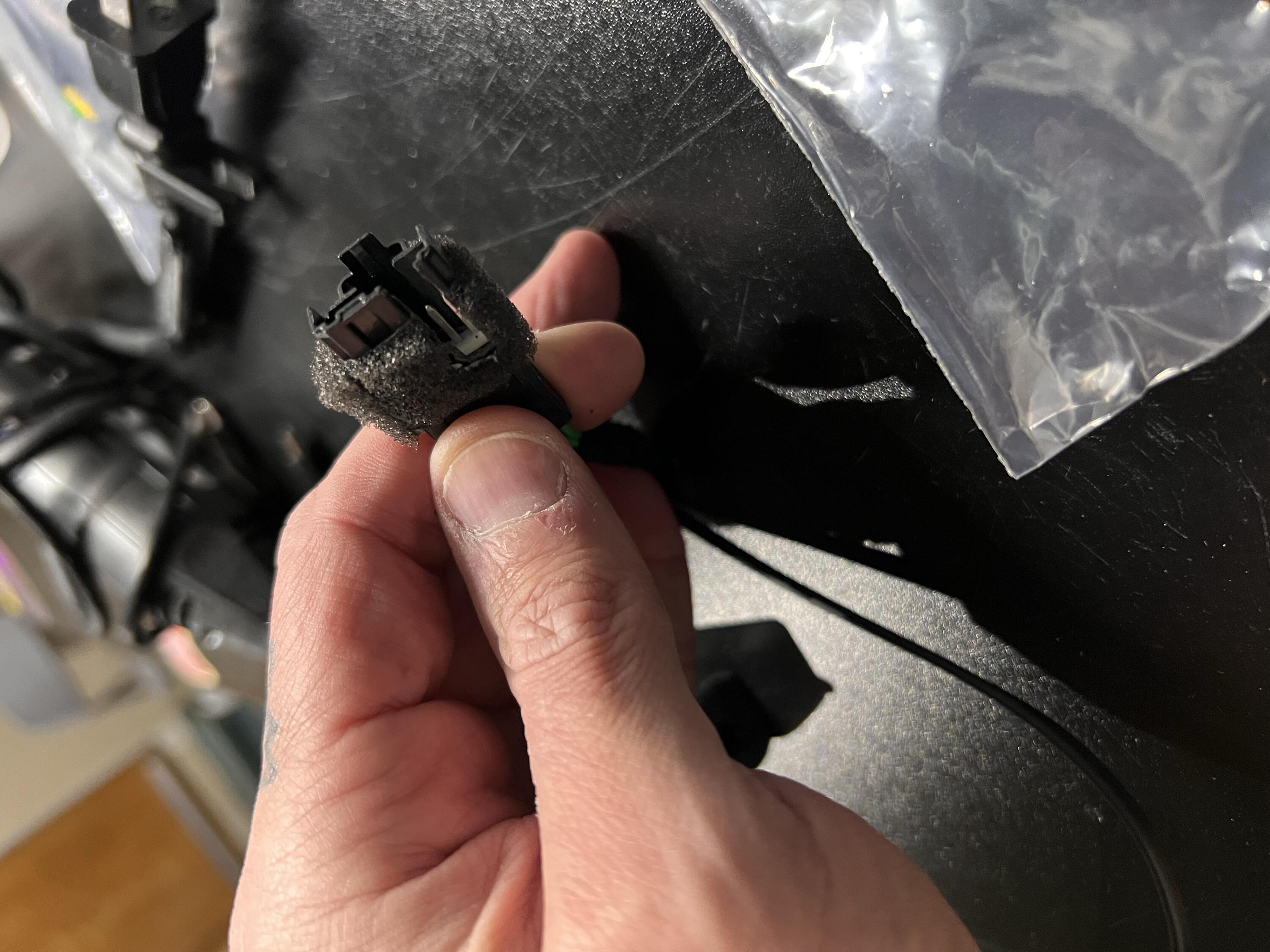

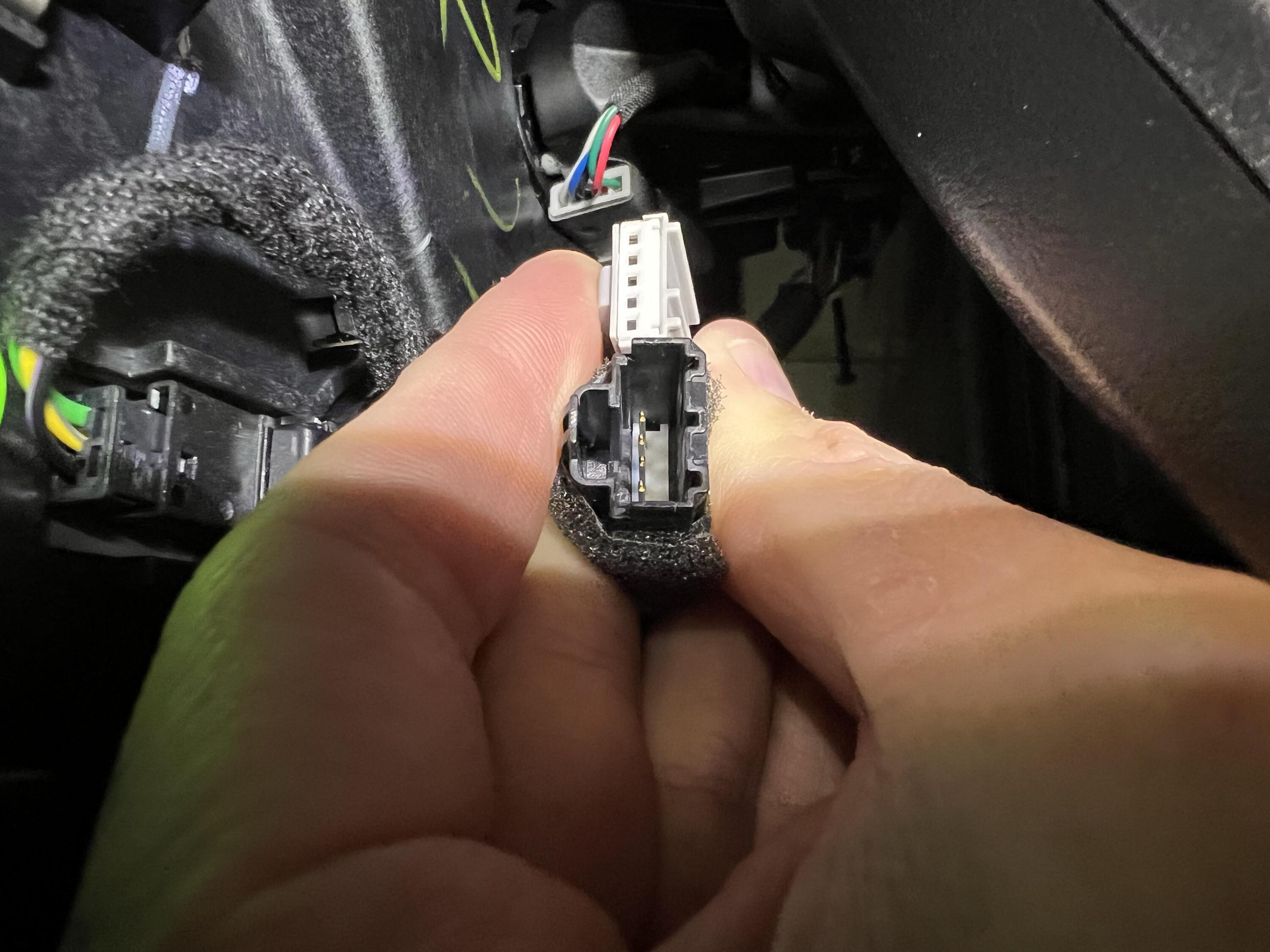

Backside of the plug you'll be needing to access
Pin out of the plug. The dongar adapter's plastic guide is in the middle, not offset like below, so I took some snips and cut it flush down.
Cut to fit. I modified both ends of the Dongar harness, not the truck.

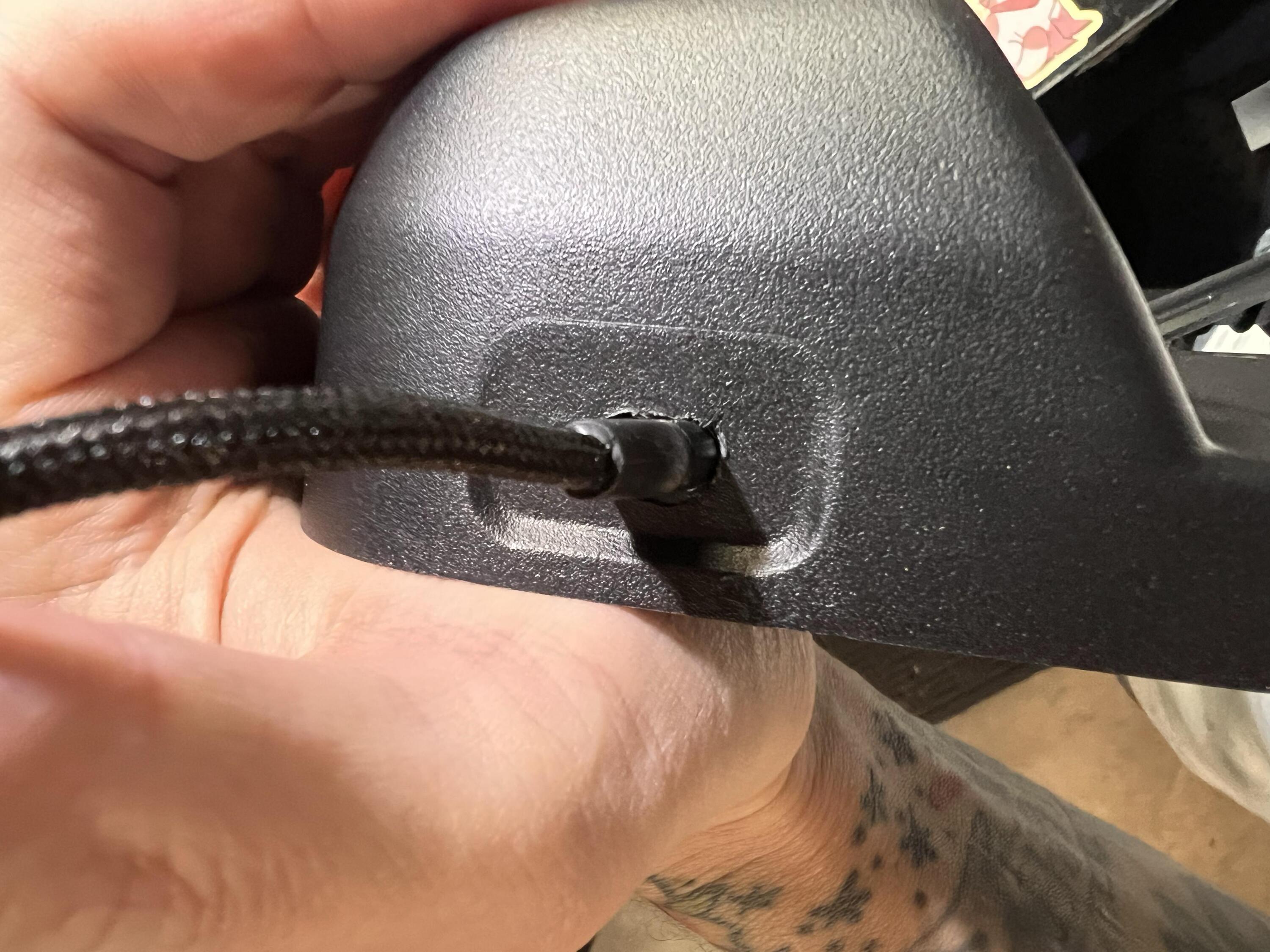

I melted a small hole on the indention you can see for the wire to come out and keep a more "oem" feel/look.
Its a ridiculously snug fit in there with all the plastic closed up, but, I was able to get the whole Dongar harness tucked away in there and just have a USB-C cable running out of the hole, with a little two sided foam tape to keep the cord snug.

The factory plug does not fit into the dongar adapter. Did you really have to trim a lot off of the dongar adapter
Khamsin
Khamsin
Oct 18, 2025
63
‘25 Ranger Raptor
Retired Army —> Public Sector
It didn’t take much trimming- just two or three small snips to the plastic for the plug to fit. The issue is the plastic guide alignment; the pinout itself is identical. I already documented this above with photos, which is exactly why I included them and specifically called out that detail.

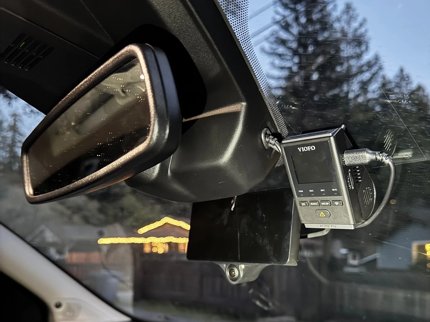

I finally installed the viofo I got on black friday. Used a razor knife and diagonal flush cutters to mod the adapter, and it took a lot of fiddling to find the right position for the adapter inside, but I'm pretty happy with the results. Need to get a usb-c elbow so I can use the usb port on top and clean the wire up a bit more.
I drilled two 3/8" holes side by side and then used flush cutters to join them into 1 hole. This worked perfectly to fit my USB-C cables through. A rubber grommet finished it nicely and hid the rough edges.
Ford Ranger 2024+ Dongar dashcam adapter install w/ rearview mirror power tap IMG_5864

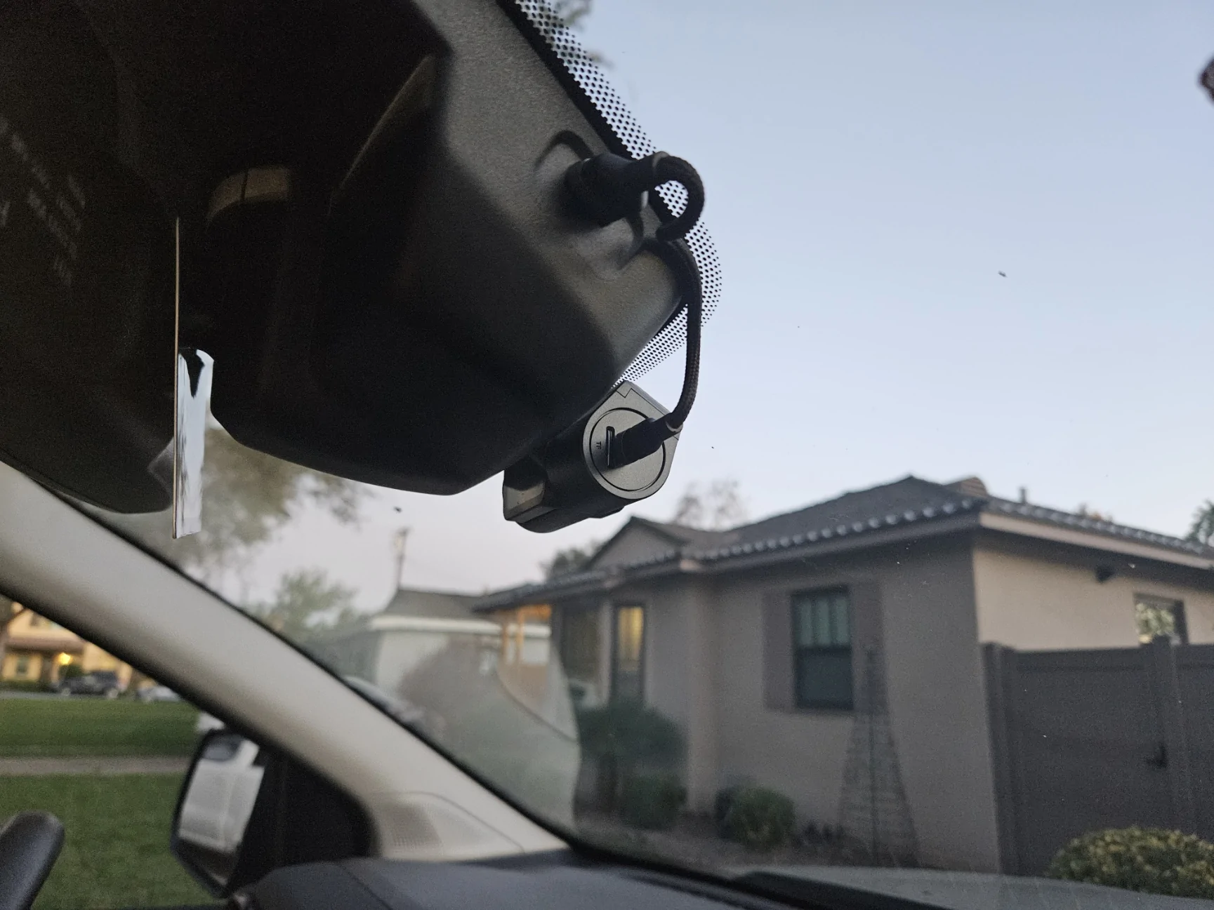

Installed mine today too! Got the cam (Cievie C200) and cable (the Hifihia knockoff) as a Christmas gift. Got a short (3") USB cable off of Amazon and it looks nice and clean! Can't even see it from the driver's seat unless I'm looking for it.
Still wish I could find a similar cable with a 90 degree USB-A, but I'd rather have the 3" length than the right angle if I have to choose. If it bothers me too much I'll probably run it inside the housing like everyone else, but I wanted to be able to unplug it without pulling the shroud.
