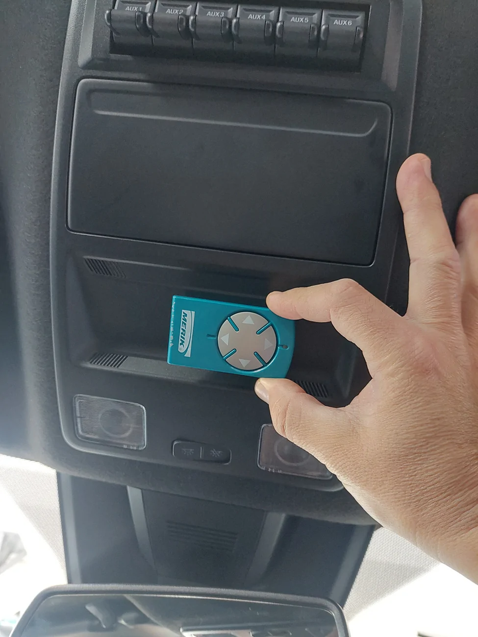

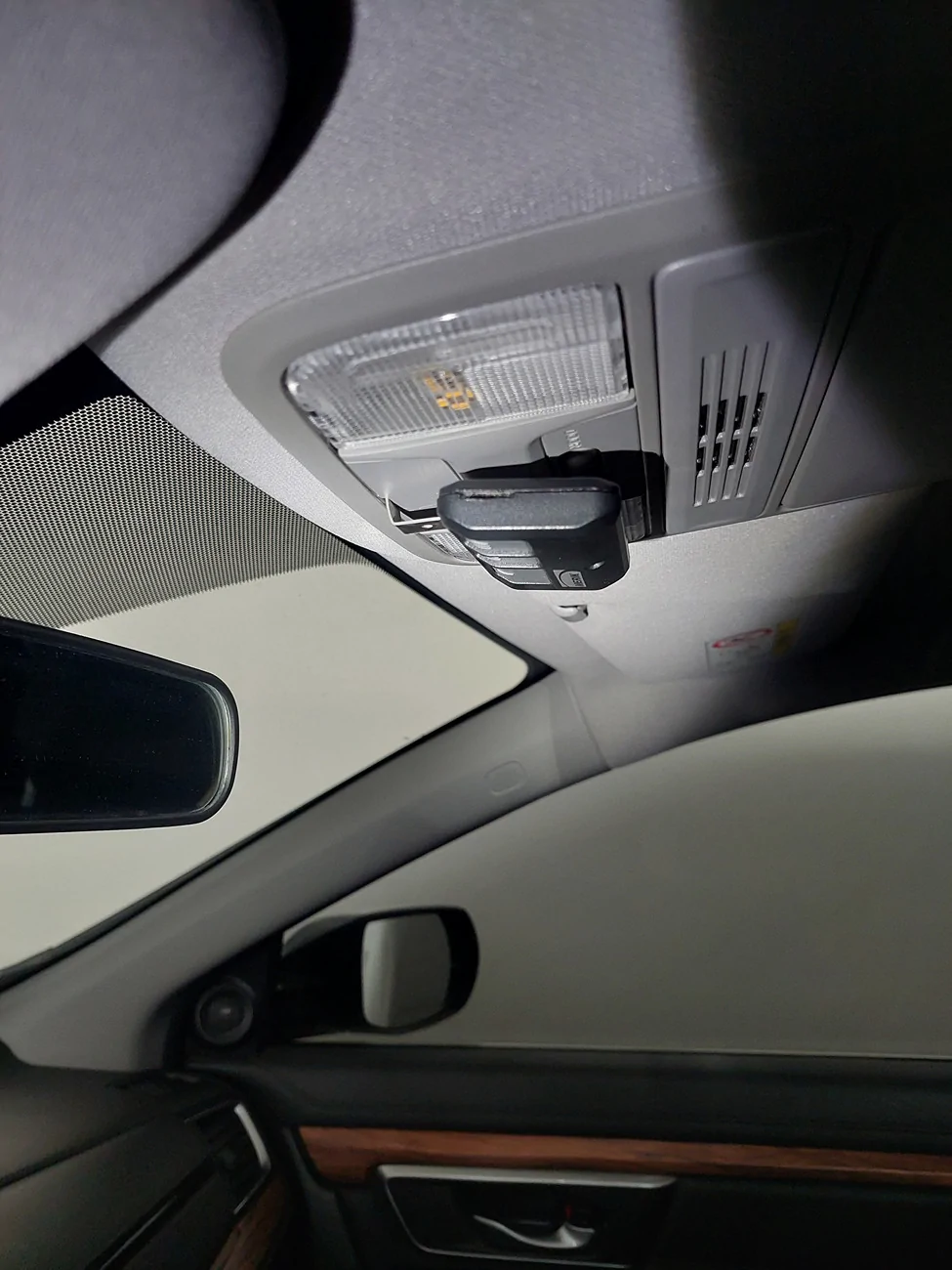

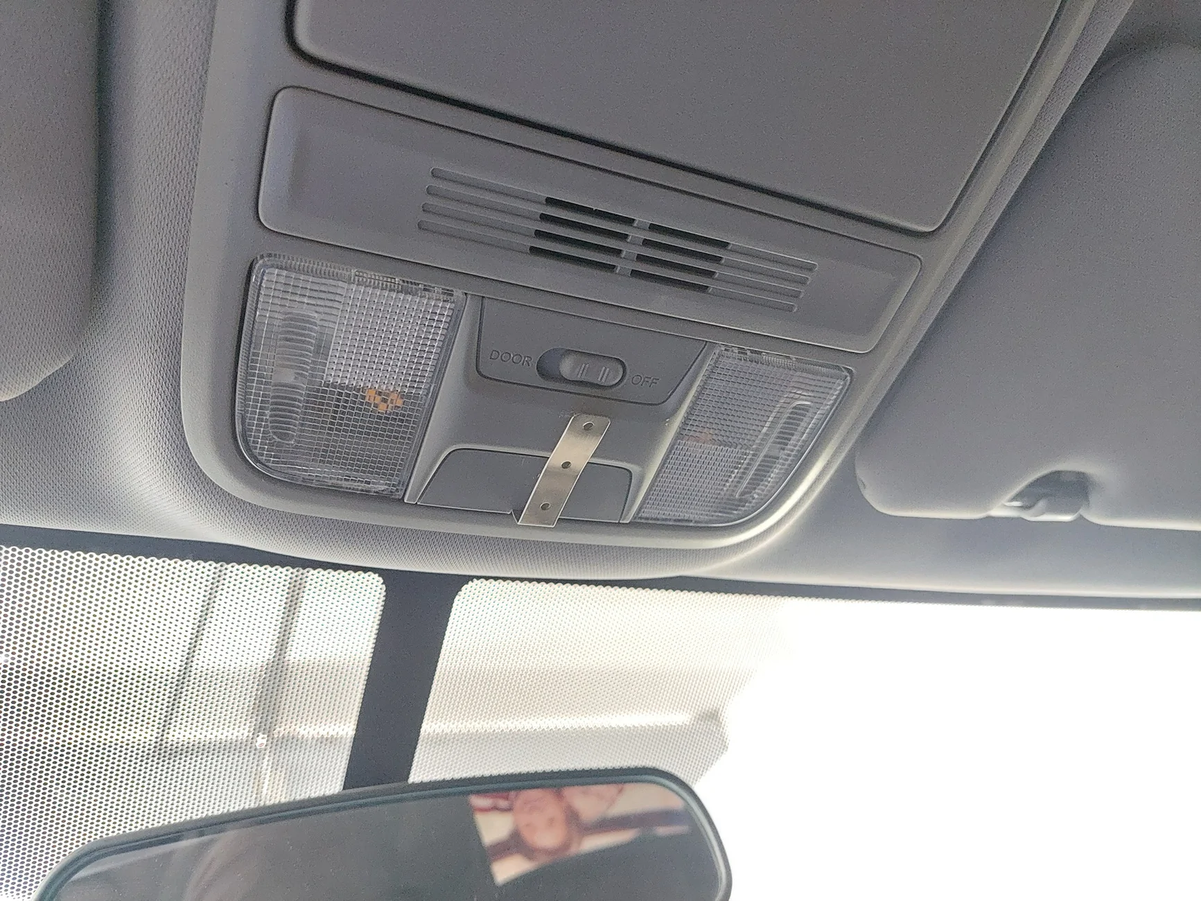

Tinkerer Fixer
I have fixed the metal clip of the garage door control - On a CRV 2021- and will put it in my '25 Wildtrak. ITS DETACHABLE, so its the best of both worlds.
Made a slit on the plastic (or between two pieces) and fixed it internally with two small screws on the interior, bent the metal strip so a half side its outside. just slide the control to hold it as it was designed.
The rangers have a ample rectangle between the sunglasses holder and the accessory switches, where you could fix the clip:
GLUE IT the back piece remains and can be opened to replace battery by prying normally. or
FIX IT WITH SCREWS. unbend the piece, drill 2 holes in the metal piece, put self tapping screws to fix it to plastic *tightened by hand to prevent stripping itf and bending back the metal piece, you could put any control there.
